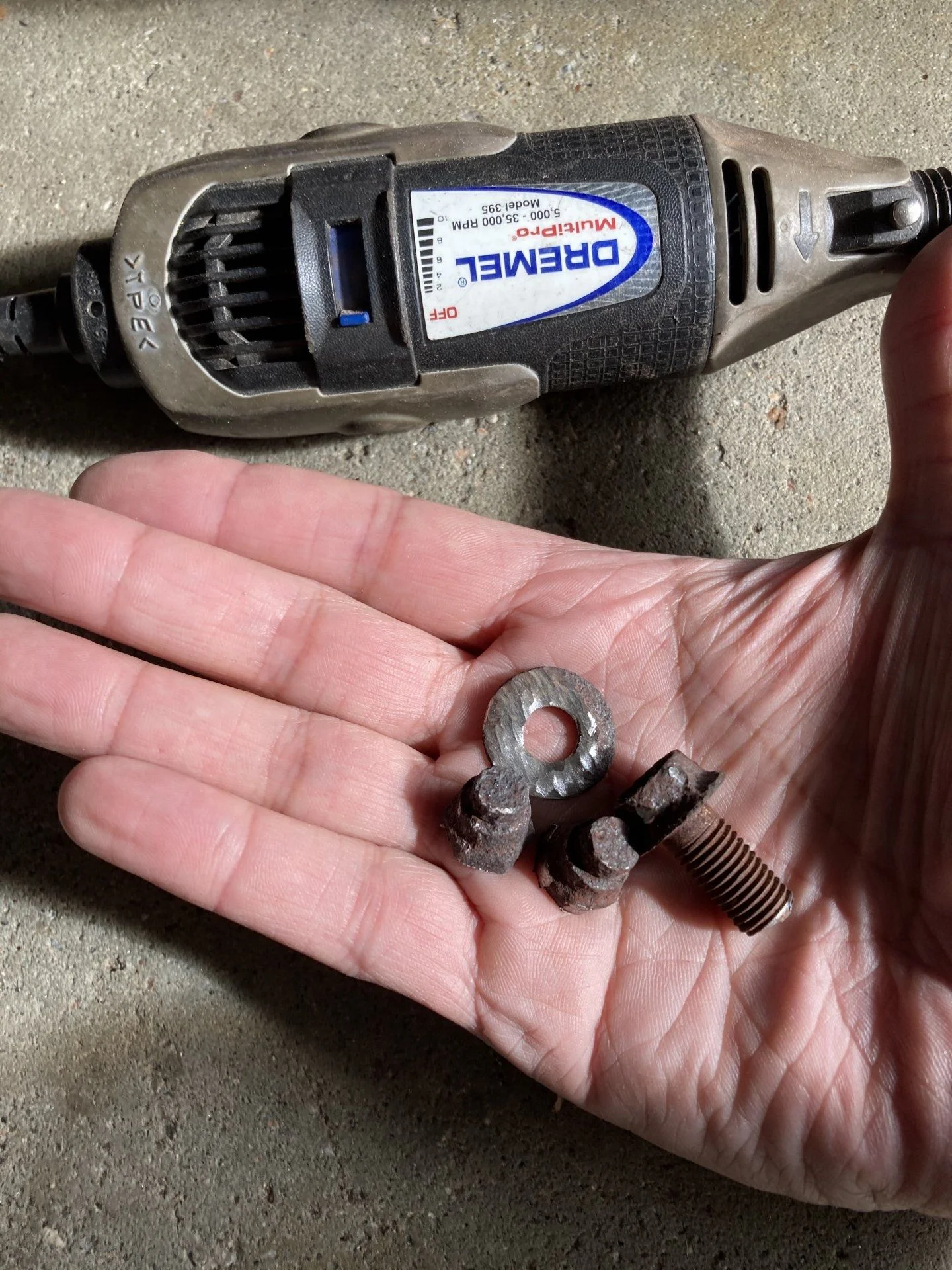

And if you plan on doing this there is a 100% chance you’ll need a SawsAll and/or Dremmel for the old bolts.

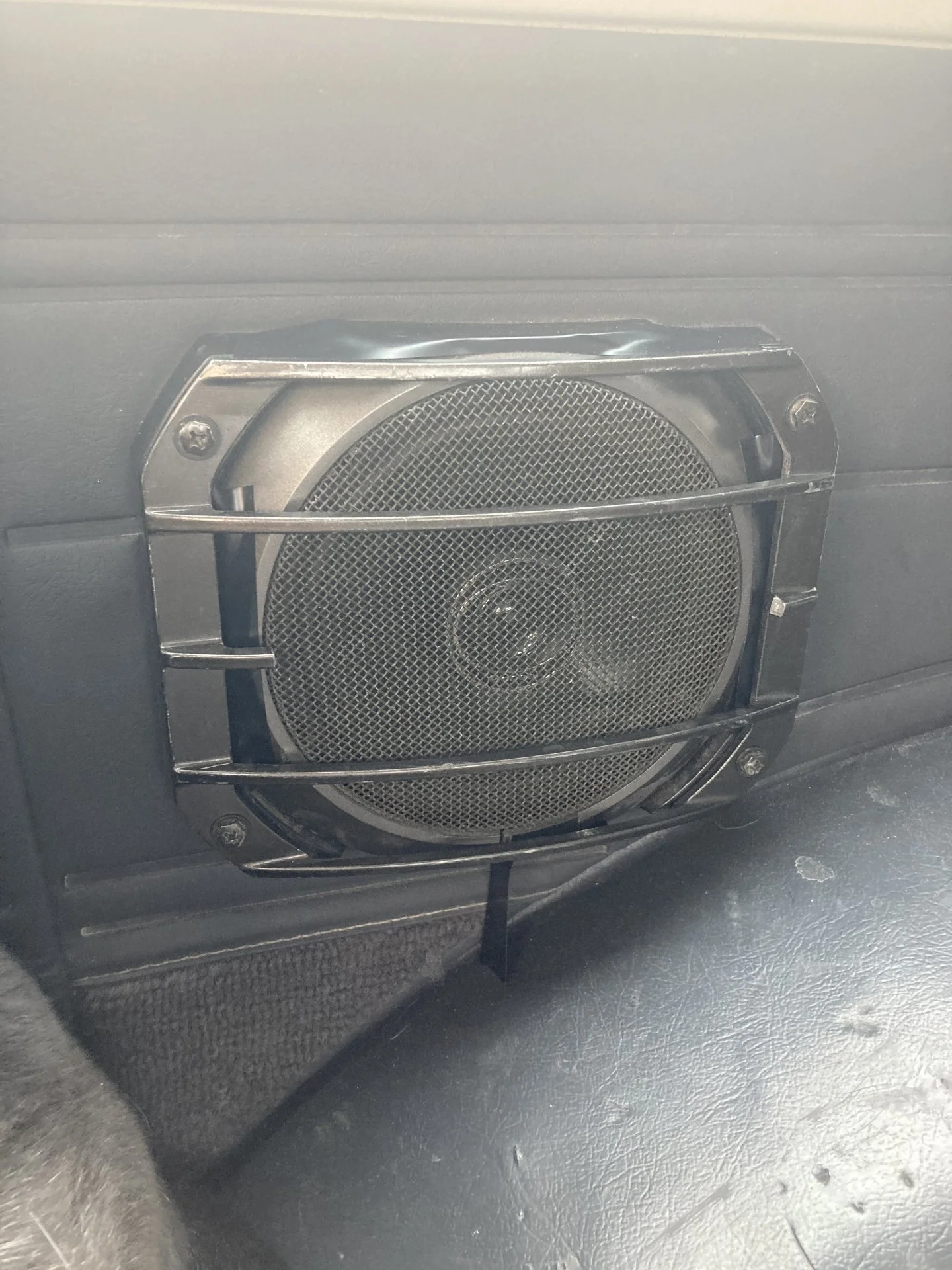

Very, very nice. Anyone know where you can get the stock 62 rear speaker covers?
Www.Shop.cruiserparts.net
When I searched their site they had grills, covers, backing plates.
I ordered just the grill but being fully transparent, the grill/mesh cover and backing plate came together.

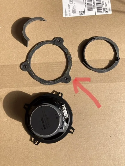

Prolly a little late here but have you seen the 3D printed adapters @TheNeek makes for this? Uses the original screws and hardware but would prevent you from having to cut into the doors:
His adapter kits include the little screws and nuts to mount the modern speaker to the adapter ring. Then you use the original screws to mount the adapter/speaker to the door. No cutting required. Works with the original door card and speaker grill as well. Sounds like this project is done but thought I would share in case someone else stumbles on this. Sorry if you have seen this before. Carry on.

I’ll reach out to him as that is a great setup.
Good news....only two holes cut todsy before wife wanted other stuff done.
Thanks for the heads up.
