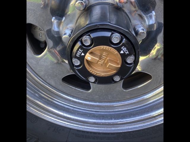

I’m sure I could have fabricated one but I’m in a bit of a rush. I have to get elbow surgery which will sideline my wrenching for 6 weeks. Have to get my front passenger knuckle rebuilt (I only did the driver side preciously), repaint the Aisin hubs by Wednesday.

Made a pilgrimage up to CruiserParts in New Hampshire and picked up two more pieces.
Should be my last engine compartment sticker plus a semi-useless front splash shield. Figured it came with one from the factory.
With any luck I’ll get this and my Aisin hubs repainted this weekend.

Sickness continues.
