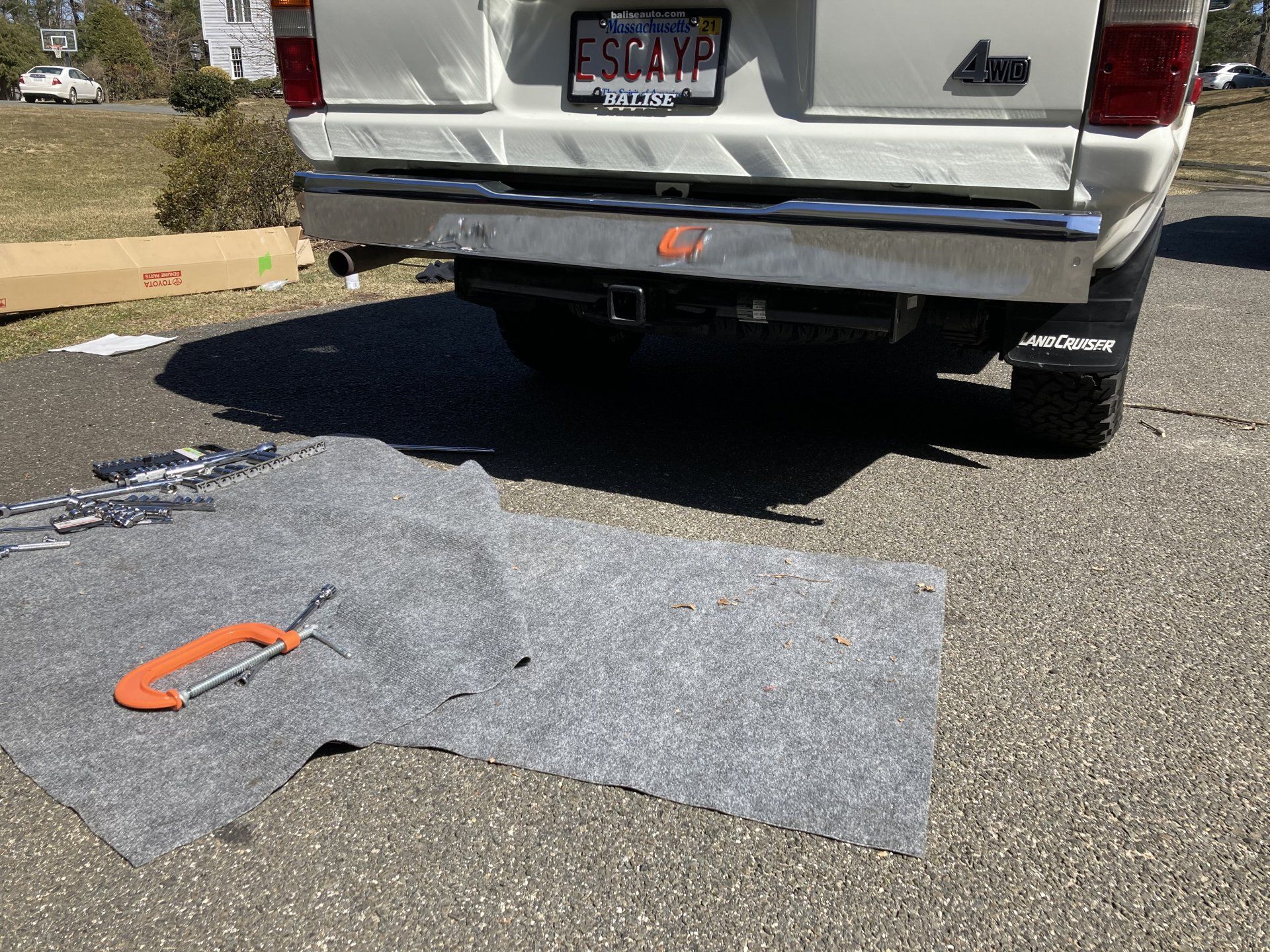

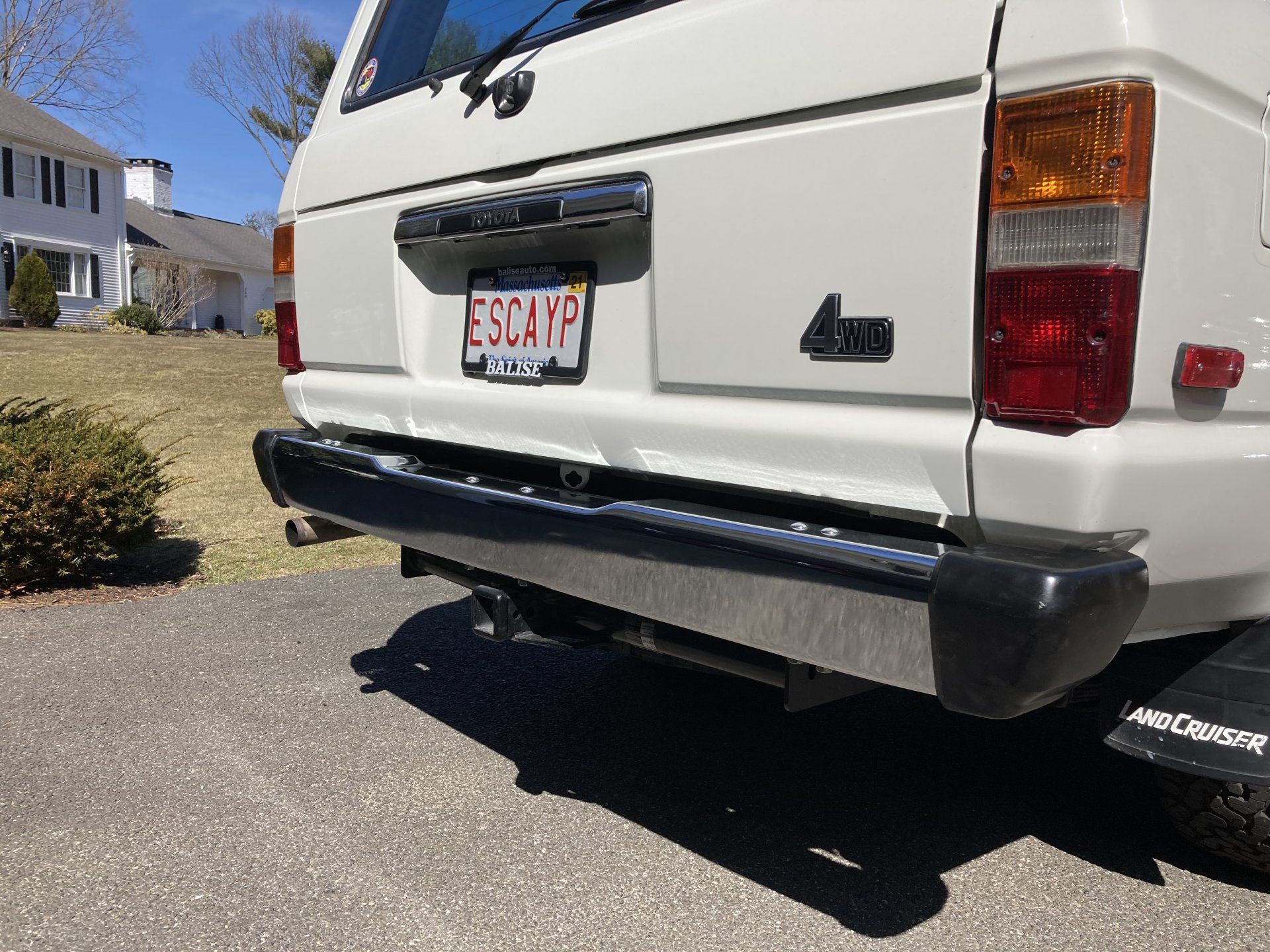

With luck I’ll have the grill, new OEM bumpers and the engine compartment stickers installed.
It’ll be over 40 degrees so seems like a good time to attack it.
