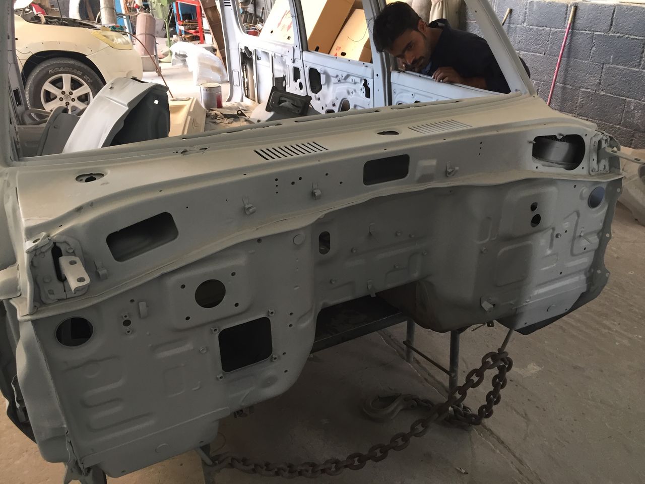

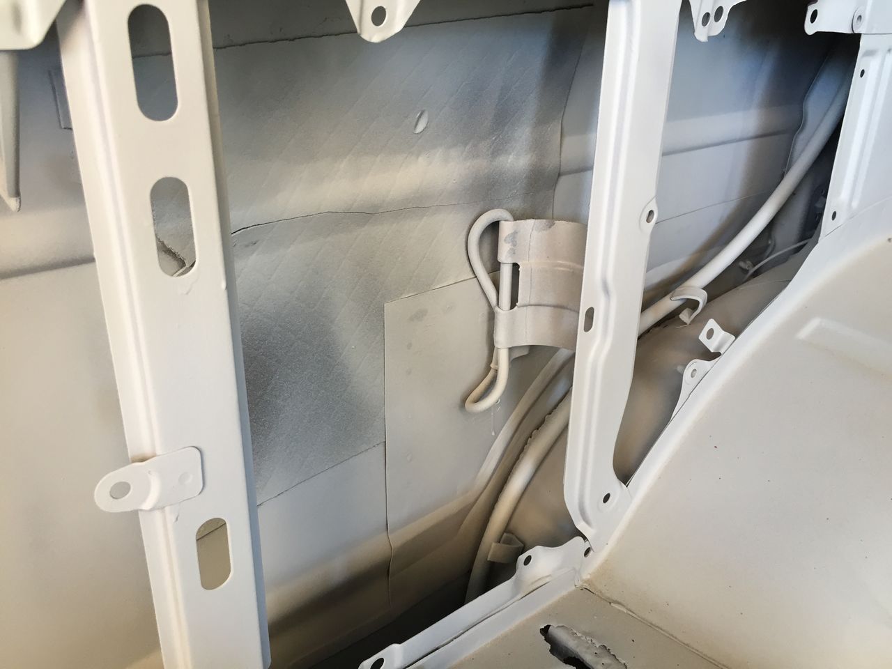

Put some primer down on the body shell to stop it rusting while i take care of the metal work and repair:
Also got the chance to have a look at the RHD firewall and inspect a few previous patch panels:

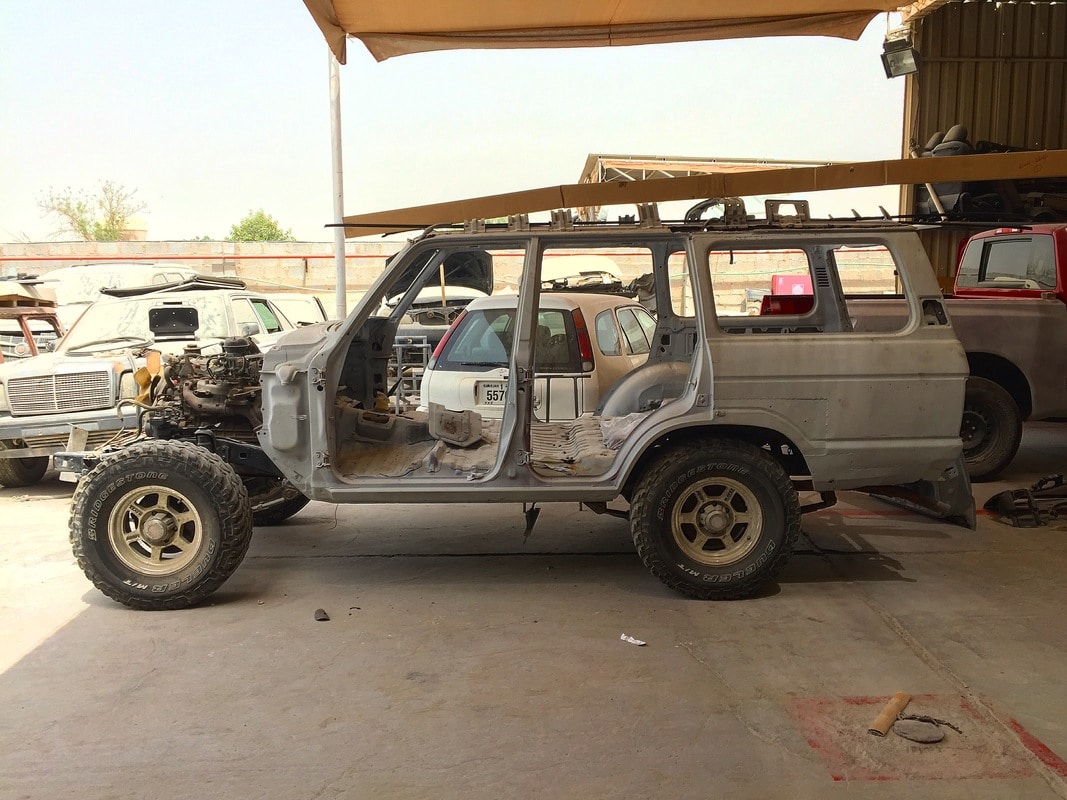

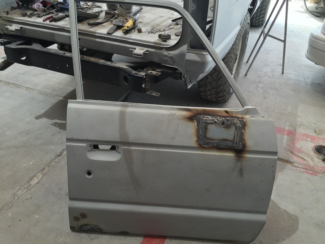

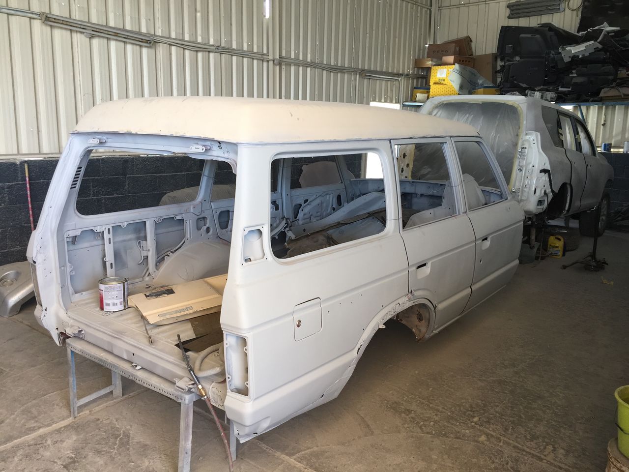

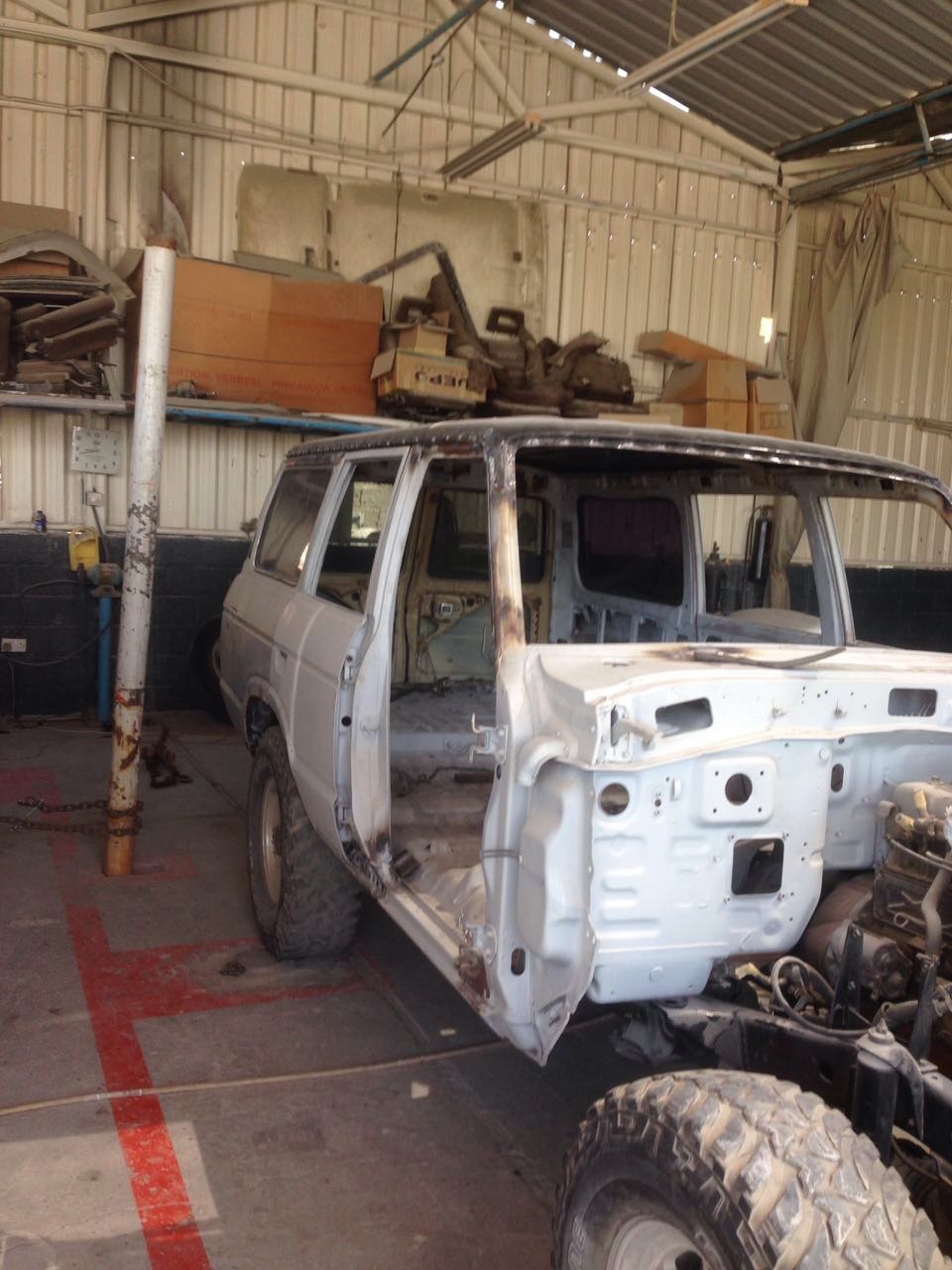

Got the doors off and almost finished from rust repair and treatment, and got the body sitting on the frame but not bolted so i can paint the body off the frame and make some last minute clean ups.

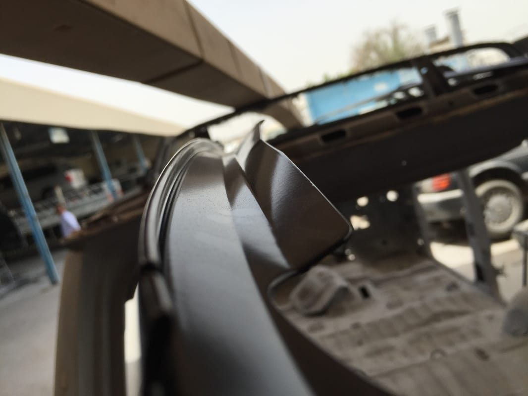

New weld-in roof channels

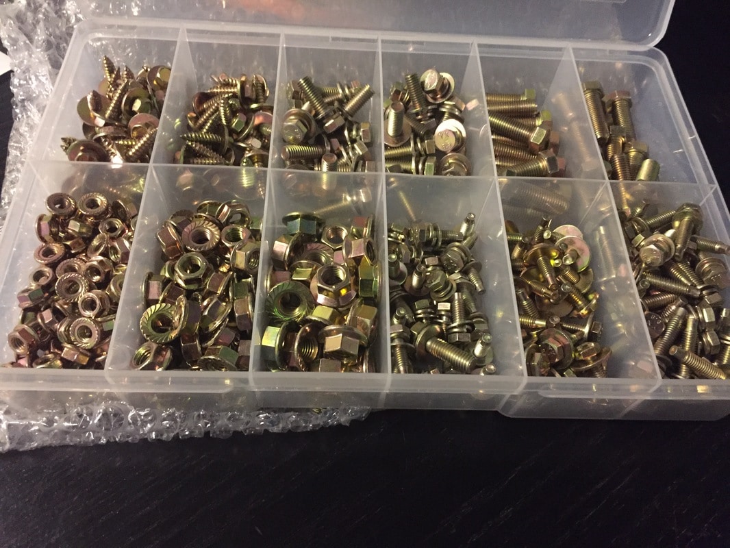

Thought now is a good time to replace all the hardware since everything is apart so bought a pre-plated
nut and bolt kit.

Impressive work so far. That original roof skin is amazing. Thought you were going to go with a camper-top conversion until I saw that.

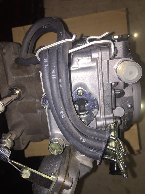

Its got it's original 3F carby in it for now, the challenge is to get the metal work straightened out and get the motor running decent. Already got the H55 in it from the factory and it drove in under its own power so no complaints yet!!

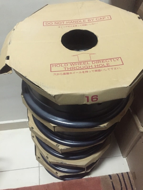

I really like the splits and have fixed two flats in 3500 km.
Can you please measure the splitrim ring as mine are rusted and I have no idea what new specs are?
Especially the ring where it takes the force of the inner tube.
So if you put the ring flatside on cardboard with the V shape up how thick is that V ?
I am in the middle of moving to another house but this is a picture of what I am trying to measure and what I am using now, is this rusted beyond safty?

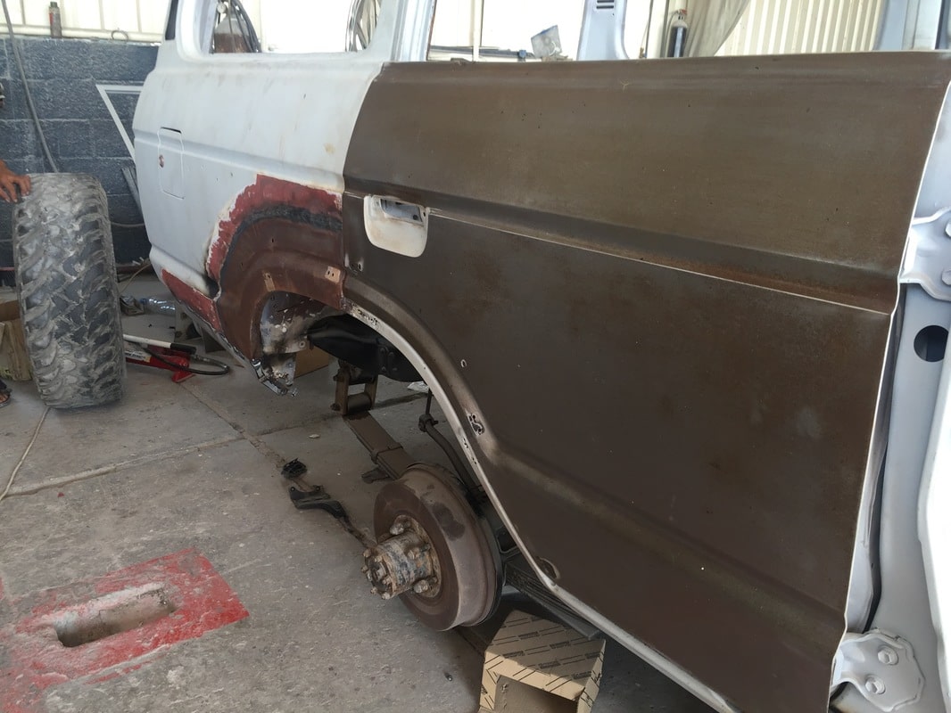

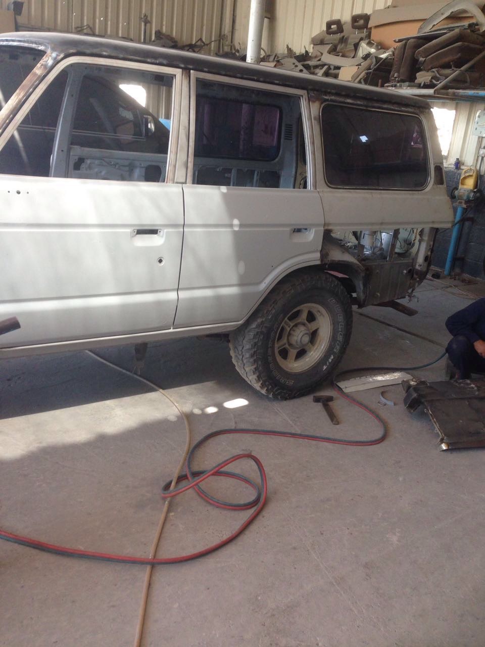

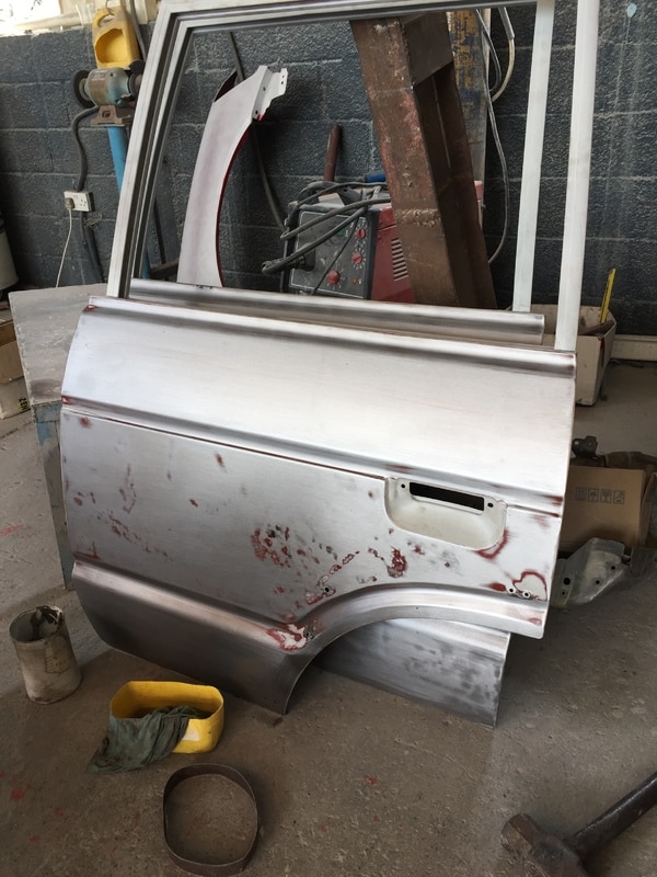

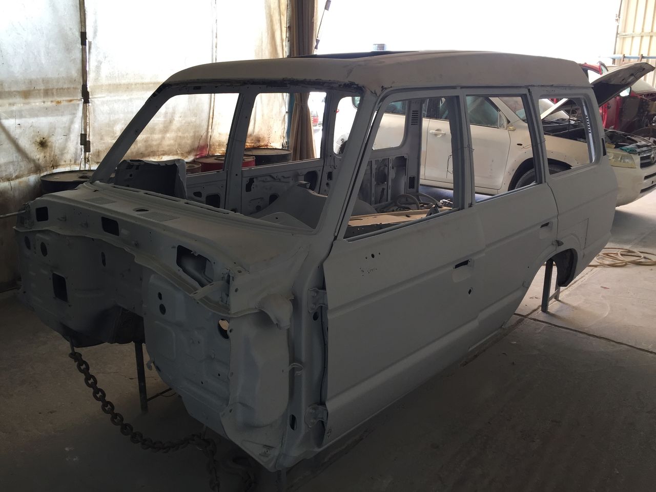

Did some more door work this week to wrap things up and get started on getting the roof seated

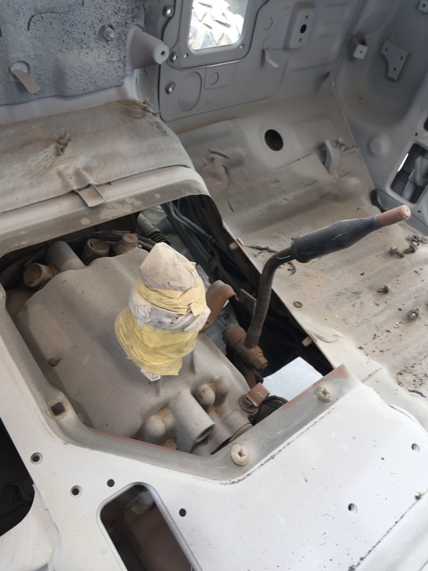

Checked the clearances for the transmission tunnel (factory 5-speed sits nicely)
For the moment, the body is only sitting on the frame and not bolted to it, there's still more work to do underneath

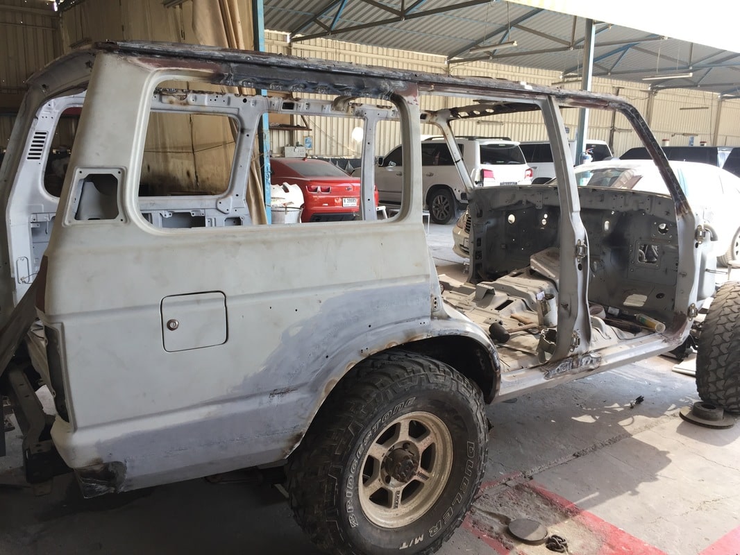

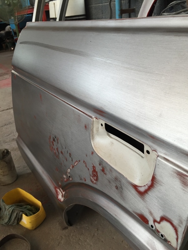

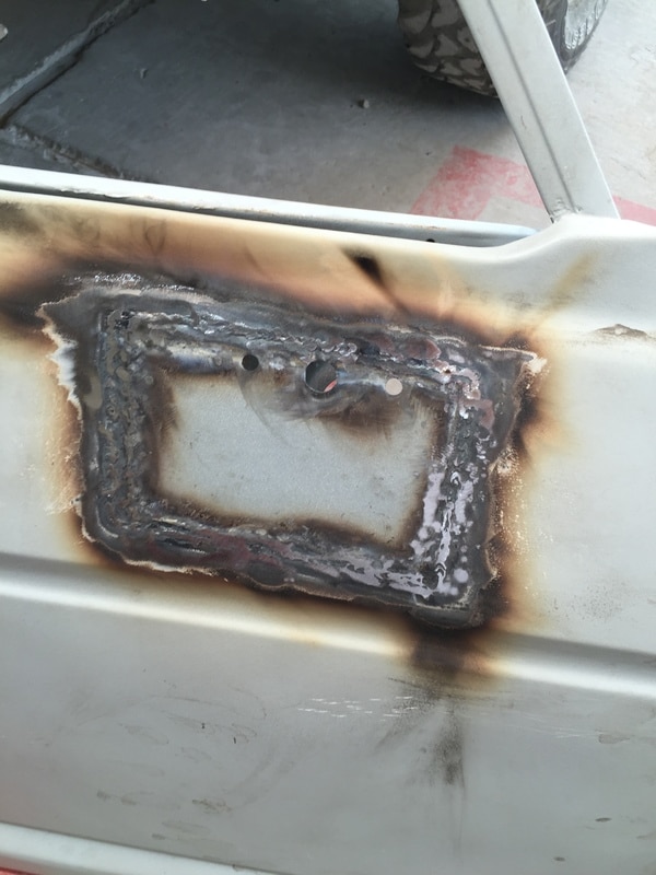

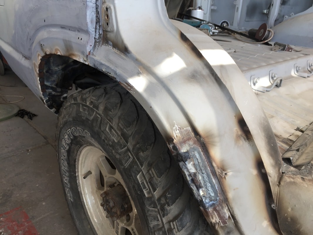

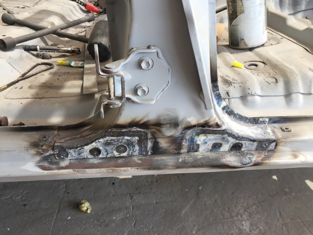

Spent a week on each side of the body, the right hand side is completely done with metalwork and the left hand side is about 80% of the way completed. All the side doors are finished and waiting to go back on the rig. Once both sides are dead straight, i will attack the rear section since barn doors need to be seated and hung perfectly first time out or else they'll rattle and squeak their way into my nerves. I also spent time acquiring some more hard to find parts gold.
First, the before and after metalwork photos:
Before....
After...
Before....
After....

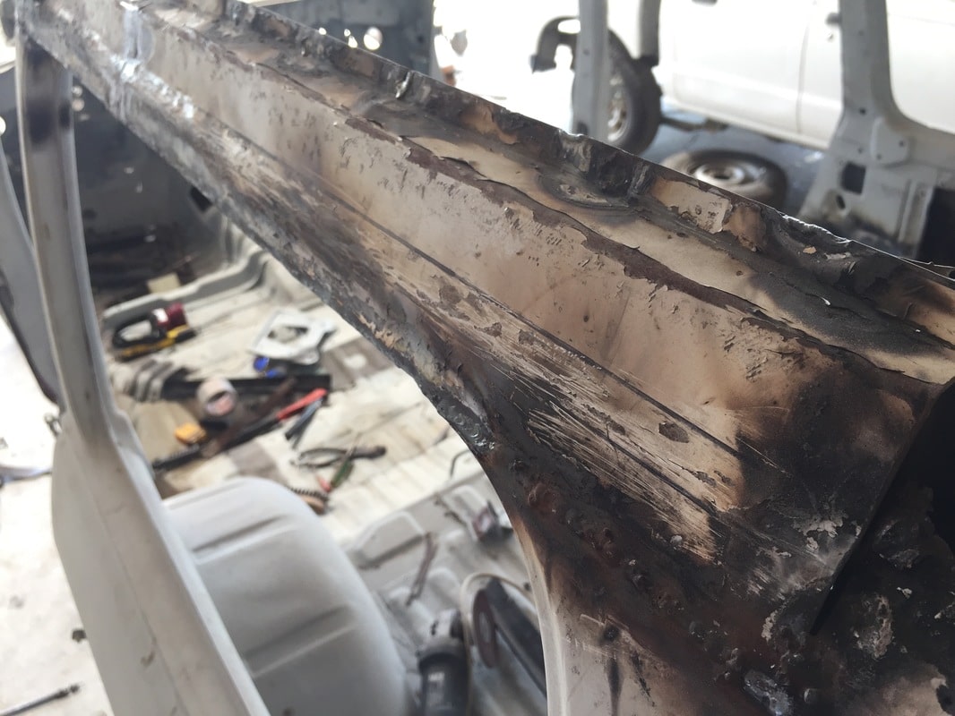

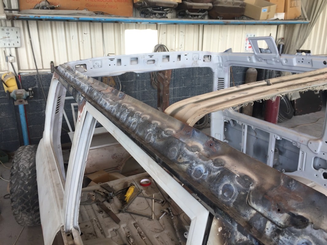

.......and finally the roof channel is just about done
The other side also on its way to being finished

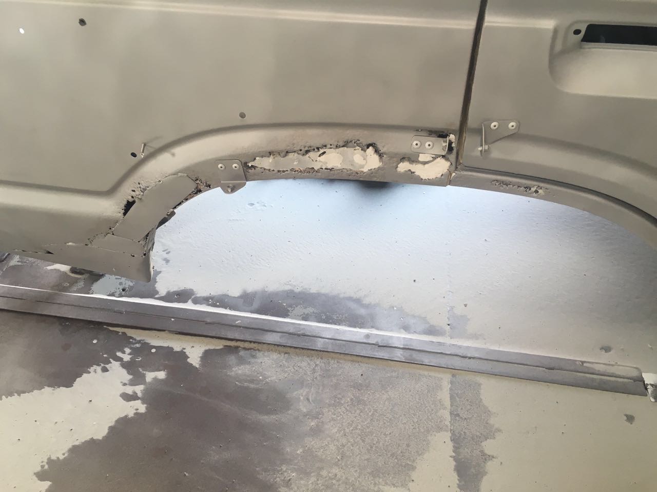

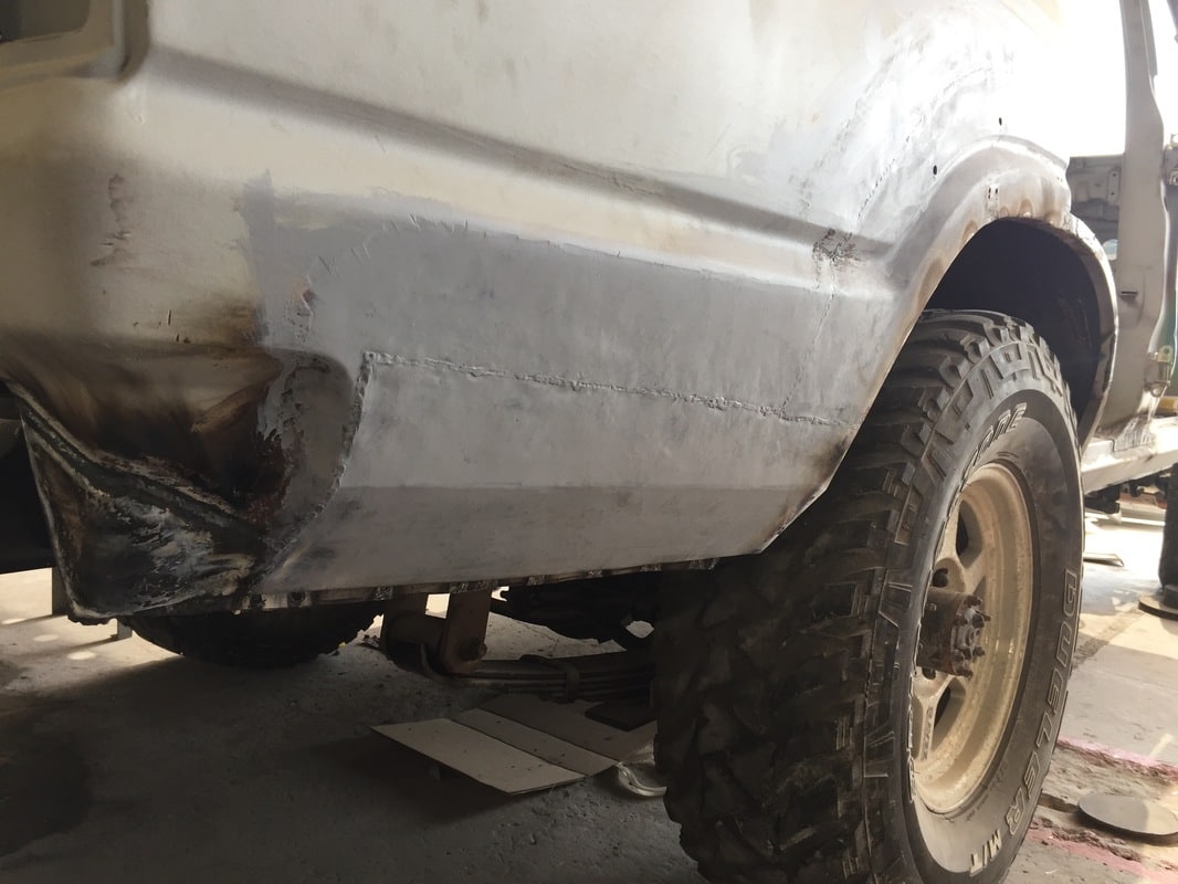

I'm very happy with the way the right side quarter panels turned out as it was pretty much destroyed
Still have a few welds to grind down but no more swiss cheese holes
The completed Right Side

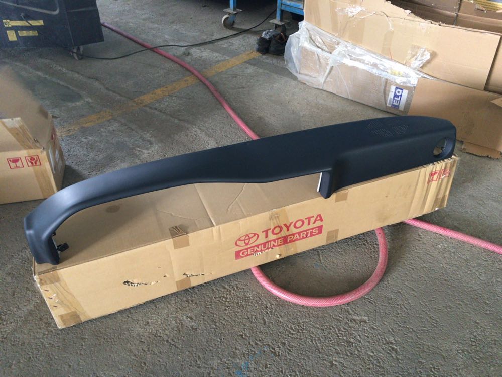

.....meanwhile in dashboard land, brand new in the box

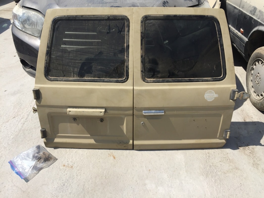

Barn doors all the way from the Kingdom of Saudi Arabia, these are so well preserved in the dry desert air it makes me want the scrapped 60/62 that they came from.....

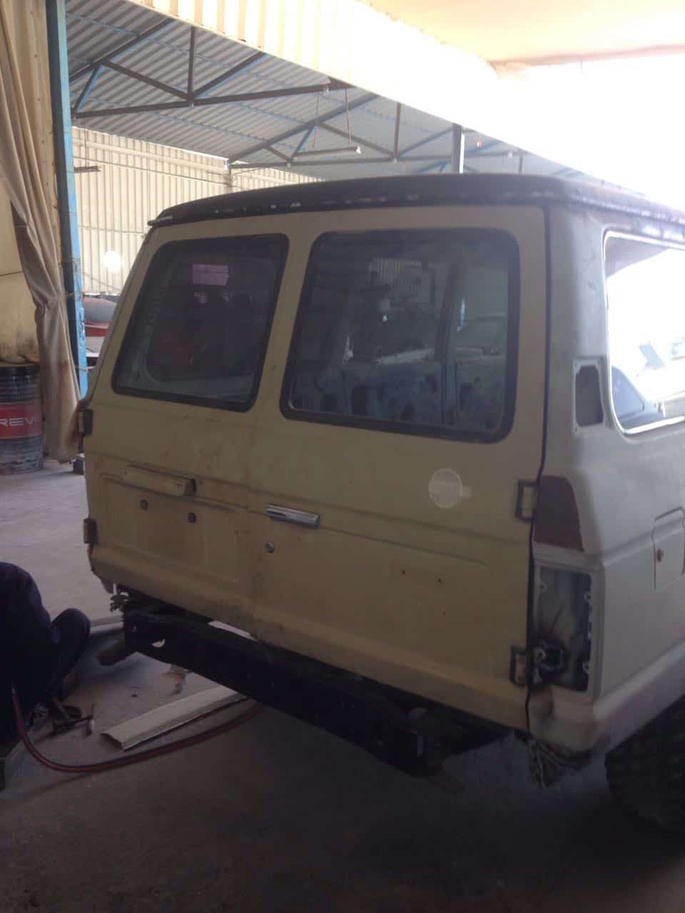

So minor progress update, got the roof finally seated on the truck, got the doors back on it and finally taking care of the last quarter panel. The items left to do are to convert the RHD body to match the LHD chassis and finally prep for paint.
Onwards and upwards.....
