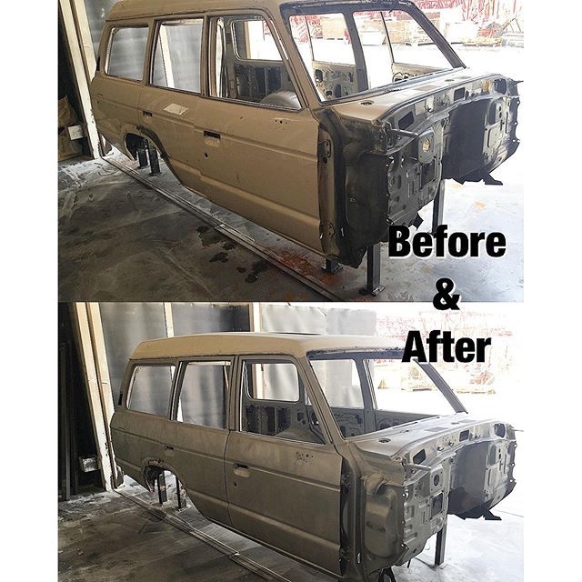

So how much does it cost to completely soda blast a body like that? This new one
looks just like that - new. Are you going to cut and replace the entire firewall for the LH
drive conversion?
drive conversion?
It was the equivalent of $1000 to do one body, i plan on first just swapping the mounting plates so i don't go hacking up firewalls. I still have some remedial metal work to do around the rear arches as well as swapping the barn doors over.

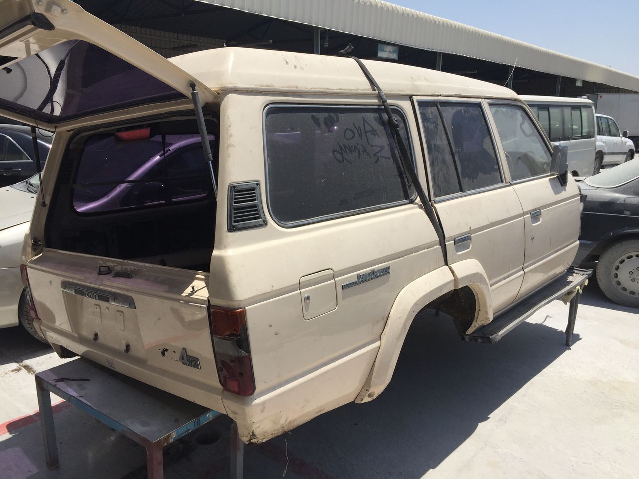

BJ60 to HJ61 Body swap...the five year plan turned right now plan!

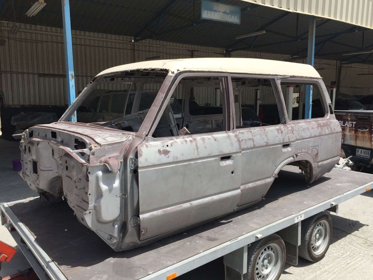

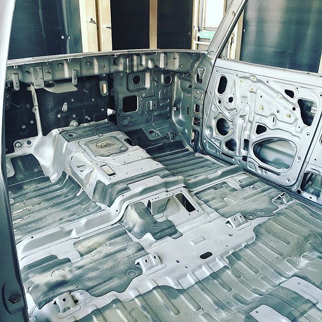

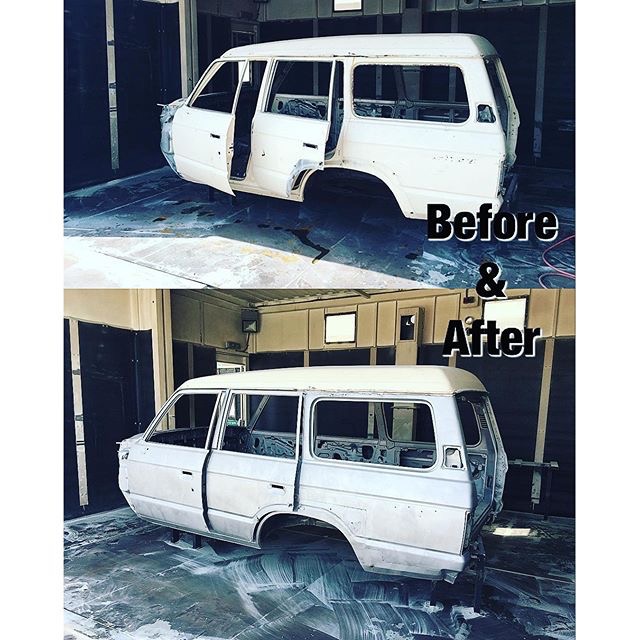

Got the body back from the blasters for the second time, now the metal work can really pick up some speed. Still not sure on how to go about the RHD to LHD conversion but i've got both body shells side by side for a comparison so i can make changes as i see fit with the resources i have.
It feels damn good to have them both next to each other though....

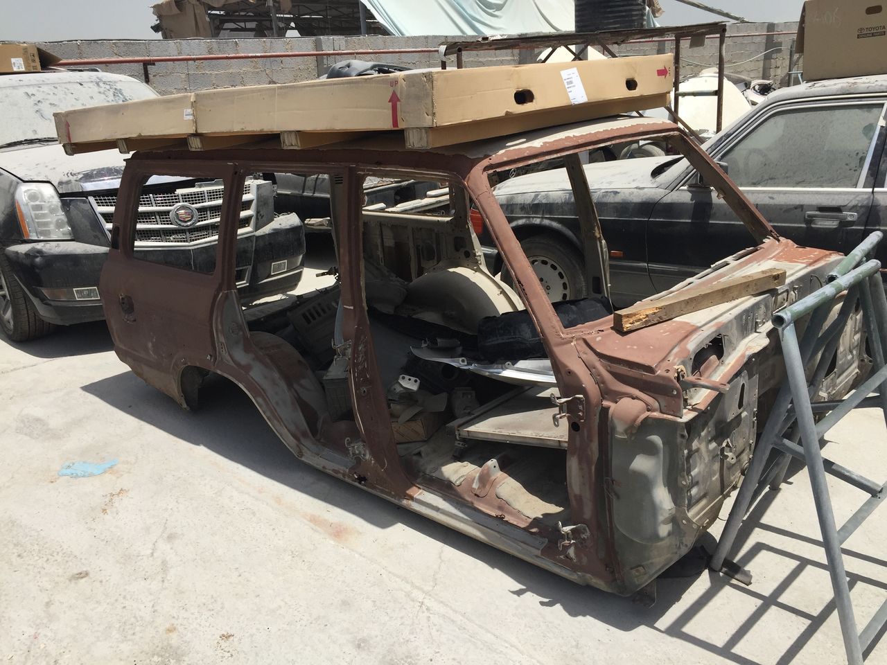

This is the "bad" LHD donor for reference
and this is the "Good" shell that will be used and converted

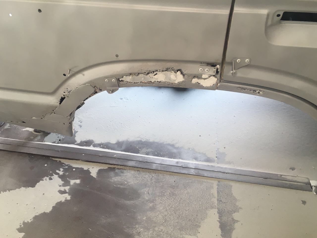

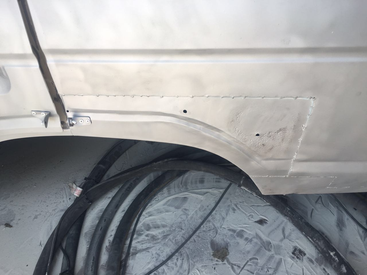

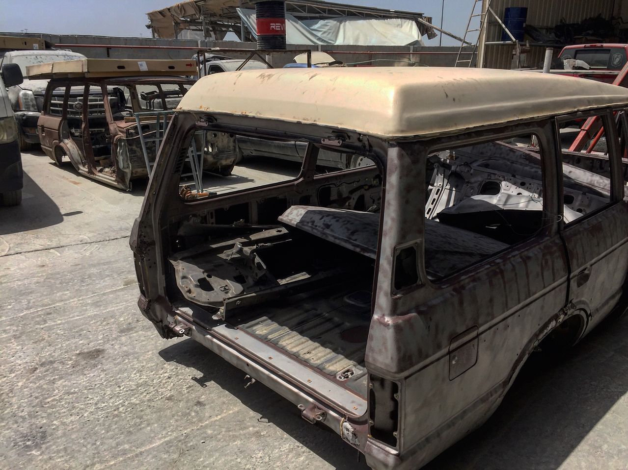

As soon as we got everything off the trailer, i got to have a good look at what i had to work with, second time around, the damage ain't that bad:
Here's the worst of it:
Right rear wheel well and quarter panel
Left rear wheel well and quarter panel

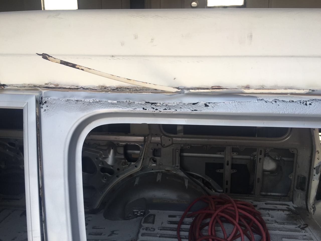

Left roof channel got bent while being put back on the ground, so that'll need some attention too as it showed some rust as well
Other than that, she's all metal, gonna have it sanded and primer'd so i don't need to worry about the humidity and surface rust getting to it while hashing out the steel work.

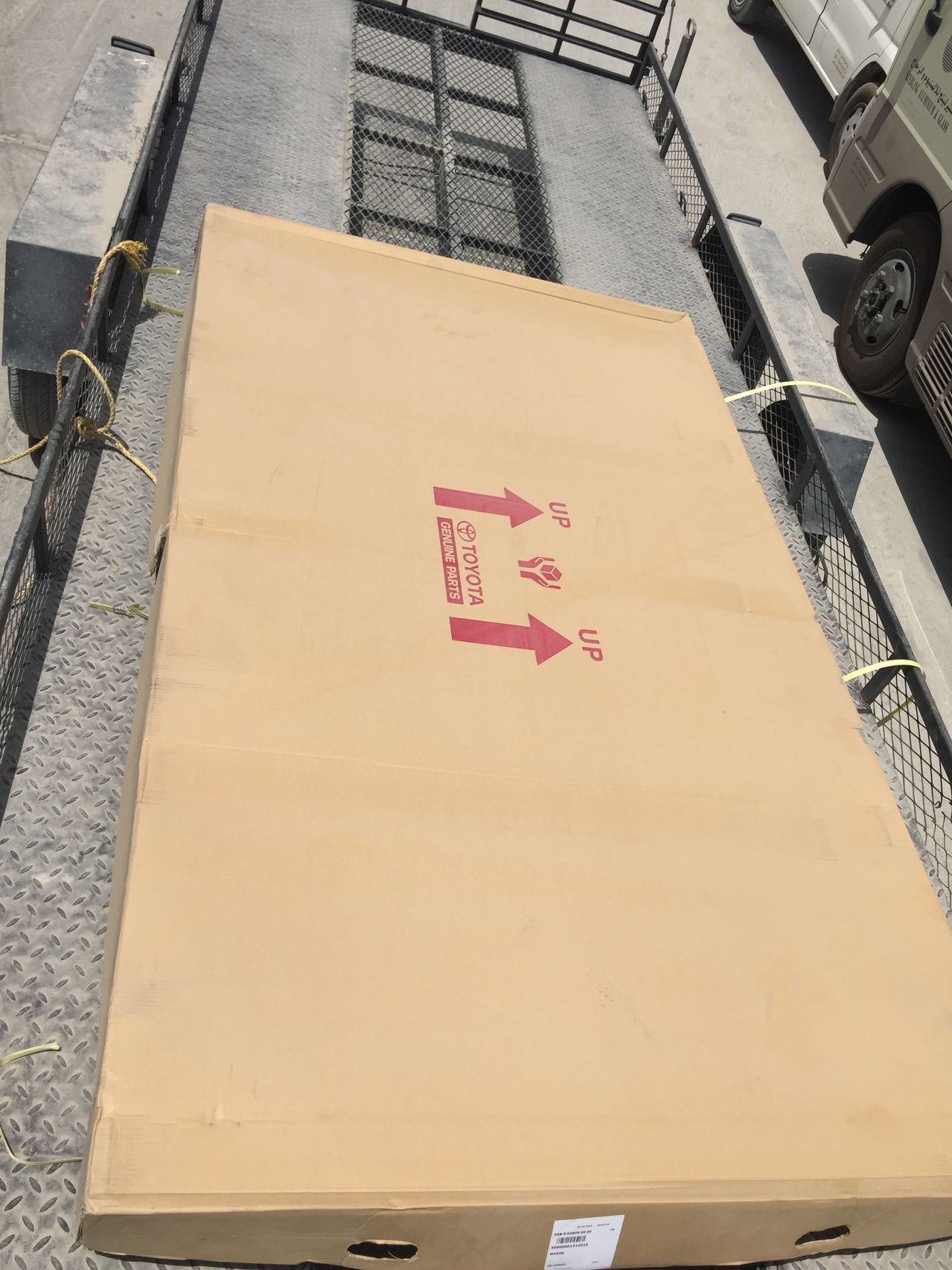

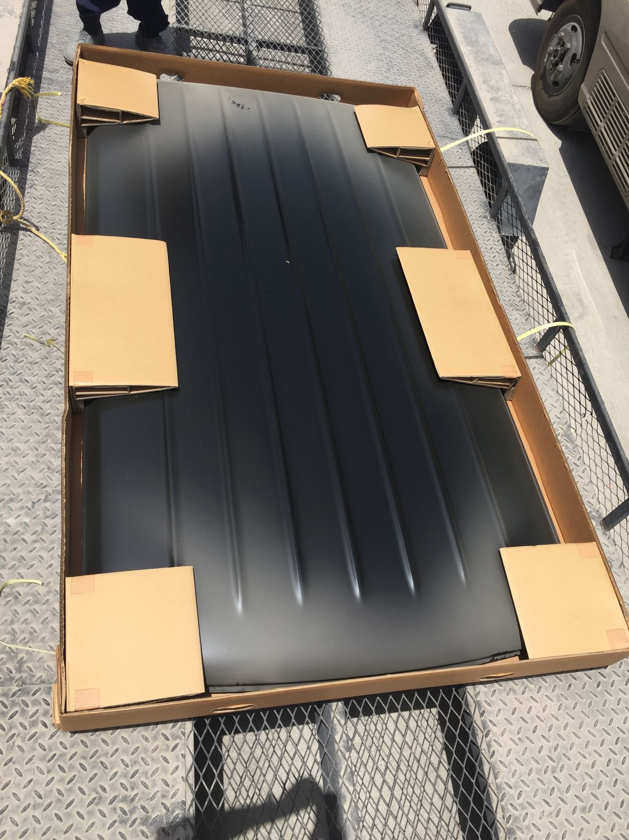

As you've all seen, my roof is destroyed, and i've tried thinking of ways to fix that issue until i got a lead on a set of new old stock land cruiser parts in Oman. So a few calls later and a trip to the border later and i tracked this down:
A brand new in the box roof skin for the 60/62
