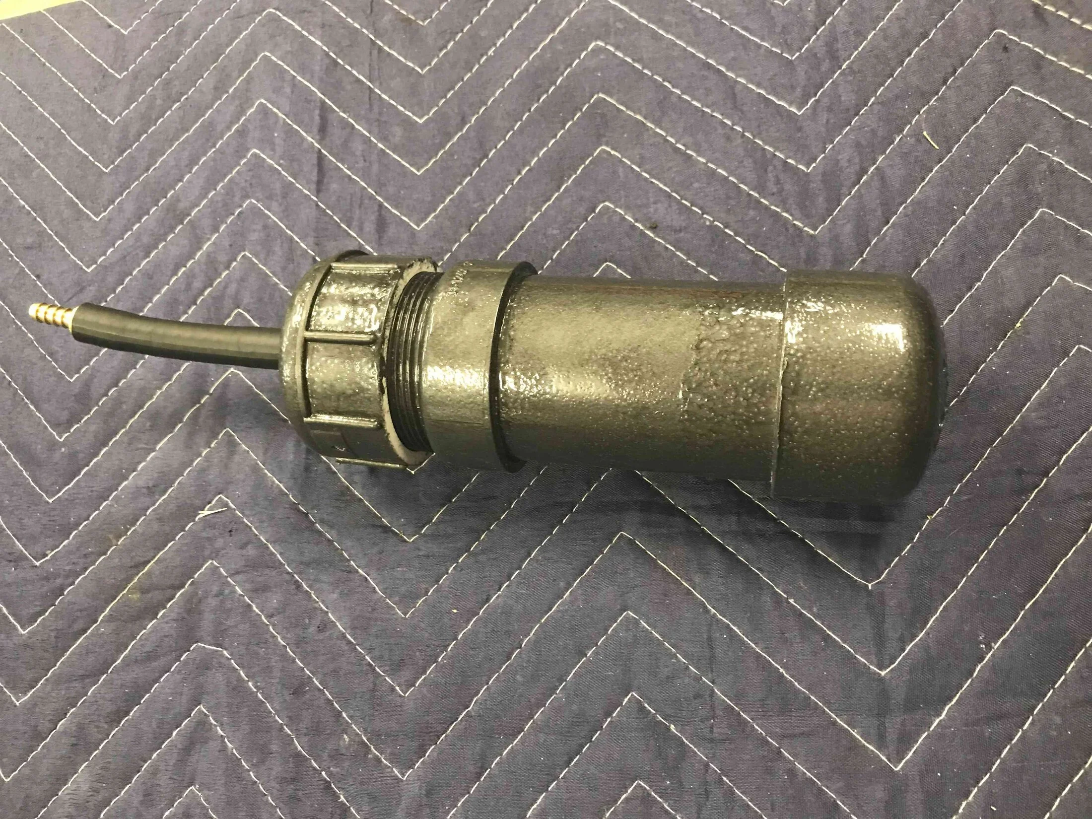

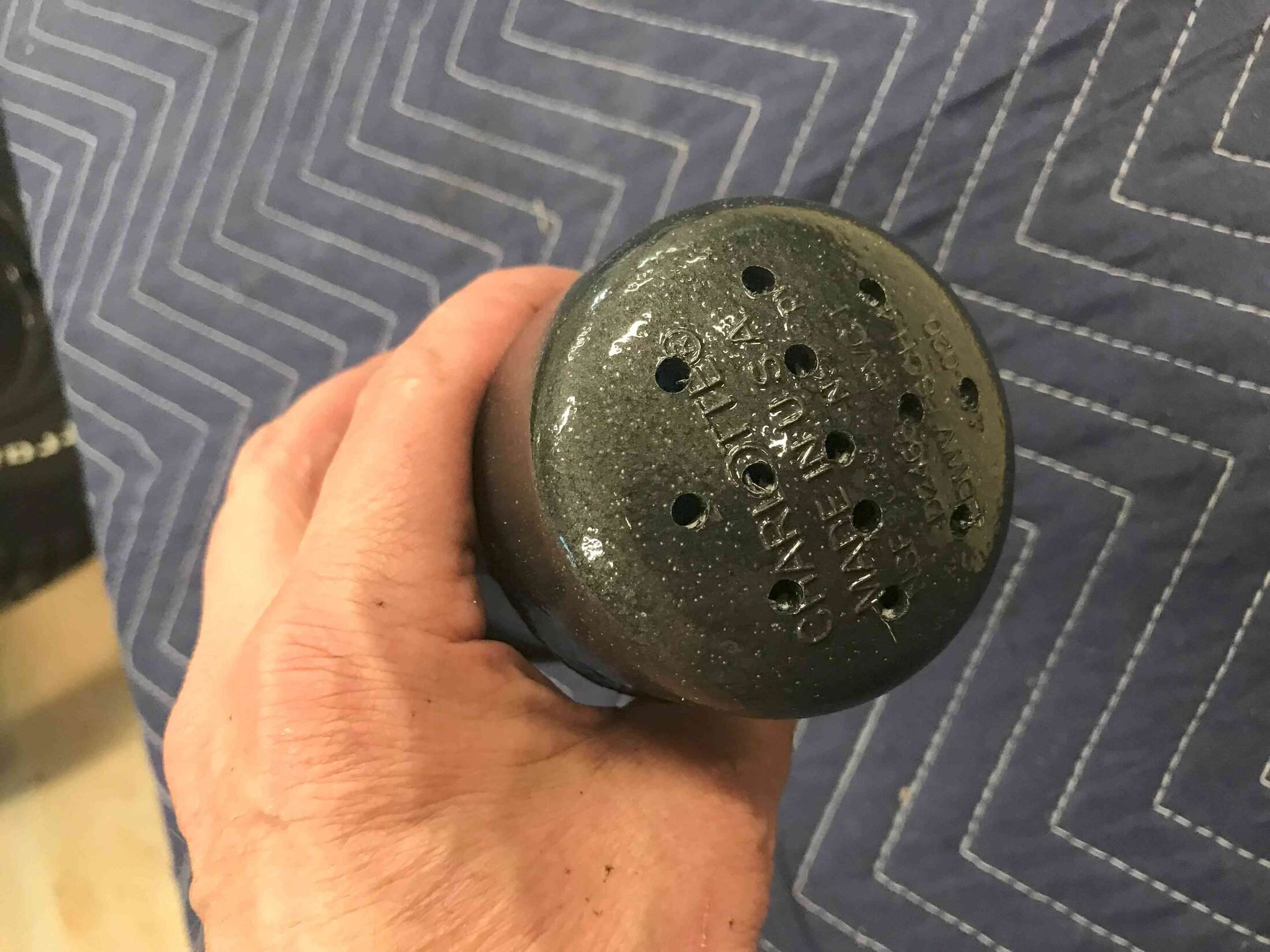

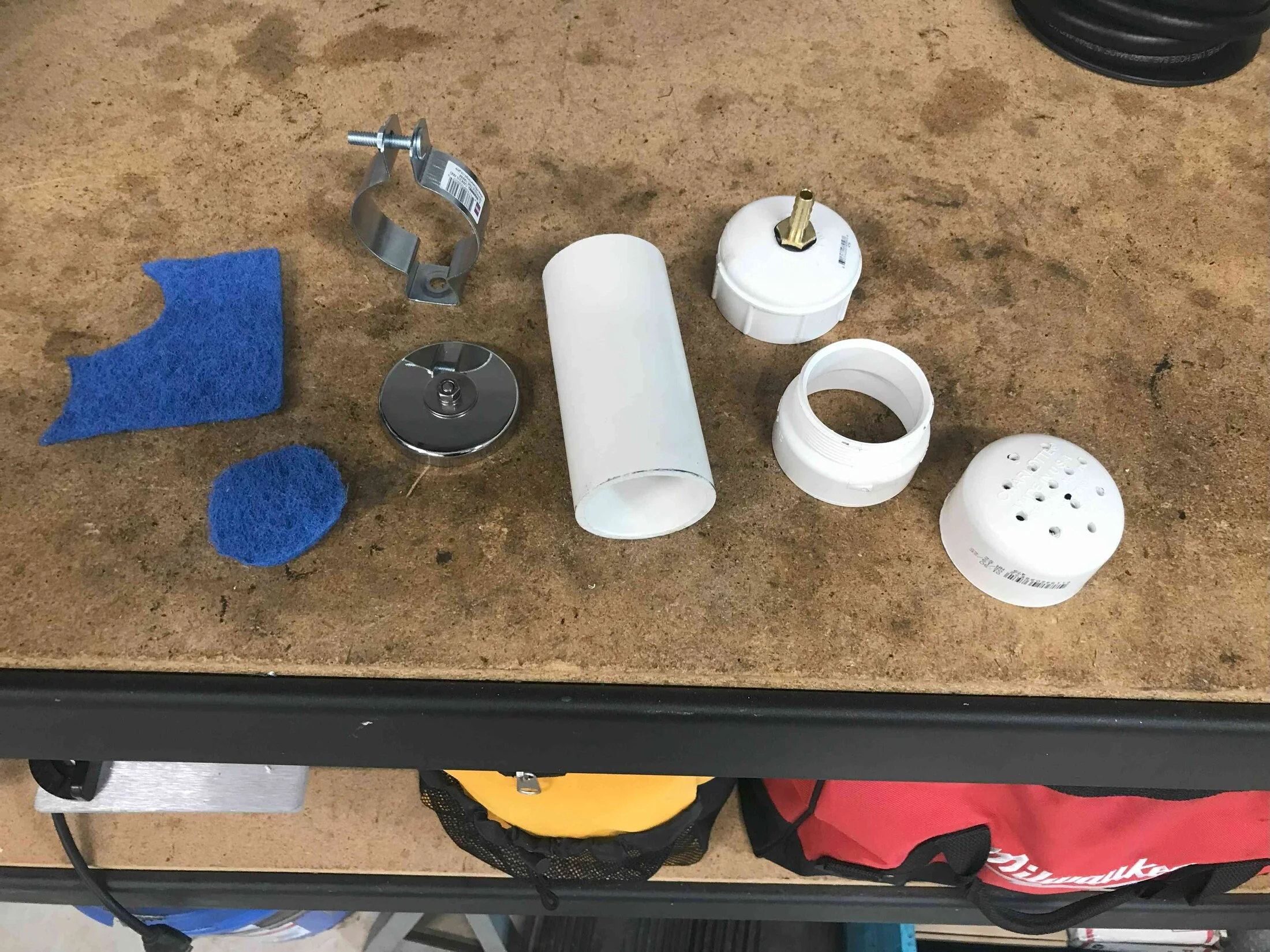

Made a new charcoal vapor canister out of 2-1/2" PVC parts.

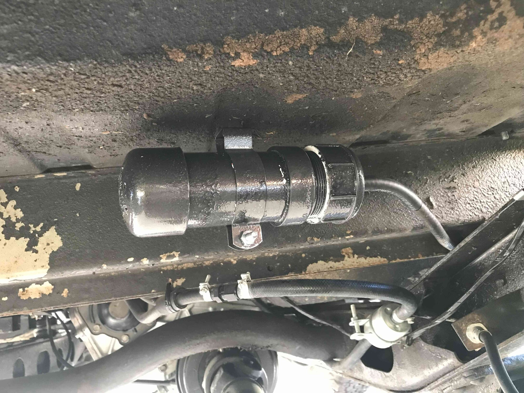

I swapped out a longer M8 bolt for my rear heater and bolted-on the #5 pipe hanger to hold the vapor cannister.
Creative. Does it work? Asking for the Feds.
Holds about 12 oz of this....so far my shop doesn't smell like a fuel cannister. :hillbilly:

Where does the chrome cap go in this device?
Initially, I was going to use a ceramic magnet (40# of holding), inside the rear frame rail to hold the cannister. But noticed the rear heater bolts were near by, so opted for a little more secure mounting.
So that sits against the frame rail?
In my '75 I have a check valve then just a rubber hose through the rail. Does this go after the check valve?
I didn't use the magnet and the cannister is mounted to the passenger side rear heater bolt.
Yes, I did have a check valve, but it is removed at this time. In essence, my vent tubes are straight piped into the new vapor cannister. If I see the need to install a check valve, it will get replaced.
Likely not an issue, but a thought…any issues with submergence during water crossings or “rain” driving with water?
Being where it is located, I'm not worried about the rain.

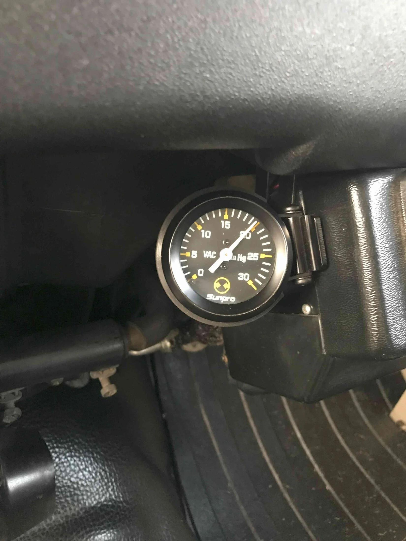

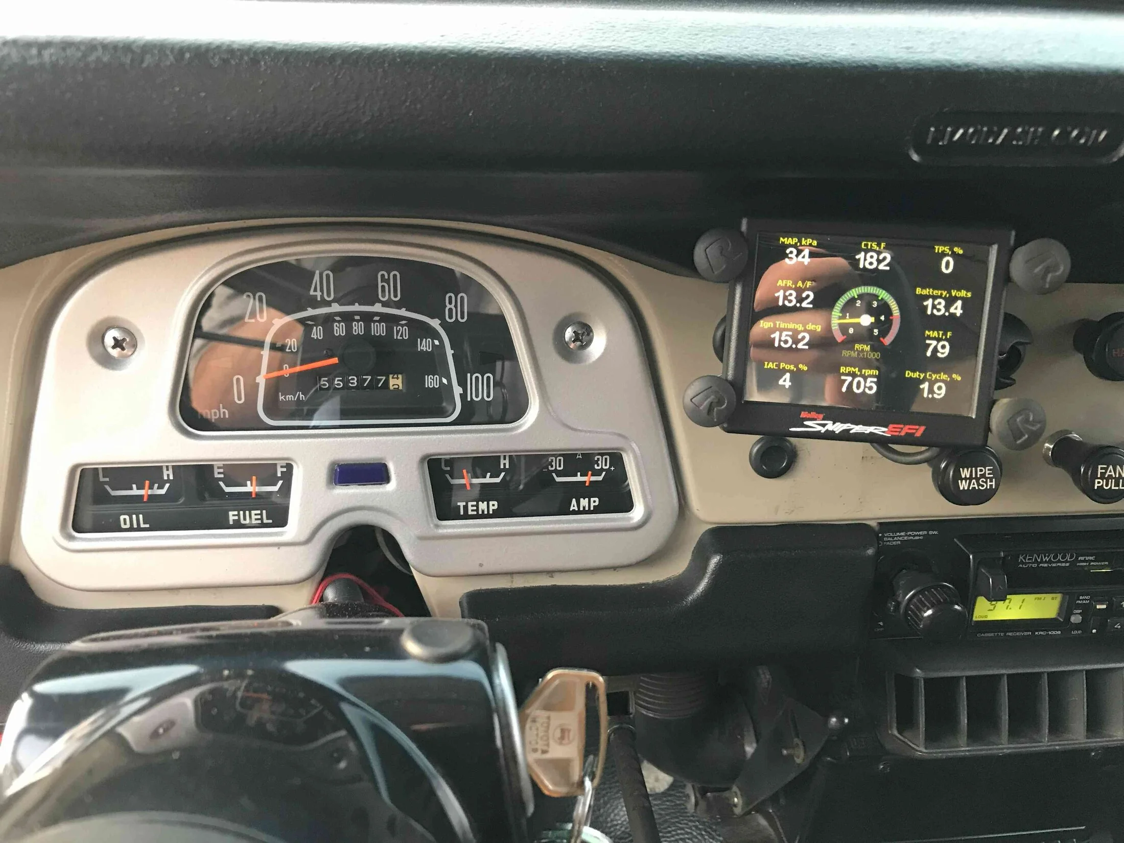

Sniper update, 5 years plus and I'm still very pleased with its performance. Here a pic after my 15 minute drive into work this morning.
The system is still pulling a good vacuum as well.
