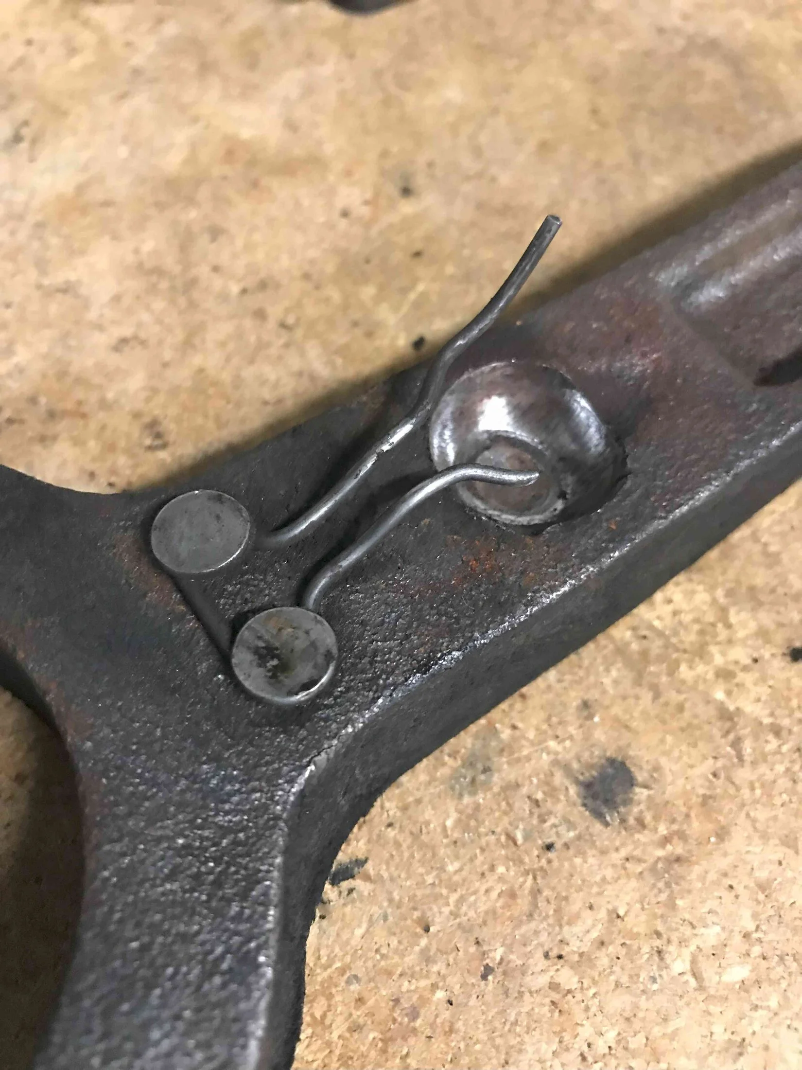

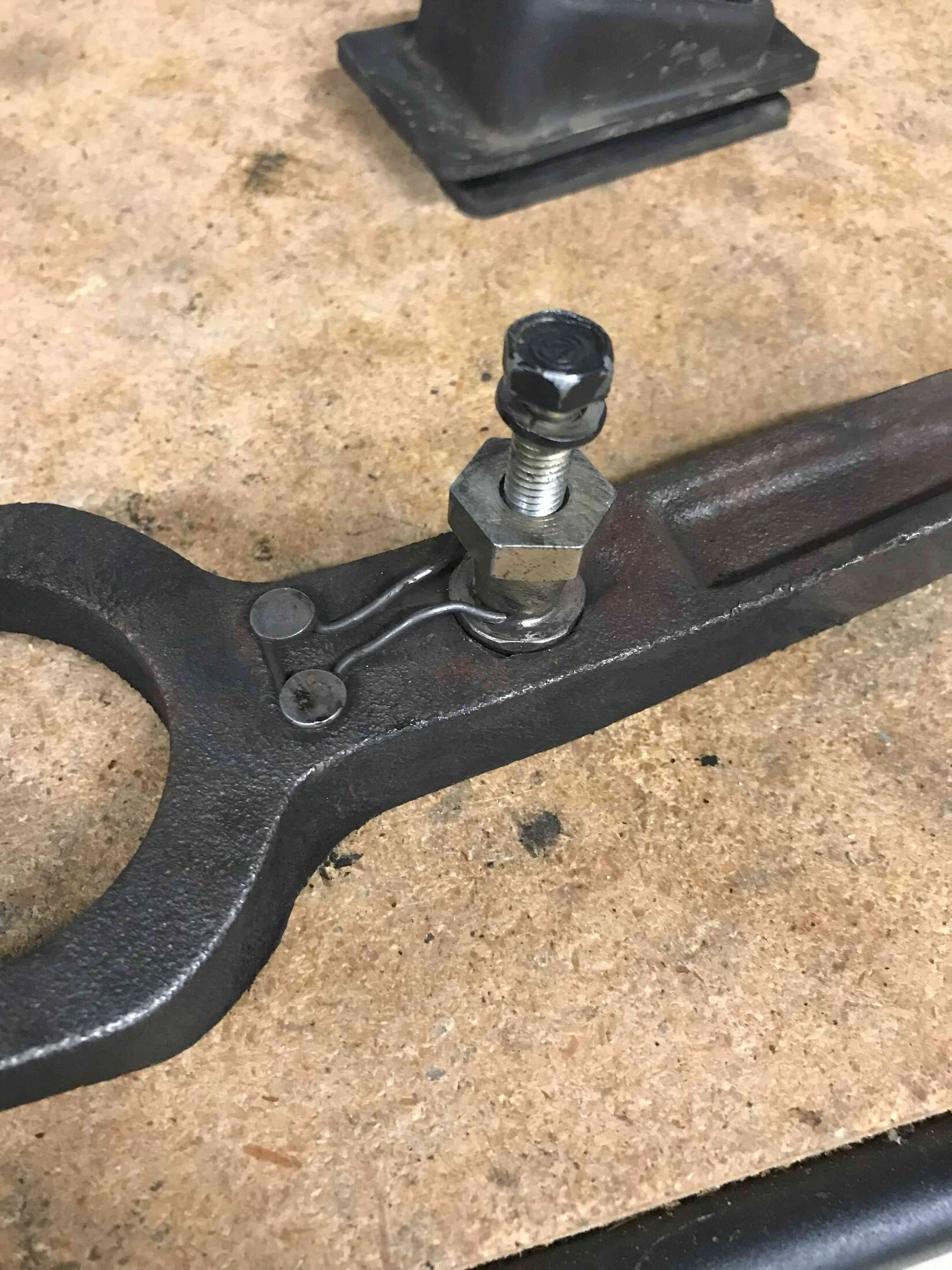

Is there anything that can be done to address the broken pivot ball spring/clip on my clutch fork?
Obviously it was still working. None the less, since I have the opportunity, I like fixing broken items.
A little bailing wire and you'll be fine.

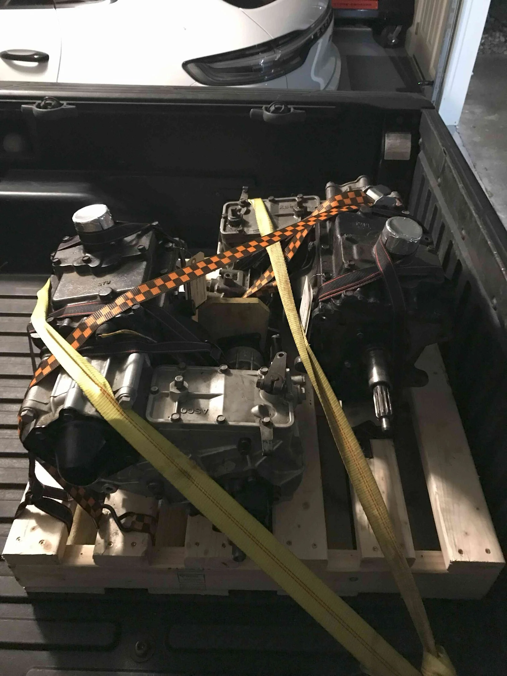

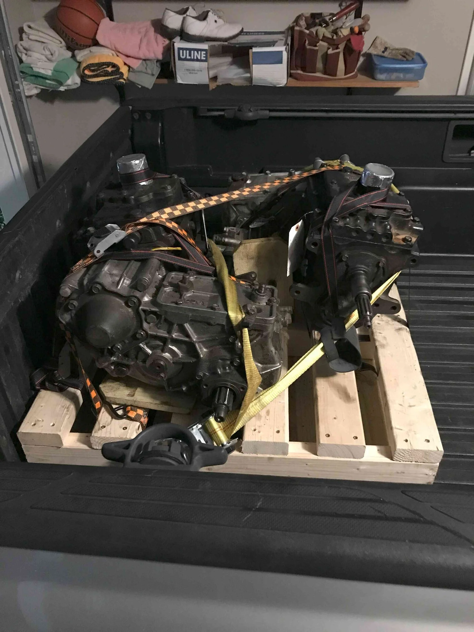

...and without too much fanfare, out it came! Being that I have two units, I'm sending them both out for experienced hands to address. So I built a pallet, will secure with a few lashing straps and they will be headed on their journey.

Drill out the pressed fittings, spin a new fittings/pins on a lathe or similar, bend a new spring and freeze the stud and press back in with spring.
OR thread the holes and use bolts with loctite so it is serviceable if it were to happen again.
Or buy a brand new one for pennies.
new fork assembly? #31204-60020
Close......31204-60030
As of this morning, their westward journey begins.....
Funny thing, showed up to the freight terminal, 70 year old lady checks me in and ask if I had a dock height transport. I told her the pallet is the back of my Tacoma. She said, "No problem, meet you out front".....she wheels around on a fork lift, snatches my pallet, applies a few tracking stickers and off it went.

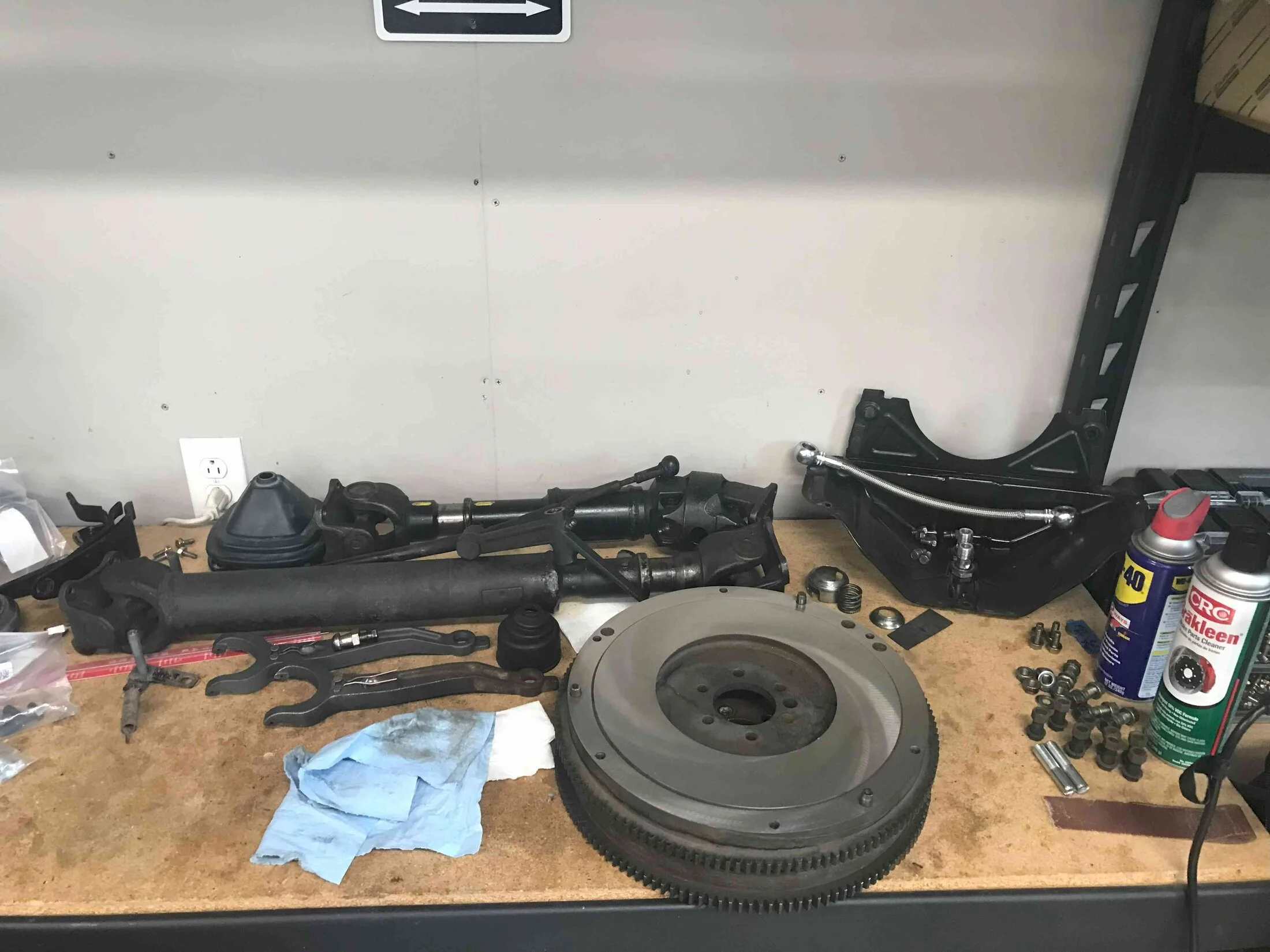

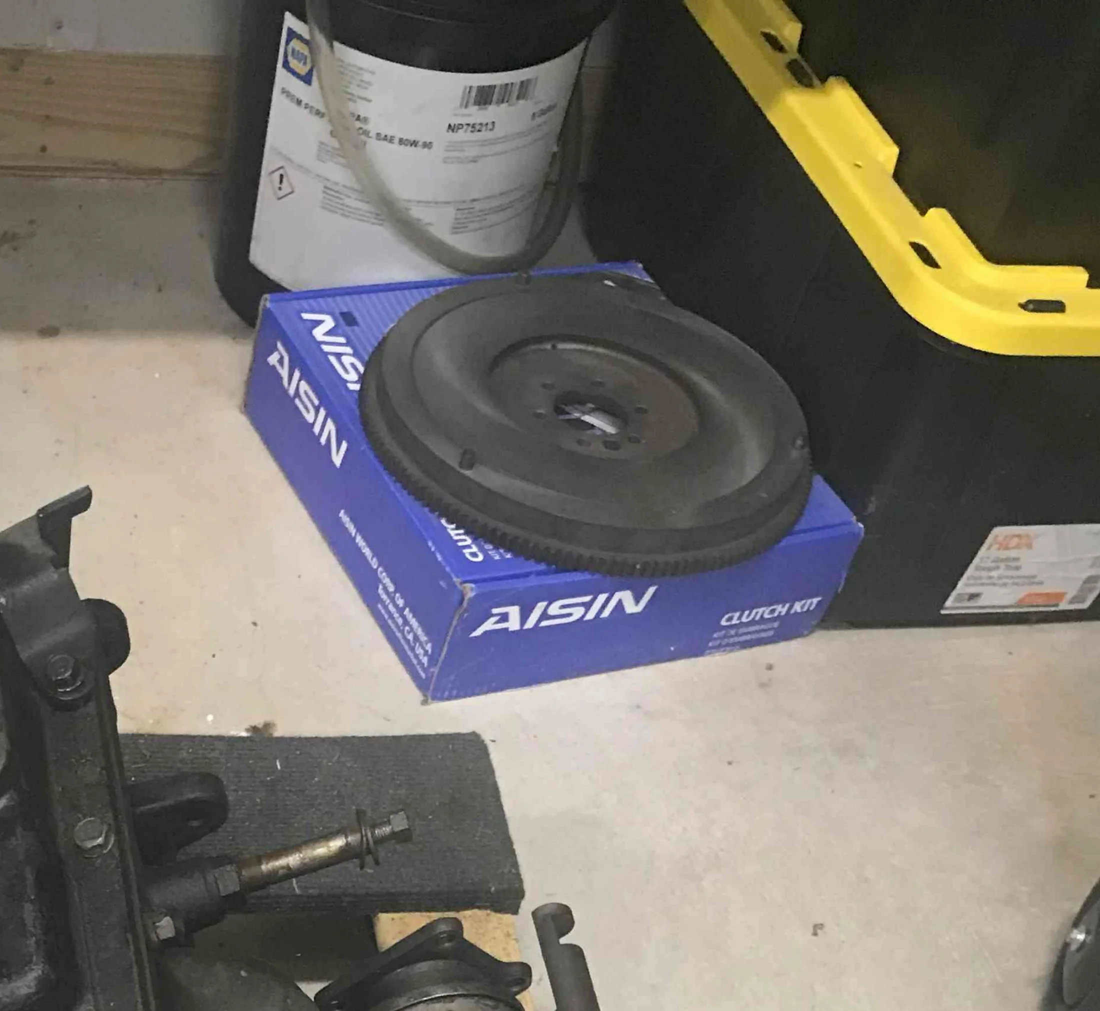

While the Tranny and T-case are in the shop getting some lovin, I'm getting some new parts together. While removed, I'll install my freshly turned flywheel, new Aisin clutch kit (CKT-032), as well as all new hardware.

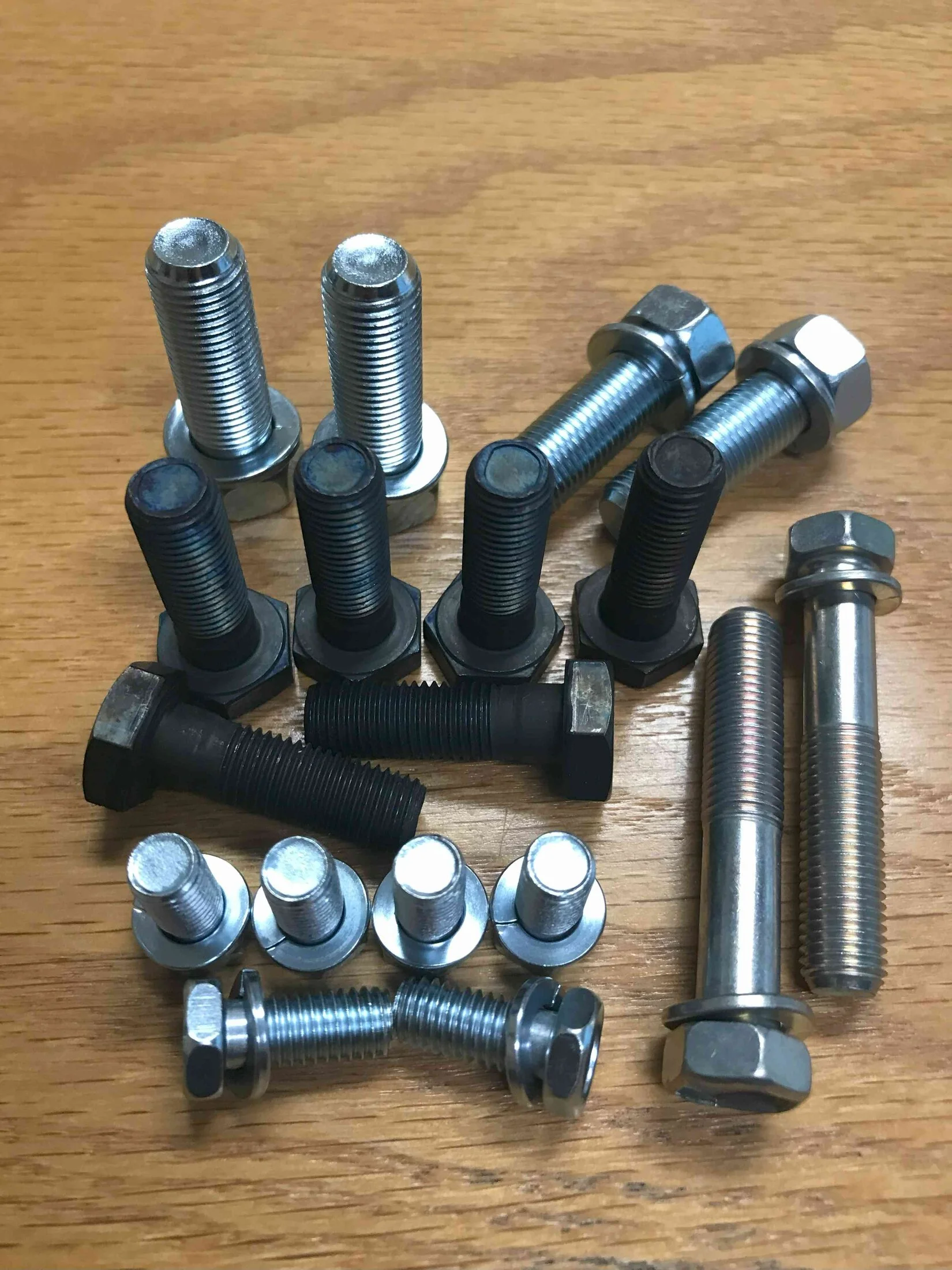

Bolt reference: 4 large top bolts are the tranny to bellhousing bolts (91619-61235), 6 black are the flywheel bolts (90913-01016)-{original part #90913-01003], 6 smaller are the clutch plate to flywheel bolts (90119-08134) and the two longer are the clutch slave return bolts (90080-11421)-[original part #91111-41055].

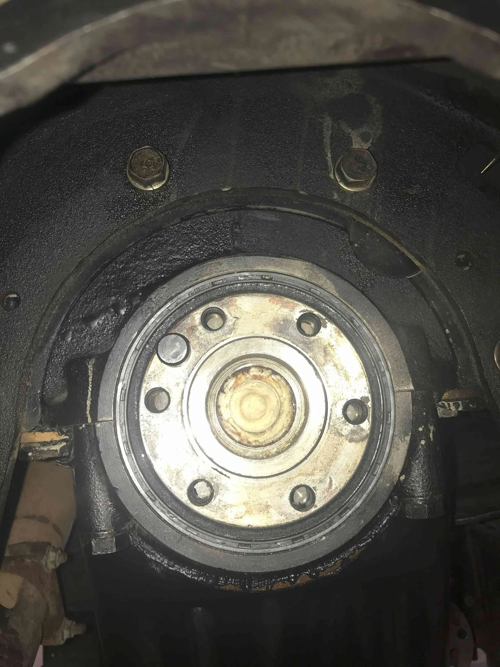

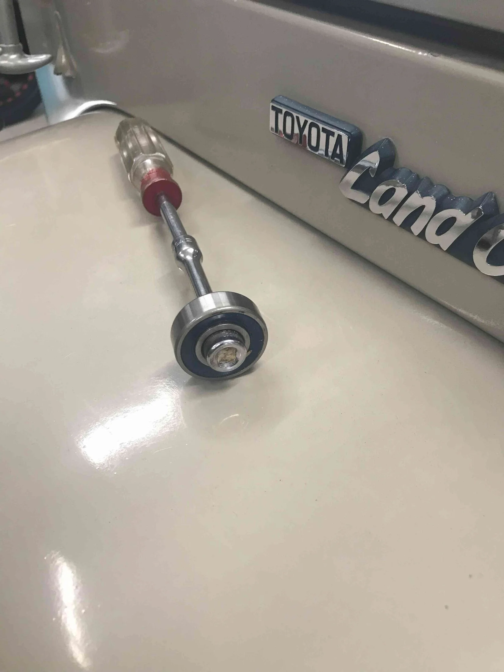

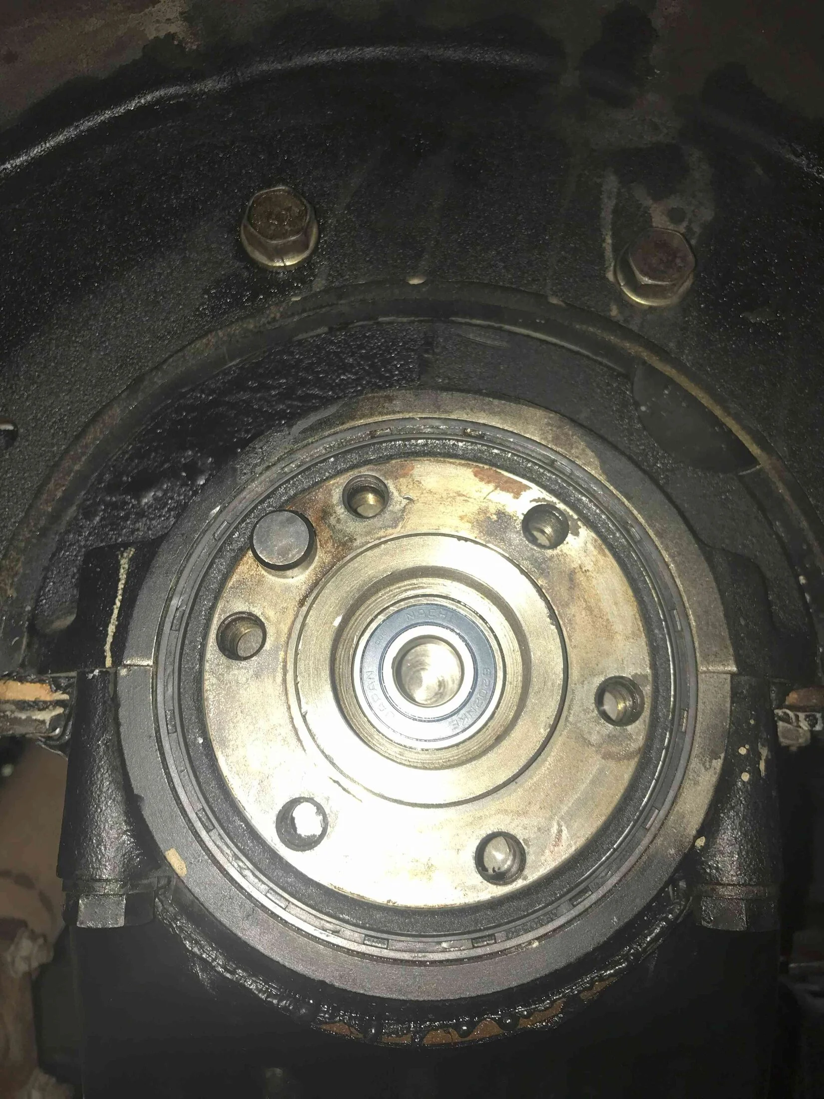

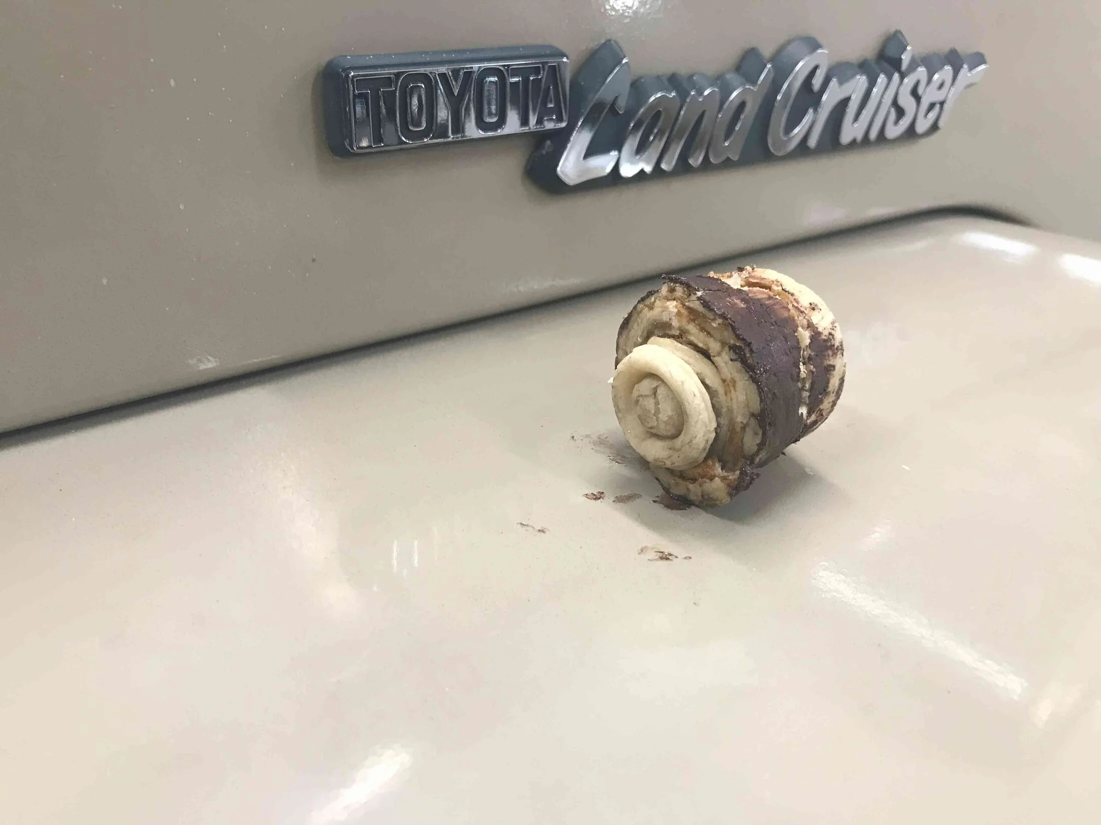

Finally removed the clutch, flywheel & pilot bearing. For the pilot bearing removal, I used the bread trick. Using a 1/4" drive 10mm socket, plus extension on the hand driver and dead-blow hammer, made for a quick process.
And for those that might want to know...it took a slice and a half of Sunbeam bread. Here are those two pieces once removed from the rear of the crank.

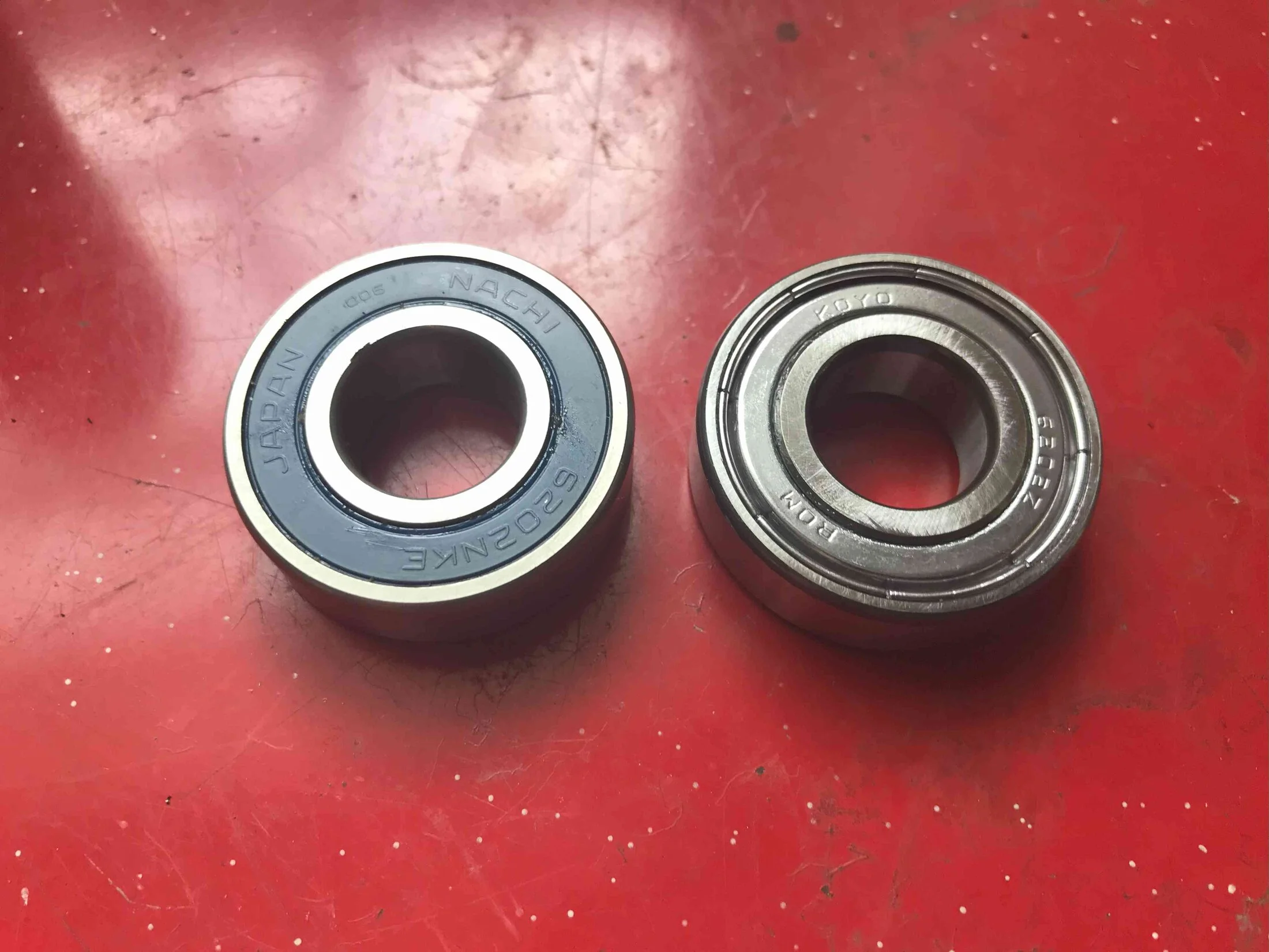

After posting my pilot bearing info, it got me to thinking. My Aisin Clutch Kit CKT-032 came with the Koyo 6202Z bearing. But looking into pilot bearings, maybe I should get the #90363-15004 bearing which is the Nachi 6202NKE bearing.
Koyo makes good bearings and based on the numbers both are the same size. Why do you believe you need the other bearing?
I'm not sure if one is better than the other....but obviously they seal themself two different ways, hence wondering if one was better than the other.
You know, being an architect with an Engineering degree, I'm probably just over thinking it.

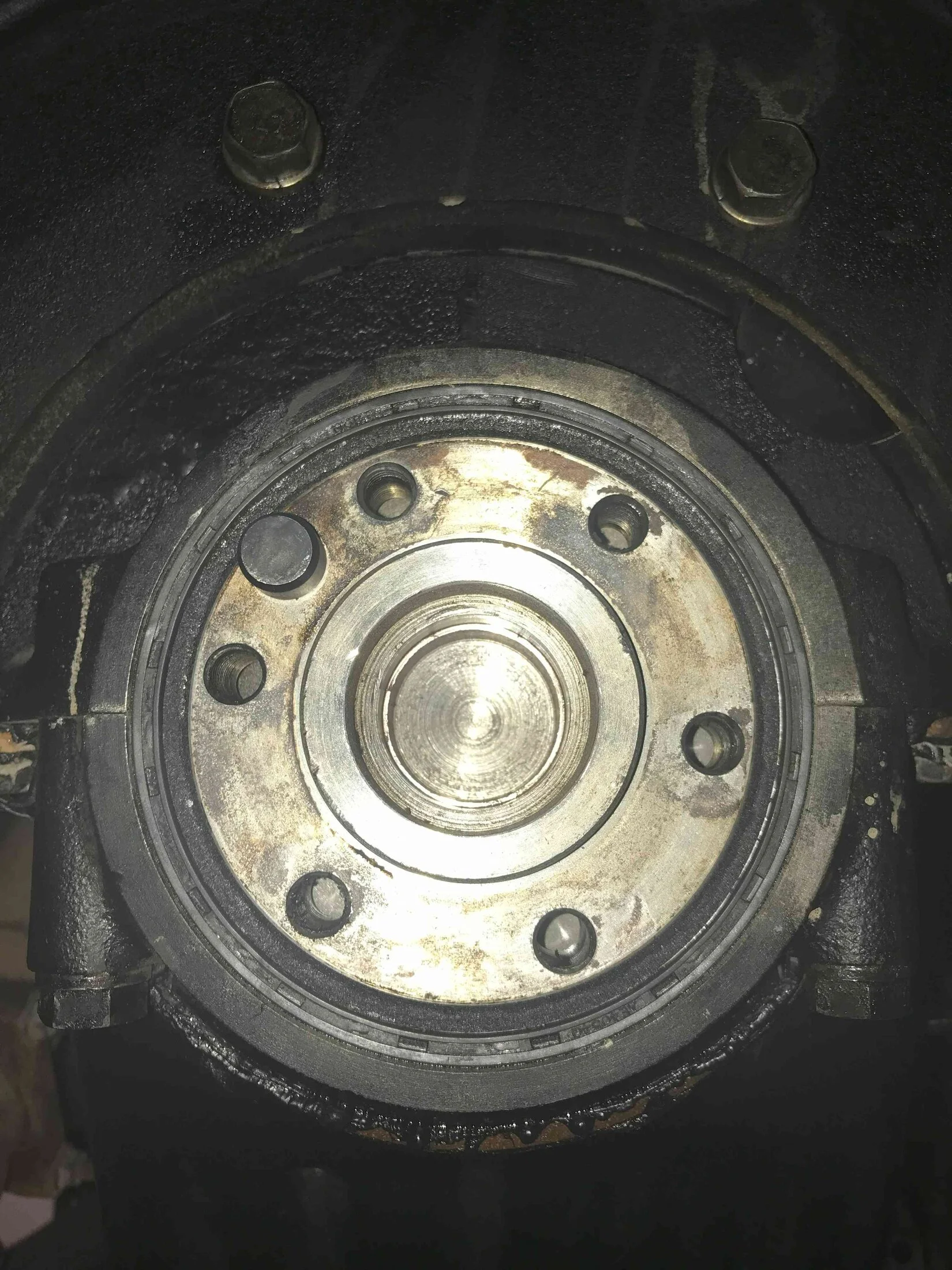

View attachment 3793430..View attachment 3793431..View attachment 3793433

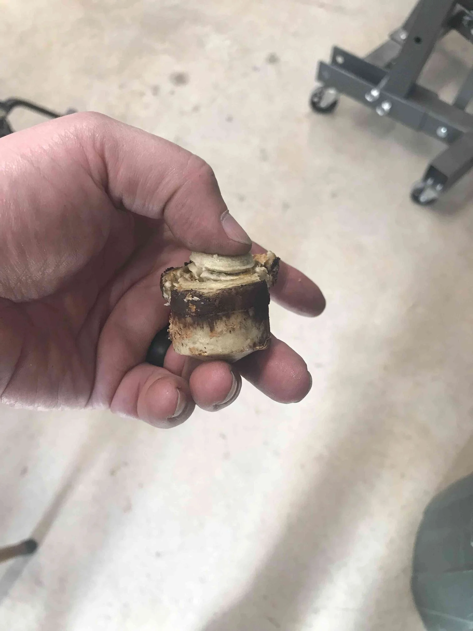

View attachment 3793434..View attachment 3793435
Whole wheat or white?
