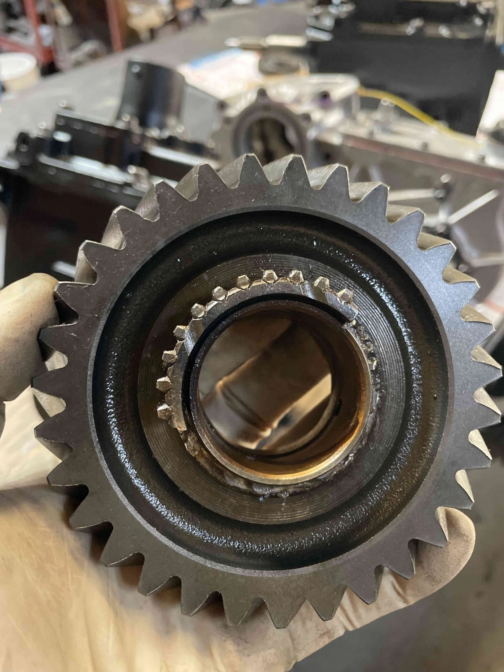

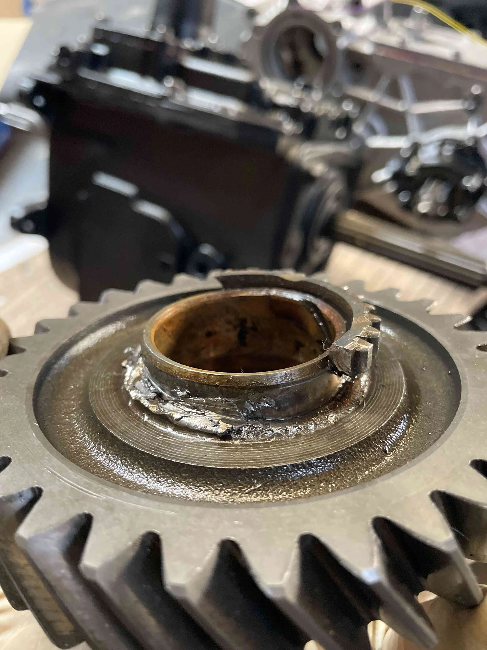

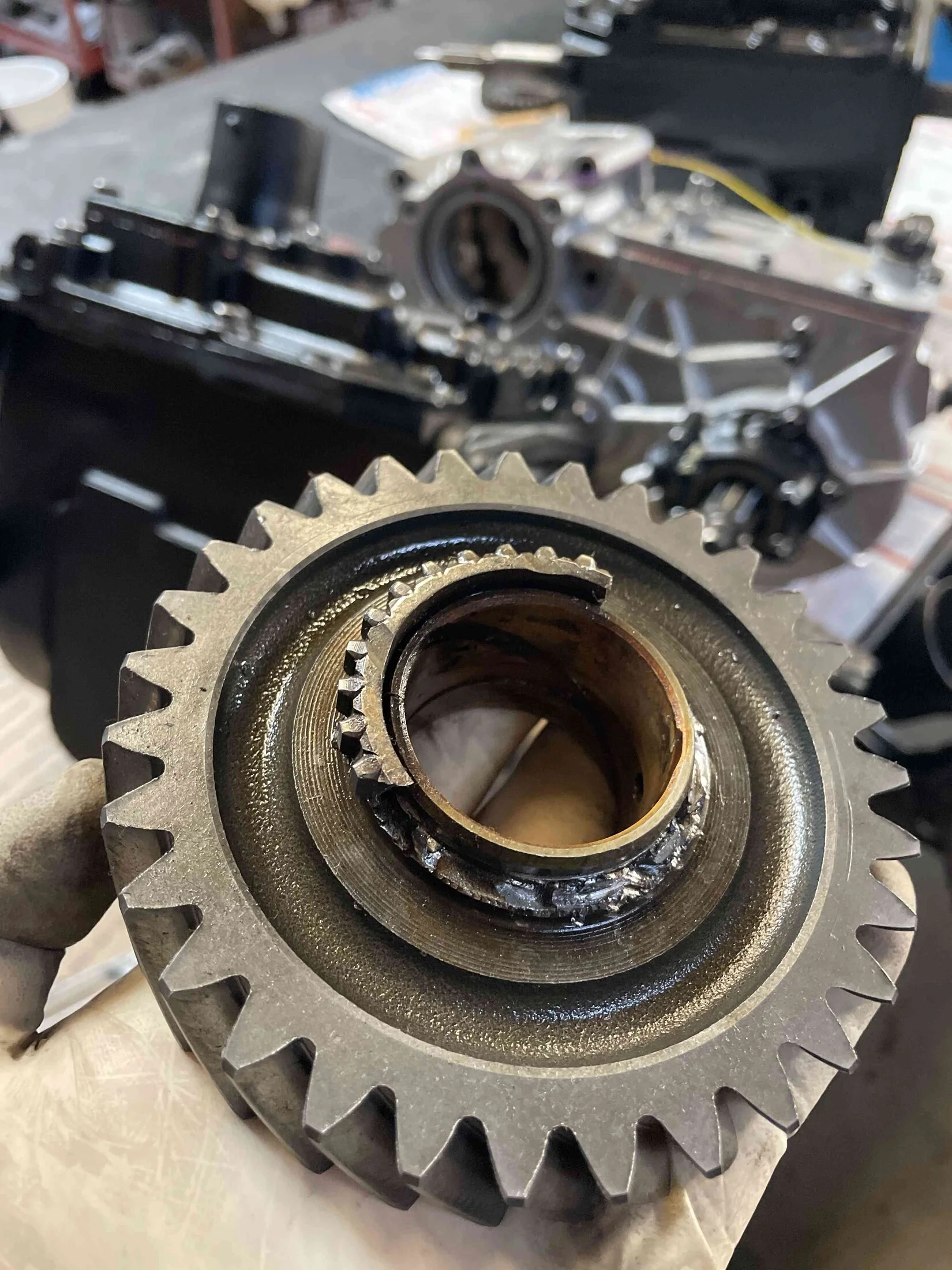

Yep, the Transfer case was hiding some issues....
Does the transfer case-assembly appear repairable, from this point in the tear-down?

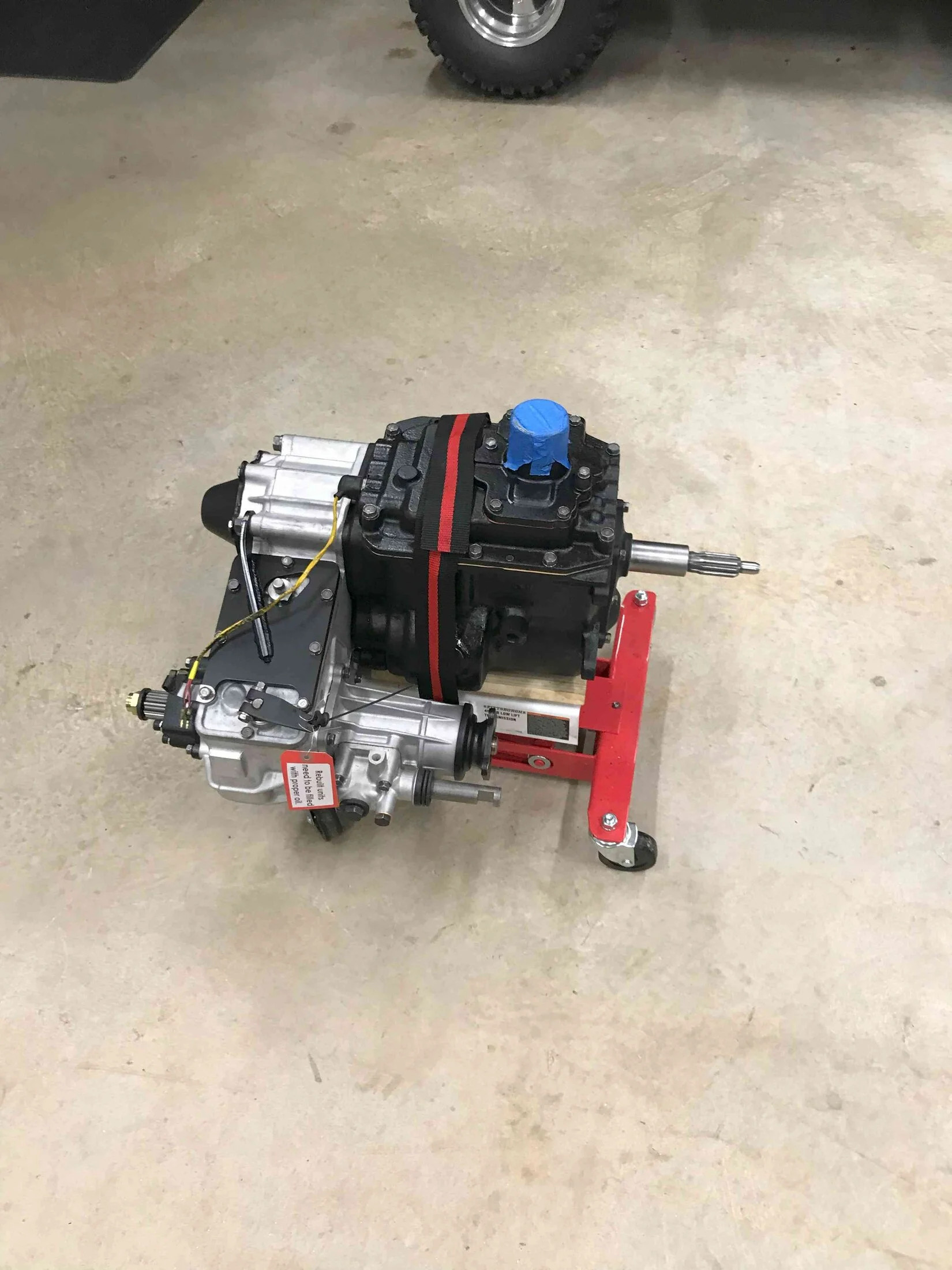

Yep, @orangefj45 is putting it back together, albeit with new parts. I guess it explains the heavy shaving on both the fill & drain plugs, eh. That '76 unit will go on the shelf as the back-up.

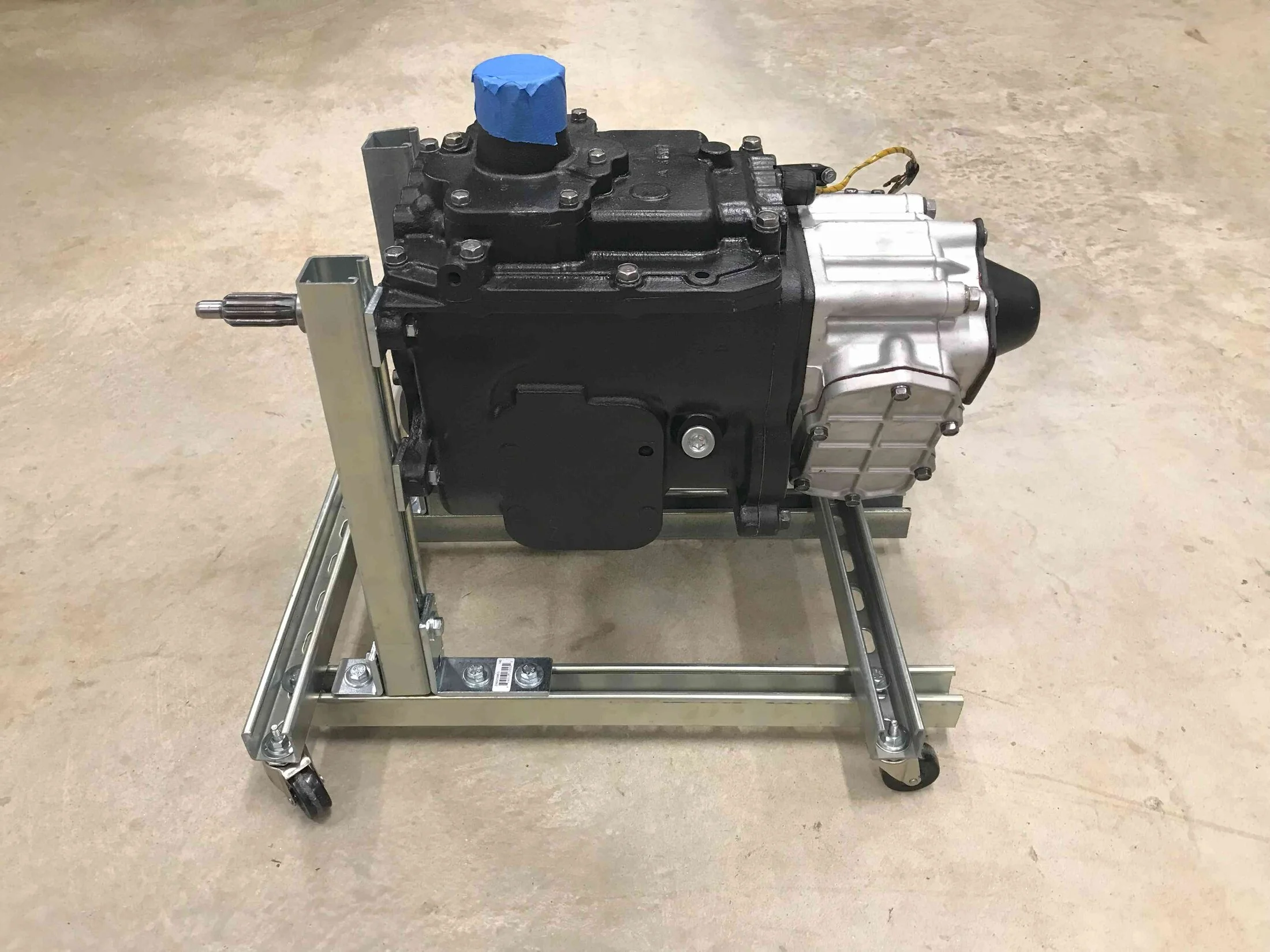

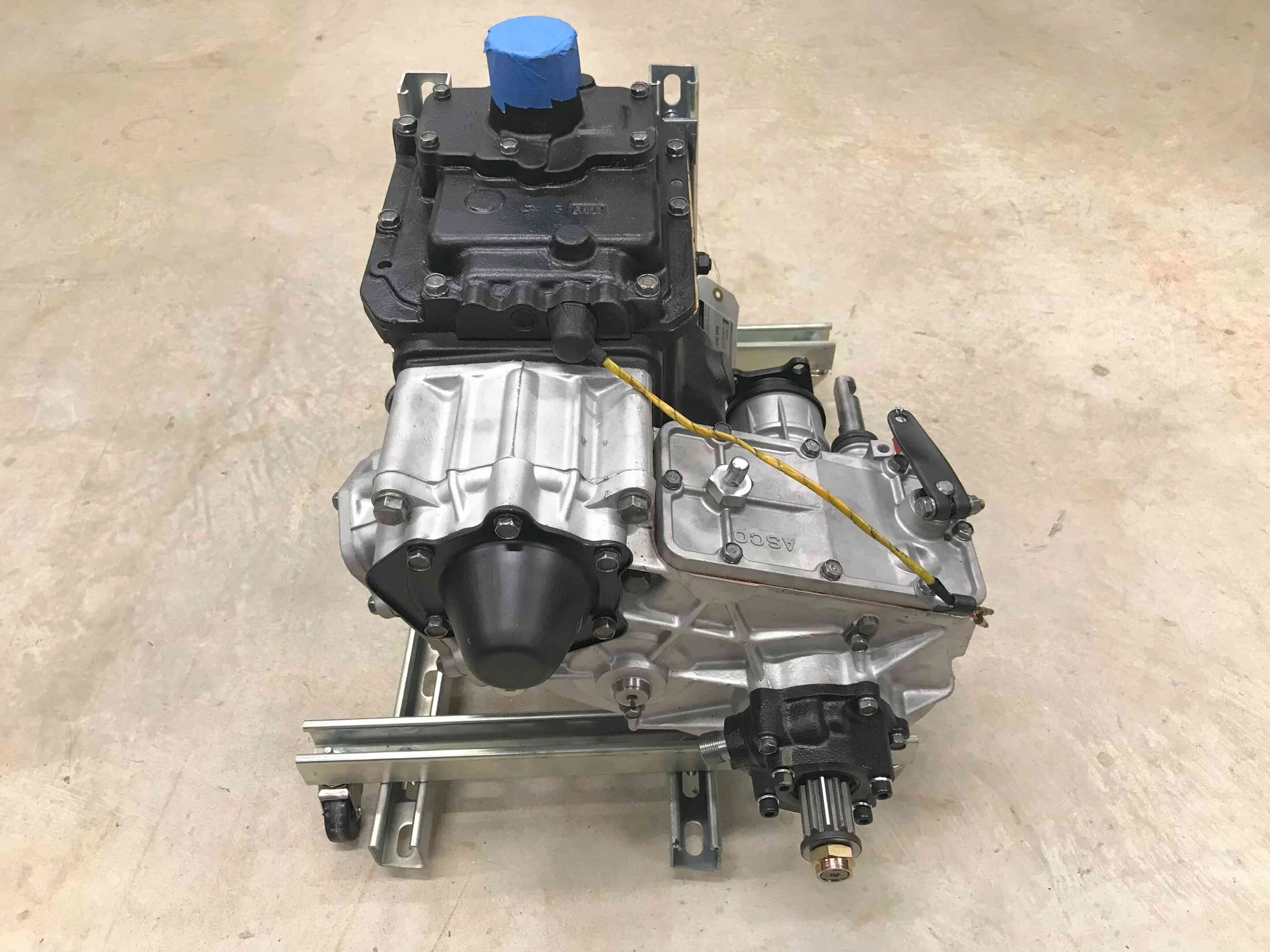

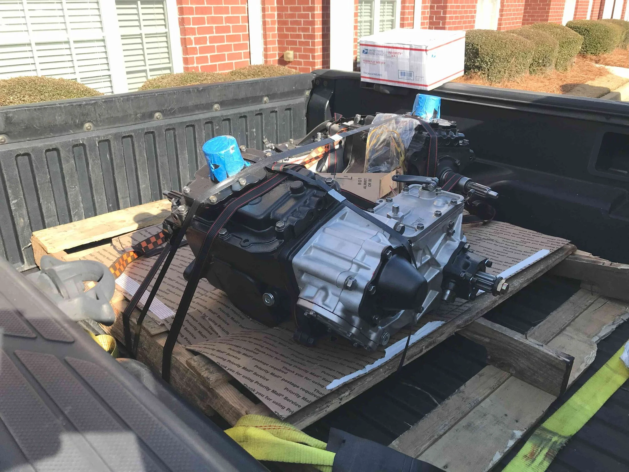

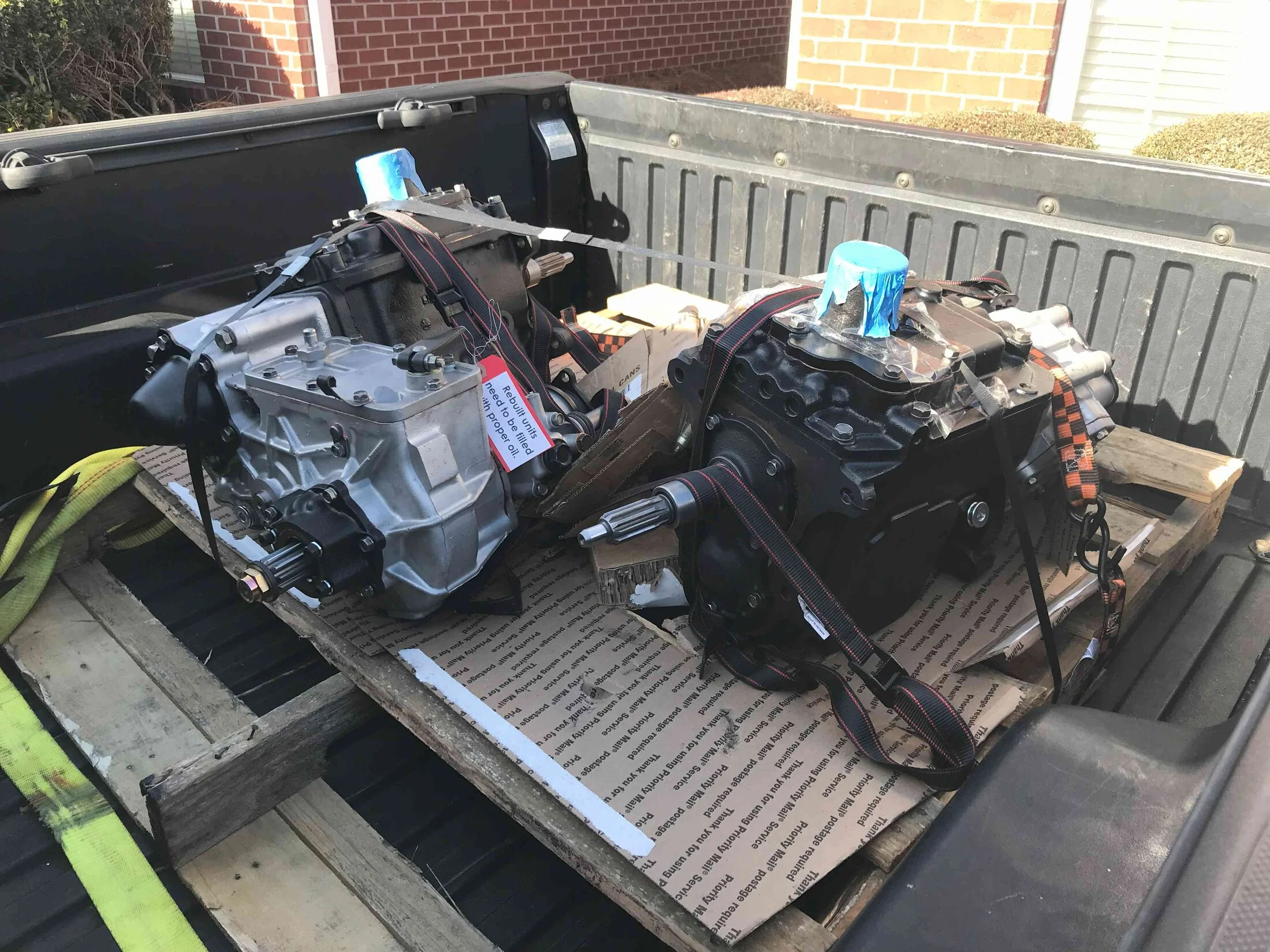

Fortunately Georg only had to refresh the '77 transmission and transfer case, so that one will get installed with they return.

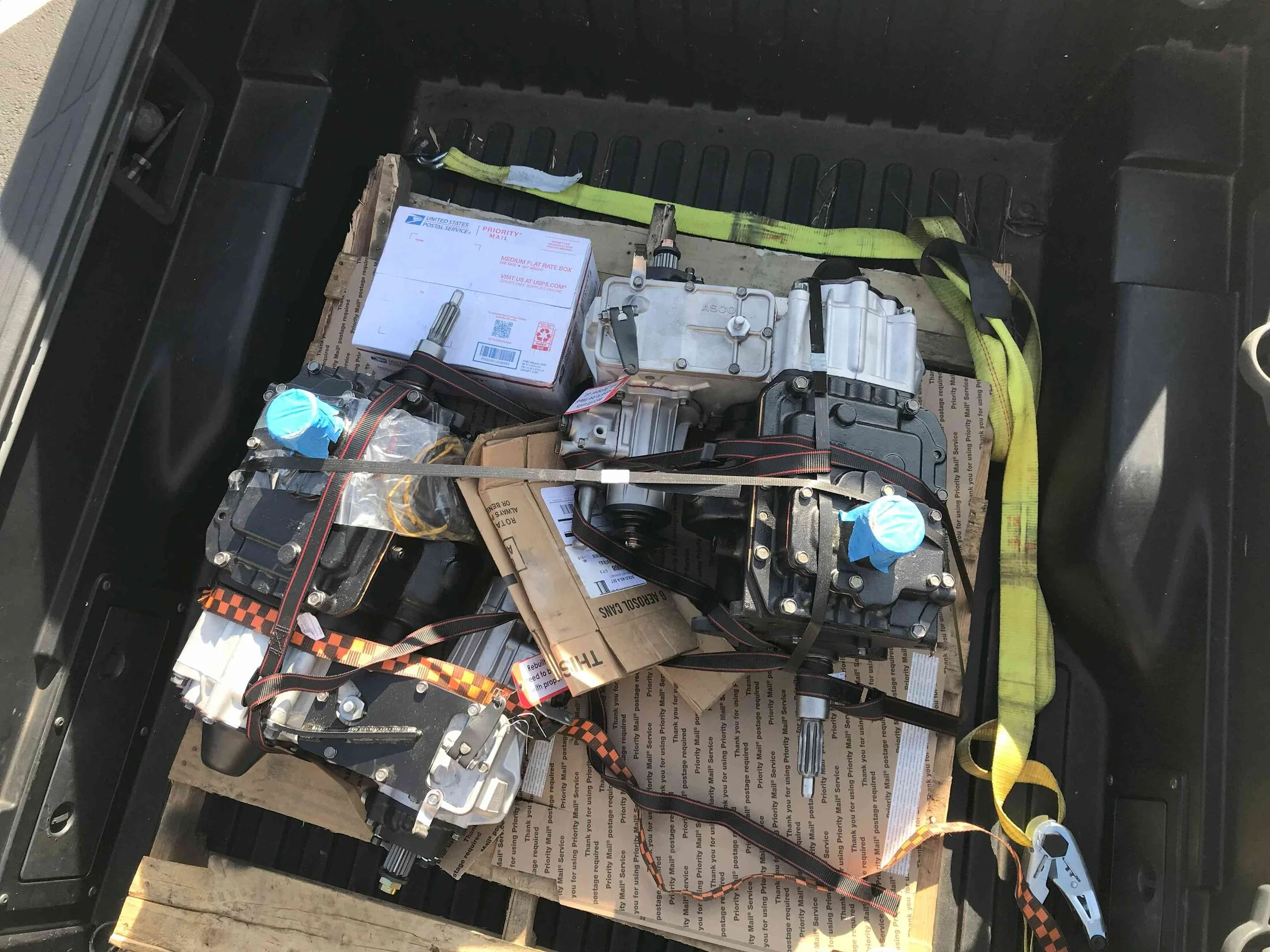

Thanks to @orangefj45 both my transmission & transfer case units have arrived back to Georgia, looking all kinds of gooder!!!!
Let's just hope I can reverse the removal process, and install without any left over parts and pieces. :hillbilly:

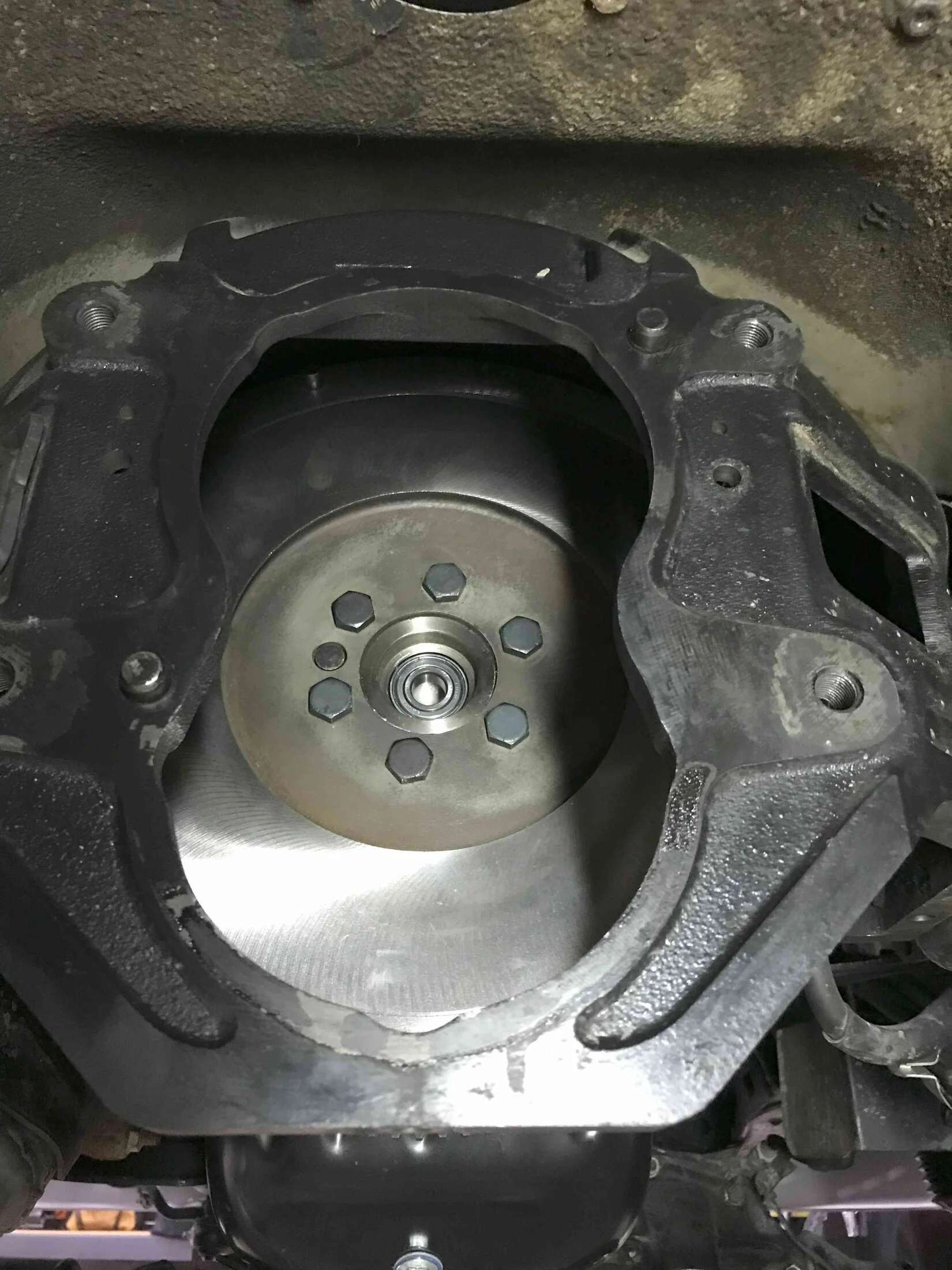

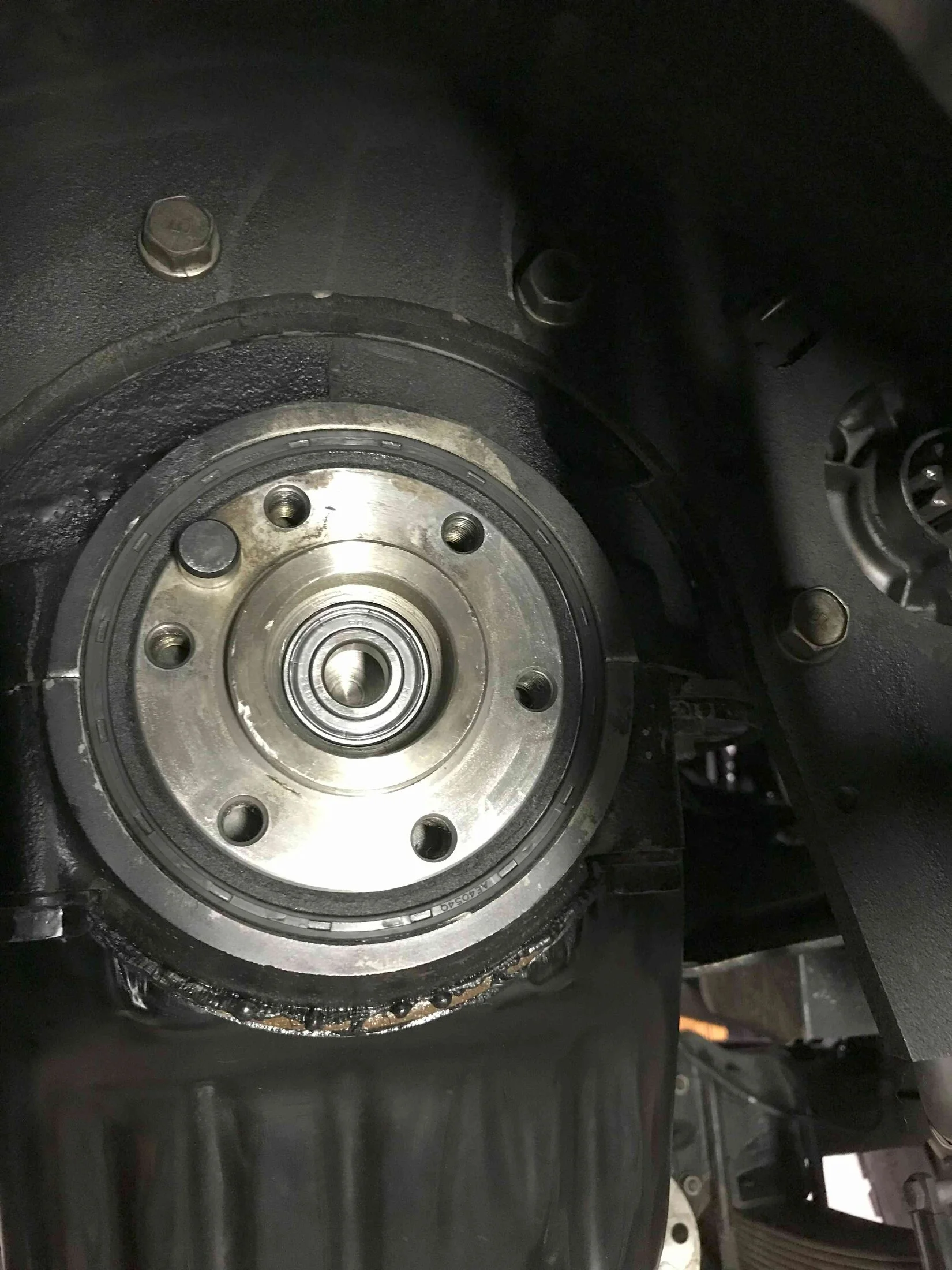

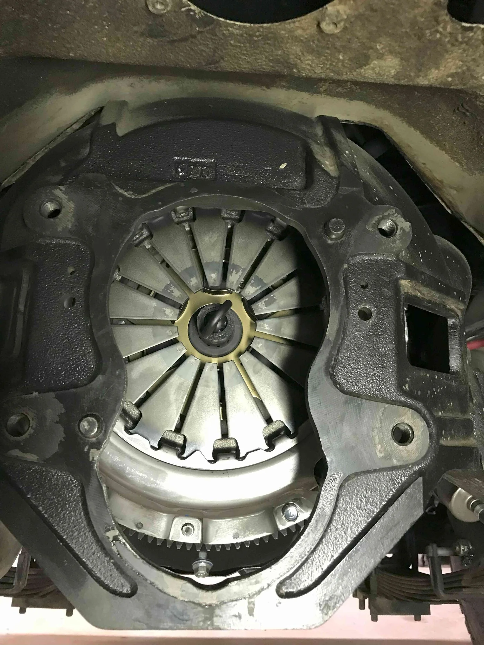

Alright, started the install last night. New pilot bearing:

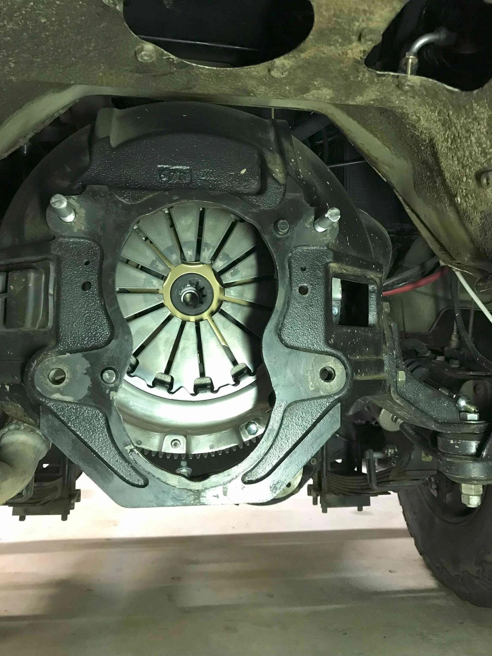

...resurfaced flywheel with new bolts & thread sealant torqued to 60 ft/lbs, cleaned with break cleaner:
....new Aisin clutch pack with new bolts & thread locker torqued to 20 ft/lbs:

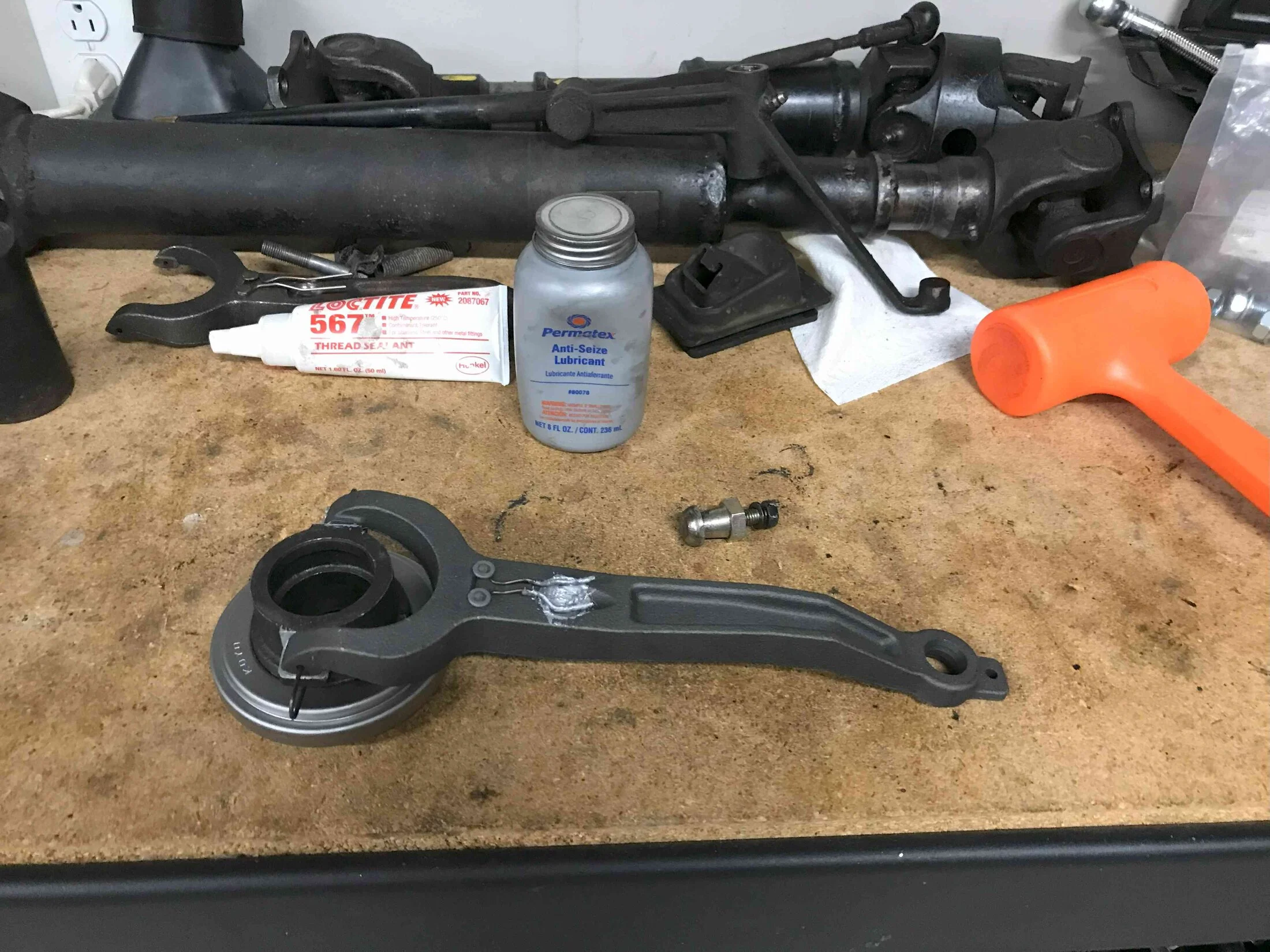

...new clutch arm, pins, and pressed on throw out bearing....ready to be installed today:
...eager to get this stabbed:

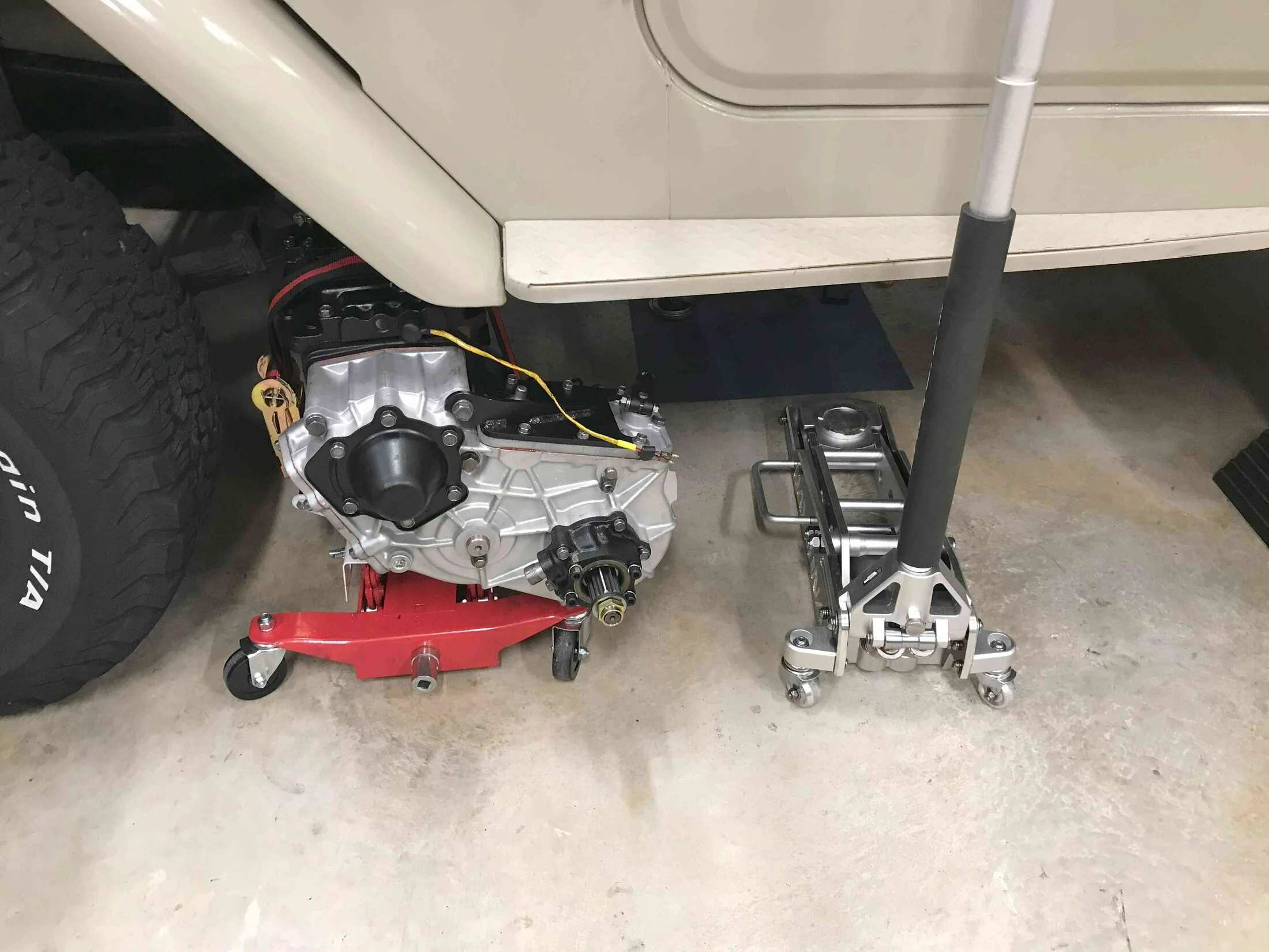

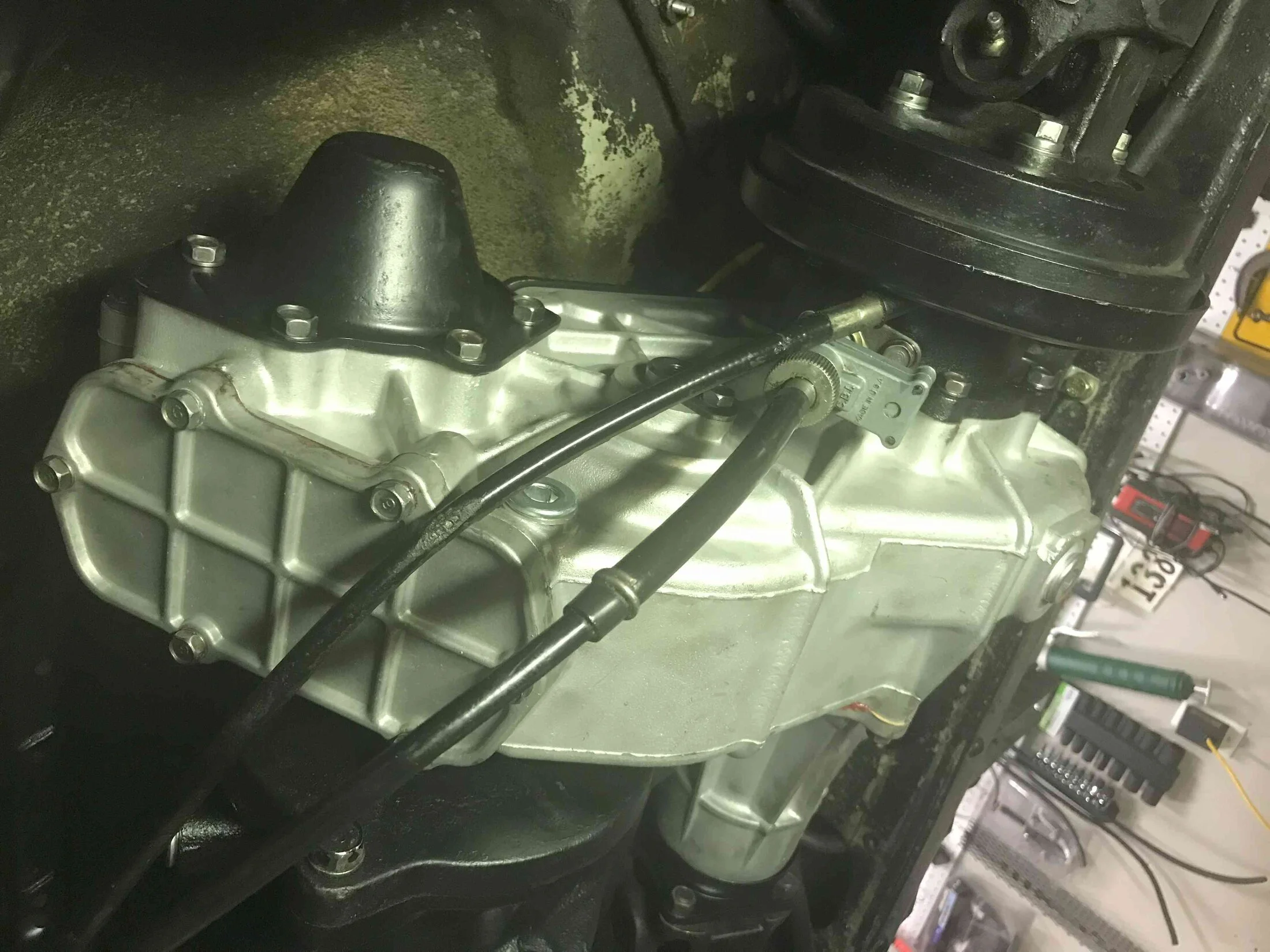

Alright, I had to phone a friend.....a friend with a lift and a better tranny jack. None the less, my 40 is back in action.
A Huge 'Thank You!' goes to @orangefj45 for his craftsmanship! Let me just say, I can not believe how quiet a properly built Transmission could be!!!! Goodness sakes, what a difference in feedback from the rebuilt unit.

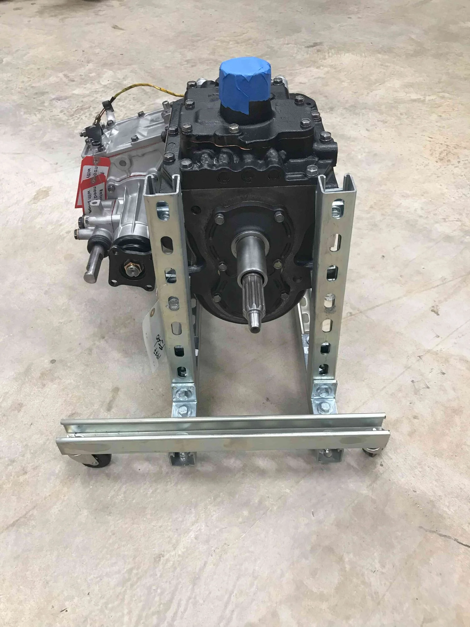

As always, first class. Add a rattle can cover over the taped shifter cane hole. Better water tight option than tape
Well, if you’ve gone this far bolt on an engine and axles… an entire spare vehicle on a stand!
Great ideas for this heavy combination storage..
