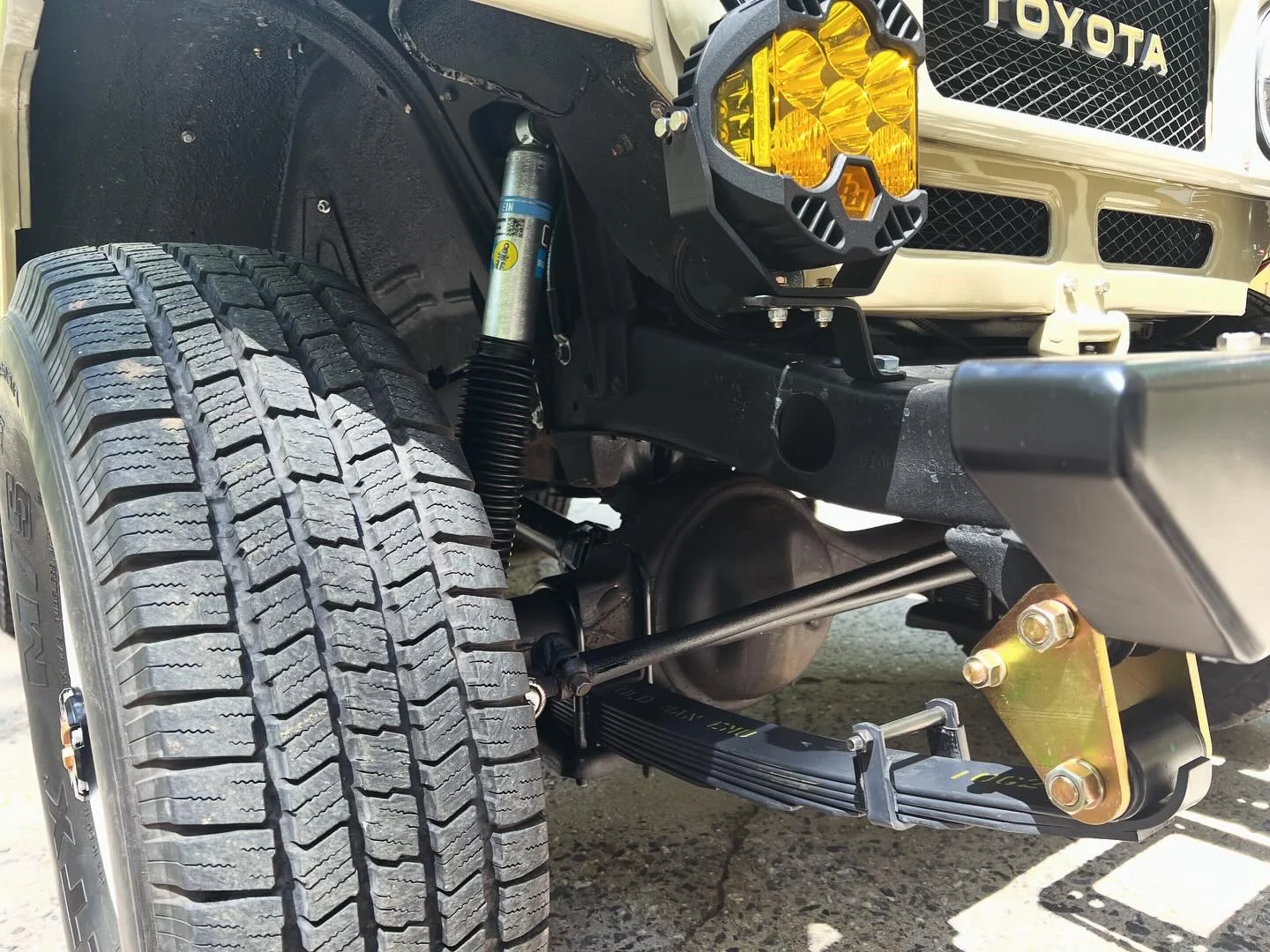

Driving observations once you have had time. My OME suspension is like a tractor. But ofc, we are basically driving tractors. 😂
Alright....I've put a few hundred miles on the Bilstein shocks now and let the 'confirmation bias' wear off. I can't really find the right words to describe the difference. The best I can come up with, they are much more of a supple ride than the OME shocks were. This was noticeable from the get-go! If they get better with mileage, it is an even more of a WIN!
I’m only in about 25 or 30 miles so far and really enjoying them. And I’m comparing this with the cheaper yellow Bilsteins that came on the rig when I bought it. But it’s a massive difference, especially getting into steep driveways, over rolling speed bumps, and even a quick trailer or two.
I am glad to hear this because my 40, the tractor that it is, drives like a "tractor". If Bilstein's would improve the ride I am all in. If I could only solve the wondering PS issue!
Added them too! Massive upgrade.

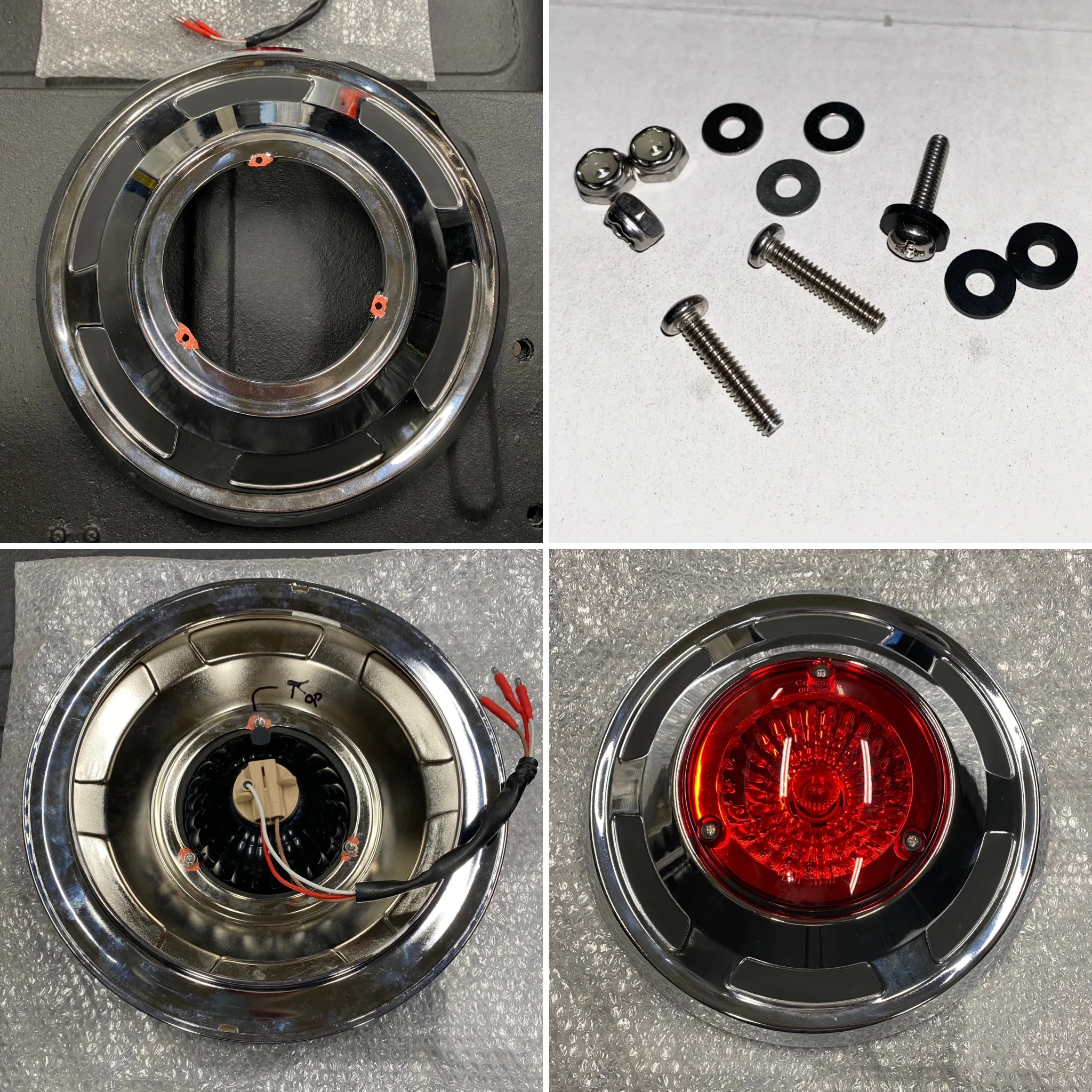

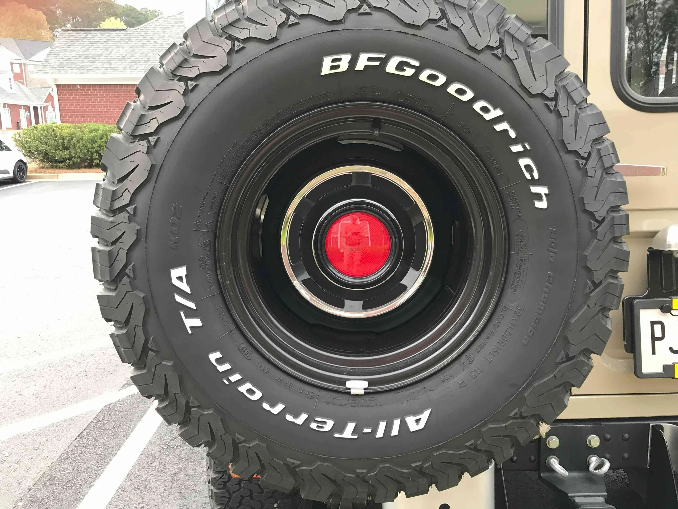

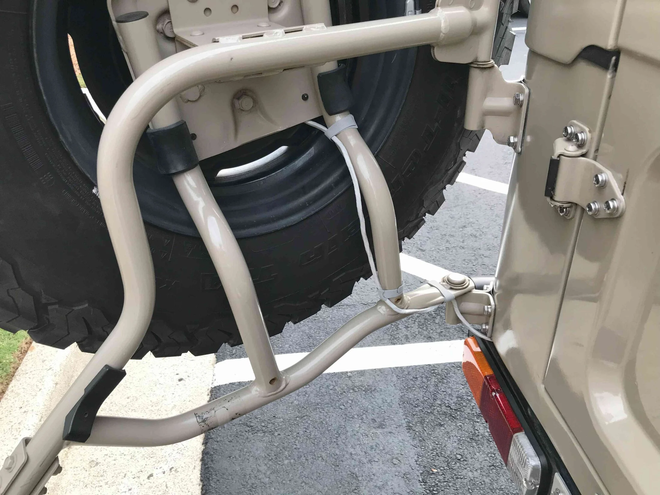

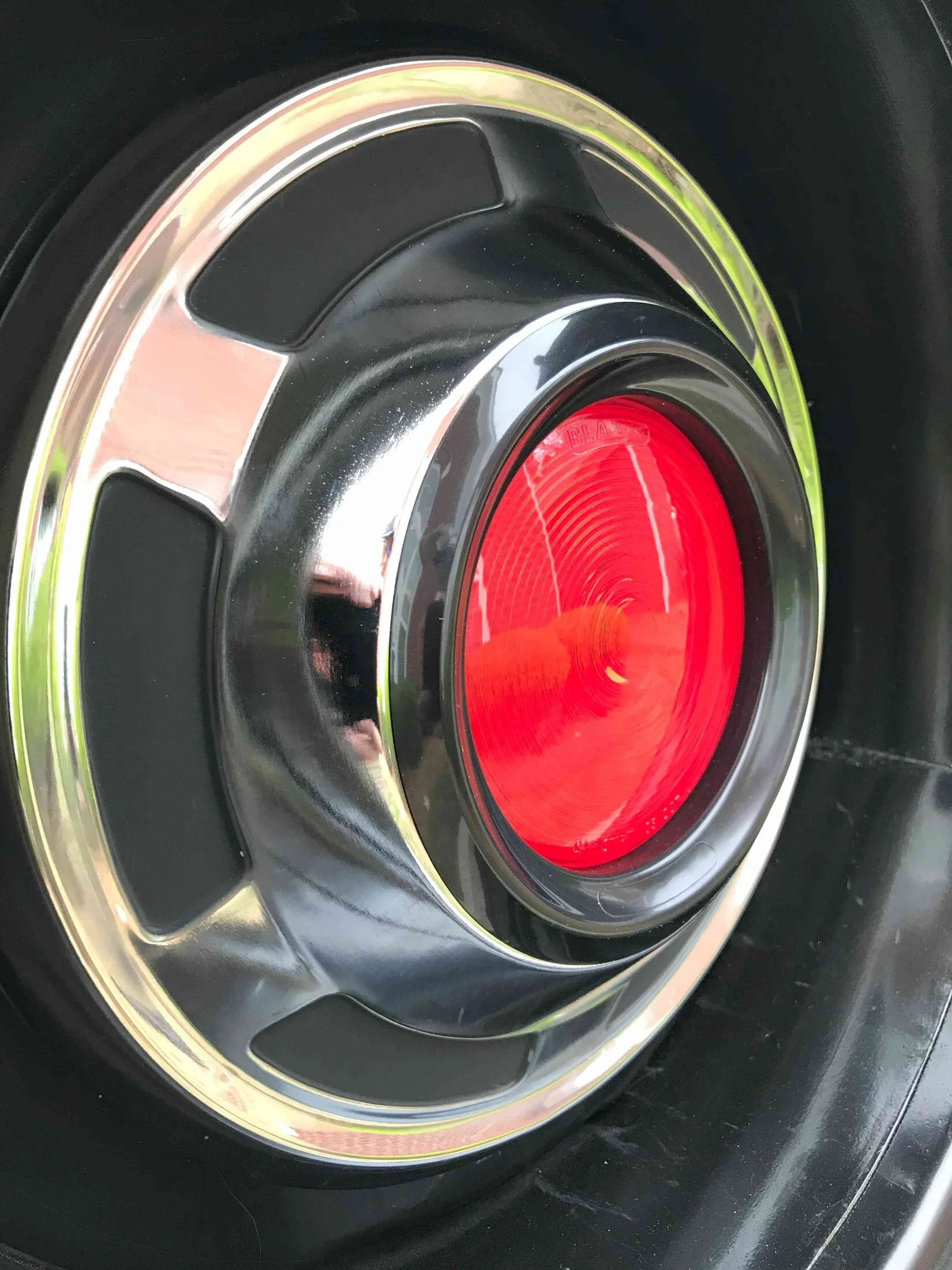

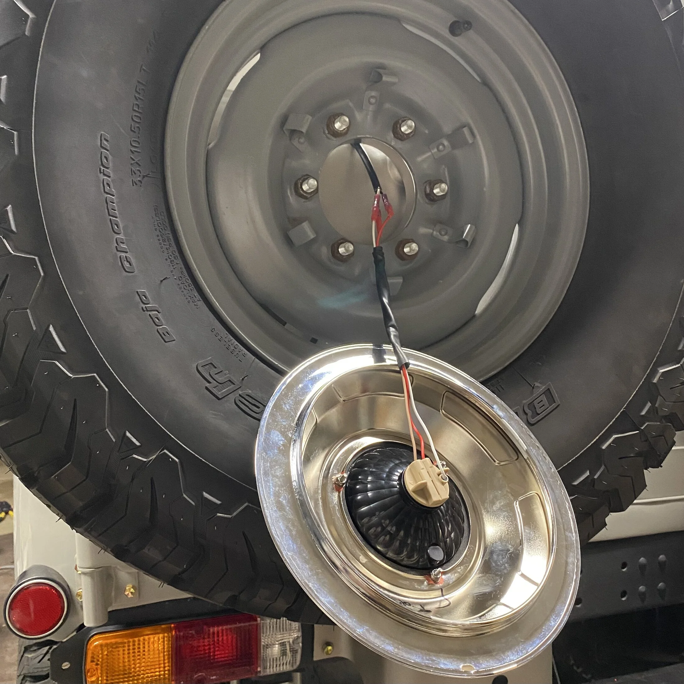

Taking a que from @Aloha Jen a few months ago - I stopped by Autozone yesterday and picked up a Blazer International B95 4" stop/turn/tail light kit. Being that I wired a trailer plug into my rear harness, this was a very simple 3rd Bake Light addition. I have a few extra hubcaps (front & rear), so I used one of the fronts, and inserted the light from backside of the hubcap. I'd say it sealed up good. Next was to wire in a simple harness from the new light to the trailer plug, but making sure I can swing the tire open. And here is the result.

Awesome. I hadn’t seen her post but was considering the same addition when I get another hubcap on the spare. Was picturing a smoked light that also has reverse LEDs incorporated.
Maybe wire one of those obnoxious strobe units to it for extra attention

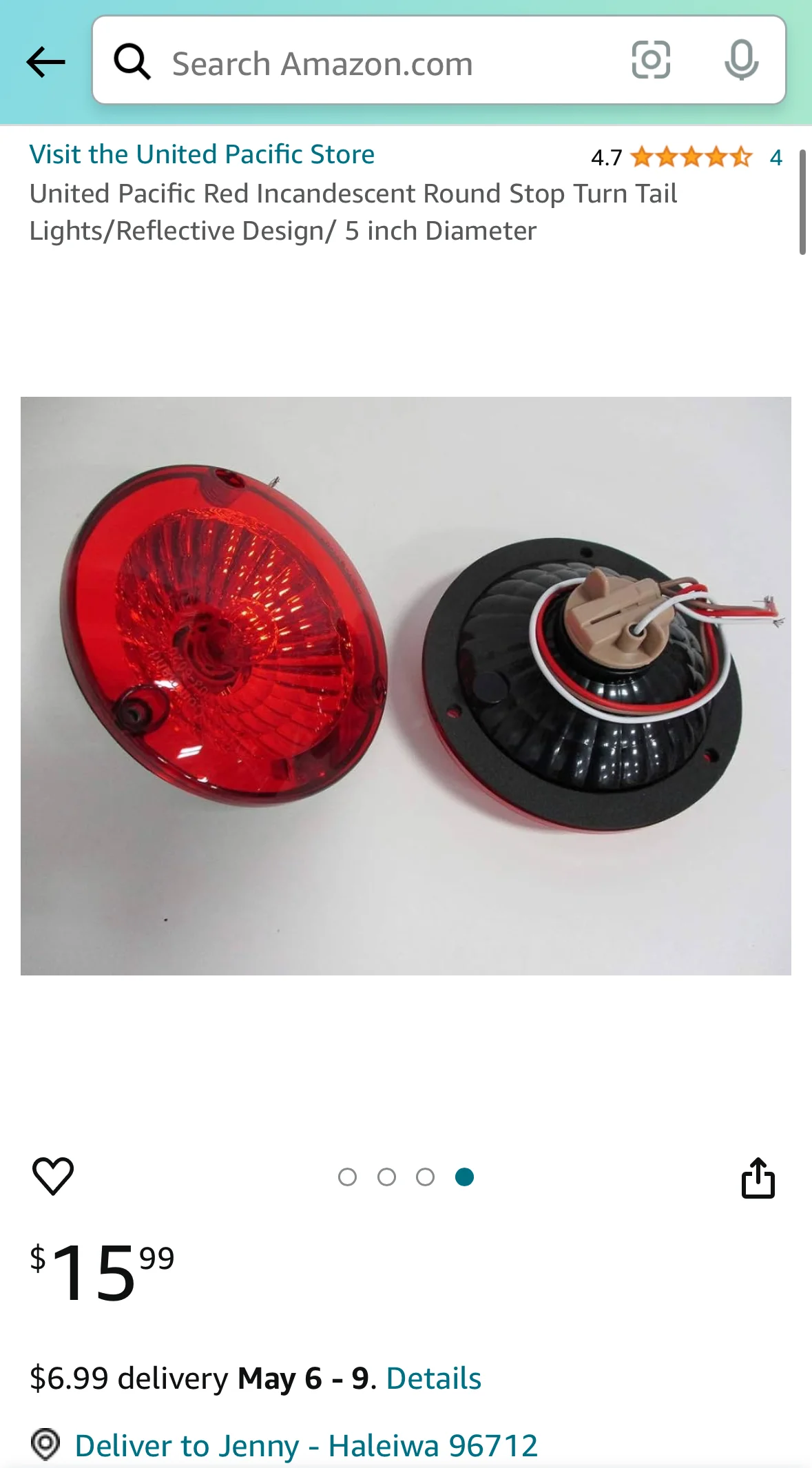

Is that an LED or Incandescent?
Me, Mr Cheap'O - I'm using the $13 Incandescent..... :hillbilly:

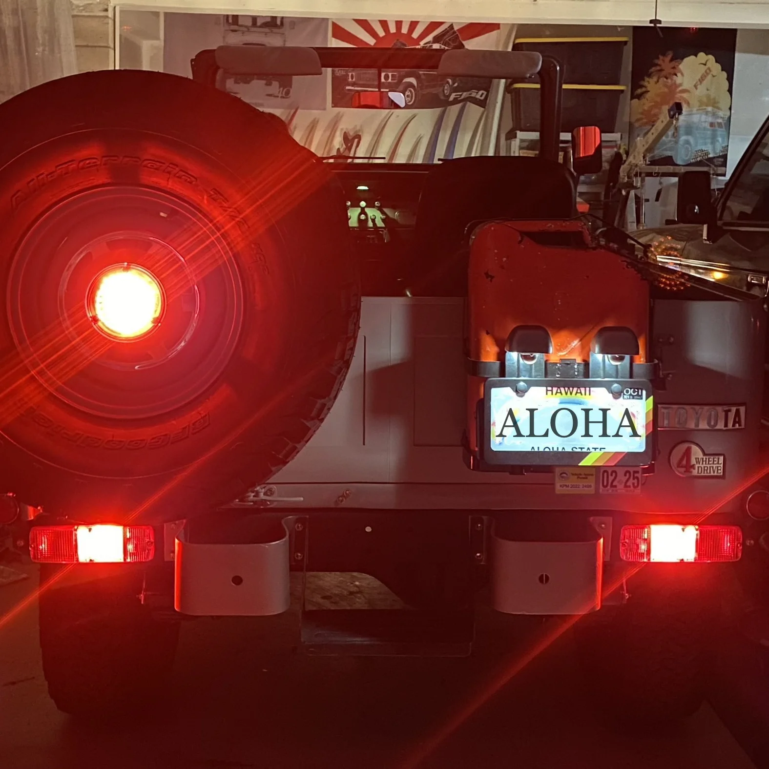

I'll say this. I had my wife stand behind my rig last night to let me know if they were working. With the running lights on, no big deal with brightness, but with the brake depressed, it about blinded her.
Also, an installation note. The light & rubber gasket wasn't installed from the front. The lip on the light is a little wider than the opening of the hubcap, and doesn't fit. Hence me installing it from the backside of the hubcap.
These are the ones I used, very inexpensive on Amazon and they are sealed very well. The seem to be fairly good quality and have a retro like feel to that that goes with my incandescent taillights.
The 5inch size seems to be perfect for sitting right on top of the OEM open hubcap and comes with rubber gasket.
They are very bright when you brake, people will definitely see you stop in front of them!

Bilstein shock update.....GREAT upgrade from the OME units, and should have changed them out sooner!

The Bilstein units I installed were the 33-062518 & 33-185606, with the recommendation from this thread < click here >.
