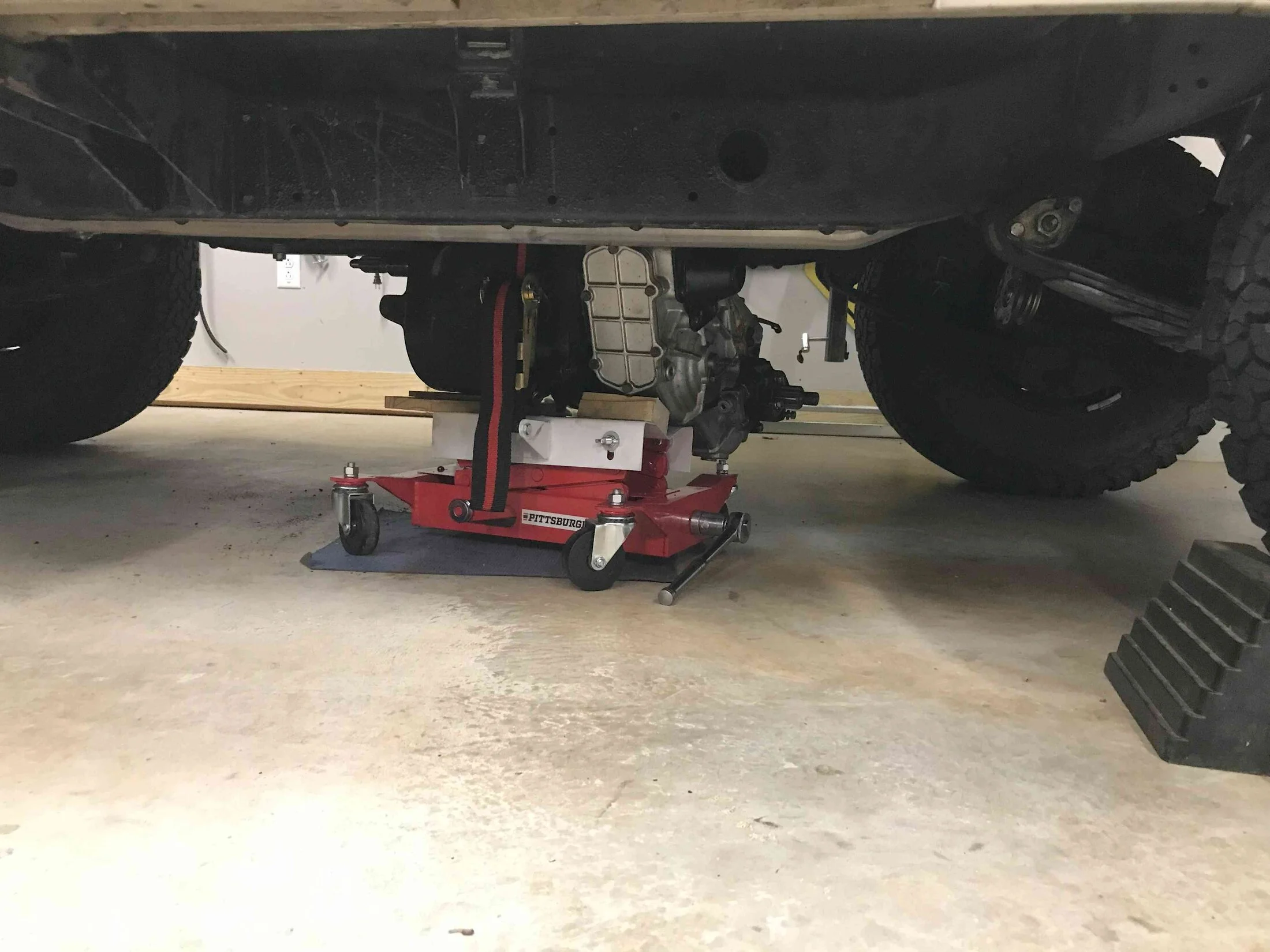

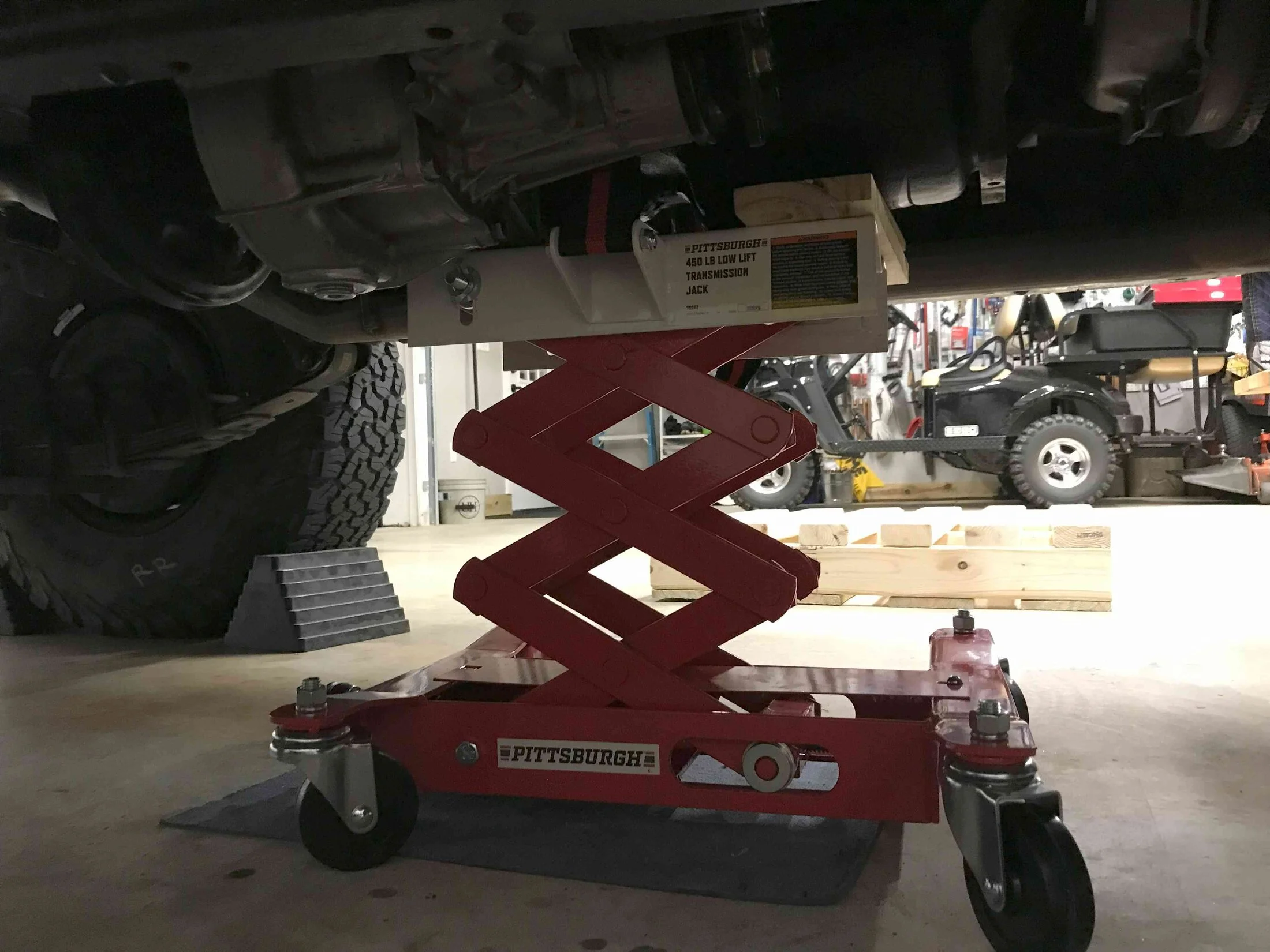

I was on my way home from work and noticed my transmission started acting funny, with slack on the down shift. Then it seemed like it started missing a gear tooth every so often....well, that will never do. Did a few assessments, and determined it was the T/T case. Went and picked up a tranny jack from HF and started disassembling the necessary parts.

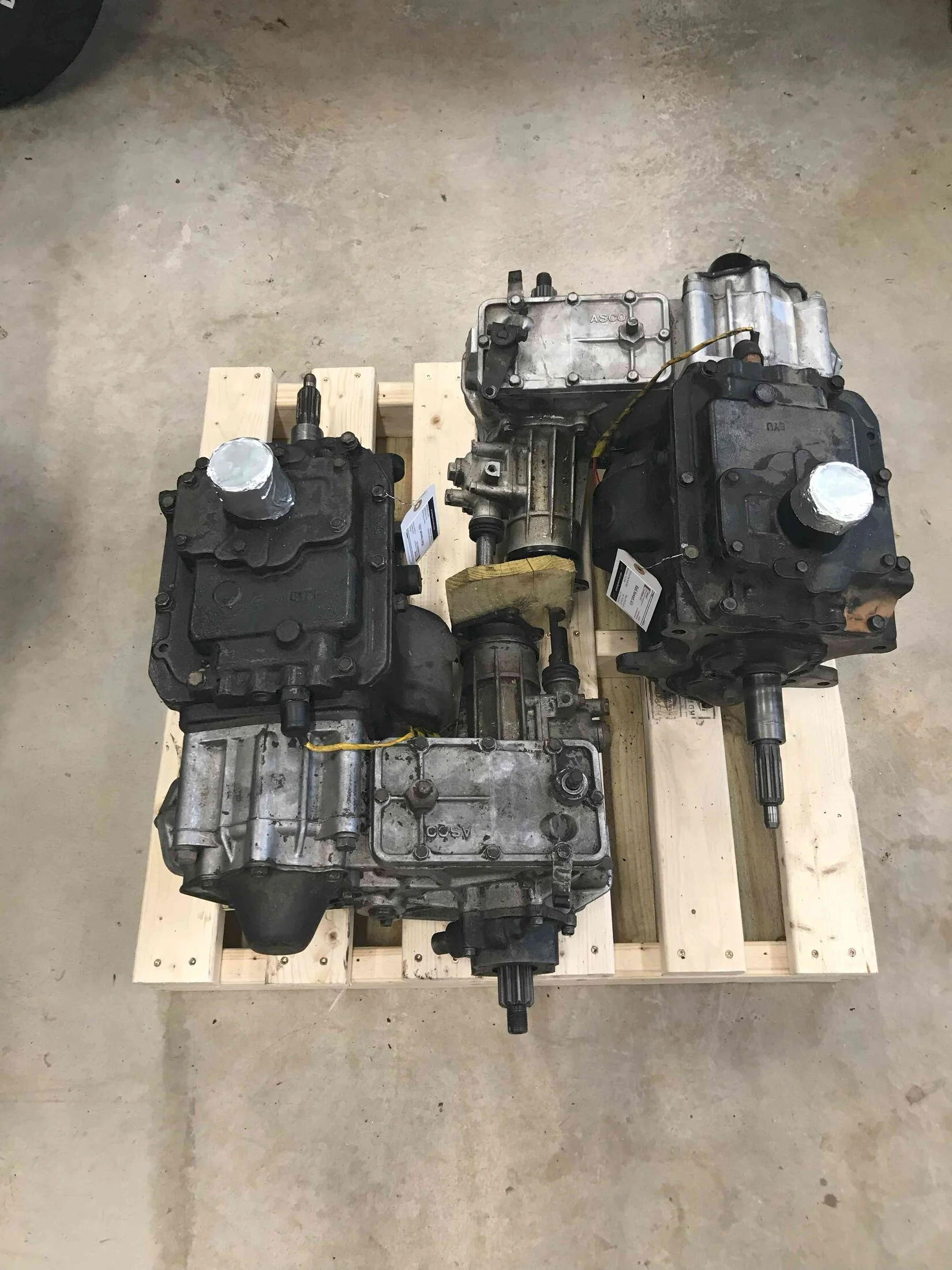

...and without too much fanfare, out it came! Being that I have two units, I'm sending them both out for experienced hands to address. So I built a pallet, will secure with a few lashing straps and they will be headed on their journey.
View attachment 3770079..View attachment 3770081
On way to Georg? And what will you do with the other unit?
Did you drain them? Without getting debris in the gear box itself, what is under the top cover of the transmission(s)? Experience can be just inspection, no special service tools needed.

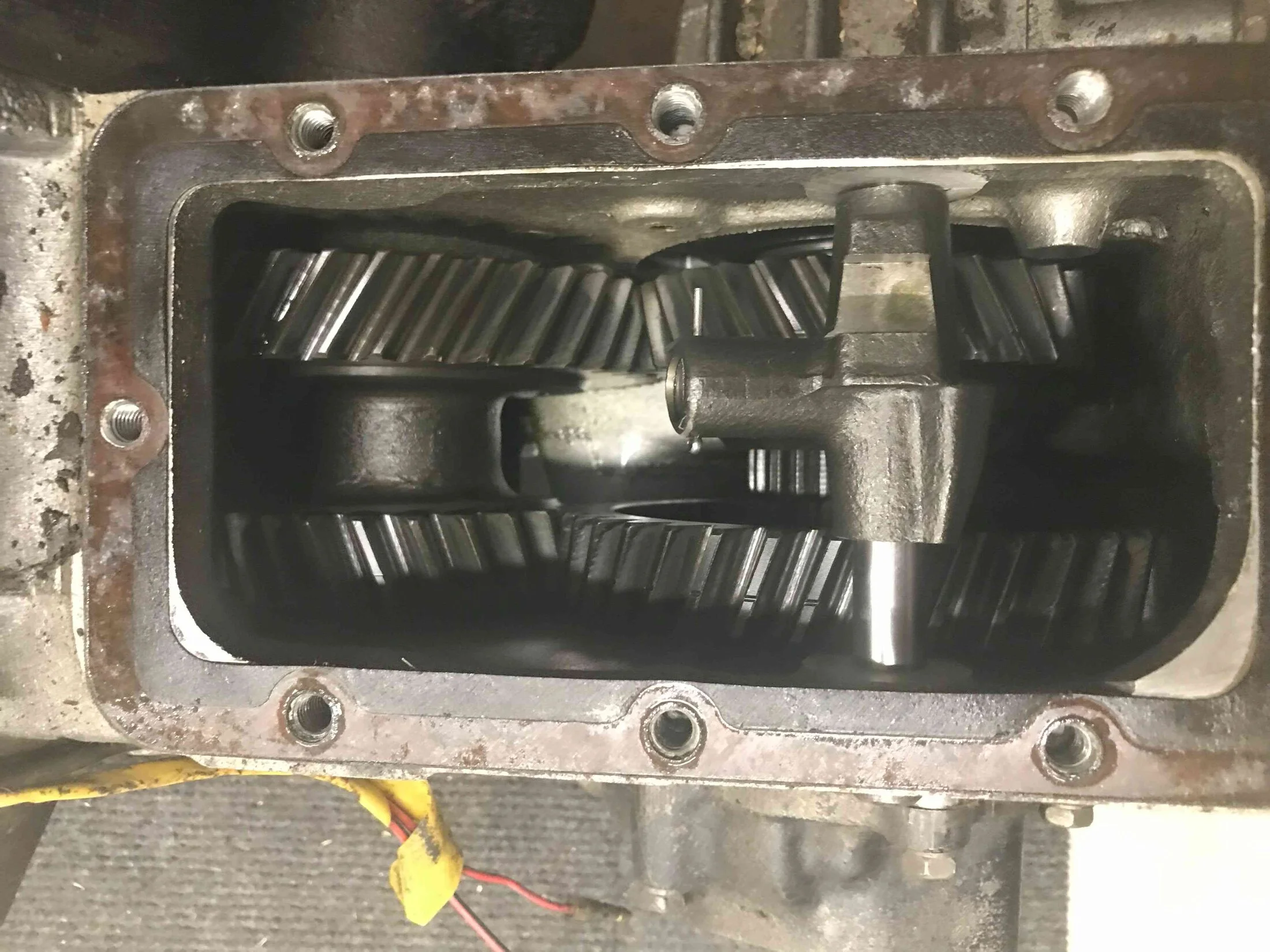

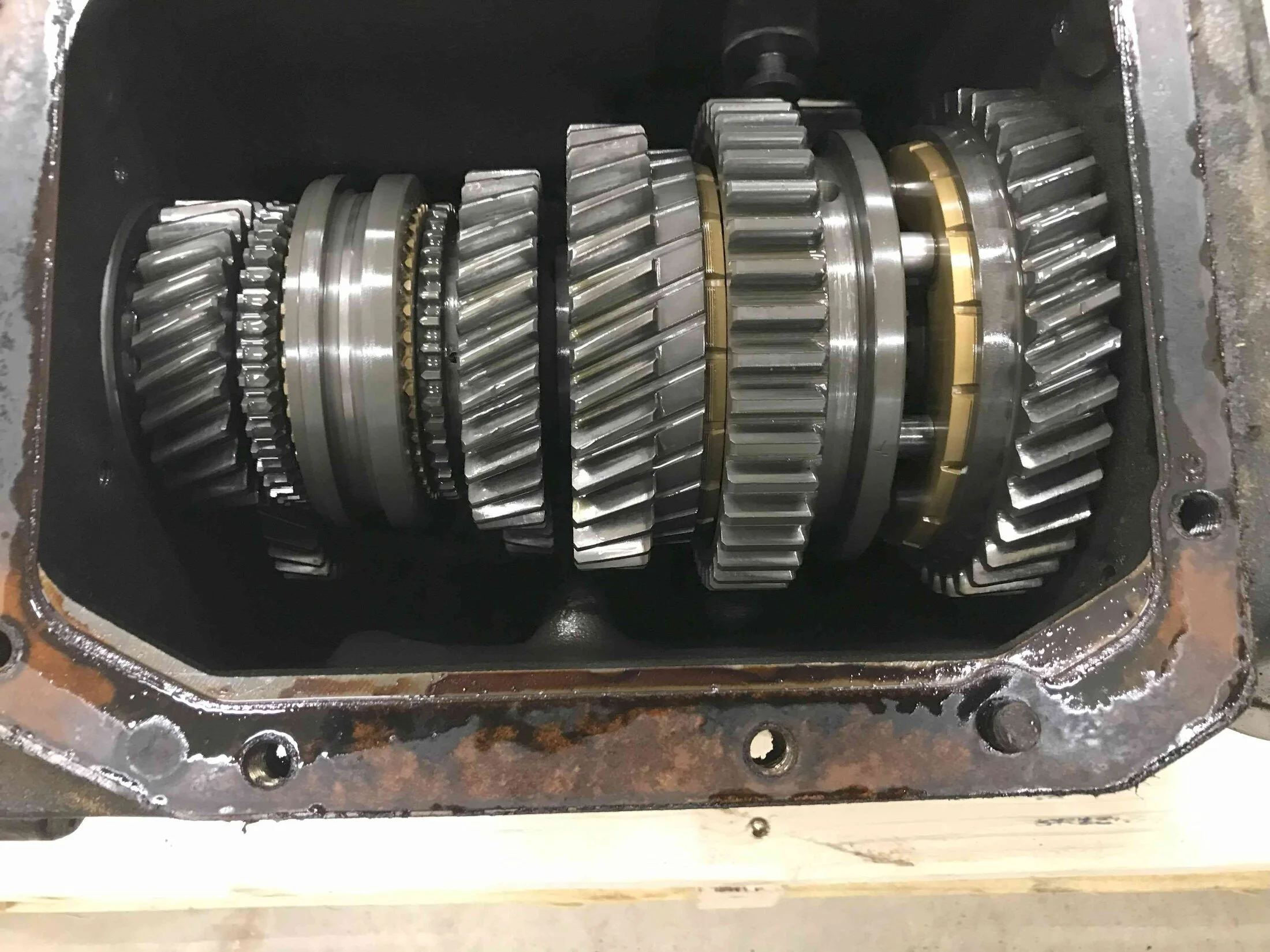

From my visual inspection of the tranny gears, they look fine. The drain & fill plug didn't have too much debris on them. However, both plugs on my transfer case had about 3/8" worth of metal debris on them. Which was odd being that it was less than 6,000 miles back I changed out the gear oil and there was minimal debris on the drain plug with hardly any on the fill plug. Also, I knew the seal between the cases was compromised due to removing the tranny fill plug and about a cup of gear oil came pouring out...but I was ready for it. So over the last year or so, something has worn enough to cause that issue.
Eh, I've been meaning to reseal, rebuild as necessary, the other T/T unit, so they both will get the business now. Maybe all that is needed is a good friend with experienced eyes to review both units, and the feedback could be that nothing is wrong with them....at least experience/expertise can tell me that. When it comes to things like this, I don't trust my inspection skills.

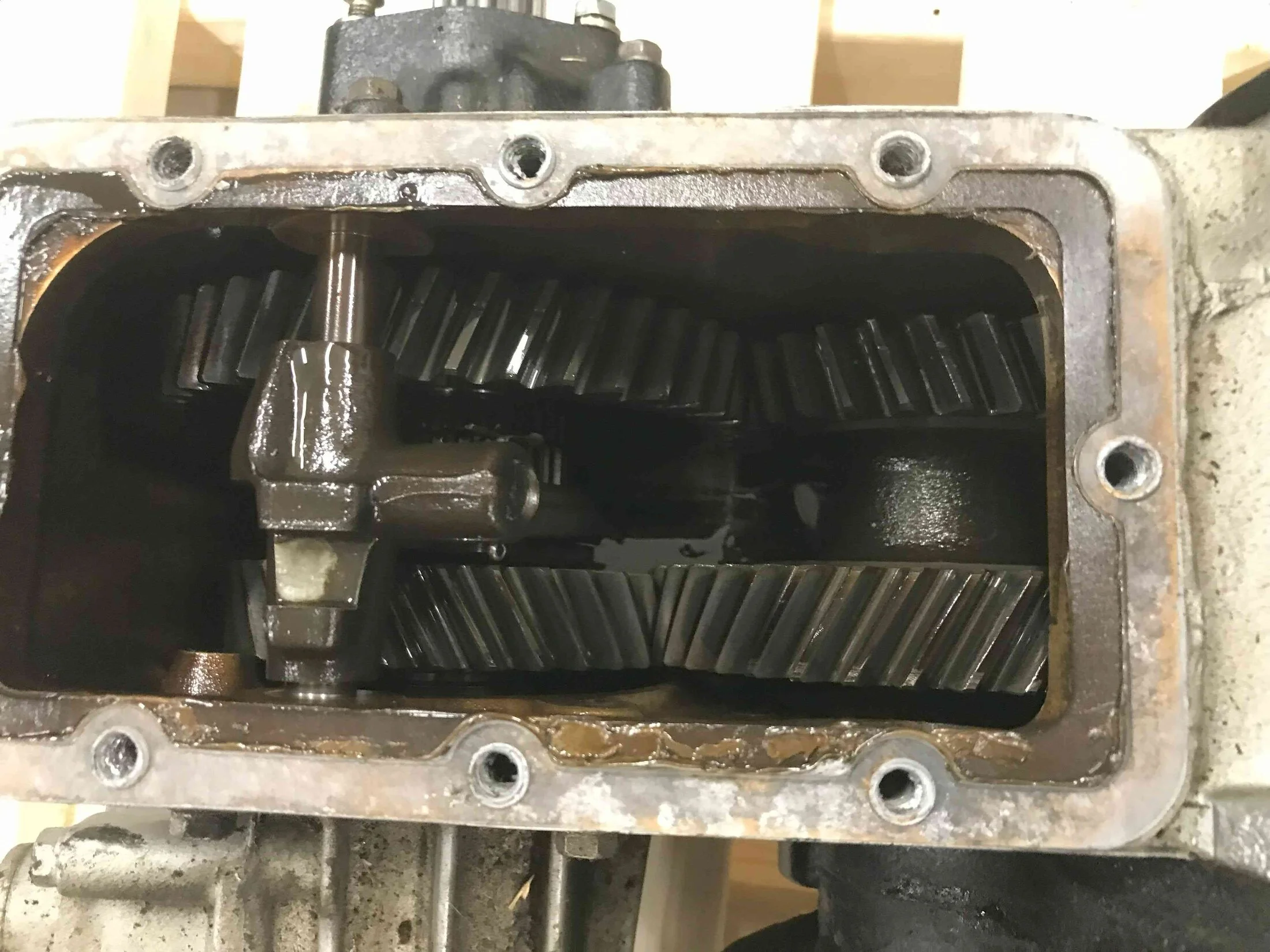

When I took the photo, I didn't think much of the dark color of the bearing. But as I drained the transfer case, the gear oil was a dark color similar to the color of what you see on that bearing. It was not the golden color I was expecting. Once removed, I opened the case and it is dark all inside as well. It is almost like I used a 50/50 concoction of chocolate syrup and gear oil for the transfer case. Heck, below is the inside of both the transfer case & tranny, notice the difference in the gear color.
Transfer case
Tranny
And if you are wondering that the other T/T case innards look like, see below. This unit may be good to go, but it is getting inspected none the less...
