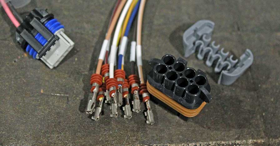

Found these Bussman/Eaton waterproof fuse/relay boxes. They have a bunch of different configs, some with only fuses, some with more relays, ect...
I want the wiring to be as neat, new, and clean as possible since I hate wiring. I meant to order one, guess I ordered two.
They come as you see, loaded with fuses, relays and a fuse puller. Fully potted and water tight. Cool stuff.
You need to order the plugs to build for your harness into the box (the 4 plugs on the sides) which I did (not pictured)

what kind of pins and crimping tool is required for those connectors?
Regular weather pack crimpers should work. This is very much a build your own harness type thing.
As far as I know you'll need these. I could be wrong but this is what I ordered:
You'll need these plugs (different colors):
These types of connectors and seals (depending on your awg) :
280 Series Sealed Female Terminals w/Tang and Seals 10 PK.
These terminal holds:
Edit: more info here:

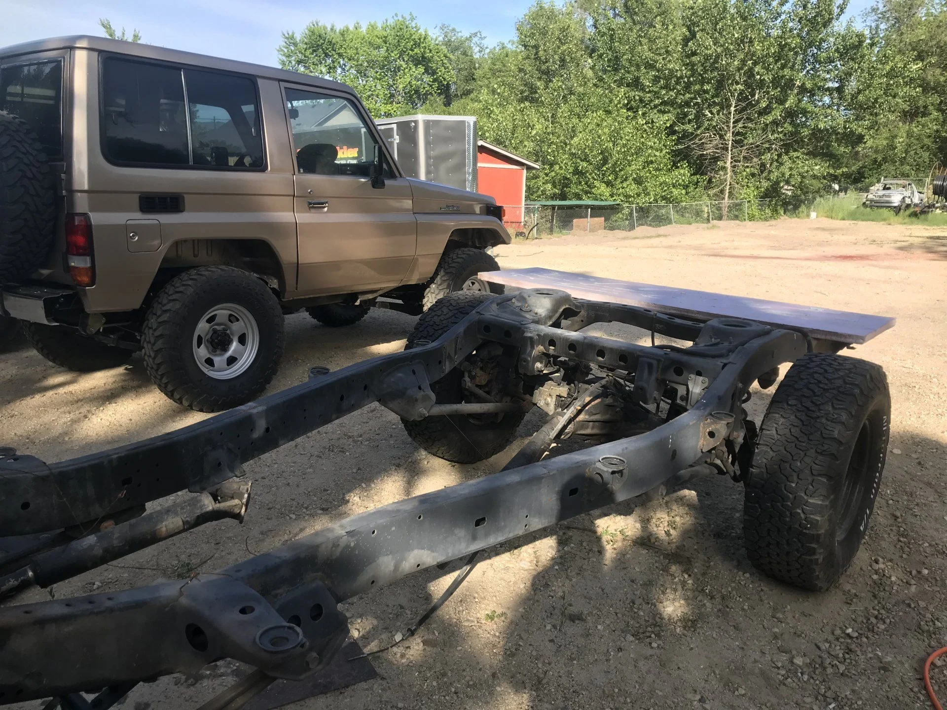

Spent a little time on the chassis getting it ready for cutting. Brake lines, ABS harness, exhaust , ect removed.
With only little things left on the 70 I should have more time for the chassis.
