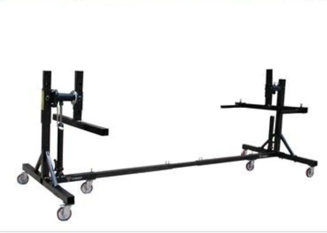

Also, if anyone is curious how thorough this build will be, I ordered up one of these :D :
2002939
It’s ready and waiting for ya Tony!
I am actually looking forward to this. The FJ142 I built was one of the funnest builds I have ever done.
Cheers
It'll be a fun one.
Once the body is all fixed up and squared away, I'll be happy. That's my main concern. We'll get it though.
After that, the rest is easy(ish).
I hope you have the wide nose in route? We are going to need that for layout.
Cheers

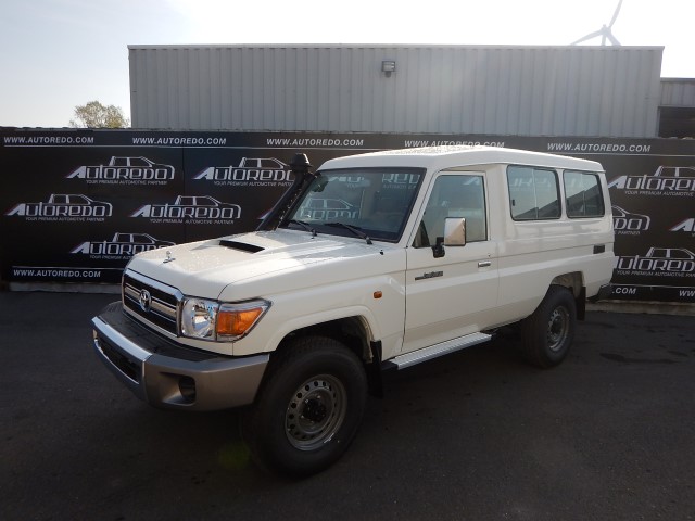

If anyone has a lead on an '07+ hood, shoot me a PM. Preferably less than $750 shipped to Boise as that's what I'm looking at from the usual suspects. 😁 I'll drive, within reason, to pickup if need be.
Is that the hood with the scoop for the Intercooler?
Do I feel a group buy coming up for the hoods with the scoop ? I would definitely like to get one
So is that a yes, the 2007 and later hoods will all have the scoop? :)
Just the V8s.
Yes,
Hood 53301-60770
"Bulge" aka scoop 76181-60901
All for $750ish shipped from the usual suspects.
Mind you that doesn't include the under plastic guide thing (that directs air to the intercooler), or the insulator or all the other little bits and bobs. Still significantly cheaper than the price quoted from another "land cruiser parts" reseller in the US in the north east for take-off hoods.

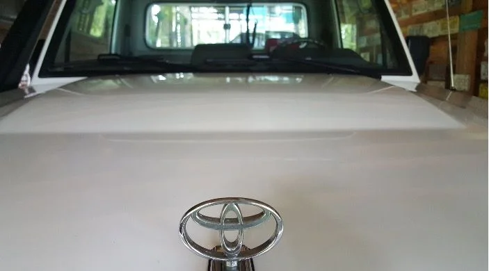

Not all '07+ hoods have the bulge. There's a bunch of different part numbers for all sorts of variations, no idea of the difference. I believe there's also two different kind of bulges big and small. I'd prefer smaller which I think is that part number noted above.
Edit: As far as I know that part number is for this style of hood. I could be wrong so if someone could double check....
@TonyP ...... "Not all '07+ hoods have the bulge. There's a bunch of different part numbers for all sorts of variations, no idea of the difference. I believe there's also two different kind of bulges big and small. I'd prefer smaller which I think is that part number noted above.
Well perhaps they do all have the bulge although some don't have the scoop.
