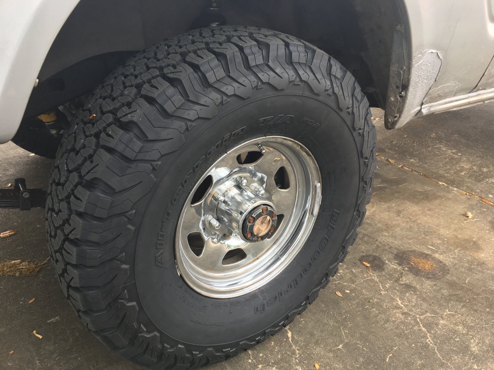

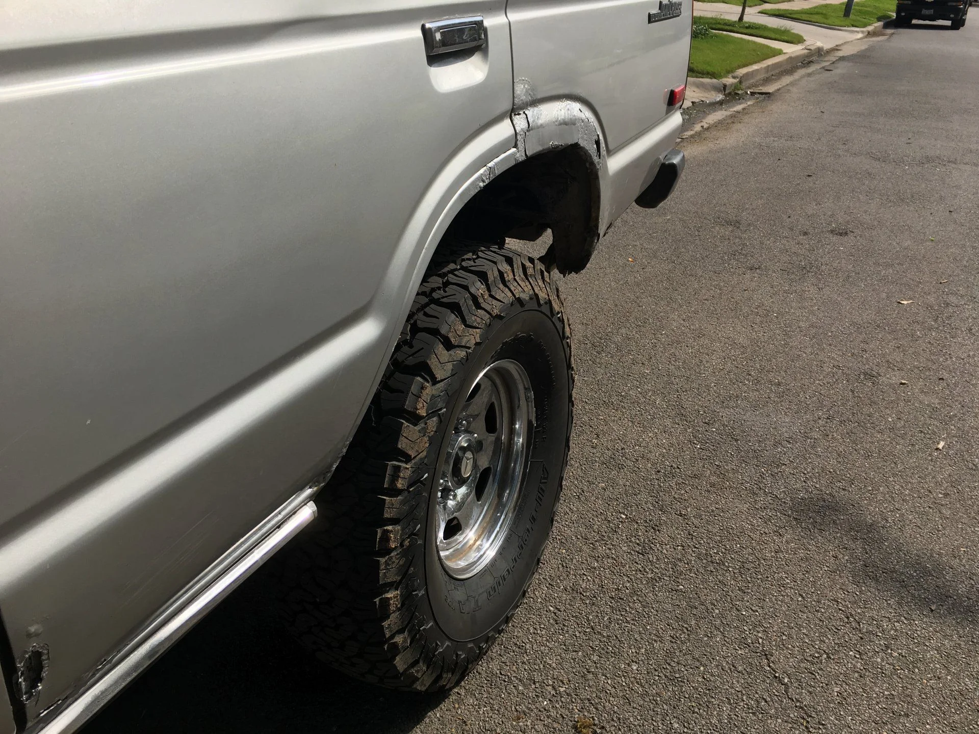

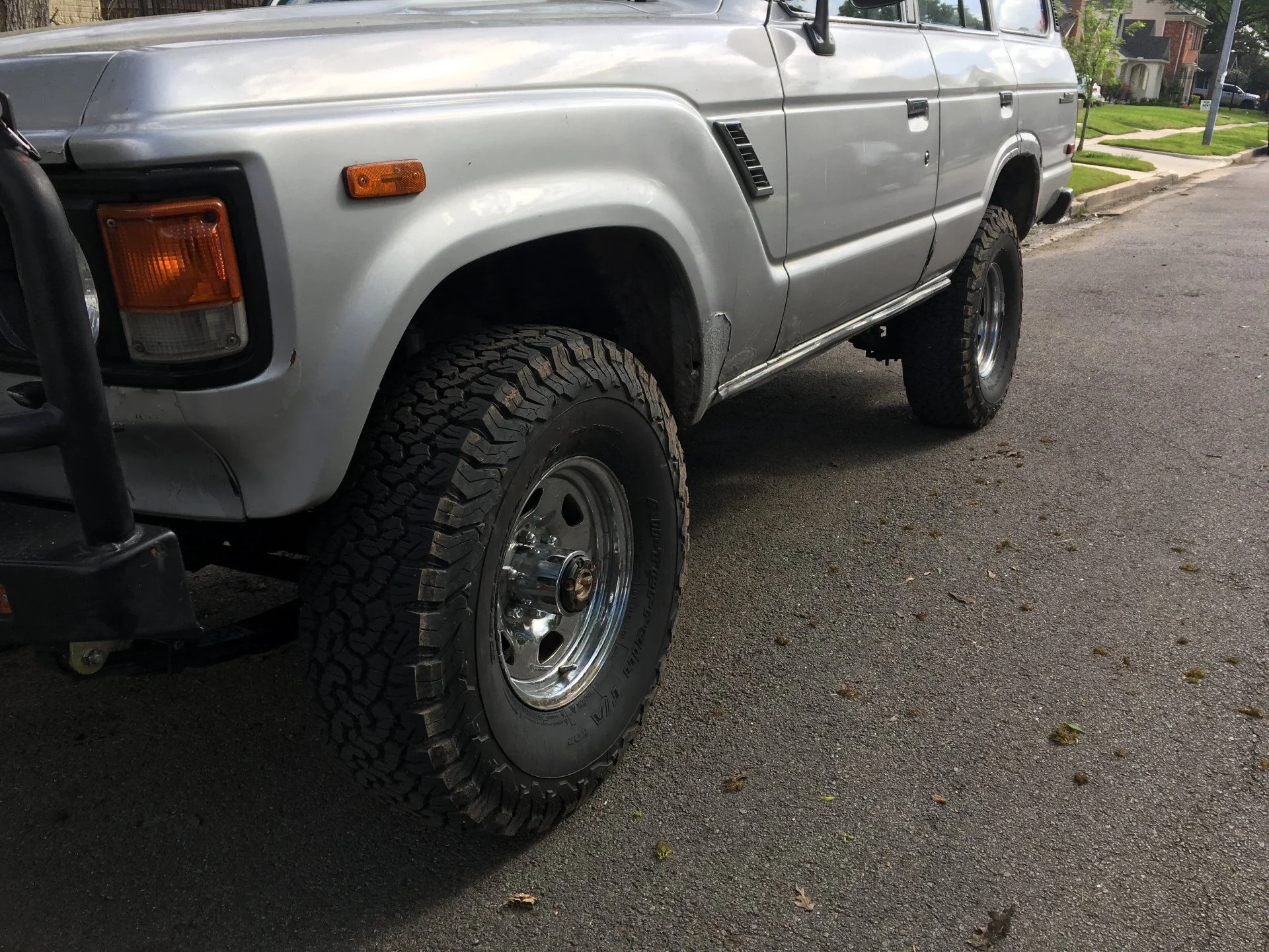

4wheelparts did it. They were great to deal with and I've had it up to 75 without issue. @FishTown
Curious if you used shims on your front with the lift. I've seen some with and some without. Notice any difference in the steering feel? Also, why Bilsteins, it seems like most of the OME kits come with the OME shocks.
I had shims ready to use but we tried without them and the truck drives great. Straight at any speed and no wobbles. Steering effort is the same.
I don't think that the OME shocks were all that great for my application. More on road then off. I've always used Koni and bilstein on my cars and for this application, I called Bilstein directly. They verified the balving based on my needs and I can tell you this, the truck drives and rides better than my 2004 tacoma with new oem shocks. Plus I hear the OME shocks are just marked up Monroe shocks. Didn't like that. I paid $100 less for these German made shocks.
It doesn't ride like an Oxcart despite having super heavy springs. Exactly what I wanted. @abtx4x4

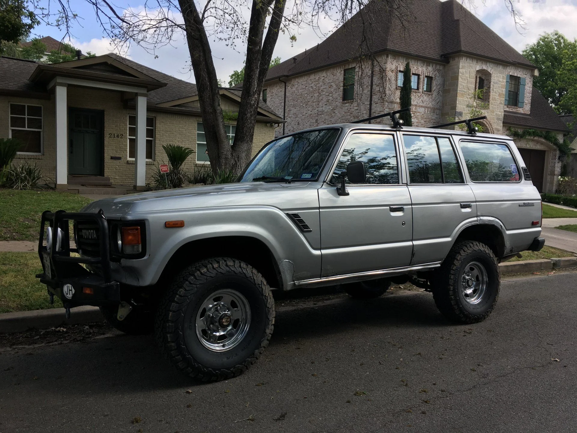

Went from Houston to Lake Charles on a whim for work.
Took the old truck because my Tacoma is missing the spare. No regrets, the tires are breaking in nicely and it feels comfy at speed. I even got it to 76mph, which is a new record. It eeked out a solid 14mpg running for 2.5 hours at highway speed.
I've also got a small Yakima load warrior rack on loan from a friend. It needs a megawarrior for this size of truck.

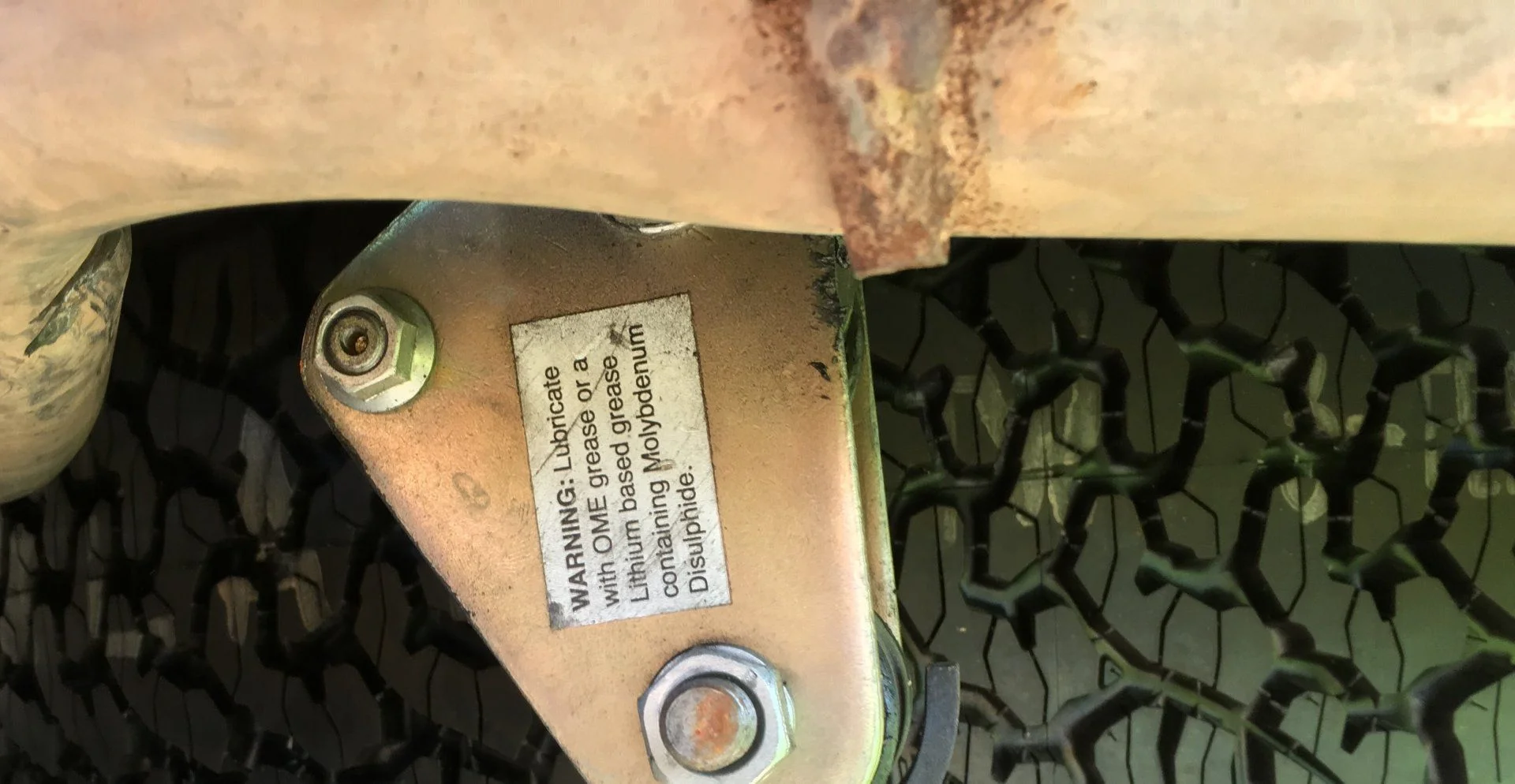

Since my old shackles were stuck and I added the ome shackles, I've had my exhaust running the rear DS ome piece.
Stopped by a small exhaust shop and he fixed it up cheaply. No more rubbing and vibration coming into the chassis.

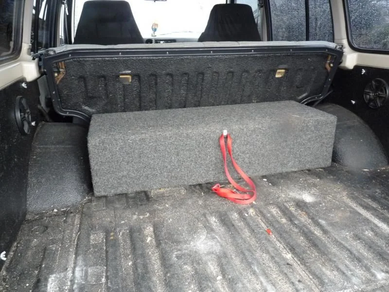

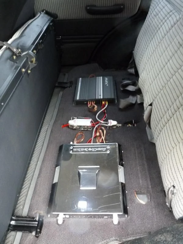

Currently away from home in Washington state. Was browsing online and found a Rockford r600x5 amplifier. Planning on putting it under the back seat and building a box for a single 12 in the back.
I want to take these ideas and have my friend who is a carpenter build me a box to fit in between the wheel wells snuggly with a downward firing 12 in stealthy tool box.
I want to have the box with a lid on top to have some storage for straps and tools. I want to cover it in the same rubber diamond plate. I've ordered stainless latches and hinges from Amazon. I want to make it look more like a tool box than a speaker system.
I refuse to tint the windows so I have to keep it stealthy.
