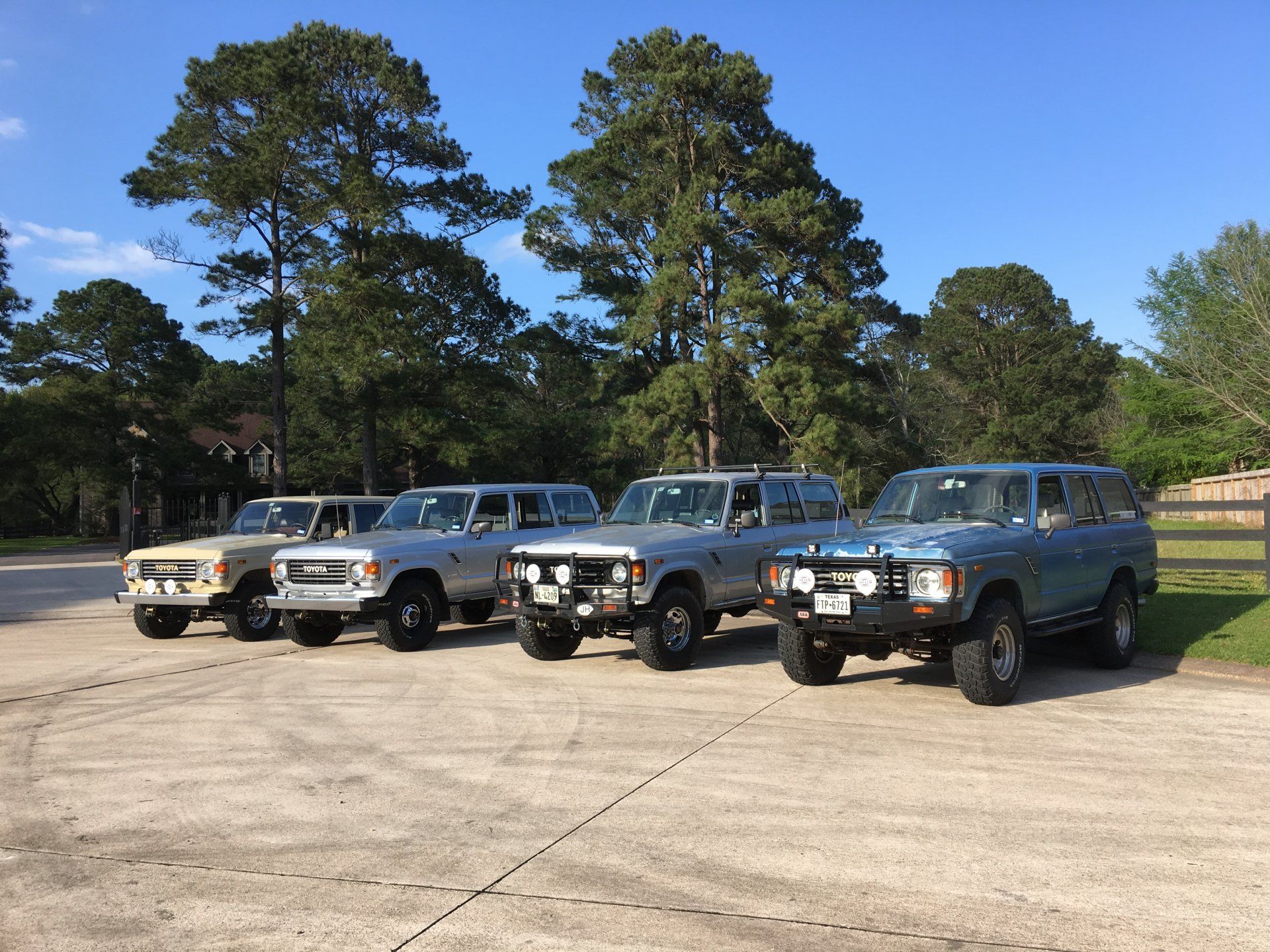

@houstonfj40 @klinetime574 @FARMAN33 and I are all having a party this Sunday.

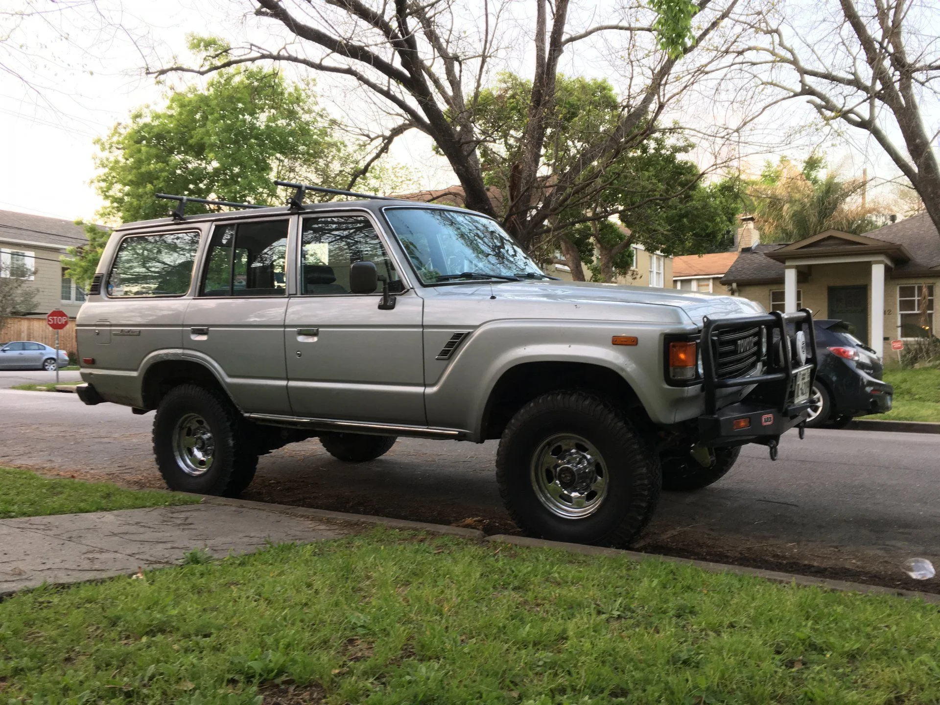

At the end, my truck will no longer be a low rider.

I can cross the last needed item off of my original list!
The truck is lifted on ome cs005F front and cs005RA/B with bilstein shocks and ome shackles. No lean at all! Can't believe it.
I can't tell you how happy I am with the ride. It's not bouncy at all and feels like a modern truck around corners. I also found out that I've got brackets for a rear sway bar so I'll be looking for one from a 62.
A big thanks to @FARMAN33 for lending his awesome garage and supplies to help me get this all done. Also, @houstonfj40 and the man beast himself, @klinetime574
An awesome group of guys who stopped at nothing, no matter how bad the 300k original suspension parts fought us the entire time!

Glad to help Alex. Great truck!
Marc
I'll take "man beast" for $500, Alex.
Good times man. I'm glad we could get your 60 sitting proper.
It appears we did a LOT of good guessing! Thank you for the filter and the BEER! Was great fun wrenching with all y'all!
