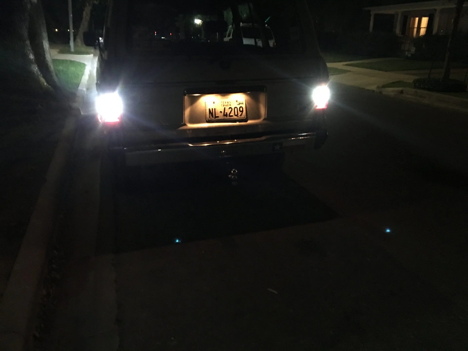

Changed the oil with some Delo and added my pfran led reverse lights.

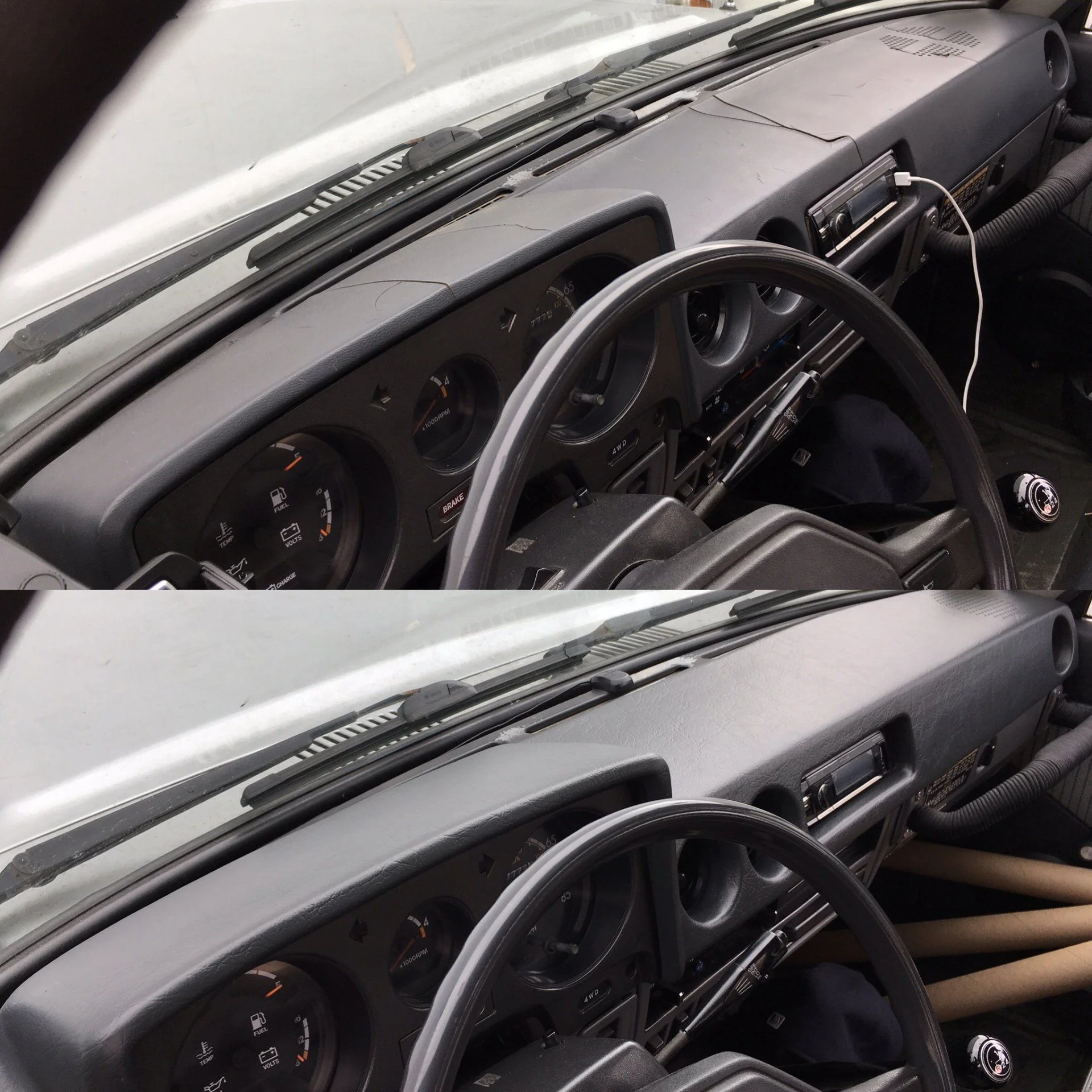

CCOT Dashcap in gray. It was time. I saw a piece break off of the already cracked dash sitting in the sun and I knew it was time. Consider this my first "cosmetic" mod. The interior in the truck is really much closer to perfect than the rusty outside would indicate.

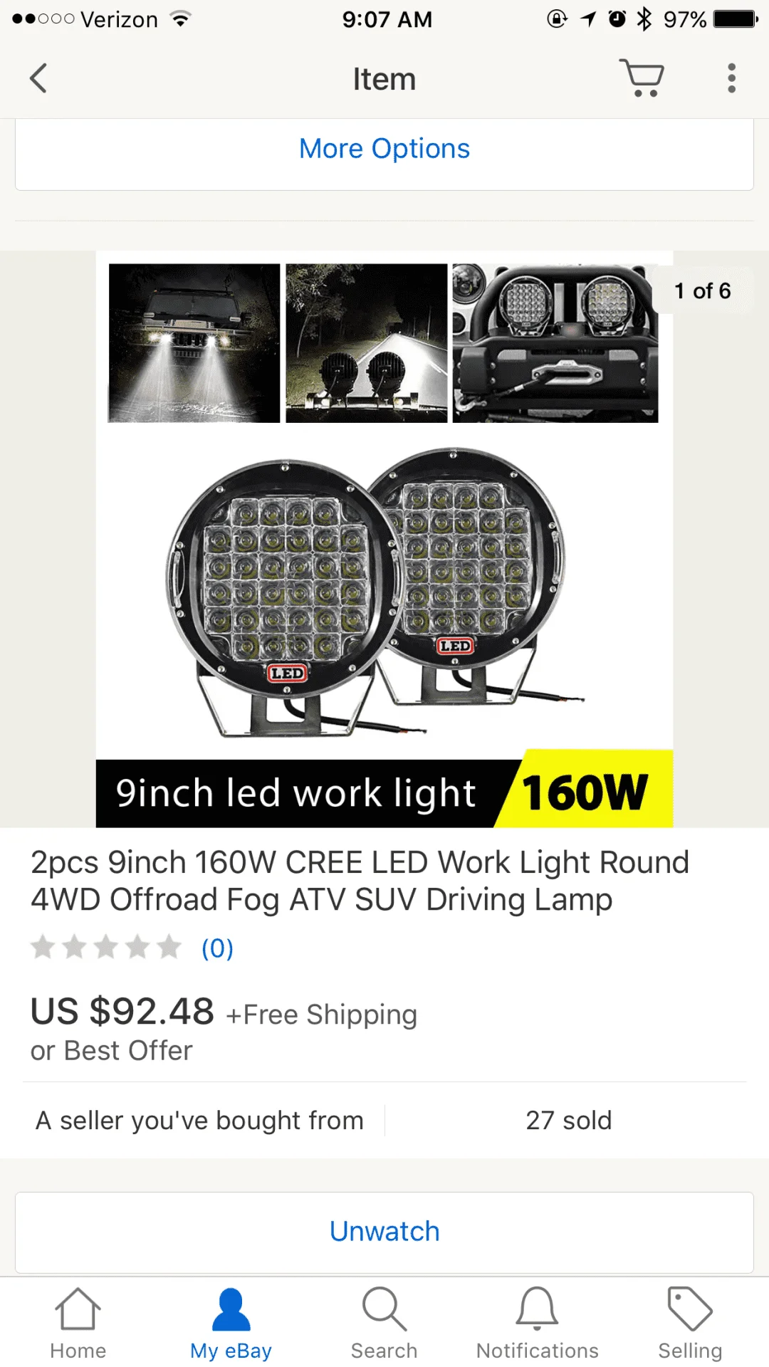

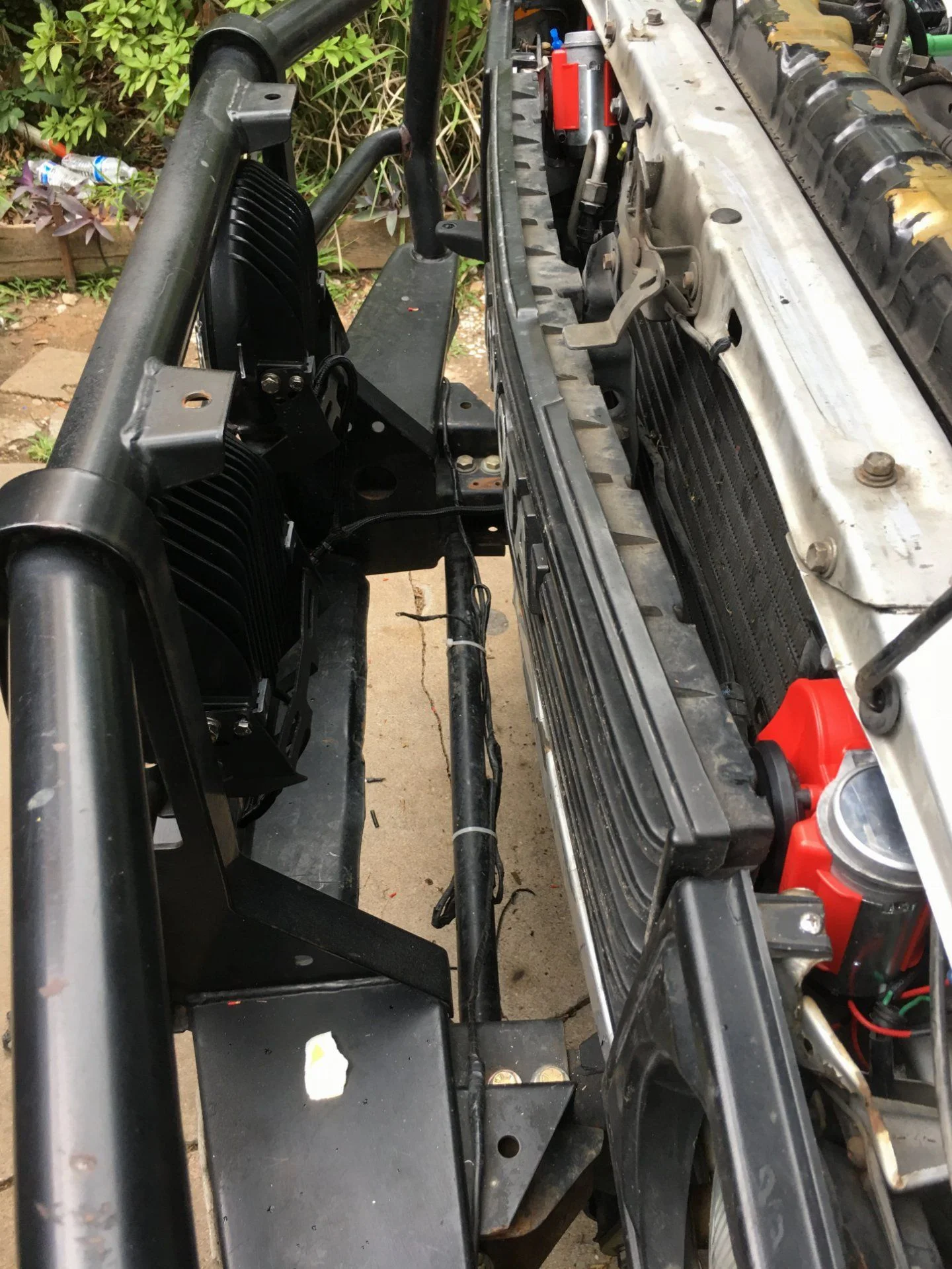

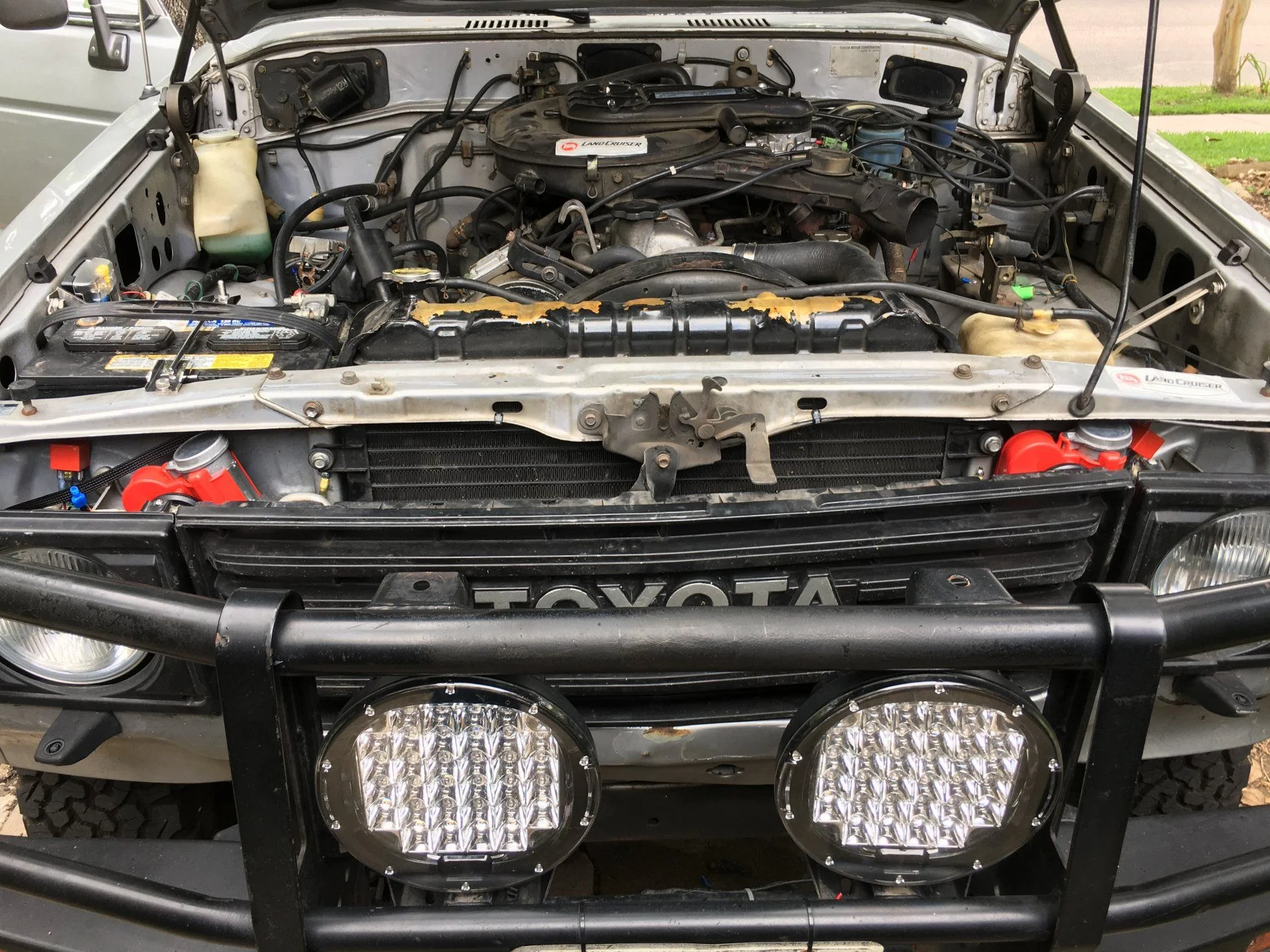

WannaARB 160w fogs from eBay to replace my hella 500ff. I liked them for the $55 and it helps that they came with a harness but they weren't doing it for some of the trips into nowhere for work. I work in pipeline right of ways and refineries in the middle of nowhere, I needed more light for some of the off the road driving. $92 shipped for what would have been $1500 otherwise. I got black ones to not look like as much of a poseur.

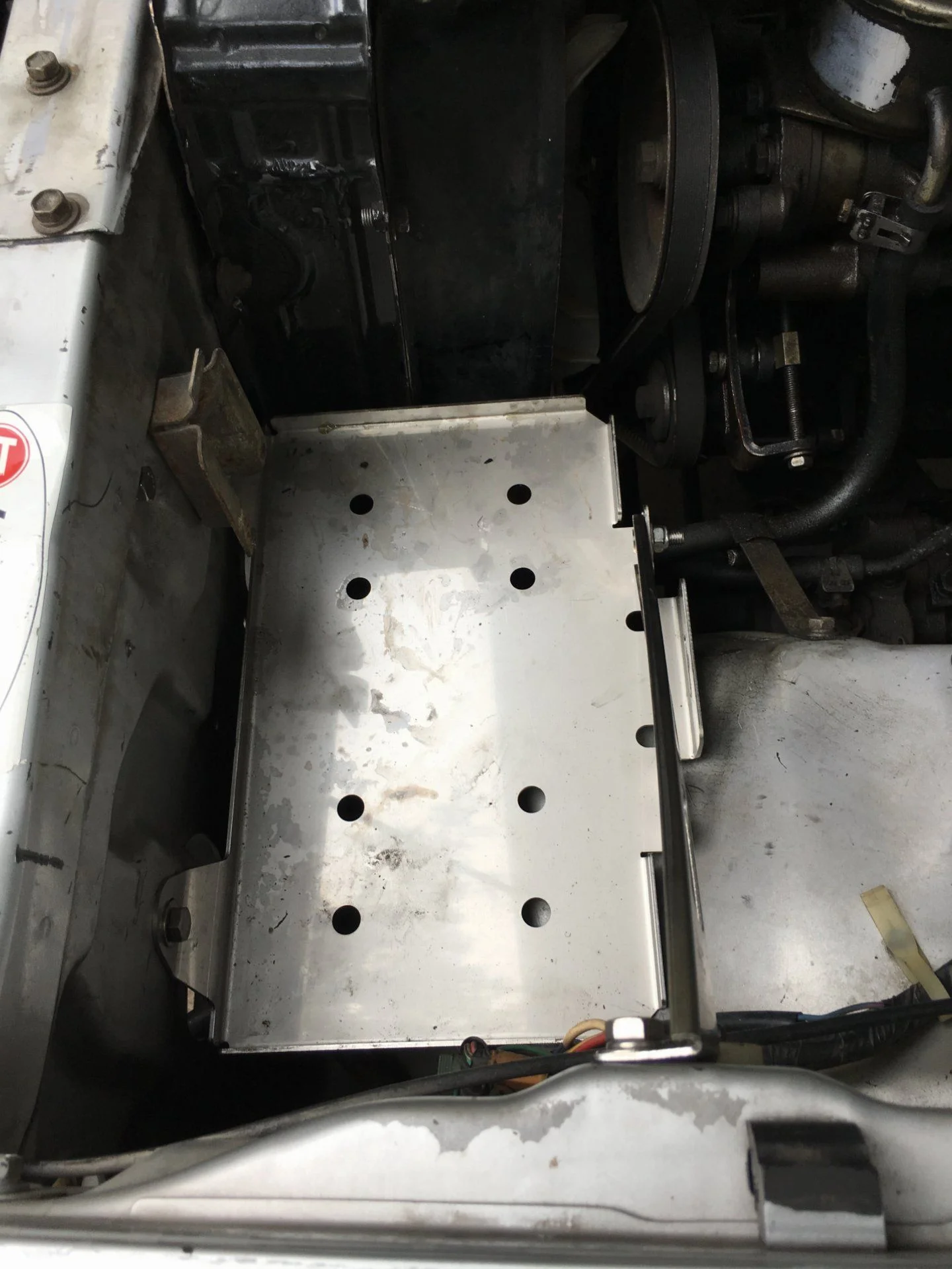

Dual stainless battery trays.
Dual stebel nautilus horns on relays

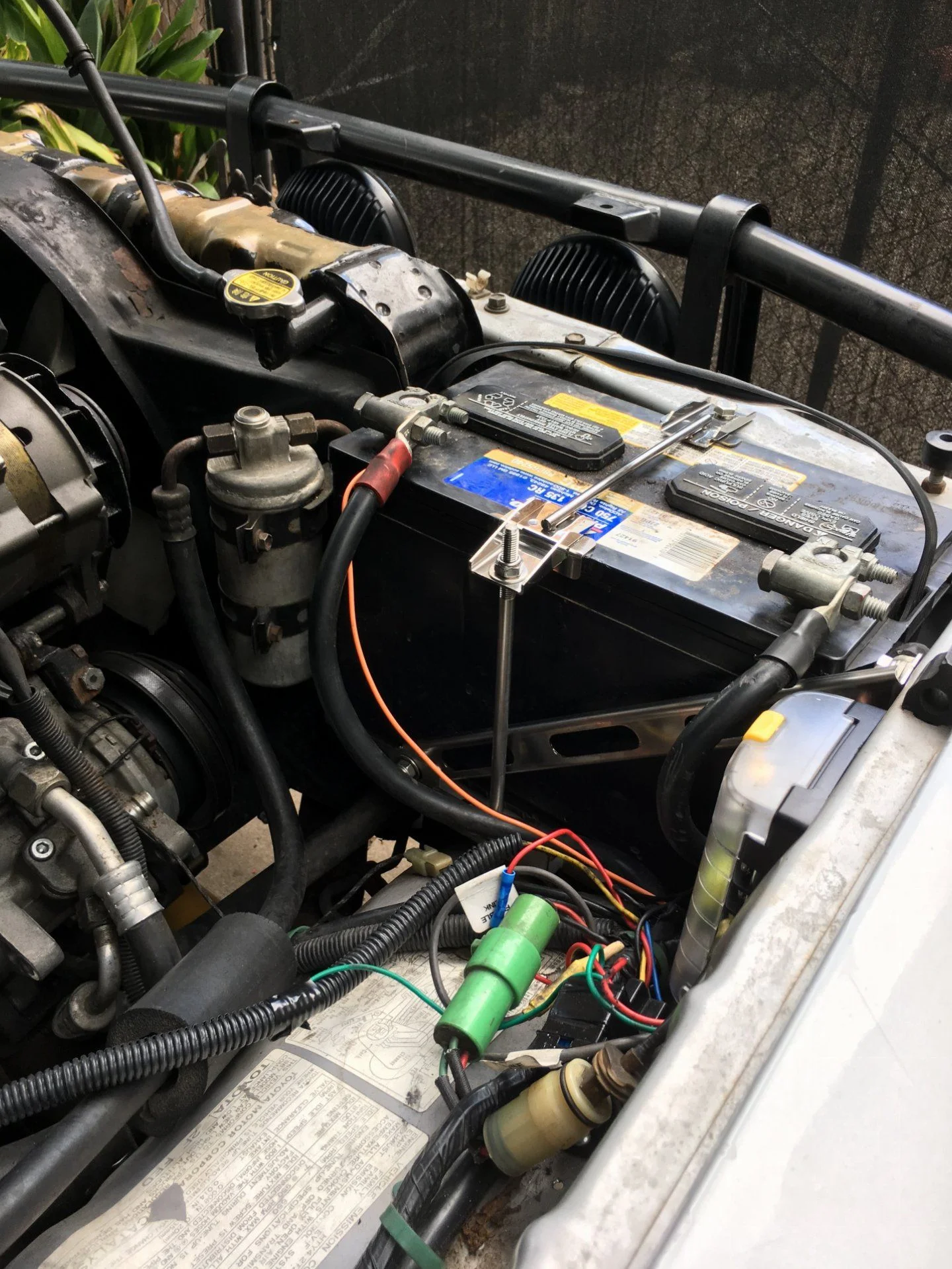

Blue sea 12 circuit fuse block
Haven't decided what I'm going to do for a second battery. Either another AC delco 27 or a yellow top. I bought the hold down for the yellow top but I'm having second thoughts. My factory tray was wasted and I want a second battery for the self starting and a winch soon.
The fuse block cleaned up a lot of wiring issues that I've had and simplified the under hood area.
The horns were needed. I've had close calls with so many people recently and the oem horns were barely audible. These are 139db each and have a good mid to high tone. Wired them up with relays and I'm really happy.

Add my second battery and a dual battery relay. Tray is in place. Just a second lead acid nothing fancy.
