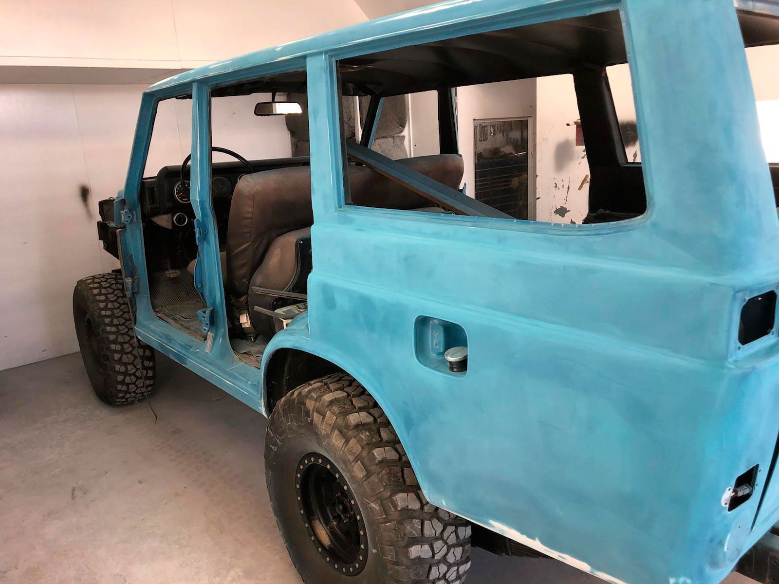

RTC Auto Body (the same shop that just completed the paint work on Marv for @OldBeachBob) has the target carrier now, Ryan thinks about 60 days to get it back to me. This is the first time I've had a shop do any type of paint or body work and I was a little apprehensive but with all the other work going on in my shop and winter approaching I was left with little choice if I wanted it done this year.
I believe RTC will do a good job, Ryan seemed excited to get the job in his shop and he appeared willing to deal with my OCD. I’ll try to get out there a few times in the next 60 days for some update photos.
"Nebula green, I bet."
X2
Color change comin?
