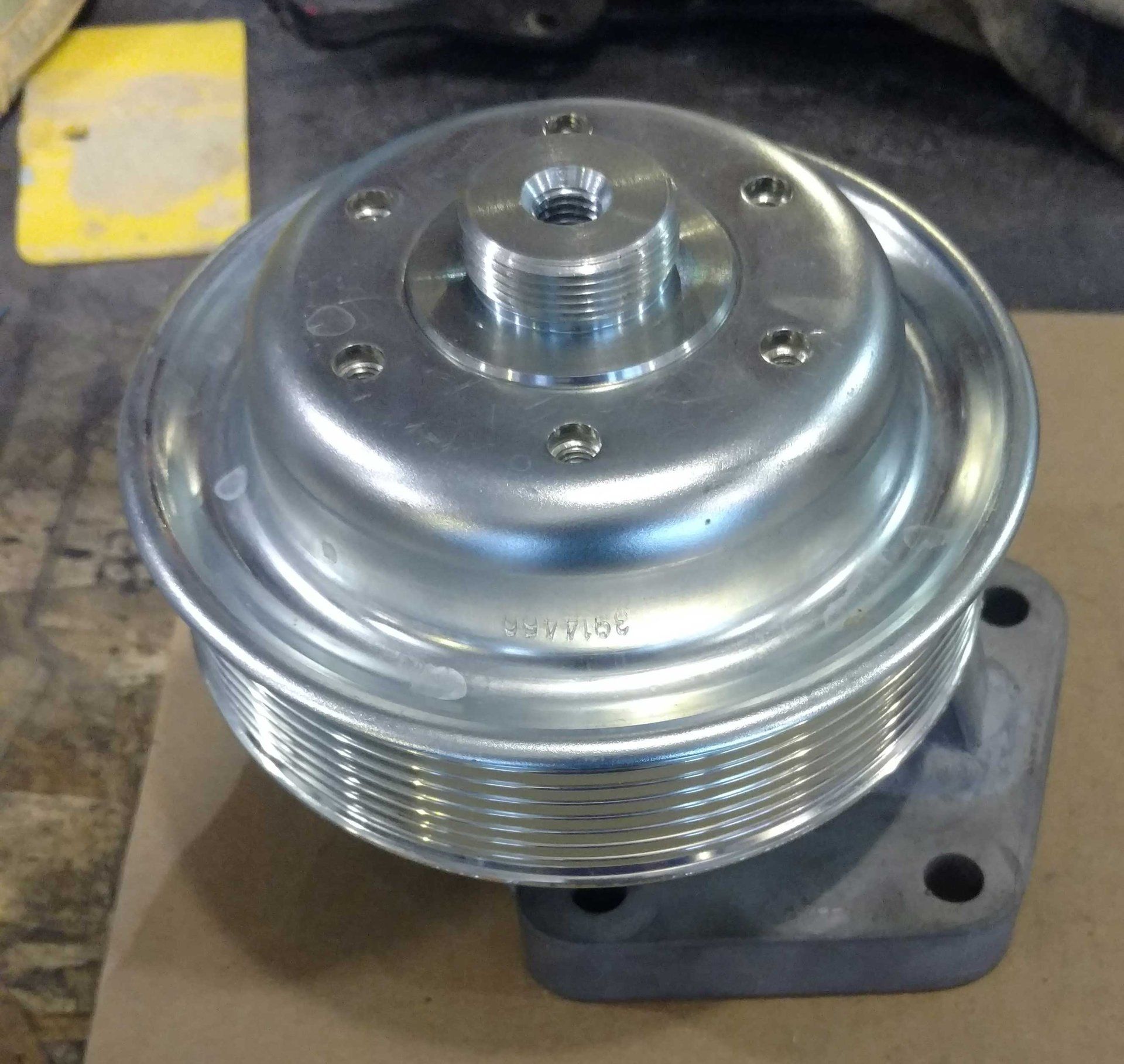

Step one is to figure out a fan support to mount the new mechanical fan.
The factory 4BT fan support was too long and positioned the fan too low and too far to the driver’s side to be usable. From what I could find the early Intercooled 12 Valve Dodge Ram Cummins fan support was centered and moved the fan up about two inches, the problem was Dodge only used these three years and only on the intercooled versions for those pickups making them hard to find on the used market and stupid expensive when you do find one, Cummins still offers this mount but again crazy money for something I didn’t know if it would work so I decided to make my own. The ('94-'02) Cummins fan support is an inch shorter than the 4BT support but it is still the low drivers side design, its inexpensive and readily available so I just bought one as a starting point.
I used a chunk of 3” heavy wall DOM and welded it to some ¾” flat bar, bored the tube for the bearing and machined the mounting surface of the flat bar perpendicular to the bore.
To lock the bearing in place I added a shoulder to the front of the housing and I added a snap ring to the back side.
All the parts pressed back together.
