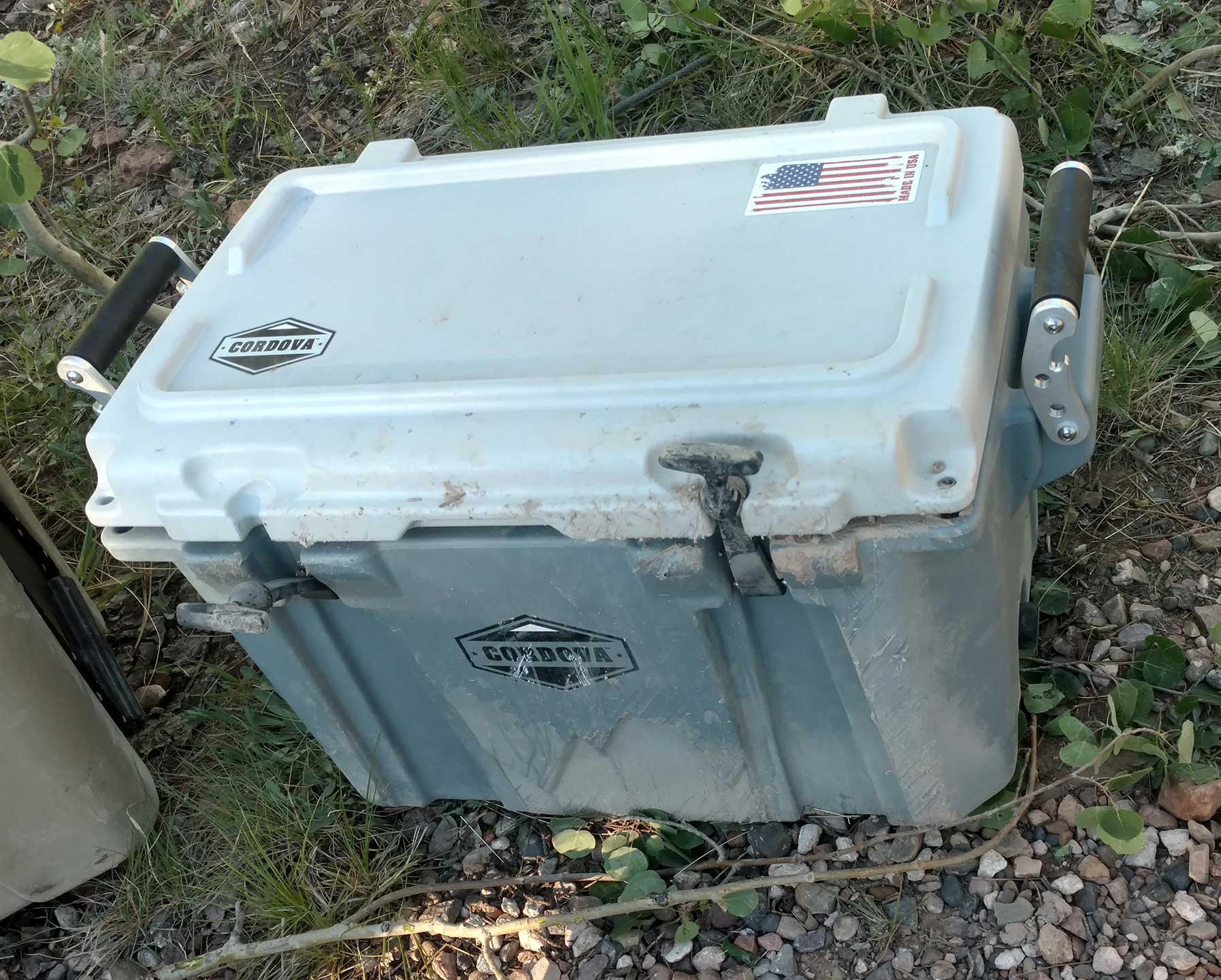

I believe my ice chest may have damaged the arm the day before, looking at all the stainless lines in that area it’s obvious that’s where the ice chest got wedged during the melee.
I'm ordering the steel arms this time to try to ice chest proof that section of my suspension..
Time to get a styrofoam cooler, easier on running gear and tell your dogs to quit dancing on the ceiling.
