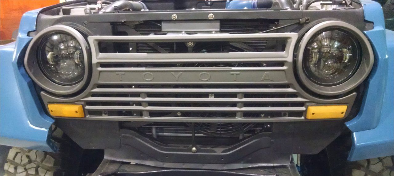

I’m trying to work on a few known issues now instead of waiting the week before the pig party to get started, as I’ve stated before I can’t get enough air through this grill to keep everything happy on the really hot days so I’d like to mount the later open grill. I’m thinking about taking these parts to get powder coated to save some labor on my side of things but I’m struggling to find the extra set of headlight bezels I had (good chance I gave them away in a big box of pig parts I didn’t think I’d need) anyway if one of you have a set you’re not going to need I would gladly trade you some American freedom bucks for them.
I need the silver outer rings in this photo.
Thanks.

Are you going to try to modify the current grill by relieving the areas in between the letters?
I know Evan @fj55-100 has a legit '79 grill. I have a spare '74 grille, maybe I could ship to him and he could mark the areas to be cut for the benefit of others seeking more air flow? I could post pics...
My plan was to send these parts out to get powder coated so I could focus on some other projects I have going on at the moment, well it got to the point I was spending more time trying to find a shop that could do the work in the color and time frame I needed than it would take to do it myself.
So I decided to just sandblast it and Cerakote it here.
Yep I got side tracked and forgot to cut the blinker light holes..
Notice the 1968 grill has slightly different shape around the blinker recess.
Everything is installed and ready for some hot weather test driving.
Thanks to @Rix 45 and @scrapdaddy for the grill and light bezels!
