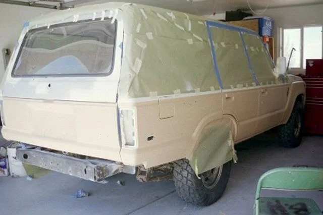

I am looking for some tan roll on truck bed liner, to line the inside of my 60 buggy. It always covered in sand on the inside so It will hide it well. Does anyone know where I can get some Tan roll on liner...I have been checking the local joints but only stock black.

Here's a quick pic of my recent RattleGuard project. It's DIY, 2-part epoxy based, but def. spray on only. Deing a true epoxy, it should last longer than the 1-part Durabaks and the like.
It takes more prep than ROLL-ON Durabak due to overspray, and short pot-life means you can't dally while spraying.
