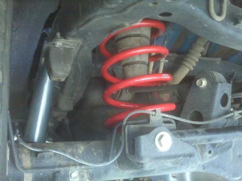

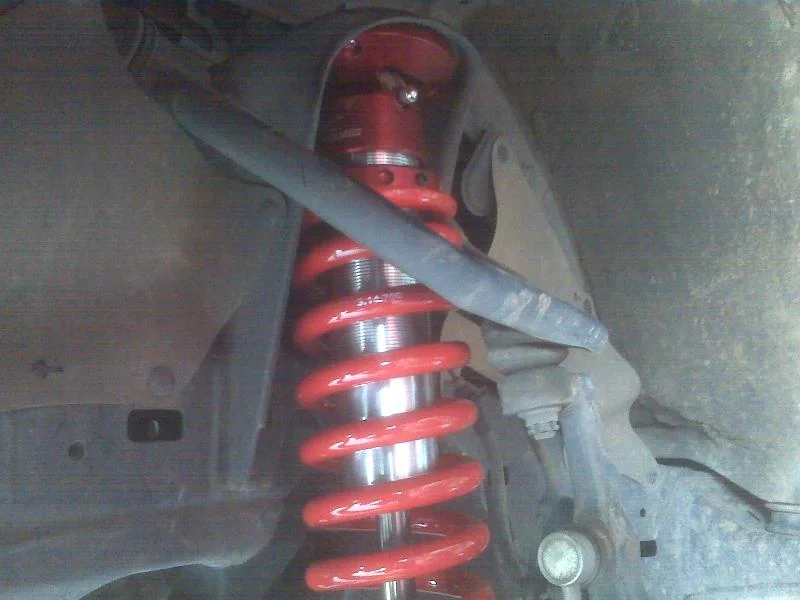

Sway Away lift installed and it came out sweet. Easy installation. Netted nearly 3" up front with the adjusting spacer at the top. We had it cranked down about 1" to start and measured just over 4" of front lift, after that Knoll took the spacer back up to the top.
Hopefully he will post up some pics and measurements after he gets the tires installed.
Pics of lift

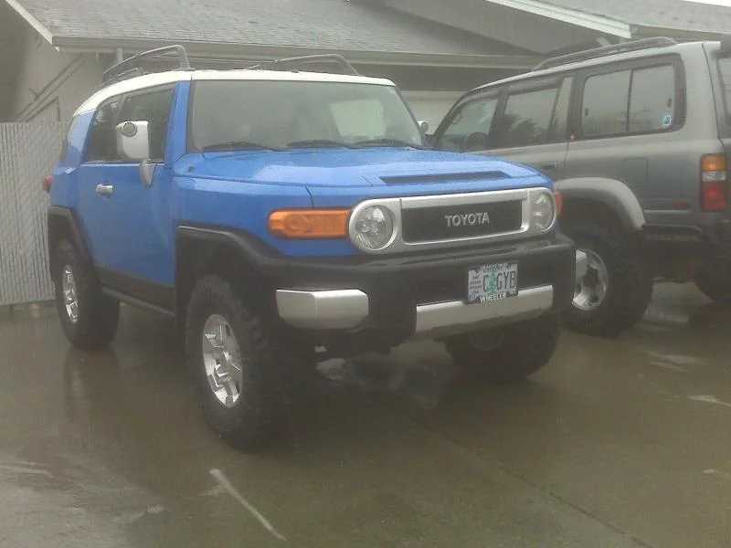

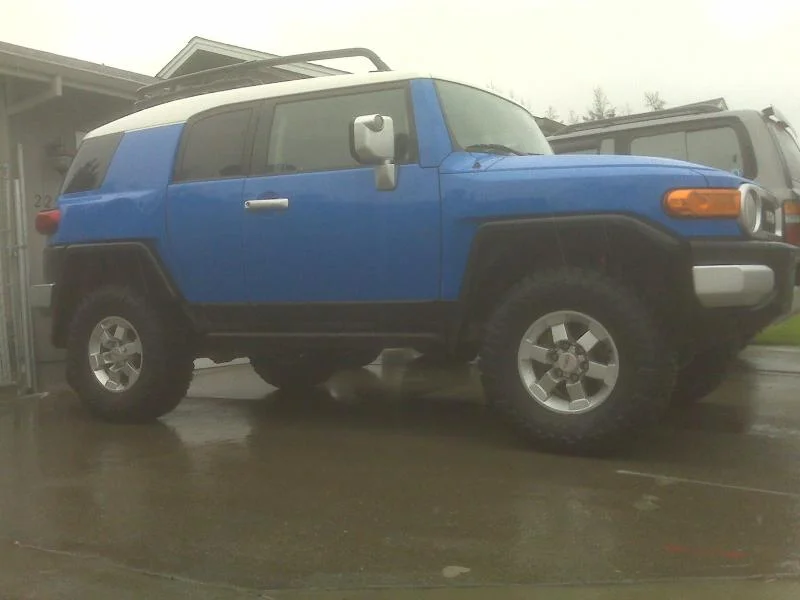

After the tires and alignment!
looks awesome knoll- nice work, nice work :cool:
Gotta give props out to toy350 without him it woulda been a very long, dirty, unpleasant day in a gravel driveway! Not to mention the expertise that his saltyness brought to the garage!
