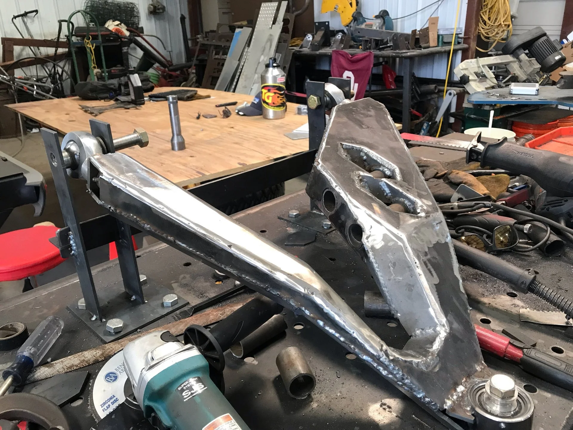

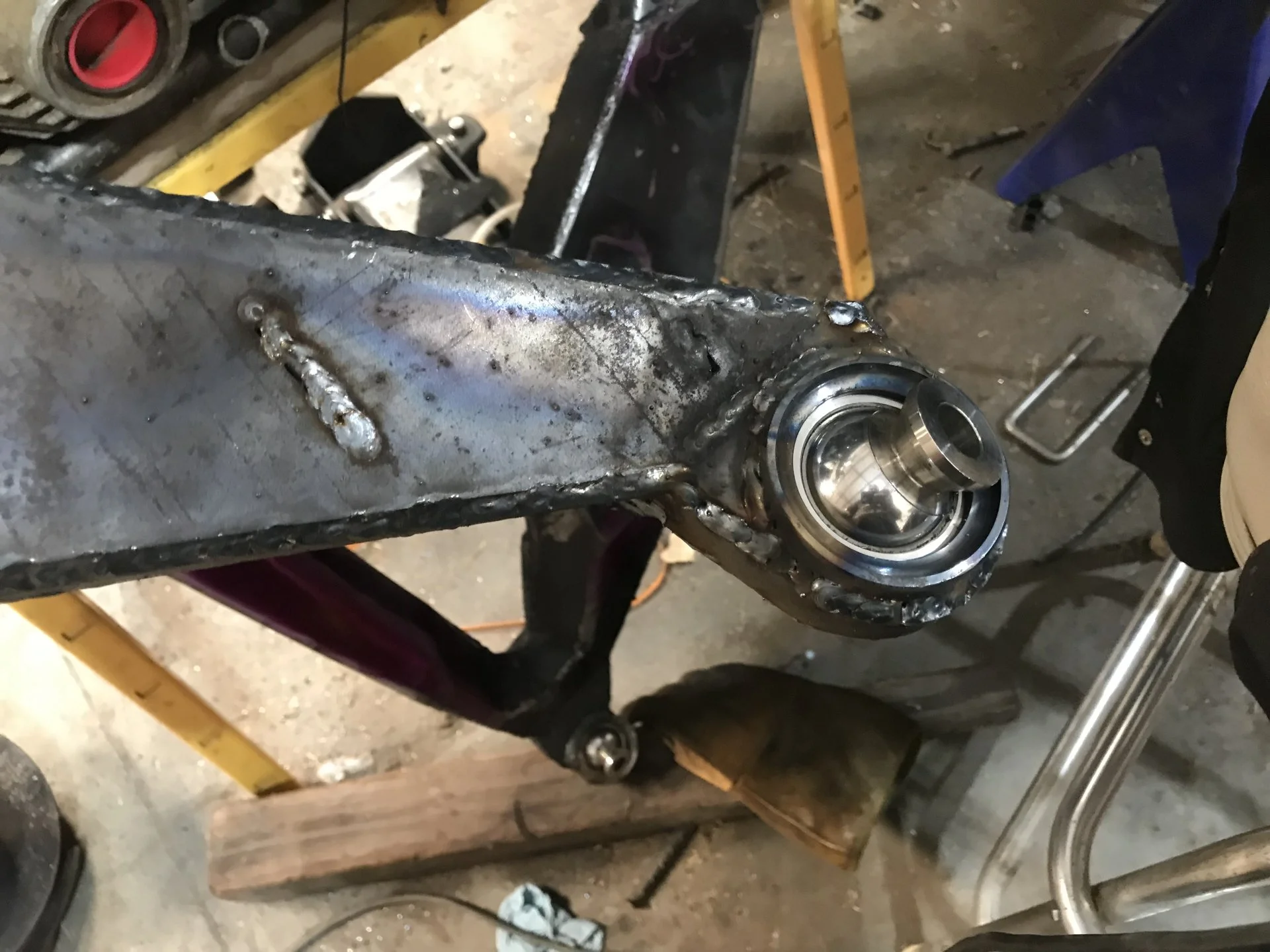

Got a rough tack in

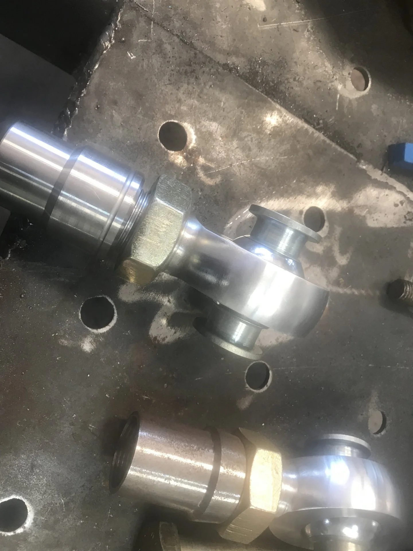

Going to have to cut a couple different parts as I have 2 different hiem bung sizes but every looks to line up pretty good

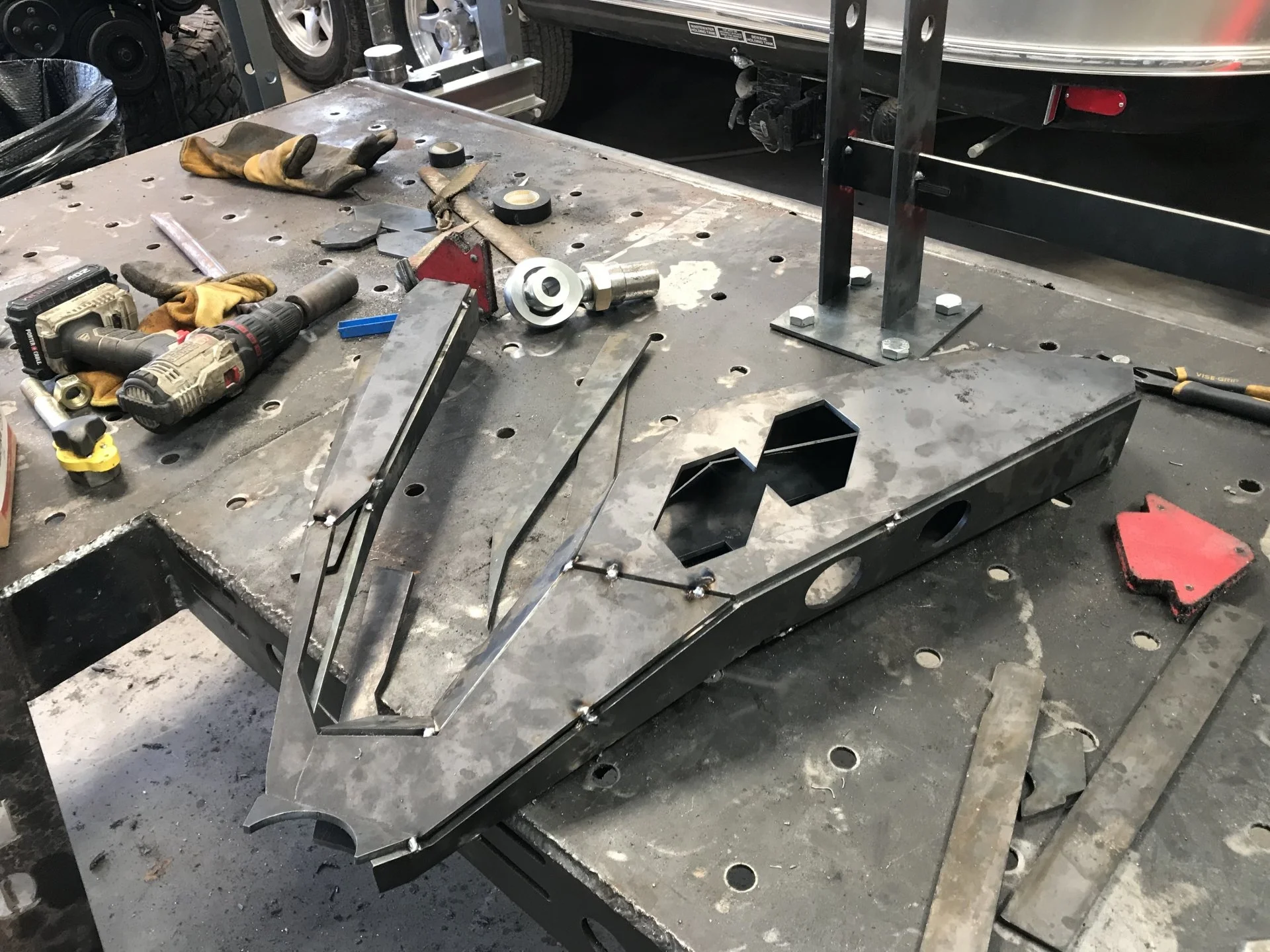

Dialed the track width down in the front to match the rear at 86” with 12.5s still plenty wide

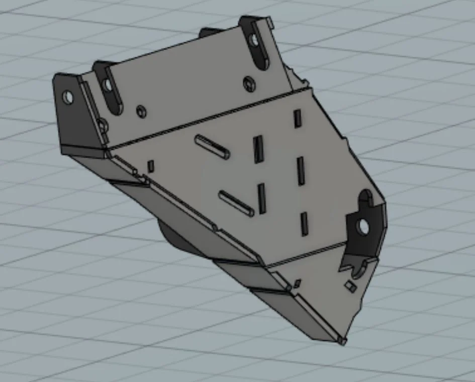

Added some ribs and decided to thicken the bottom plate from 3/16 to 3/8” for added strength and so it can be used as a skid

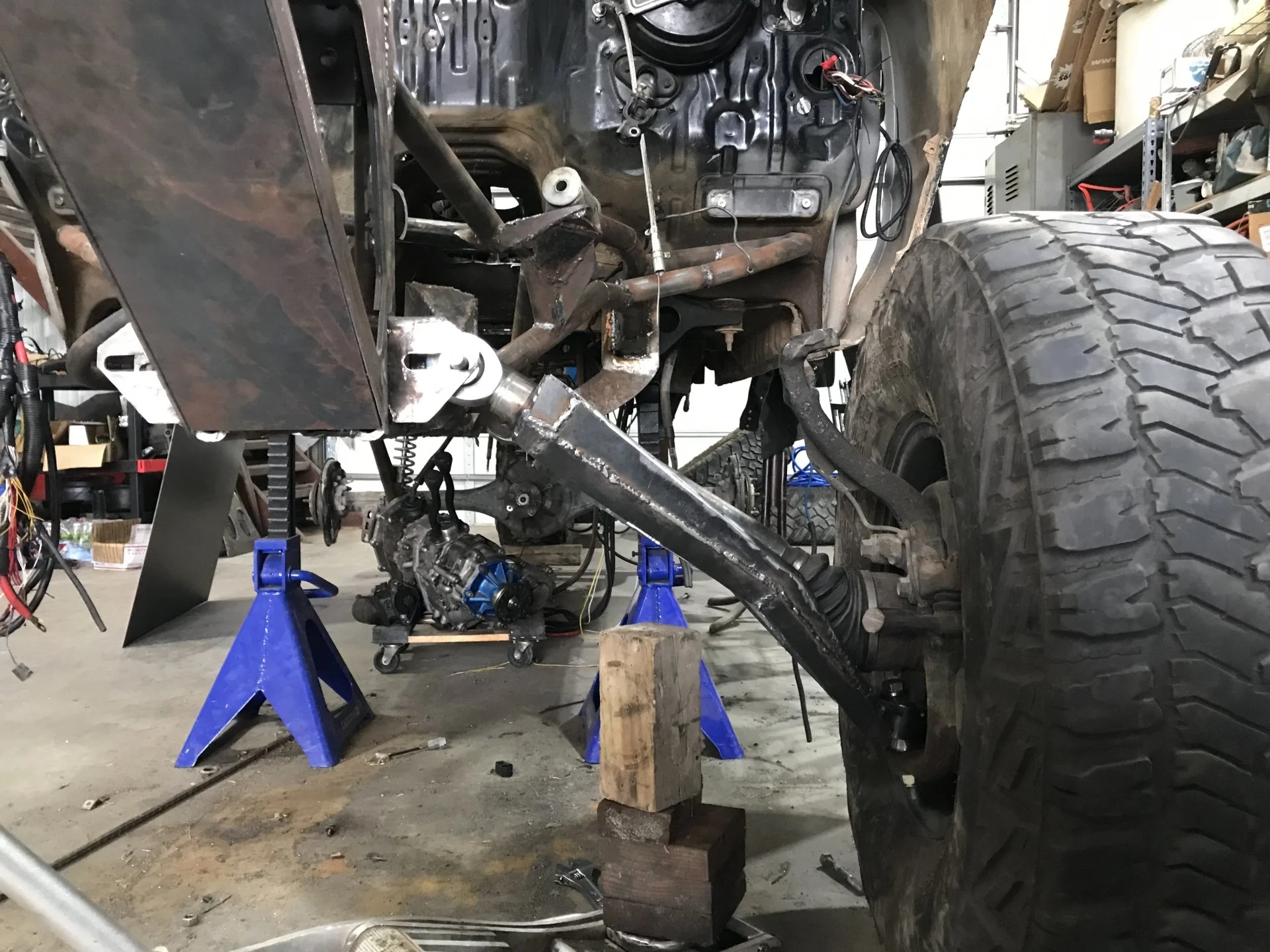

Looking like I might extend the arm by an inch to allow for more clearance near the cv boot
It’s touching but only just a little

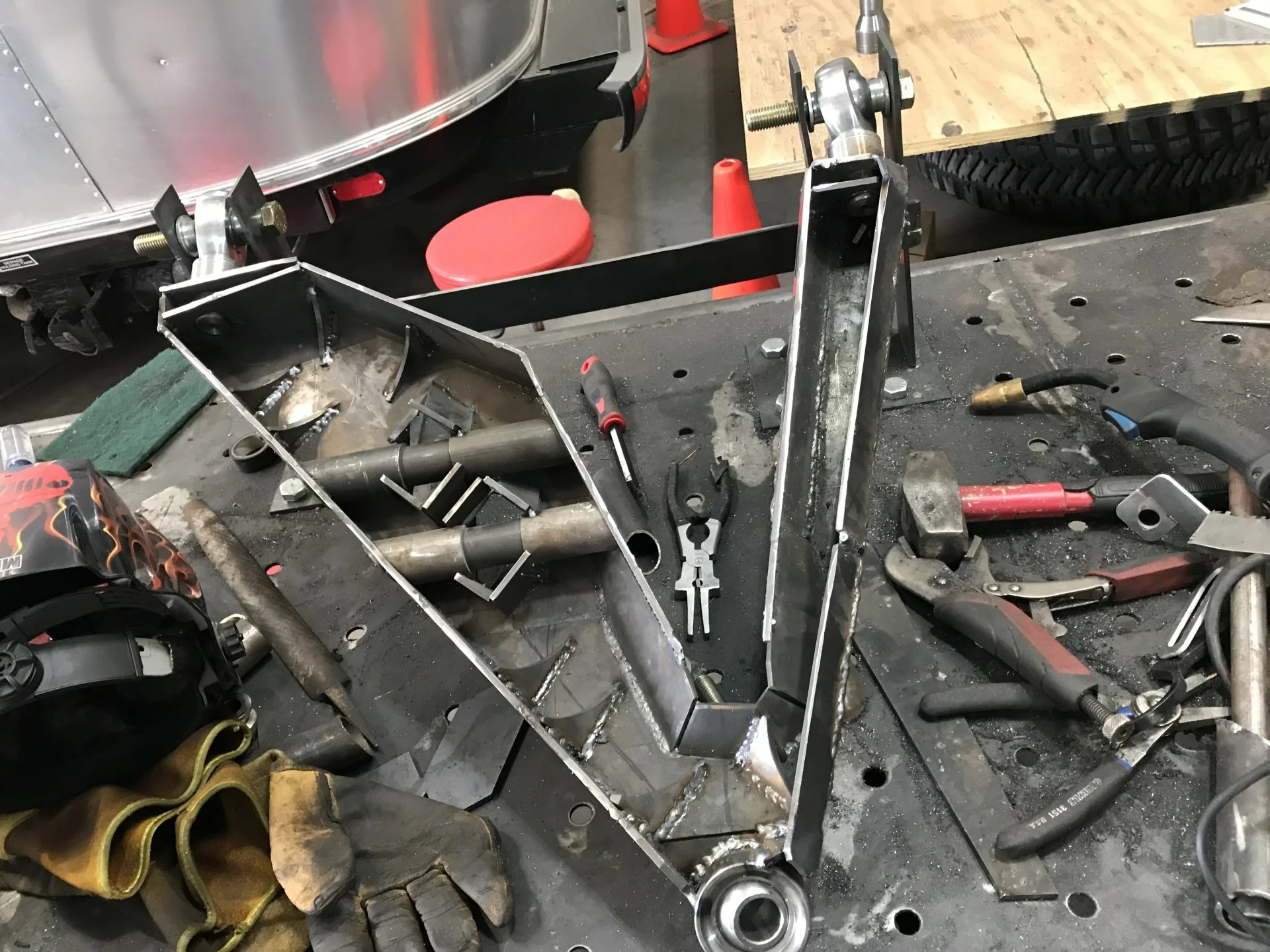

Got an upper arm tacked together
Decided to double check before I cut another one out and weld it together a little positive camber at full droop a little negative at full compression
Should keep the tires flat when turning hard

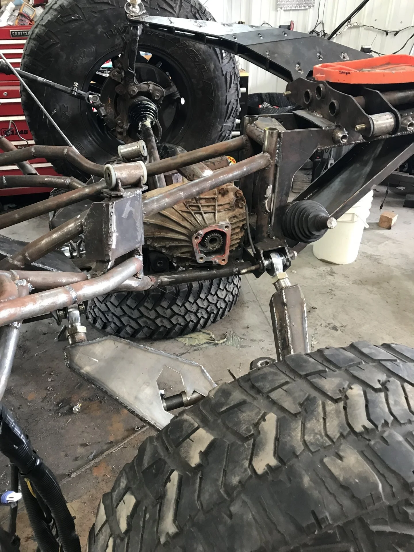

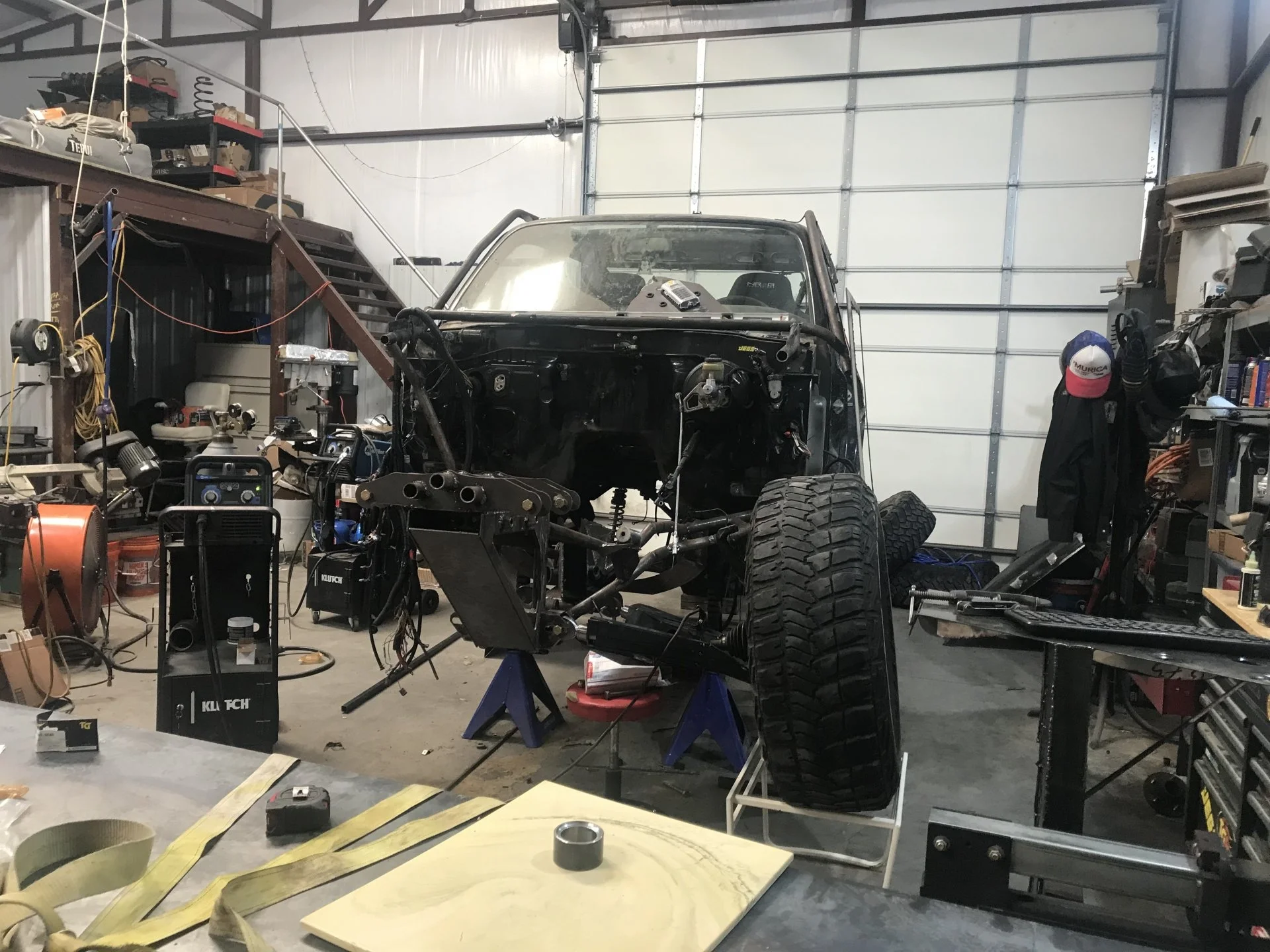

After learning more about differentials ie reverse gears and which way a drive shaft spins and all that
I decided to go to a tundra front diff instead of a Supra mk3 rear
Because strength
And
Reverse cut gears

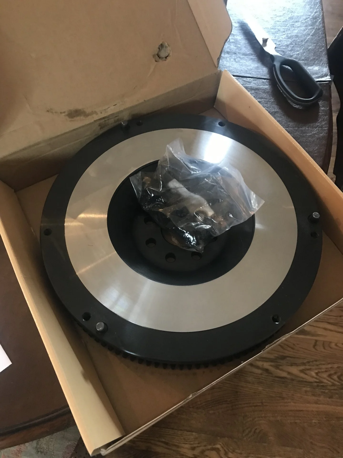

Decided to go with a slightly lighter flywheel not by much stock is around 30 probably
Mostly because price and finding a oem flywheel
This one is 19lbs
Also throwing a more aggressive clutch on there
Will be interesting to see how it drives
