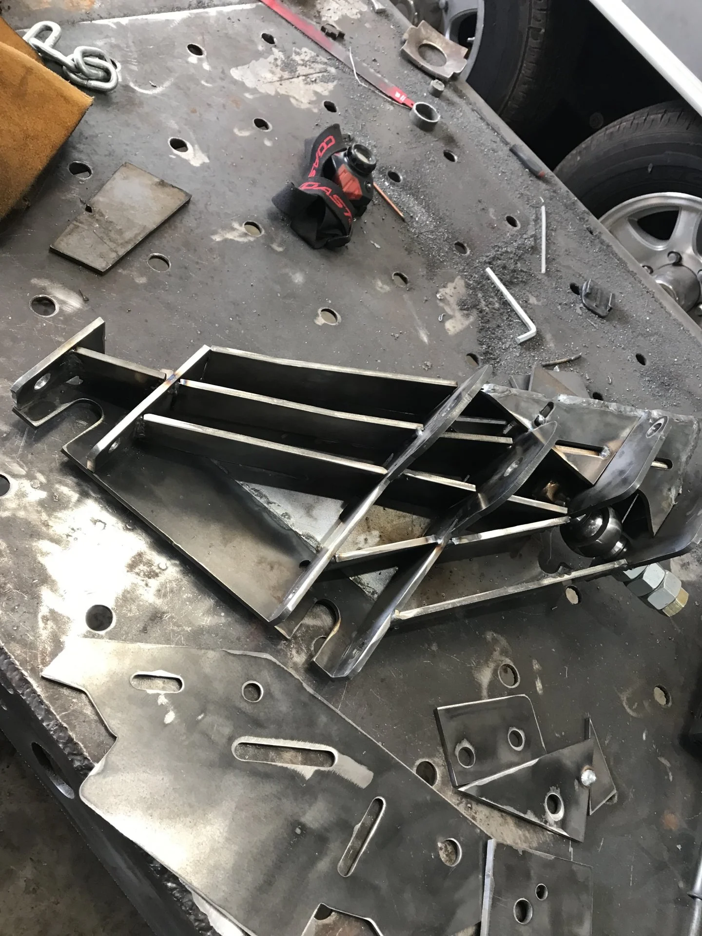

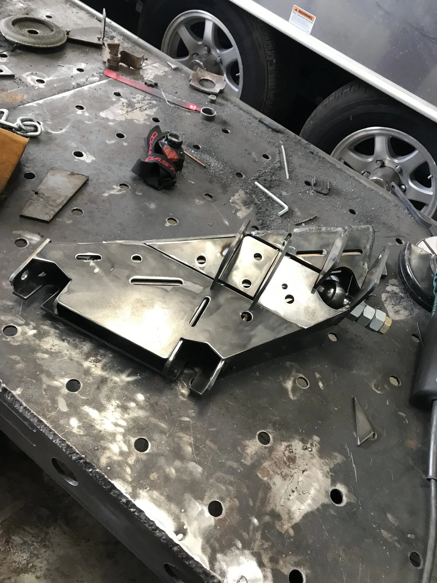

cheap'd out on welding jigs and now im cutting out new ones
I need to design some that are more adaptable so I don't have to cut out new ones all of the time, they aren't so much for positioning as they are mainly for fighting warp.

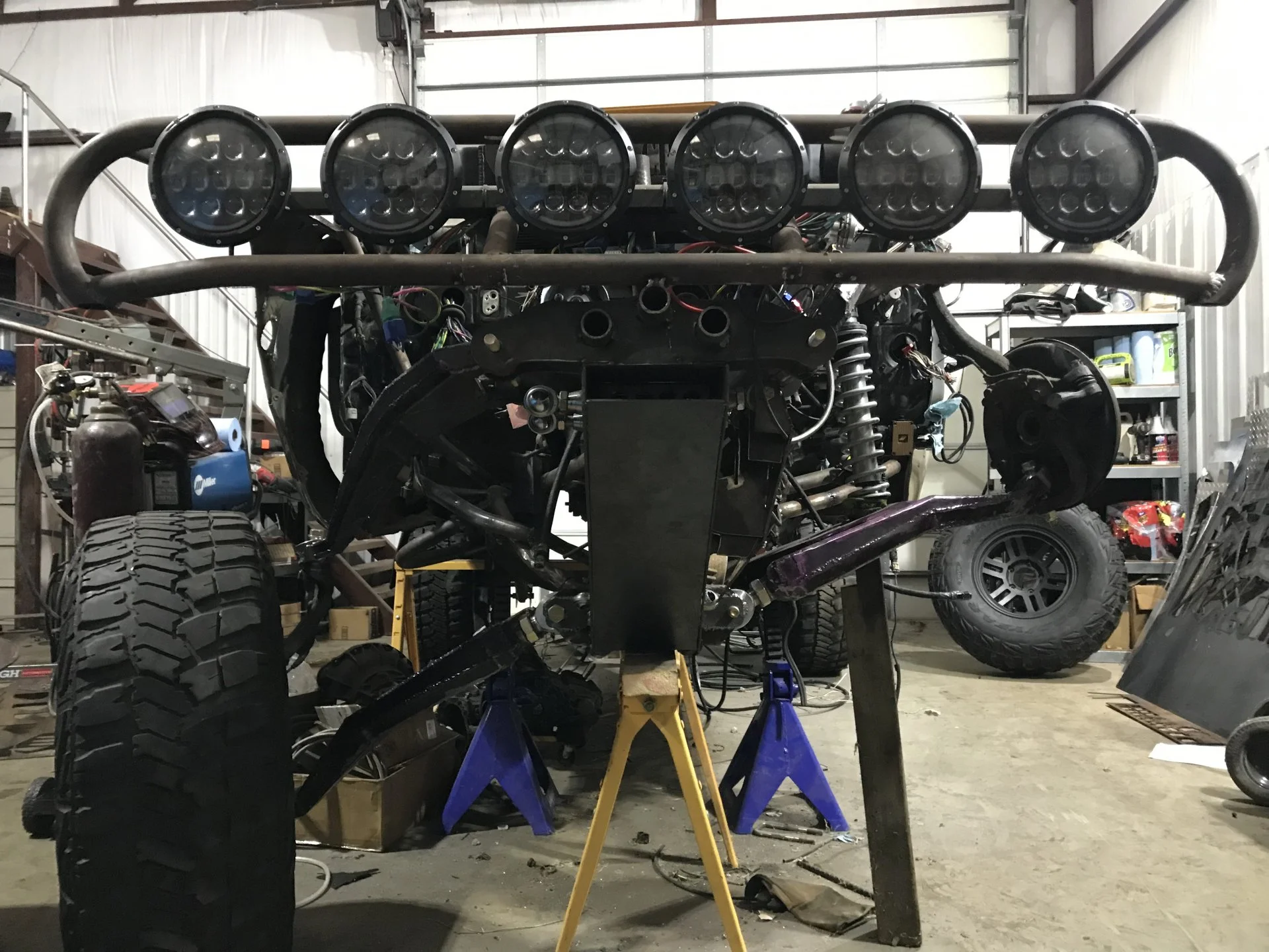

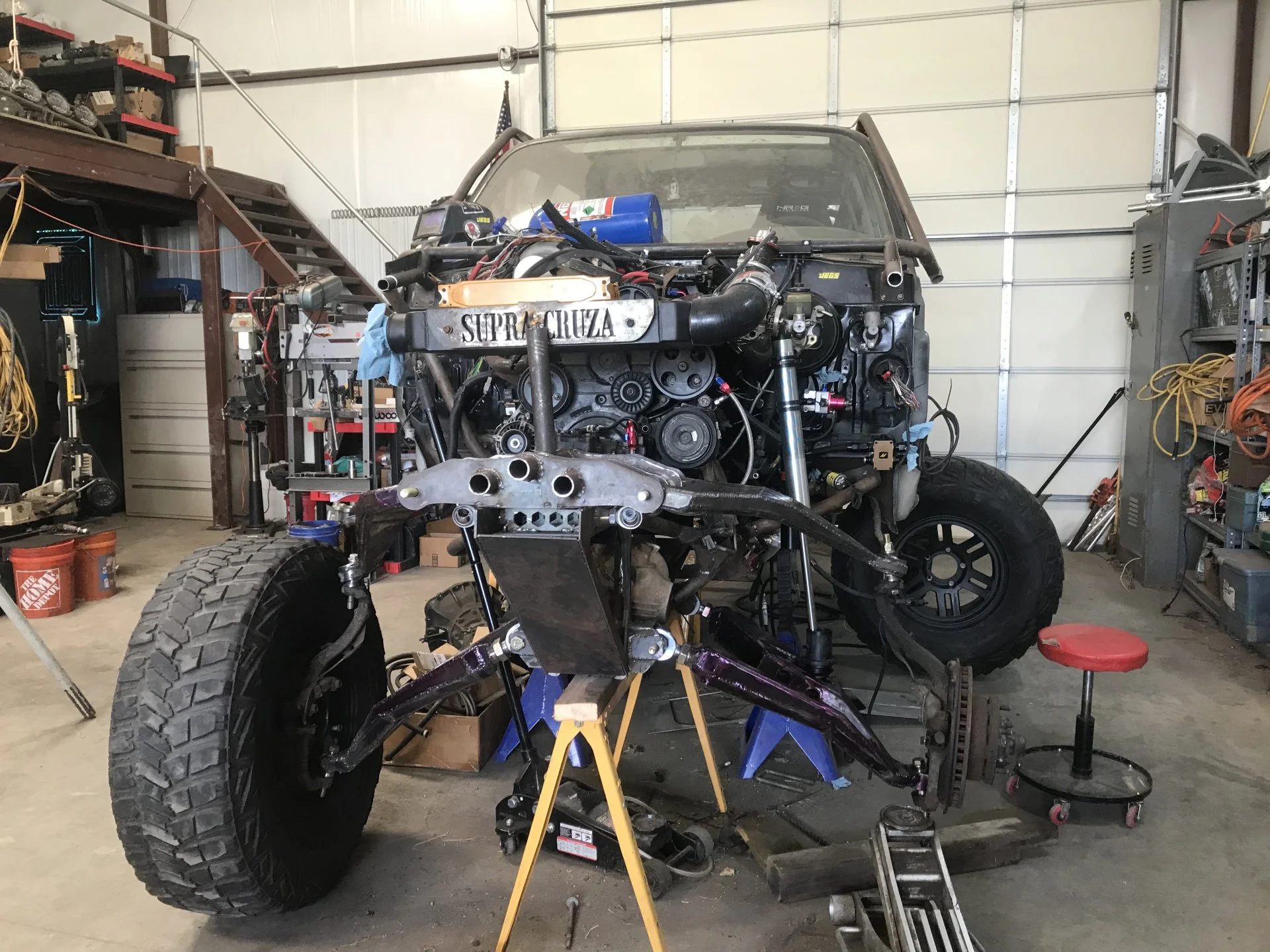

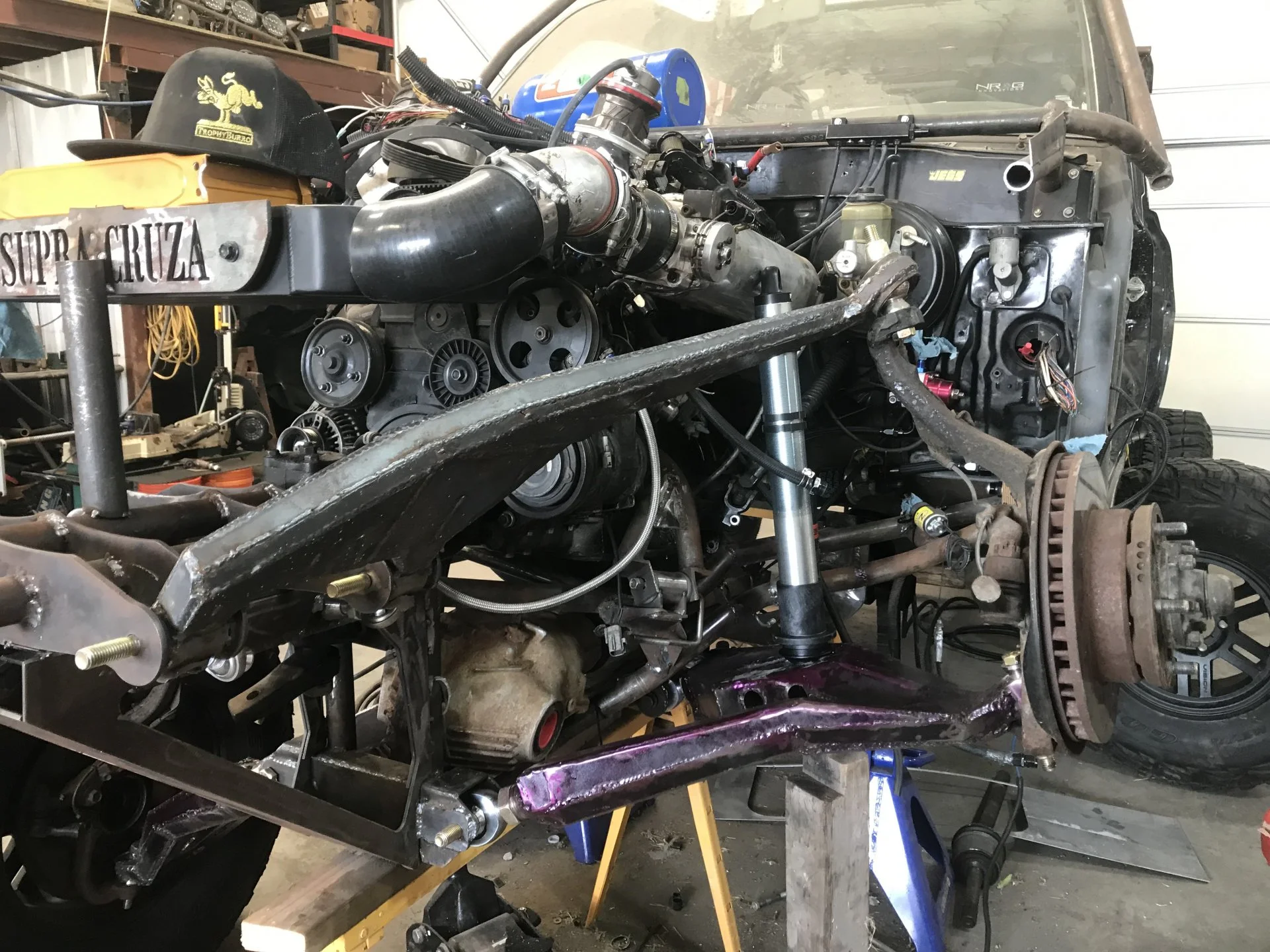

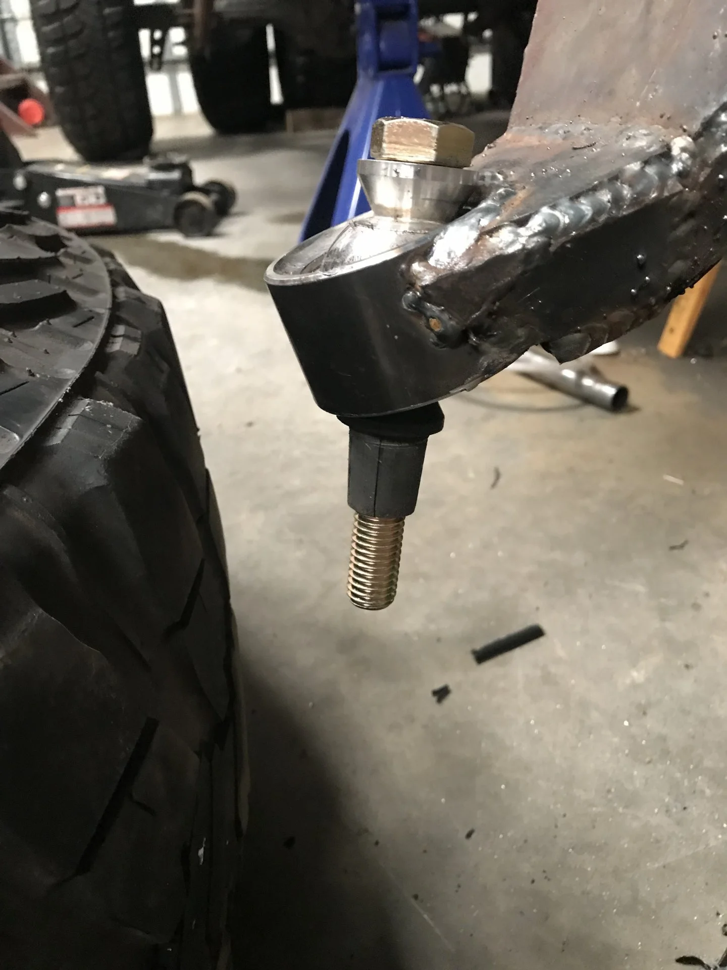

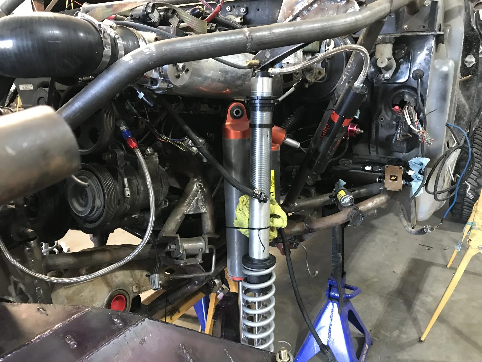

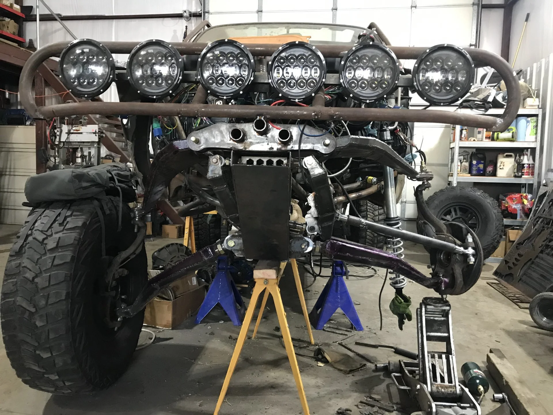

I think I have a solid plan in place for the top mount steering is coming along gotta grab more hiem joints

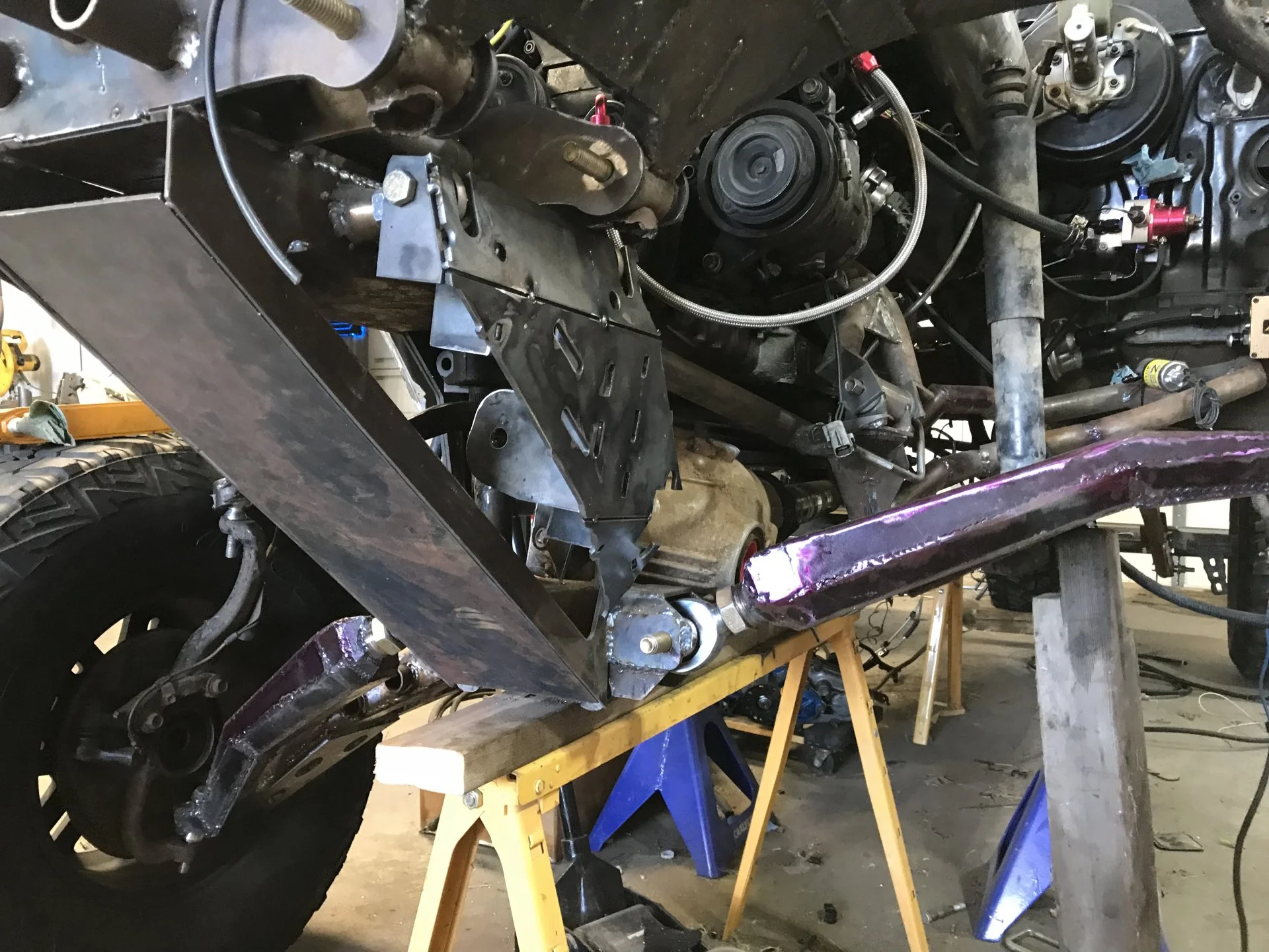

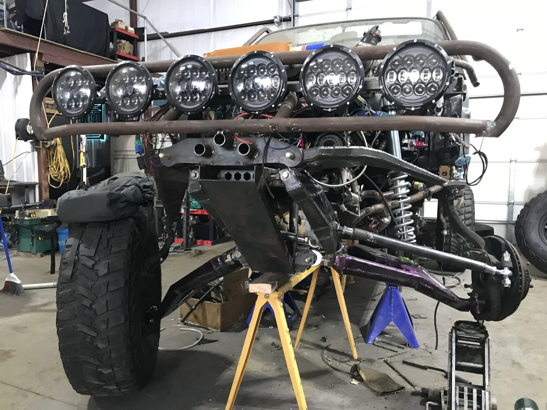

Swing arms are done
Still playing with everything but
Looks like bumpsteer is pretty minimal
When I beef up the spindles I’ll add adjustability to dial it in
Coilover mounts are next

Ackerman angle is looking good checked this with a blue bucket and some chalk so 🐻 with me😂
Bumpsteer is looking good even when turning
Hopefully better than a normal steering rack, it should be.

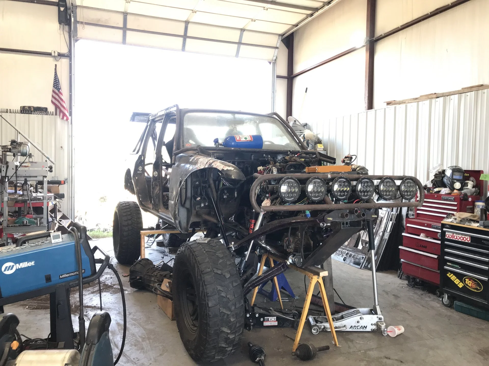

I should be off the Jack stands soon doing the part of the cage that they will bolt to right now
It’ll probably be on its belly for a couple months while I do wheel wells and wiring, maybe more.
Tubes are where I want them far as I can tell and there is no way fenders are going to fit will have to do some sort of wide body (attempt 2)

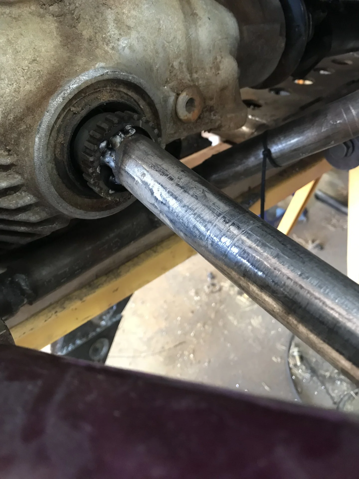

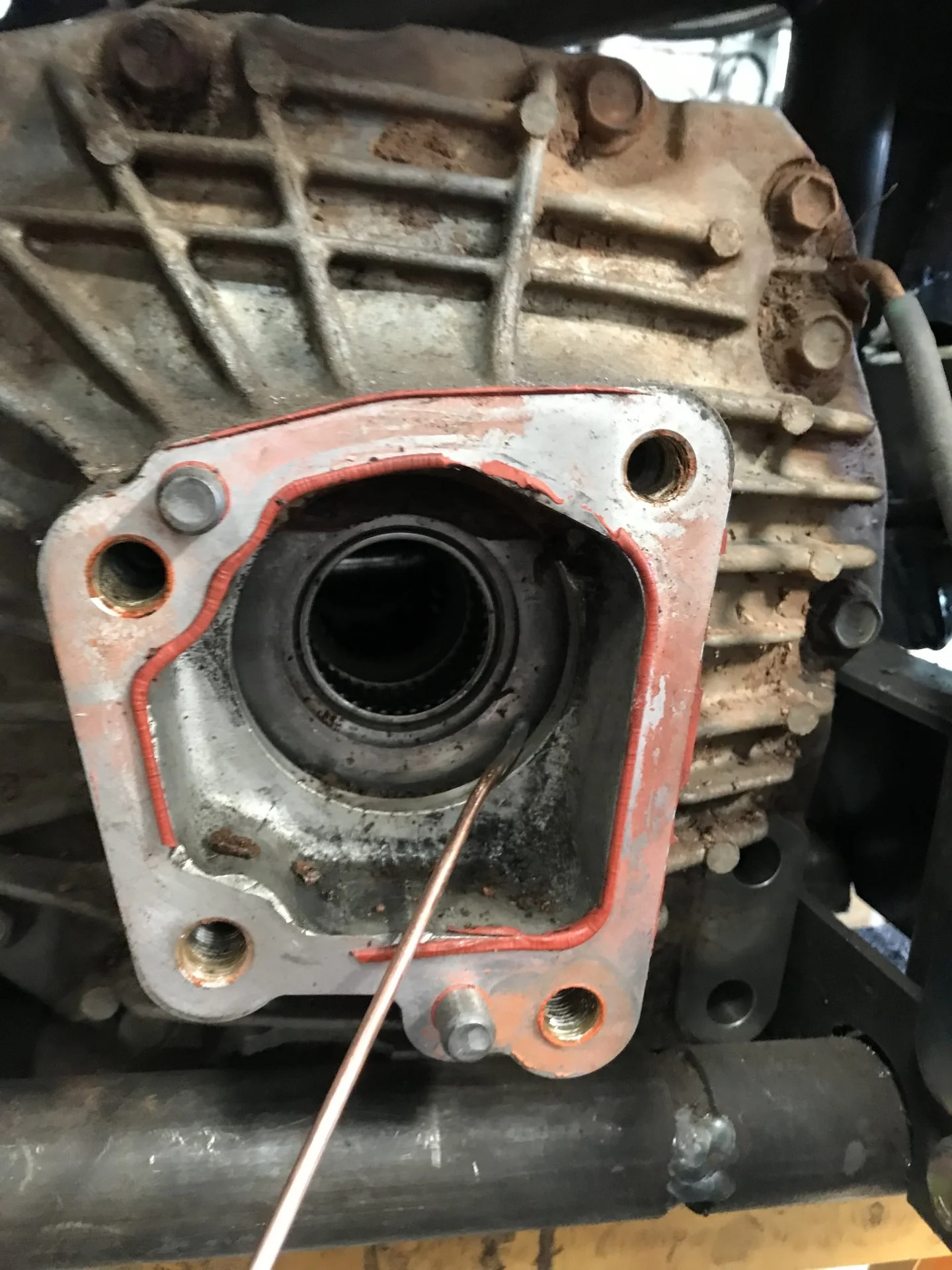

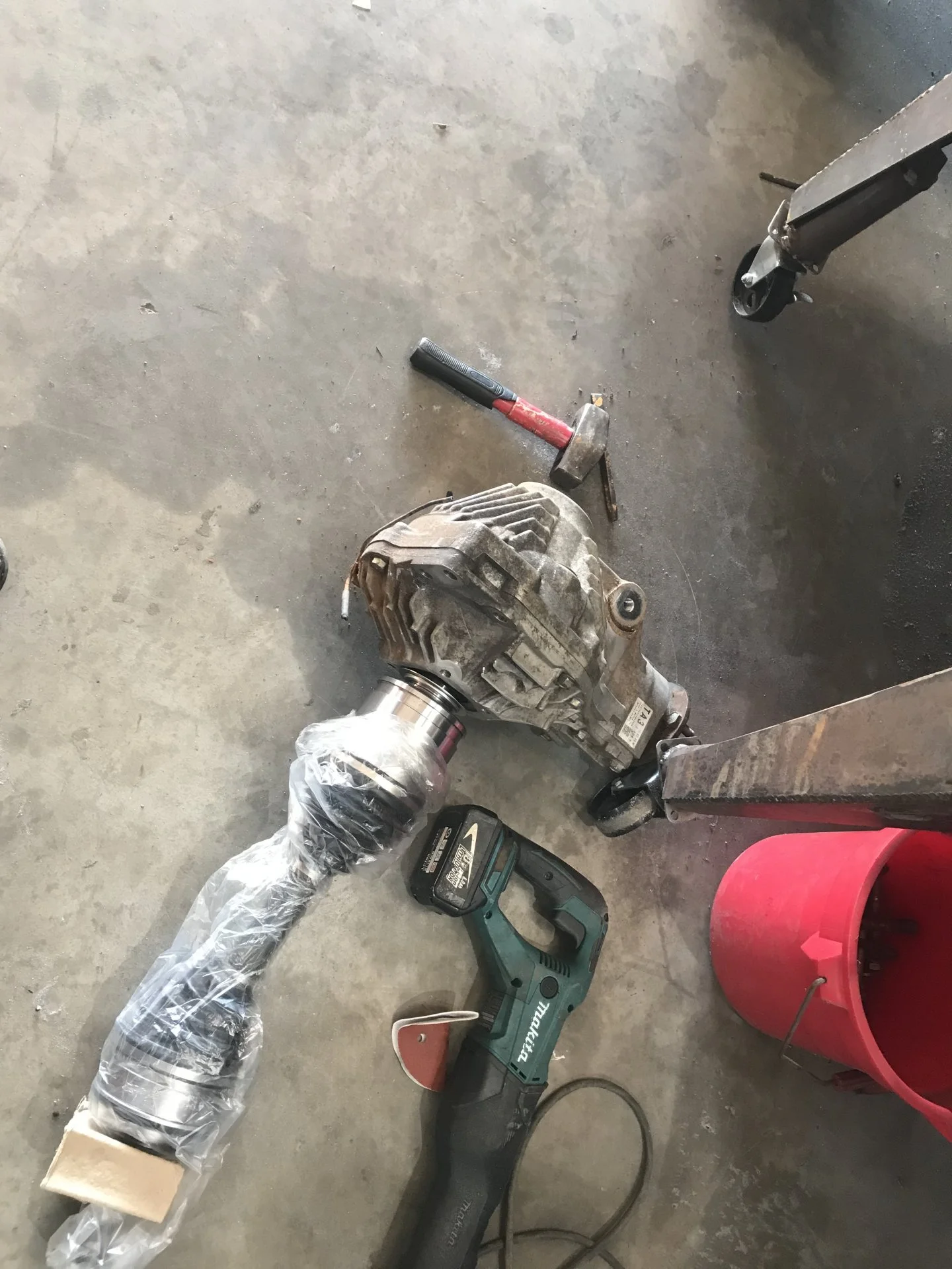

The slip gear that goes on the ADD side of the tundra diff plugs into the other side so that’s good
Bad news is that the ADD side will have to get machined down by about an inch
I might just get it with the angle grinder to prove it’s possible
Looks to be the same depth as where it looks like another seal belongs matching the other side
Maybe it was meant to be
Outside of me pressing the seal in way too far like a DA that is a center mount tundra front diff, probably the first of its kind
Definitely not the last

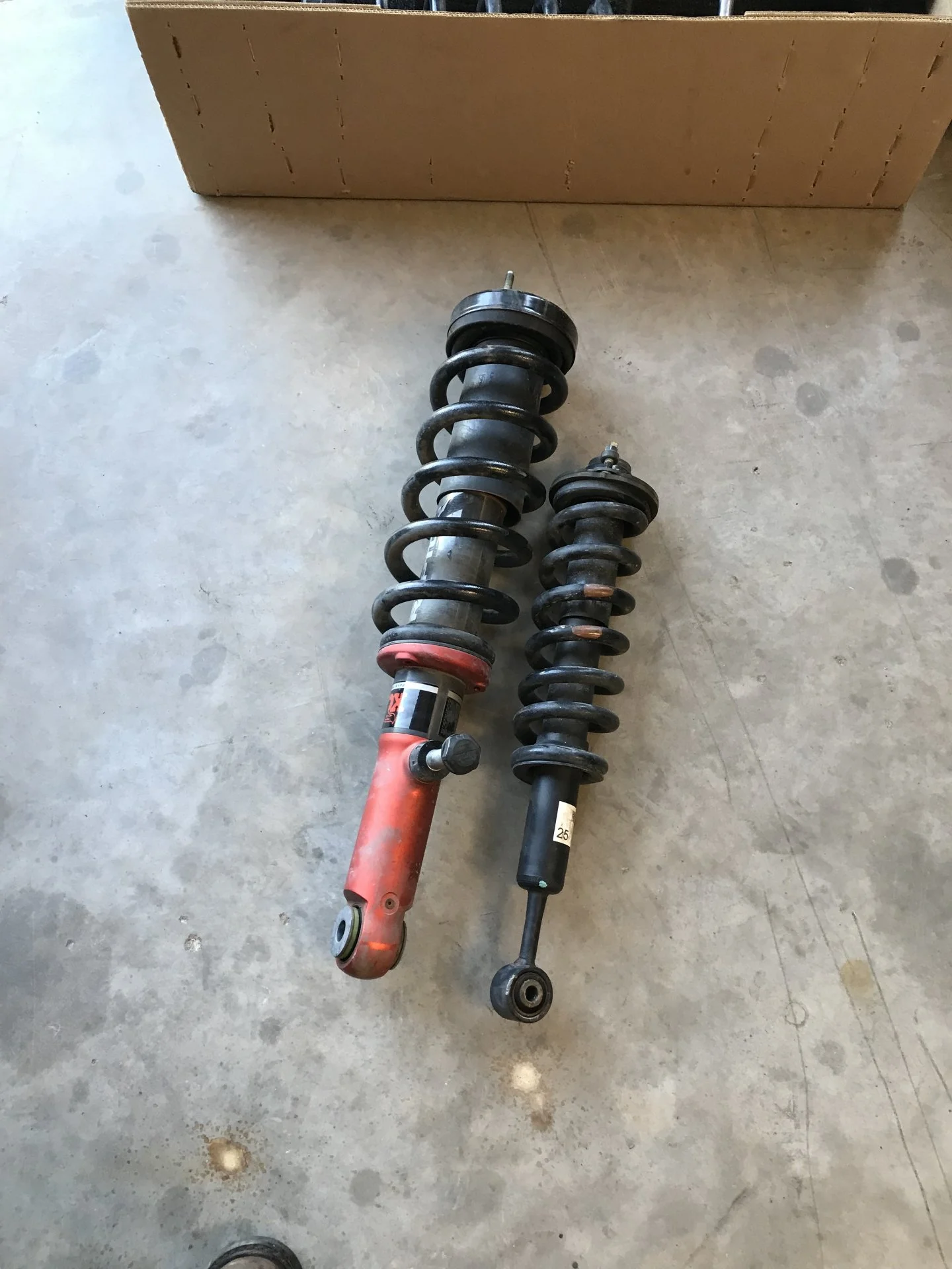

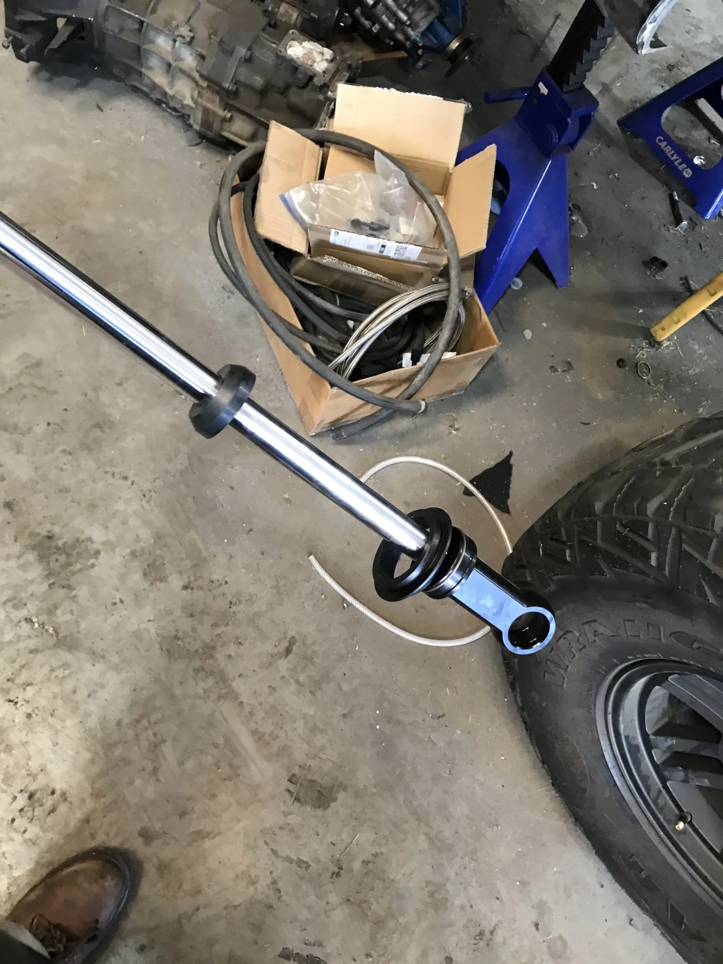

Got some 3.0 raptor shocks for the front should have plenty of dampening and everything is clearing…
For size comparison here is the fronts vs stock 4runner stuff
Getting these machined then this thing will be off of jack stands
