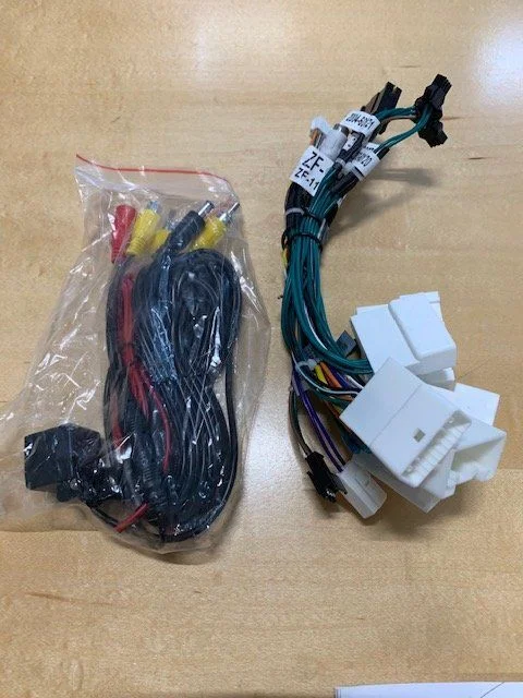

I have gone back and forth with the supplier of the unit I purchased on the included wiring harness for the 2003 model. I recently received a replacement that is a correct plug-in-play for the 2003. They referred to is as a "top model" application. Good news is it exists and works :)
I also purchased their back up camera at the same time.

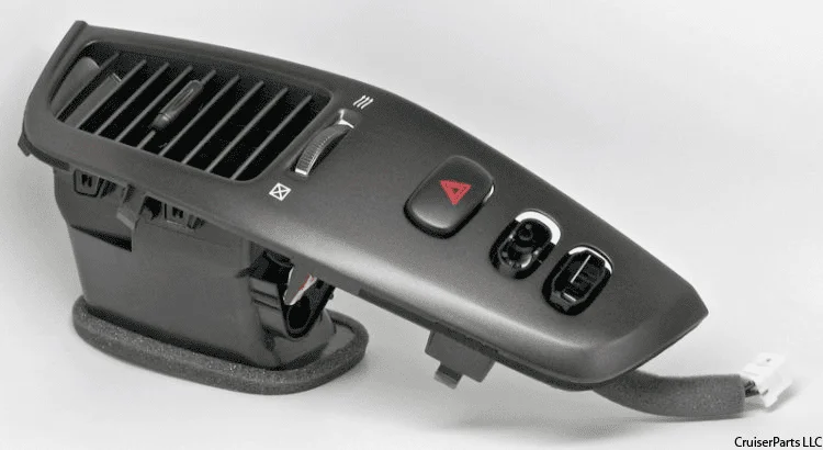

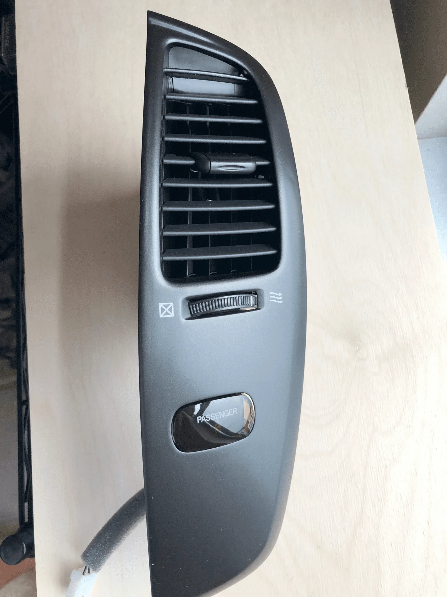

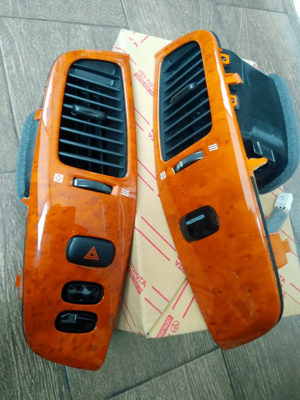

Does anyone have part numbers for the two side vents with and without the wood? I’m down to buy one and try it out.
Looking for a better fit but the gray will be darker then the trim of the Tesla screen
This might work 55660-60170 and 55670-60110 from Megazip but is appears to be darker then the LX wood ...its called Sandalwood and is probably not wood. Maybe just the gray plastic would be better. 55660-60190 and 55670-60130
What supplier did you get this from?. my unit has no climate control or audio. I need this harness.
