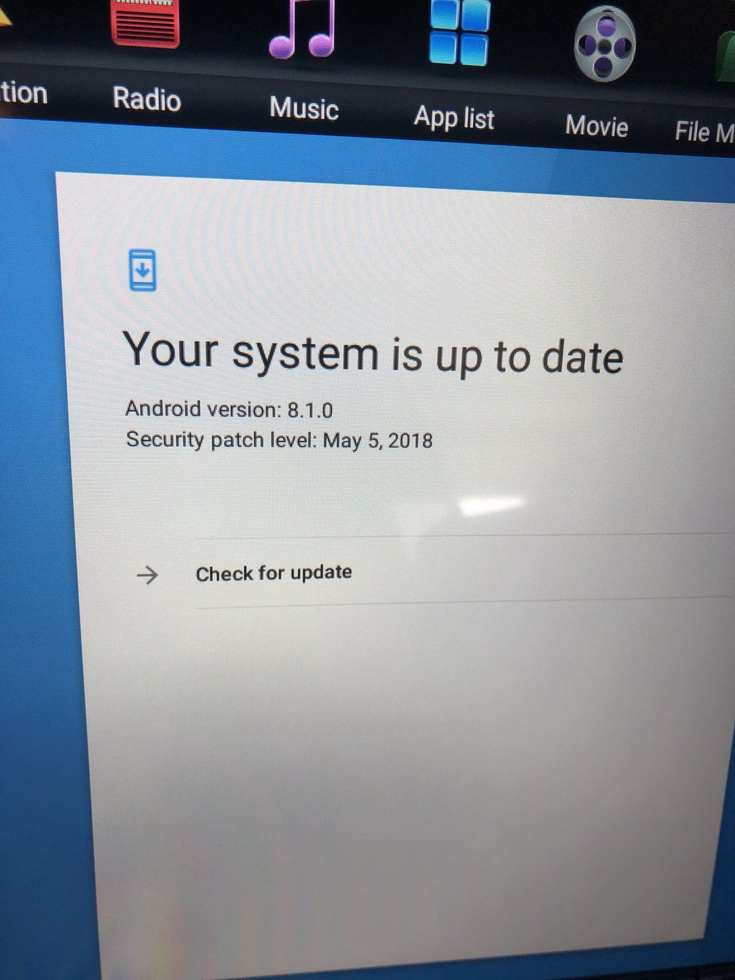

Partly thru the newest 6 core install. So far looks promising. Waiting for my new amp to come in but it powers up and AC works good. Says PX6 on the home screen and system info says 64G and Android 8.1.

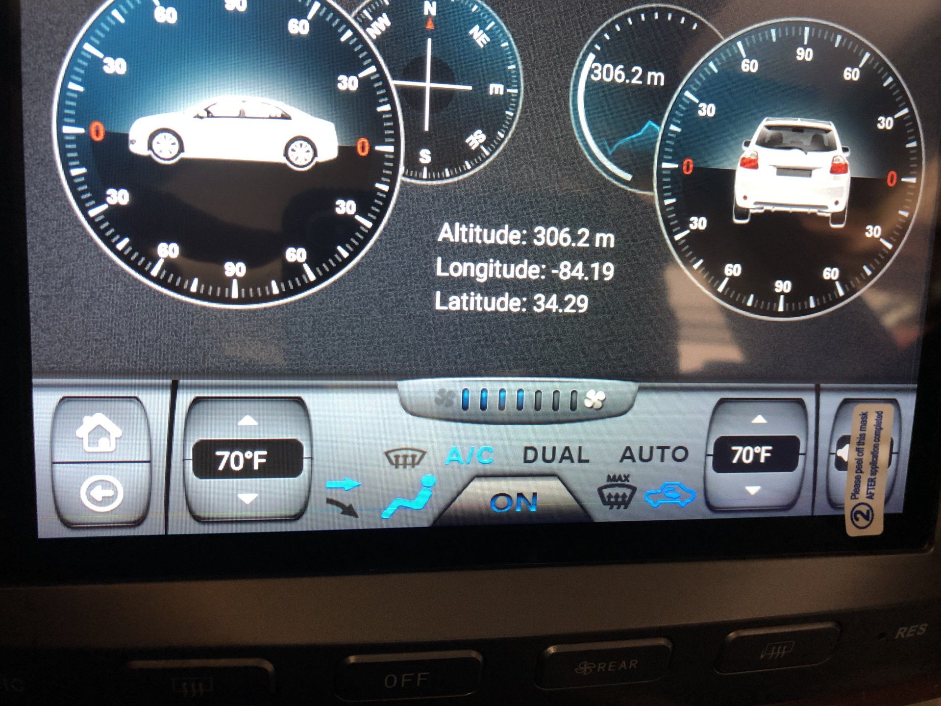

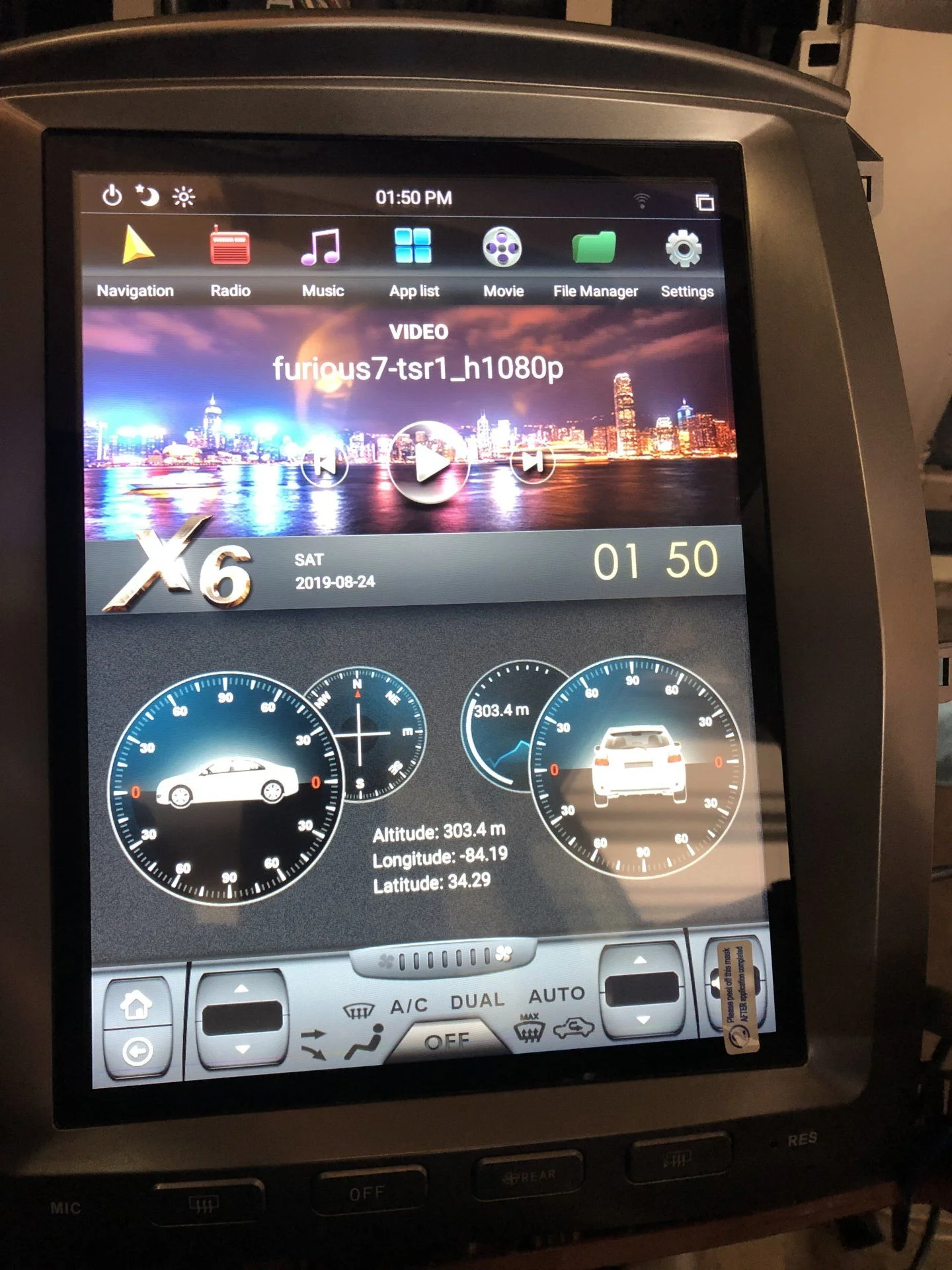

Good news -- I managed to get the new PX6/Android 8.1 unit installed in my 2006 LX470 tonight. All of the harnesses were an exact match from the PX3/Android 6.0 unit that had been installed, so this time it was really just a matter of transferring the OEM black box over to the new radio and swapping the vents/buttons from the grey plastic side panels that came with the PX3 to the faux-cherry burl wood side panels that came with the PX6 unit. (They're a big improvement.)
Happy to report that all speakers and the subwoofer work perfectly; a rousing success all around. The PX6 is also blazingly fast compared to the decade-old PX3, which is over-matched by nearly all of today's "staple" apps like Waze, and pretty much all streaming video. If you're considering buying a PX3 unit to save a few bucks, don't. You will regret it immediately.
Anyway, here's a brief rundown of my initial impressions of the PX6 head unit; happy to get additional specific shots, if requested:

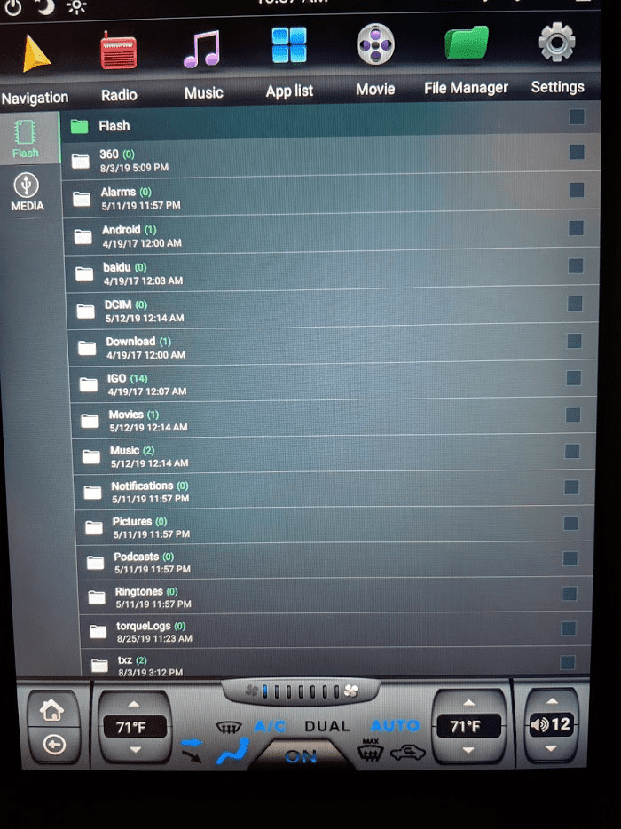

LOL can't find the USB source in the file manager - Can you post pics?
This is a shot of the newer version, which is a bit different from the units running Android 6. If you have a USB drive connected, when you go to File Manager you should see it on the left-hand margin (mine is labeled "MEDIA"). You may need to scroll down a bit to find it, depending on which version you have.
