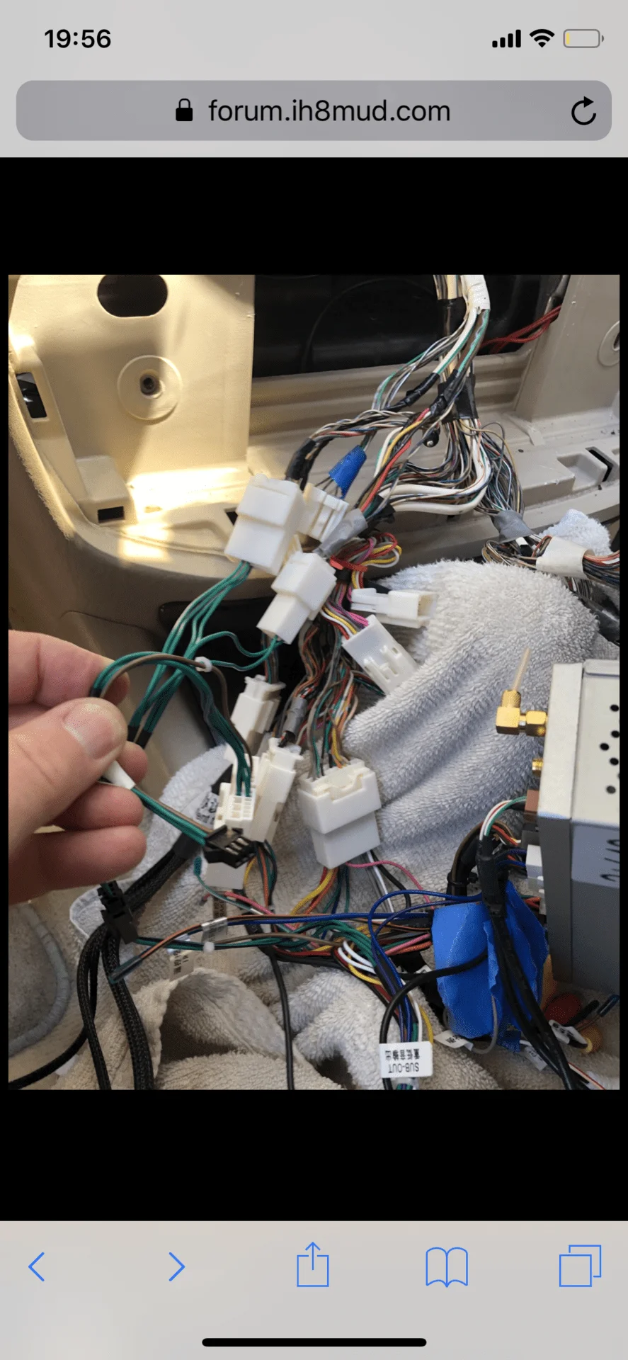

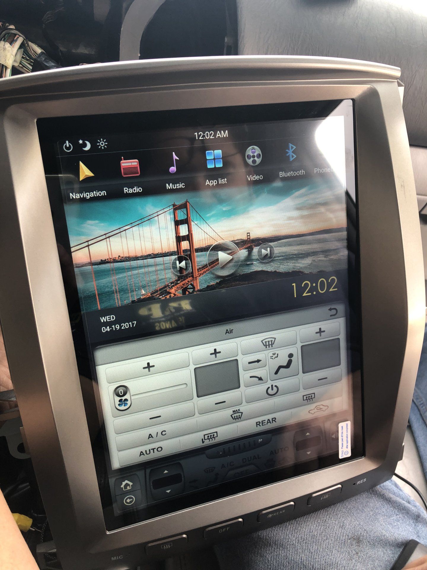

I am trying to install the screen in a 2006 Land Cruiser but after installing everything and connecting all, the A/C controls don’t seem to work. Can anyone please help me with this situation?
Attached are the pictures of the installation and how the A/C controls look.

It looks like you connected the factory harness back into the black box so there's no connectivity with the Tesla. Pull those three out and look at all the connectors that came with the radio and see what matches up and try again.

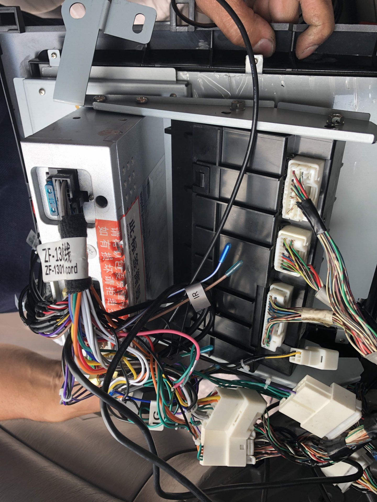

None of the cables that came with the Tesla Screen can connect directly to the black box. Only the factory harness can connect to the black box, is some cable missing? They talk in other forums about a “Main Harness for - Premium Land Cruiser, 12.1" Vertical Screen Android Navi Radio for Toyota Land Cruiser LC100 2002 - 2007 - / 2 g ram 64 g rom × 1”. Can this be the issue? In case it is does anyone know where I can find this cable?

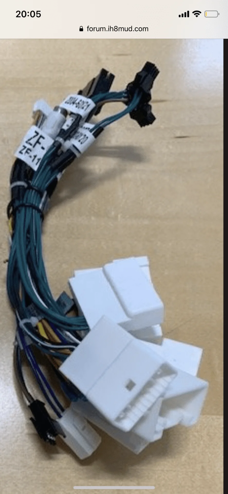

Yeah, it sounds like you're missing cables. There should be a smaller black box labeled "Canbus Decoder" included as well. The below thread has a picture of the correct harness in the first post. You'll probably have to ask the seller to send you that.

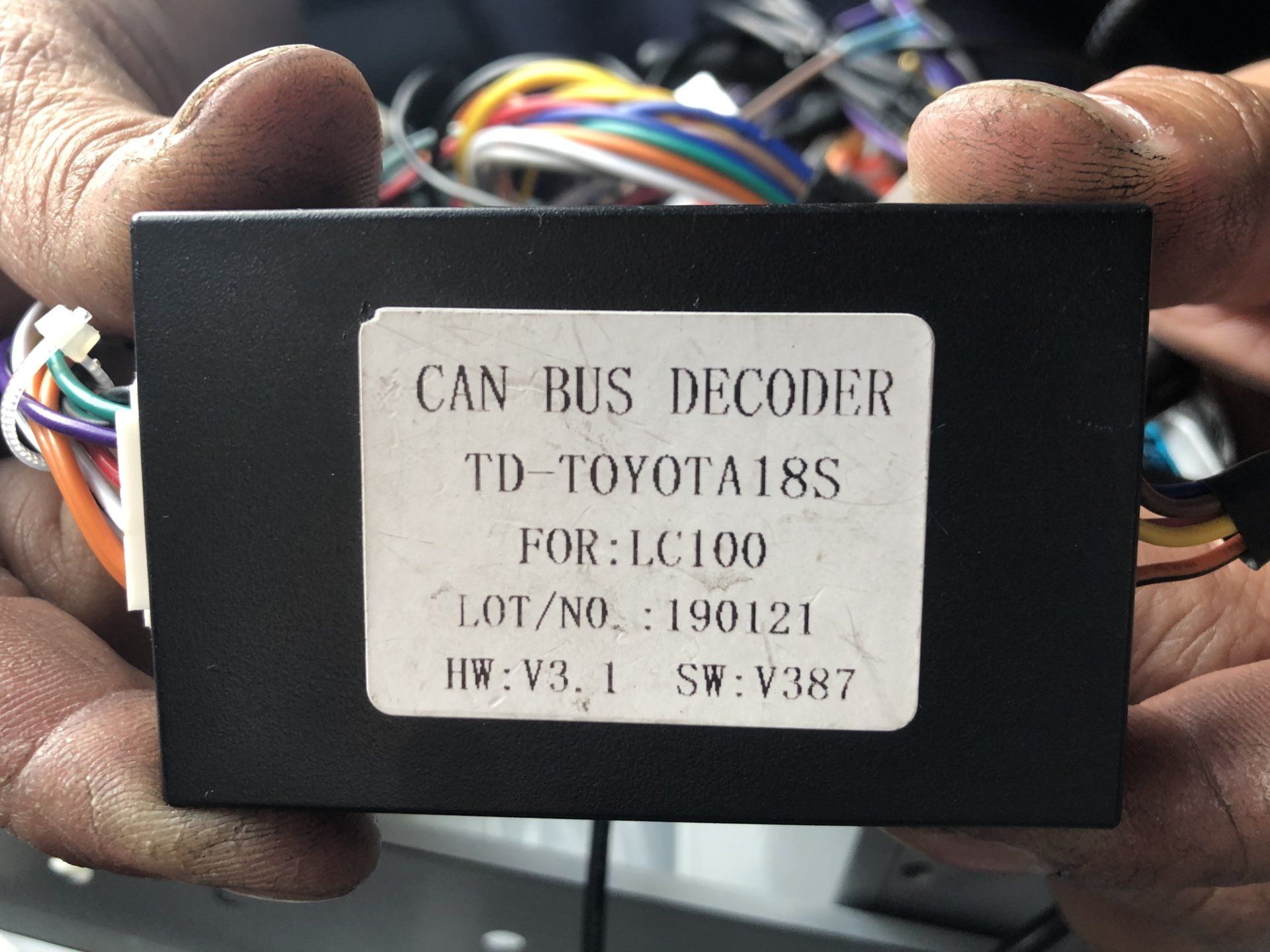

Isn’t this the “canbus decoder”? Because it was also installed and didn’t work.
The decoder is for the antenna switch and diff lock if I remember correctly. Did the picture from the other post help identify anything missing?
Looking at the other picture I seem to have the same parts and all of them installed similarly but unfortunately the A/C control isn’t working.
Looking at other treads it seems like some people had to order the “Main Harness for - Premium Land Cruiser, 12.1" Vertical Screen Android Navi Radio for Toyota Land Cruiser LC100 2002 - 2007 - / 2 g ram 64 g rom × 1” (attached is the picture) in order for it to work.
I am looking to contact someone who has this premium harness in order to give it a try but if someone knows a different way to fix this issue I am open trying anything.
