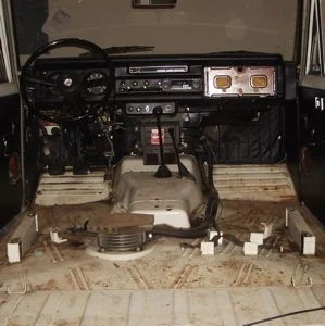

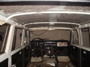

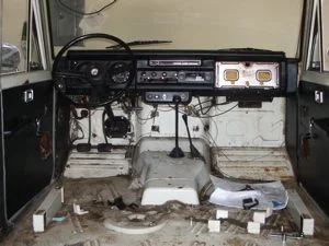

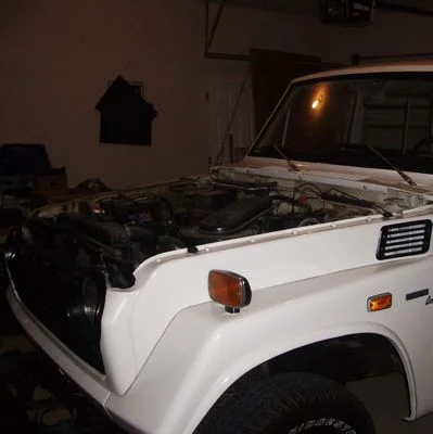

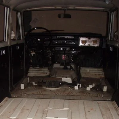

Headliner Down, Heater Out
Here are some more interior shots as she sits today.
