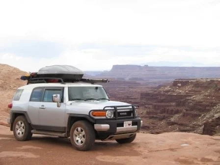

In this pic you can see that the rear is sagging a bit--and it is exactly when I don't want it to--during wheeling.
