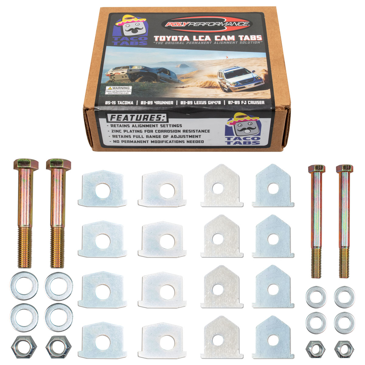

The cam tab on the chassis are known to be weak. If the tech did not torque the bolt properly it would move.
There are products to fix this problem. The cam tab are even a problem for people doing alignment.
