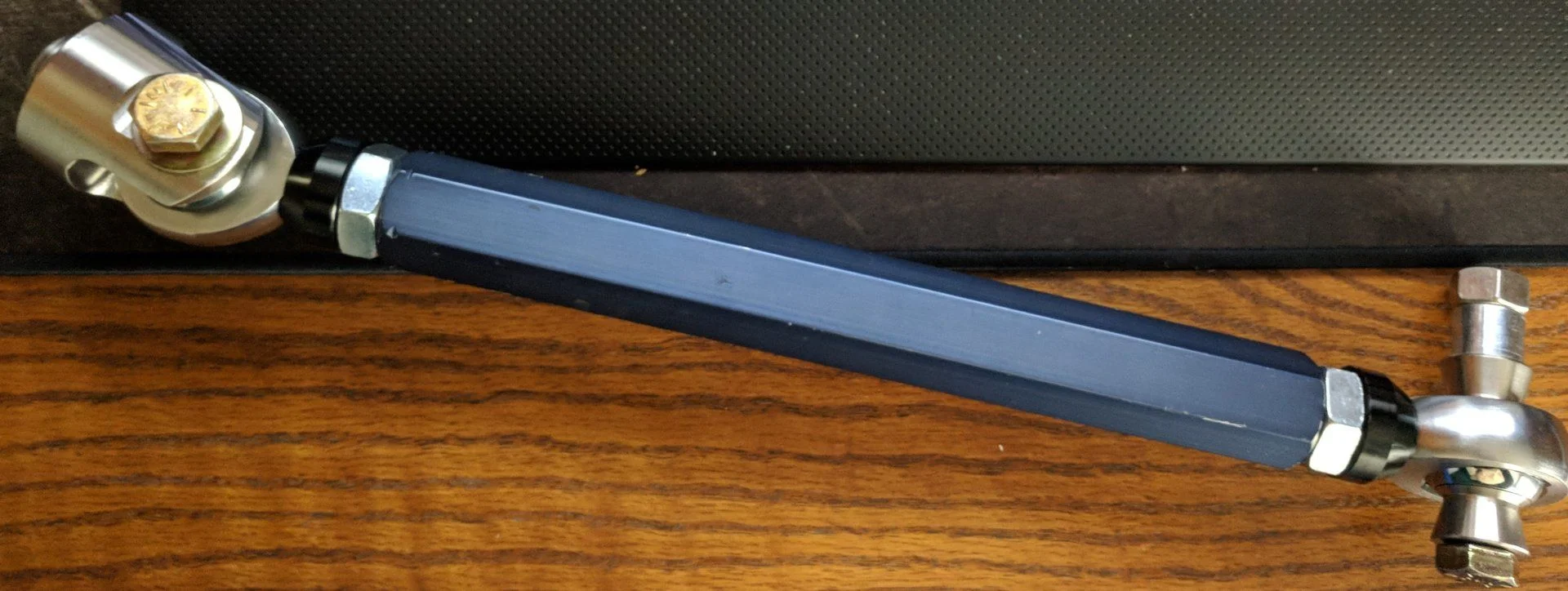

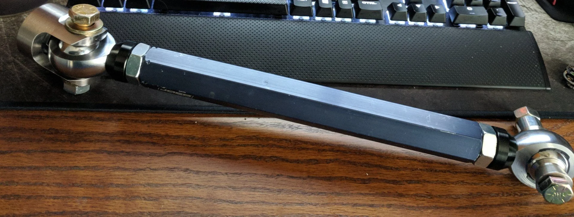

Hey all,
I know a few people have installed the older FJC steering racks (2006-2009) in 2010+ FJC's. Are they a bolt for bolt swap? Or do you have to modify anything? (I've read mixed articles on this)
I'm pretty close to needing a swap, and have some tie rod parts that are not compatible with the 2010+ steering rack. Inner tie rod end on 2006-2009 is m22x1.5, on 2010+ it's m24x1.5. Already purchased Camburg tie rod end clevis, they said it would fit, didn't. Long story short I still have them and would like to use them. And no one else to my knowledge makes them in the correct size.
Also looked around to see if I could find an adapter, nada. Machine shop was going to be $200+ to make them.
Images attached at what I am attempting to install.
I didn't realize they changed in 2010+ models. I've installed a handful of racks in mine because they keep failing (to hold up to my abuse :smuggrin:).
