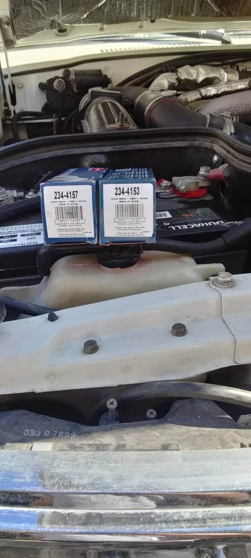

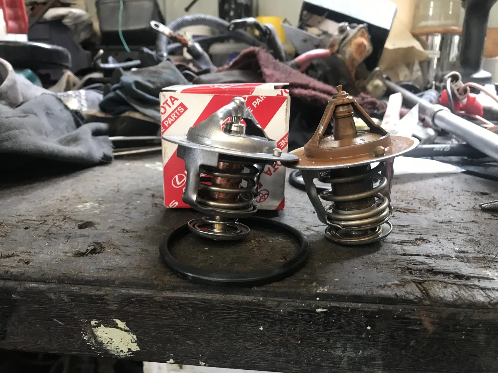

I put a diesel thermostat in mine when l turboed the 1FZ, factory was 82 degrees and l use to run about 86-88 degrees Celsius roughly.
With the diesel thermostat which is 76 degrees l run at 77-80 degrees Celsius roughly. A huge improvement in temps, currently flushing my cooling system which had some rust build up. I'm also running a large front mount cooler which should help intake temps.
How good are these things with a turbo, loving my new found power.
This is quite interesting and I'll need to try a cooler Tstat. 76 c = 168 F , which is much better than the 210F = 98C I was seeing this past summer. This is with a new Koyo radiator even.

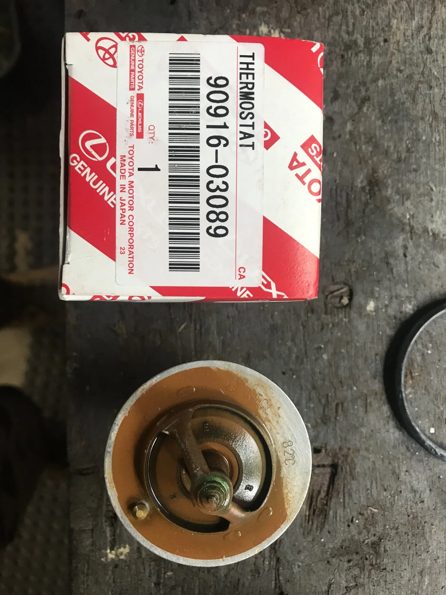

Here is the part number next to the old thermostat.
I forget who first said it but putting in a lower temp thermostat in a forced induction truck simply starts the overheating process from a lower temperature. They flow the same when wide-open.

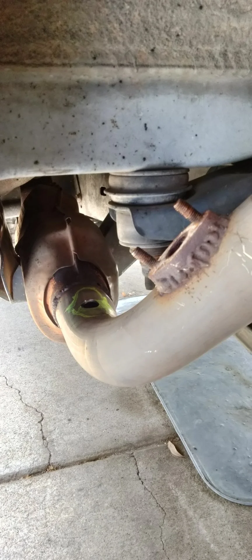

I got a p0172 last trip out so now. It came on twice during a hard uphill pull. I'm changing out the prior new o2s I put in during the rebuild with new brand ones. I'm drilling another hole and moving the o2 sensor where it should be. I originally drilled it a bit too high up the pipe. It only started having problems now after 15k ish miles.

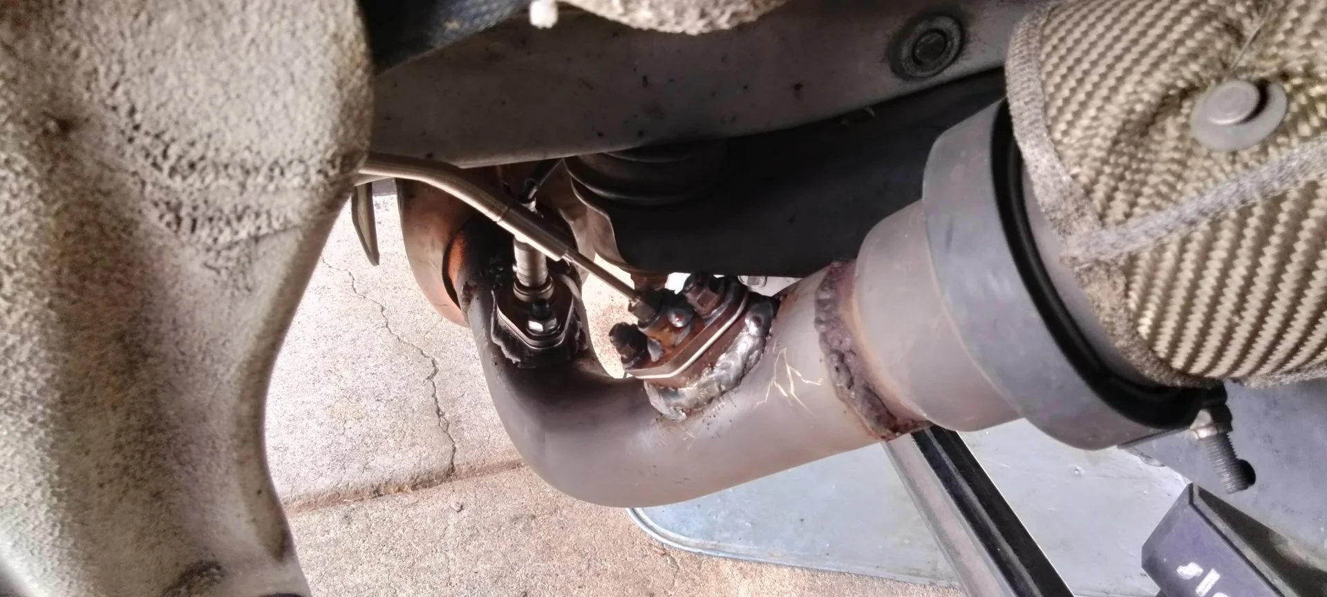

Taking the opportunity to add an exhaust temp sensor from PLX. The module already has an input just needed the sensor.

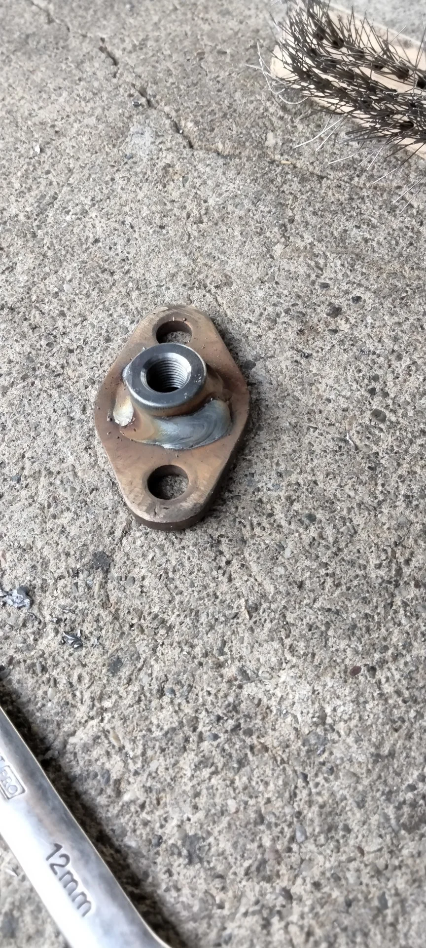

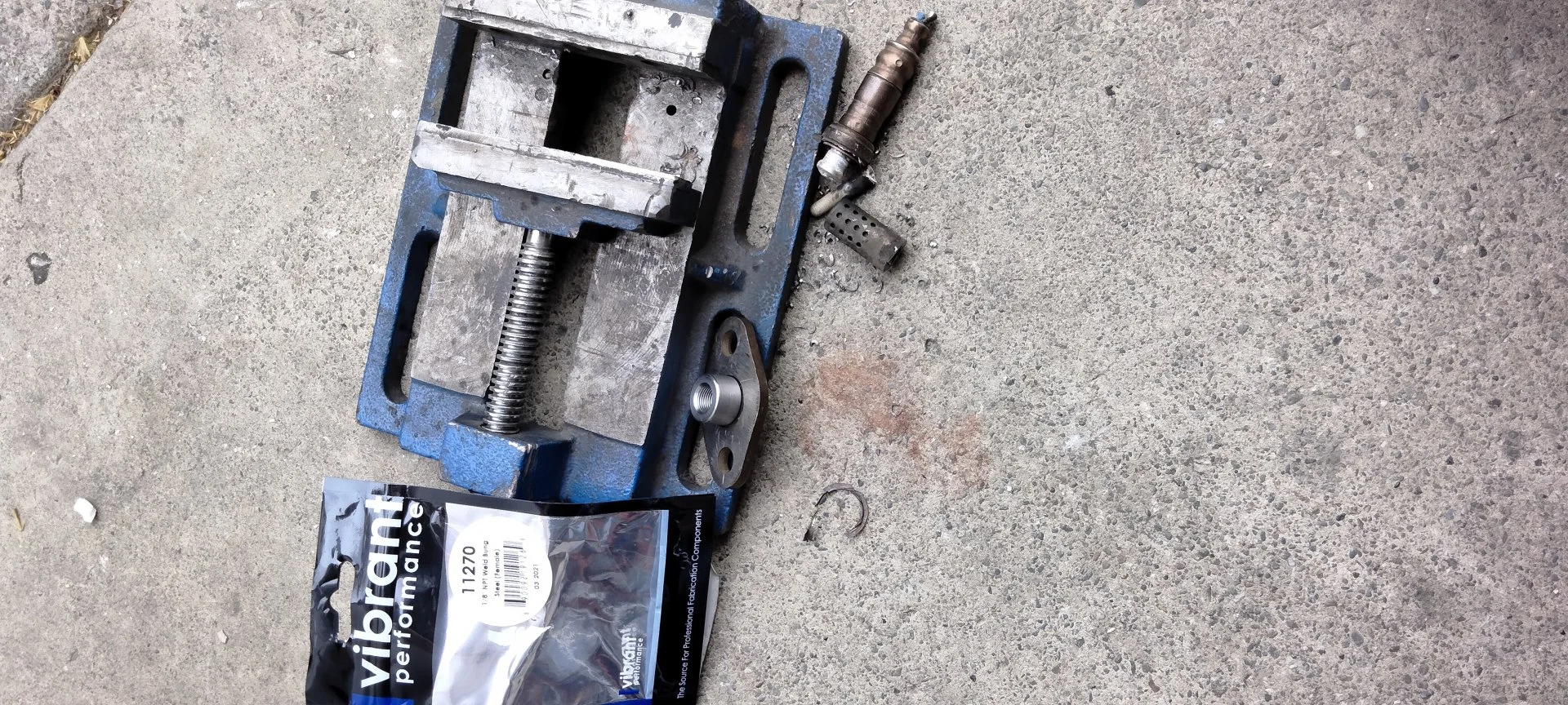

Cut an old o2 and knocked out the internals. I could not cut through the core with a band saw. That core is stupid hard and even a cut-off wheel angle grinder barely got through it.
Got a female 1/8 npt bung from amzn and now I'm waiting for the male end to arrive in the mail and a nice dry day to weld everything together.

I know the EGT sensor is supposed to be as close as possible post turbo. Ideally closer to where the AFR sensor is but I'm not drilling into that pipe. Not interested in taking off the Vband and figuring out where to poke a hole in the blanket. I'm just going to plug it in the hole I already have there. The sensor is probably not going to provide very accurate data in that location. But it was either plug in a sensor or add a blockoff plate. I chose some data rather than nothing.
