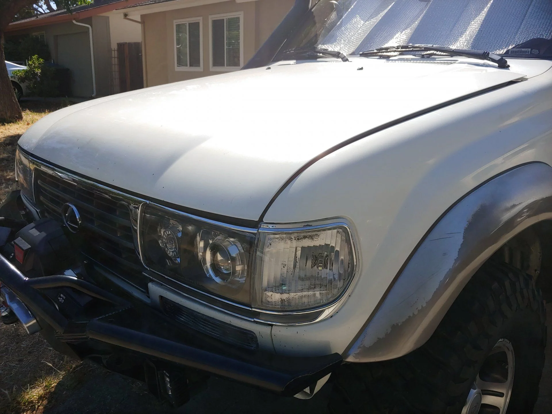

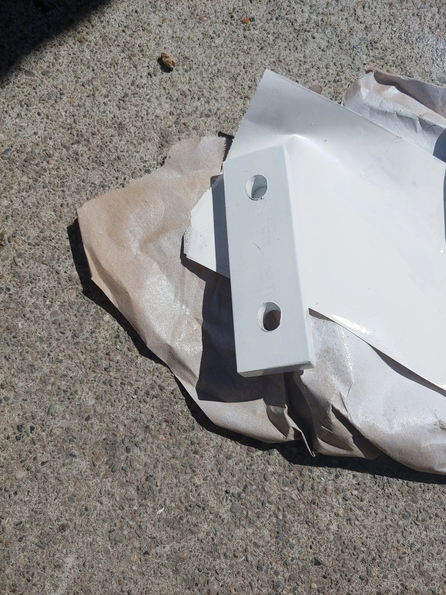

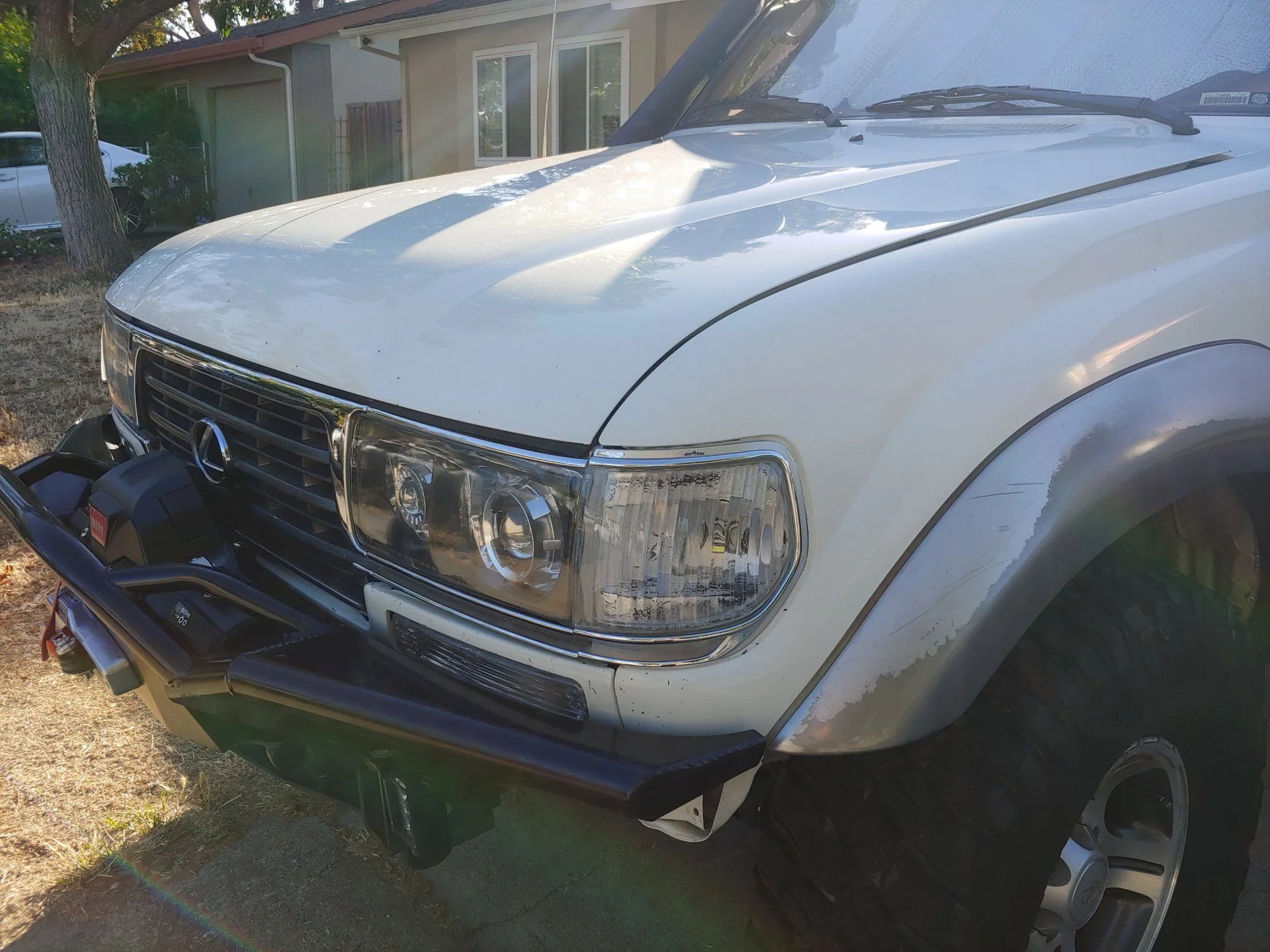

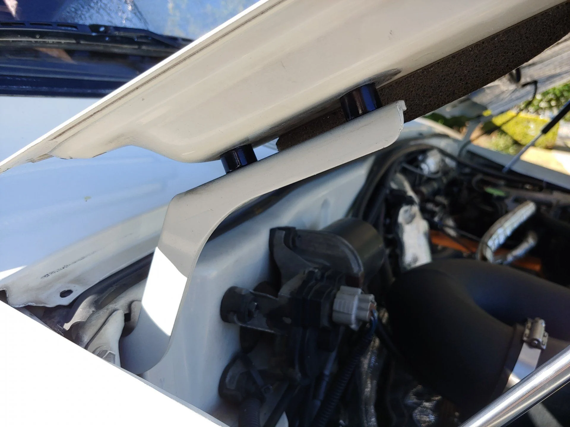

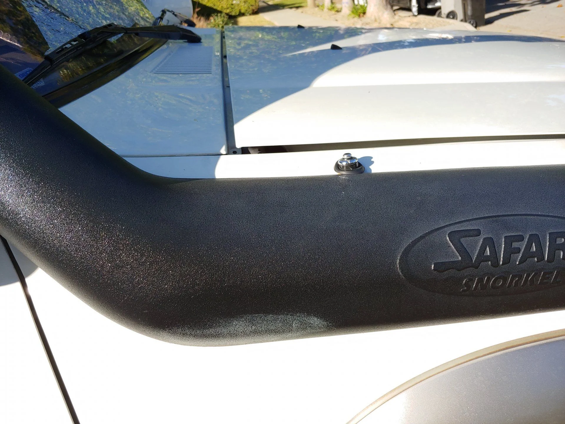

Bought the 6mm hood spacer from Amazon. Who measured that and wrote the description did not do the correct measurement. Its actually 1inch (25.4mm). Returning it to amazon since it looked ridiculous with a gap that tall. I dug around my random bolt bucket and found some shock inserts. Cut them down 5/16 and got longer bolts to match.
I can feel the heat exiting from the sides and back of the hood. I may try and find different spacers that are 1/4 inch.

I did the rear 1/2" hood lift last summer, did it with washers. Got a steady 3* degree difference out of it. Wonder what 3/4" would give me?
