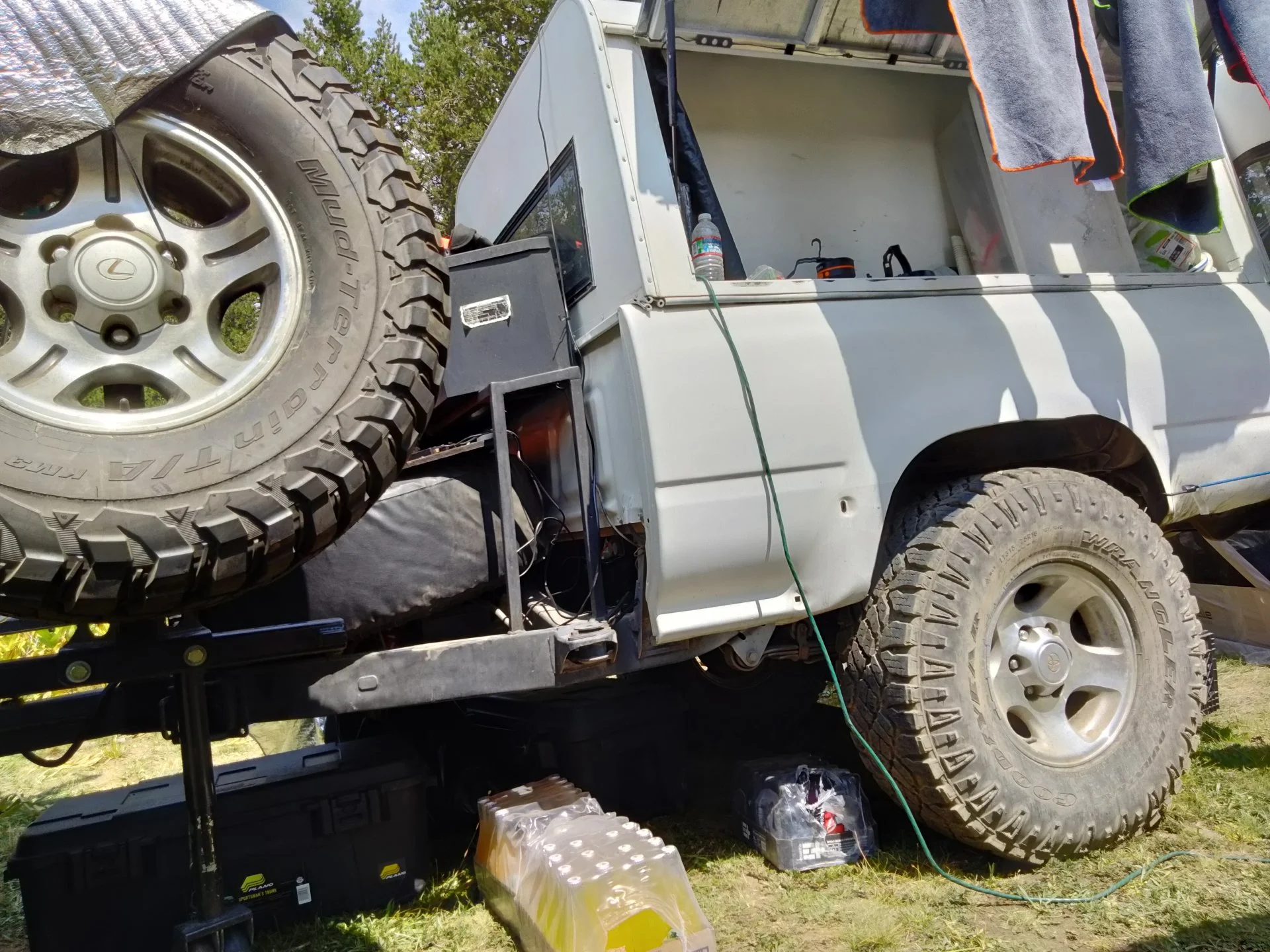

I've taken a break on the 80 and decided to finally weld in battery tray for my half cut yota pickup trailer.

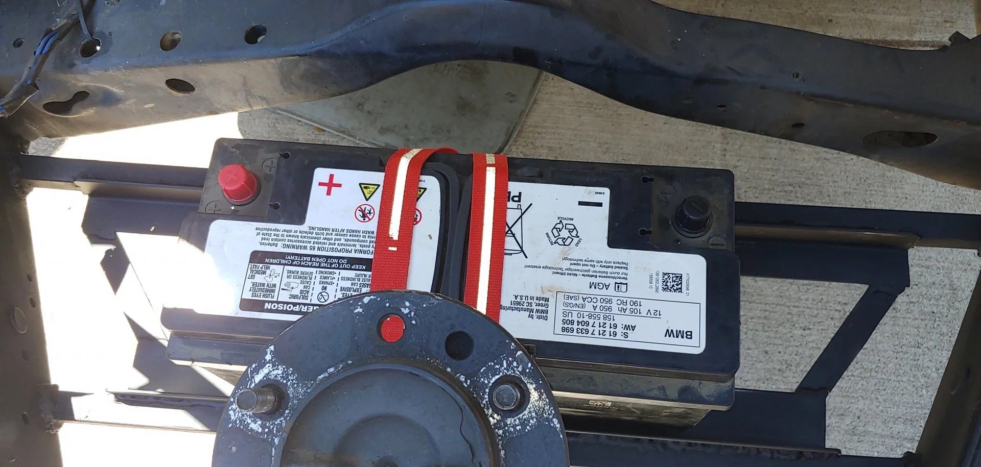

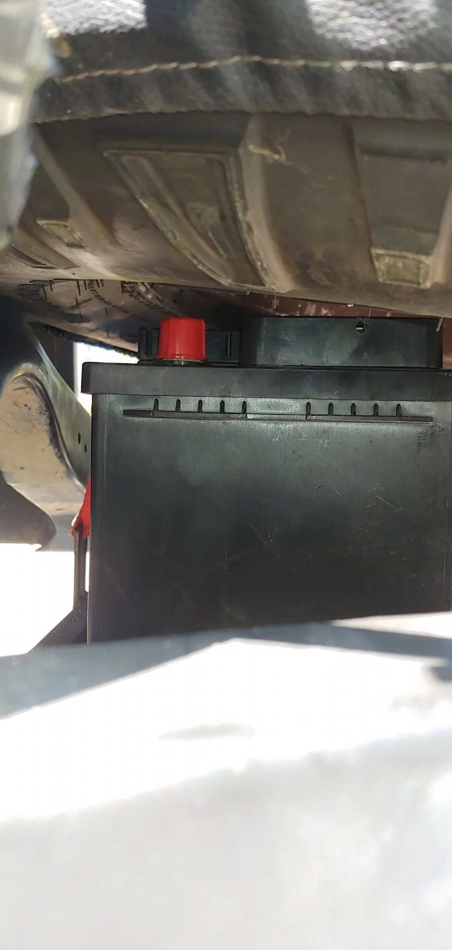

AGM 105amp batt mounted now. Now to wire up 7pin harness, solar, panel, 12v plugs, led lights and maybe a small inverter
I was hoping I could fit 2 of these side by side. But im just short an inch. Oh well. I can squeeze in a group 24 or maybe a 27 next to it and run 2 together. For now 1 battery on the trailer is better than zero.

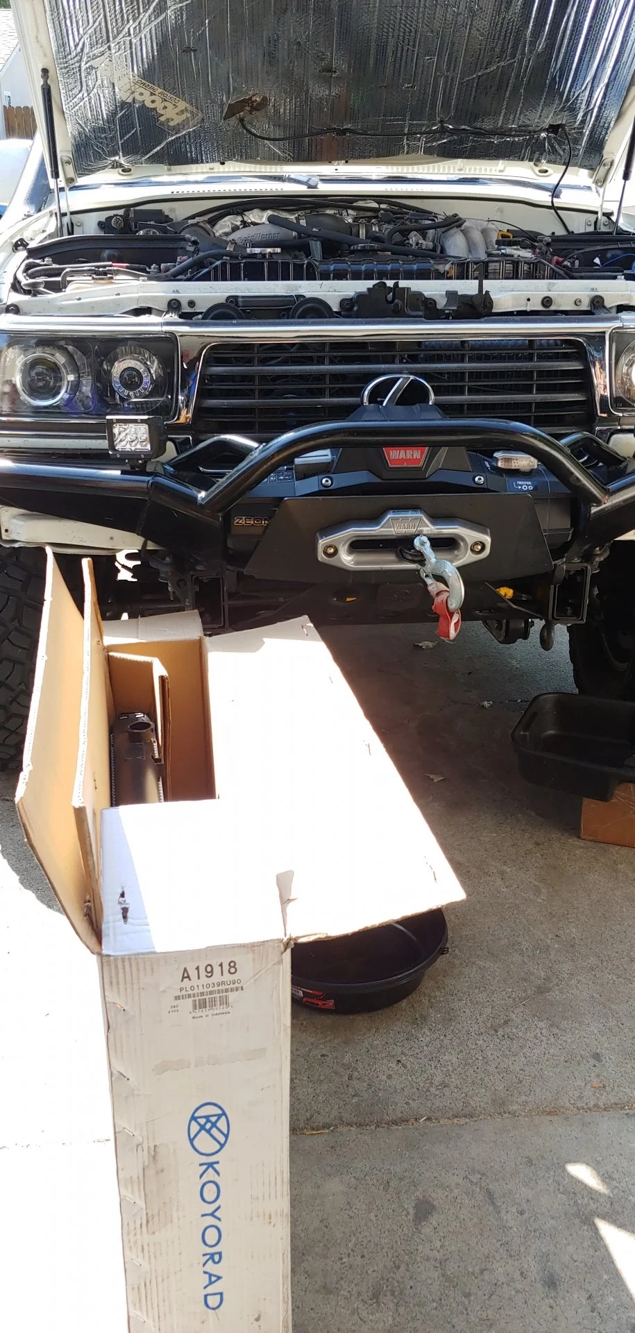

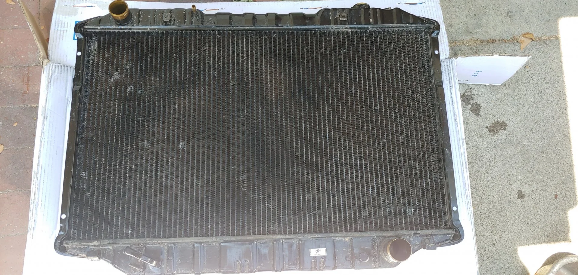

Pulled a perfectly good all metal CSF radiator thats about 2-3 years old. No leaks or anything but it wasn't keeping the engine cool enough with the Turbo. I put it a blue fan with fresh 20k CST as well.
Popped in a Koyo A1918 and a Solvefunction 3d printed valve guard.

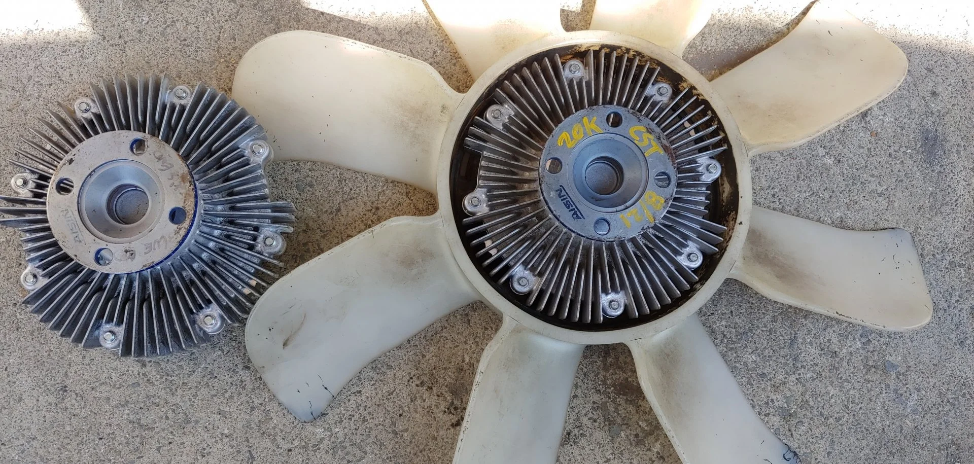

And driving the turbo 80 with the 20,000 CST oil and the photo man pulley. The cruiser fan is stupid loud now and it overpowers the sound of the turbo. And the turbos already pretty loud. I think I have too much fan now. I think I need to put back in the 15,000 CST oil cuz I think that was not the issue I had with cooling and it was the CSF radiator
I run 15,000 CST and I think it's loud so I can only imagine 20,000 CST :eek:
Oh it's just not 20k. It's 20K with the Photoman smaller fan pulley! So it's already over driven and spinning faster.
I've read it's a 10%? Or more increase.
15k and Photoman pulley was fine.
Not sure about this 20k and Photoman pulley. I think I'm over spinning the fan.

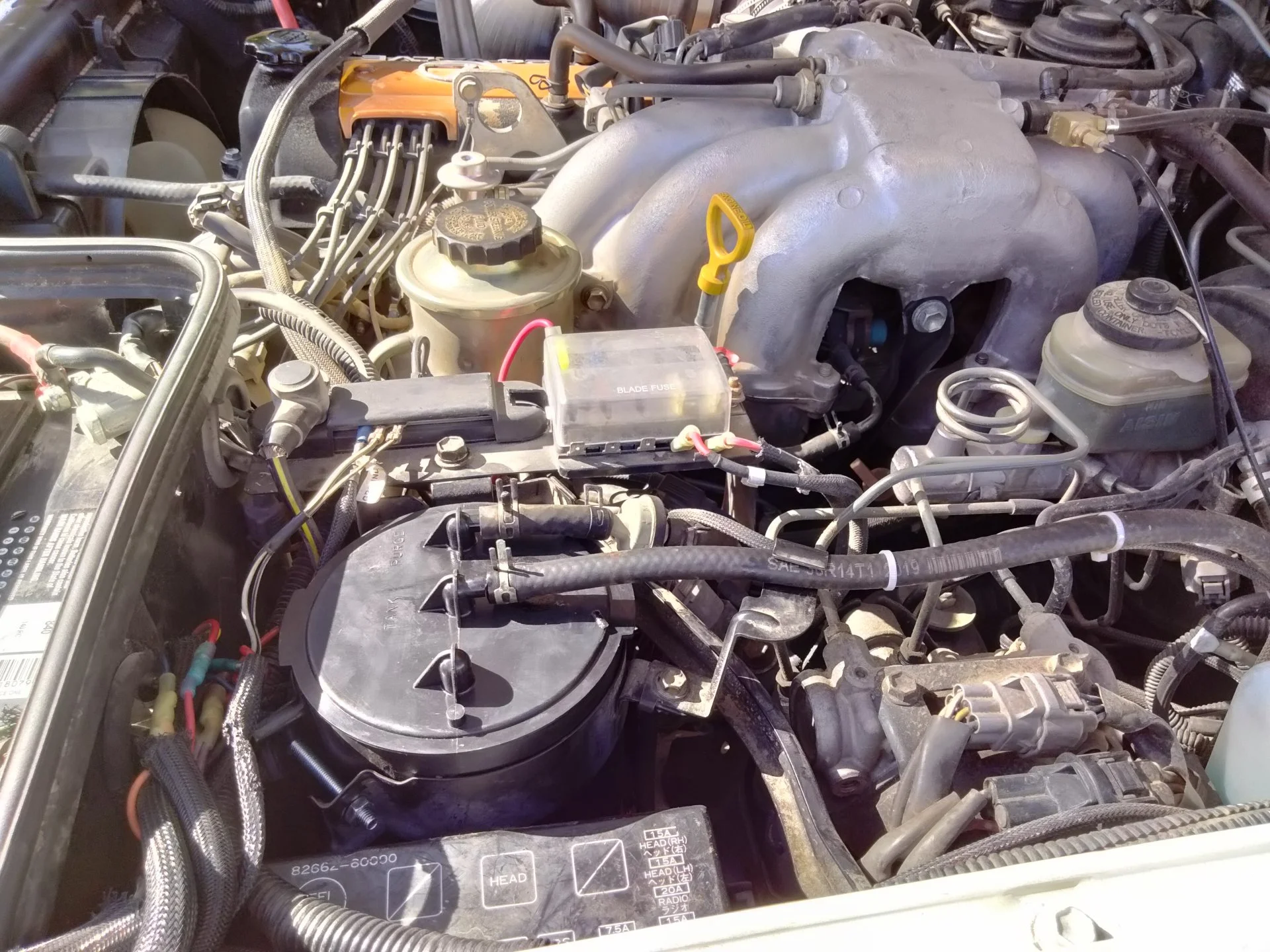

Well I got my VC120 replacement canister today. Installed it. Will see this weekend when I can drive it.
I've had tell tail signs of charcoal canister going bad but I just kept ignoring it. Brand new OEM gas cap didn't fix my fill up gas pressure issues.
It also didn't help my charcoal when i'm running 49 gallons with the 25 gal Long range fuel aux tank.

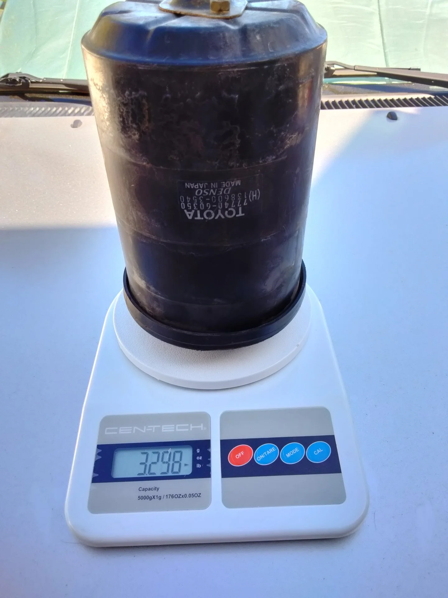

yup I decided to weigh the original. It was heavy and came in at 3.3 lbs
I've definitely noticed the hiss, but thankfully haven't encountered this issue, yet. I purchased a VC120 to replace OEM charcoal canister.
Was it a drop-in replacement or any modification needed to fit it?
its pretty close to the same size but still required some mod to fit.
I got rid of the bottom clamp. stretched out the top clamp and dropped it in. pinched the clamp together and used some new hardware (bolt/nut) about 2" inch long and snugged it down. I tried to use the bottom clamp too but it wouldn't open up wide enough and as impossible to even get hardware on, even if I could manage to squeeze it in. 2 clamps is overkill for a can anyway.

Lastly I switched out the 20k blue fan clutch back to 15k blue fan. 20k and photoman pulley is just beyond overkill and was just too much spinning the belt would slip under full boooooooost.
Drove the truck 3 hours and temps were 186 to 203 pushing up Hwy 152 at full throttle at times.
15k and photoman pulley worked great with the new Koyorad.
20k and photoman made the belt slip on full throttle. I wonder if thats a turbo only problem as the engine is spooling faster than normal NA.
