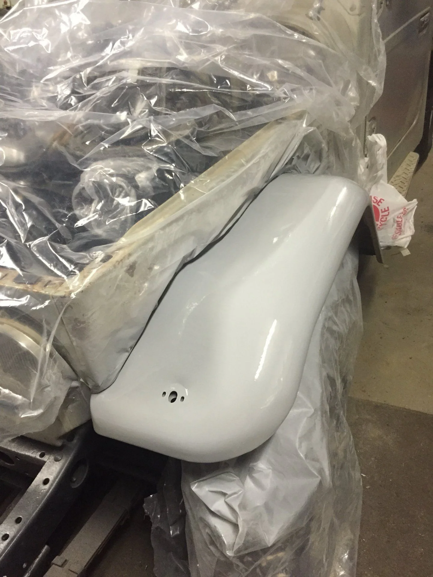

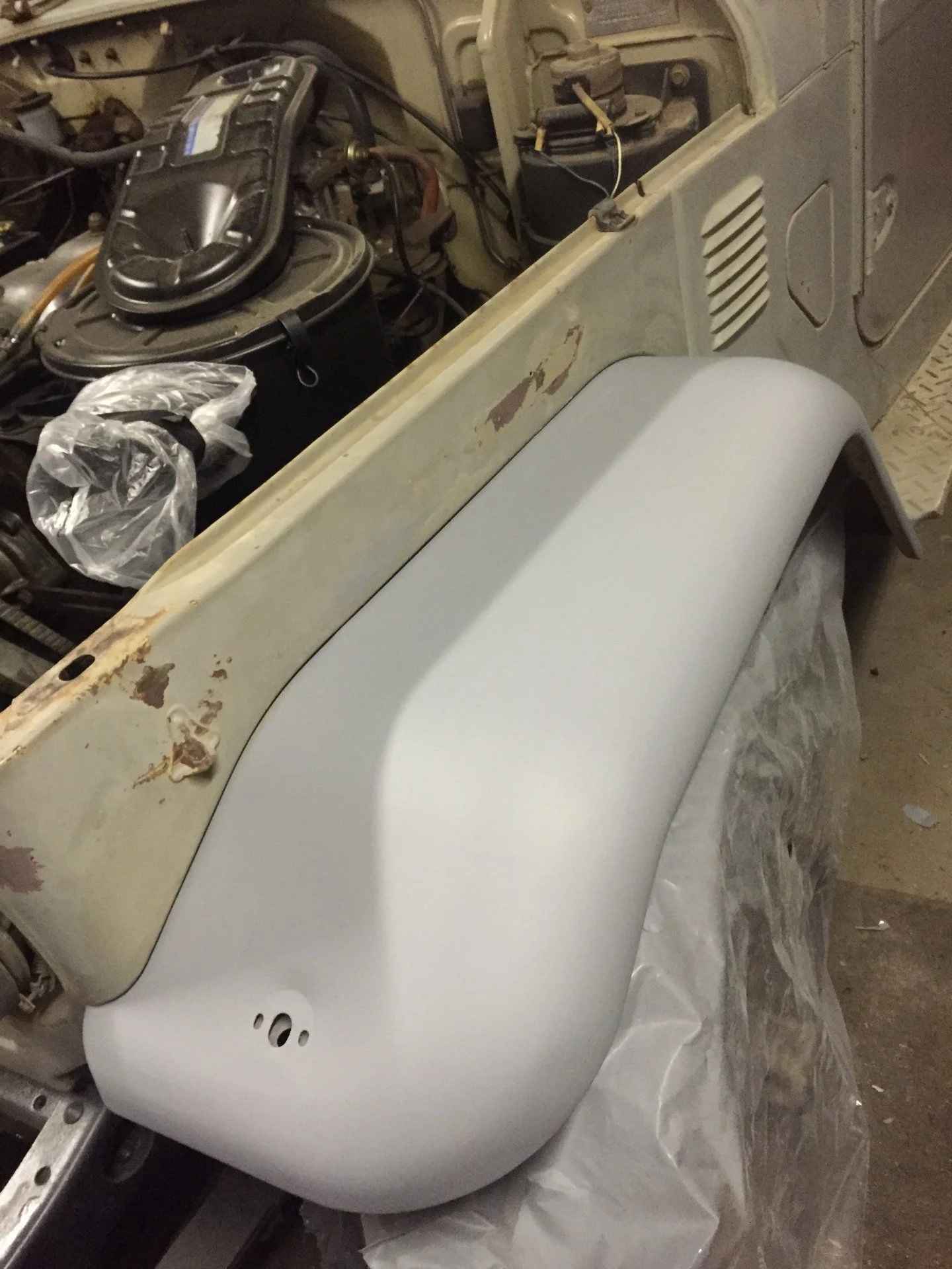

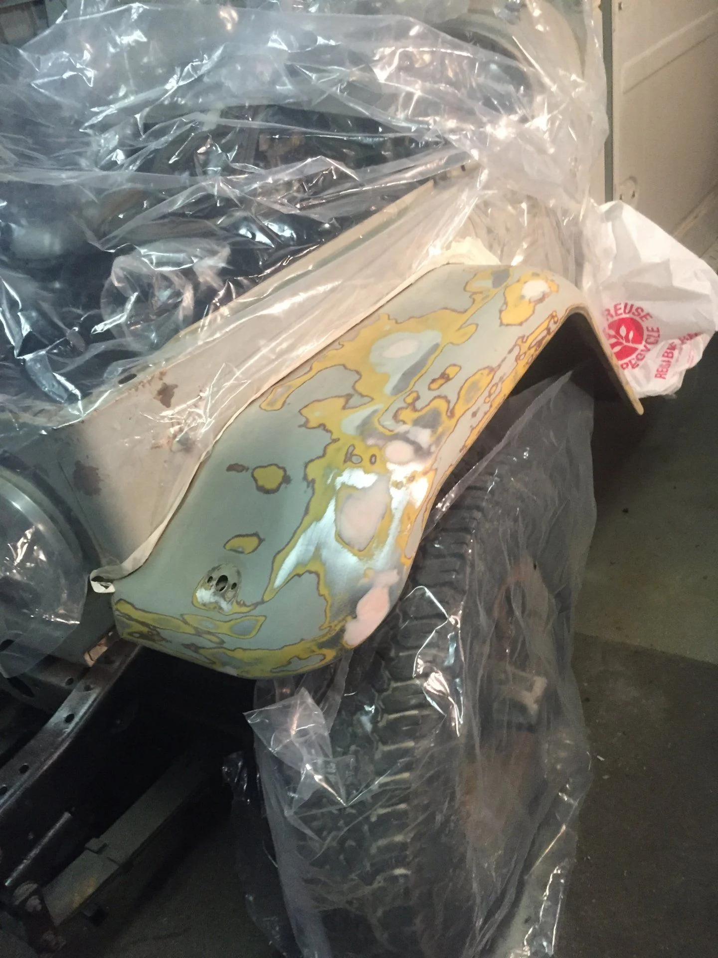

Latest progress report. Sanded back some old cracked and f**ked paint, bogged the low spots and got a coat of primer on there.
Happy with progress so far, although abit slow..
