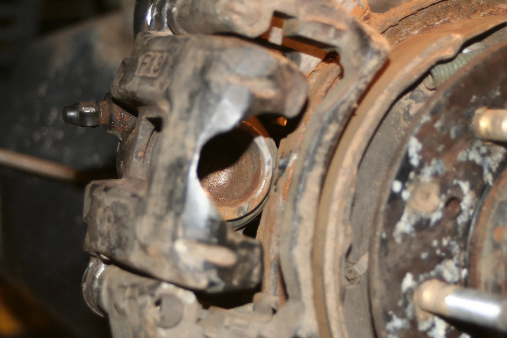

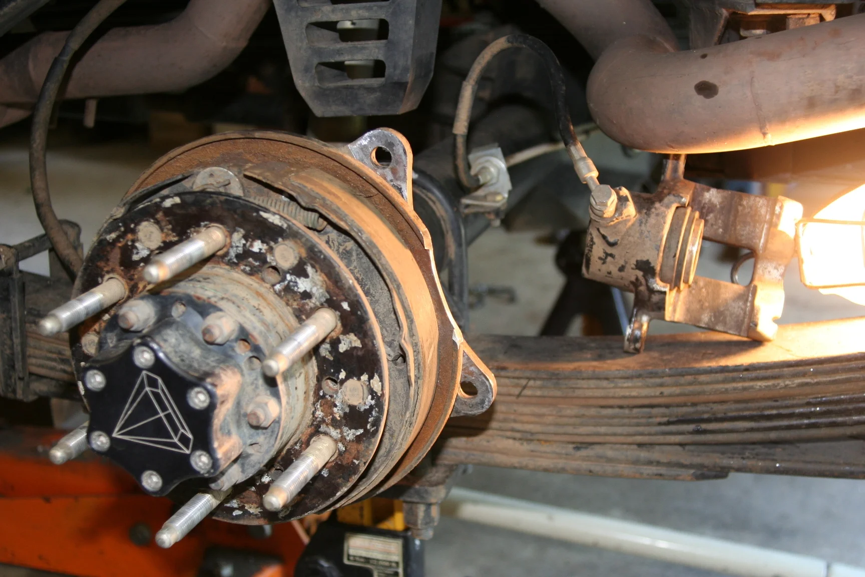

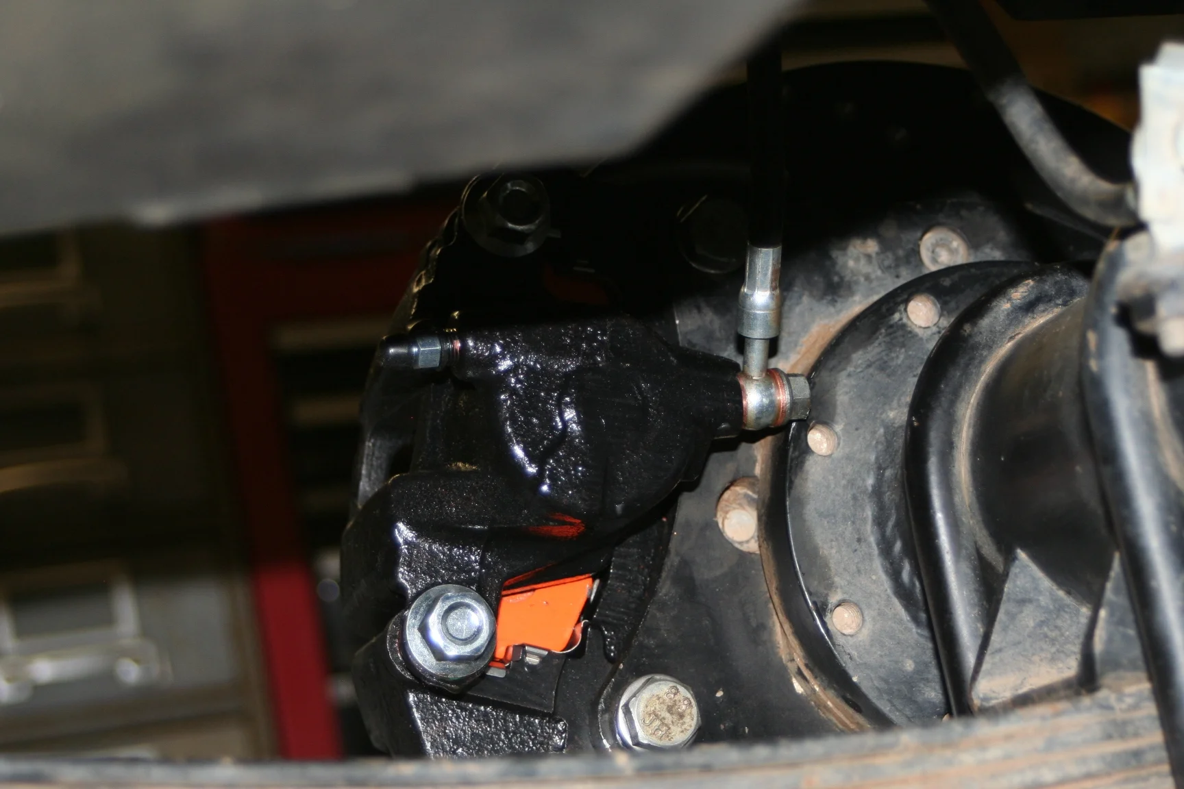

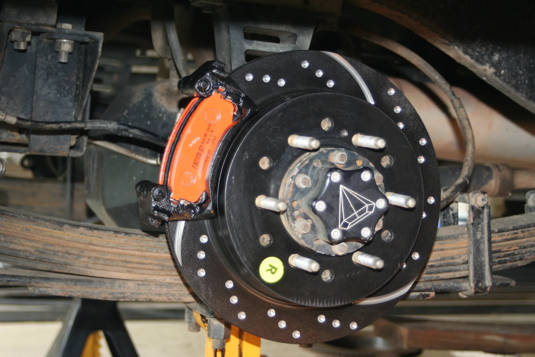

I went with EDC rotors and pads. As far as what happened, the only thing I found were the pistons hitting the backing plate. I have a Diamond rear axle that was made to use '07 4 Runner brakes. It seems the custom made backing plate that the caliper bracket bolts to was too close and the piston was hitting it. Maybe when I switched to the hydroboost system it was enough to actually bend the 1/8" plate and jam against the rotor. I never thought to check it for clearance and didn't realize the rear brakes weren't working to their potential. Anyway, I ground down the plate a bit and straightened them, so should be good to go. I ordered the same for the front.
You can see where the old piston was hitting the plate.
I ground it down a bit for clearance

Scrappy, any chance you can get a shot looking out at the caliper mount on the axle tube?
