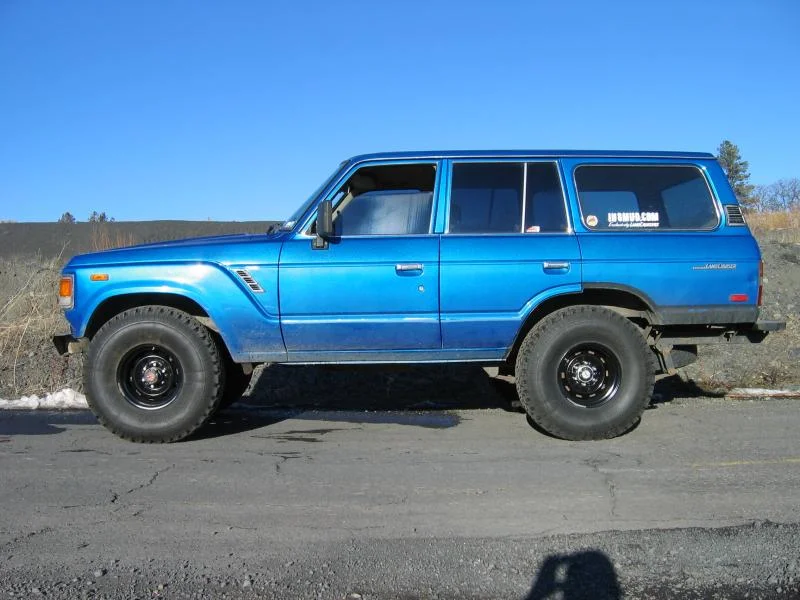

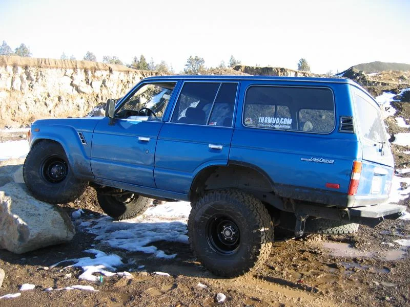

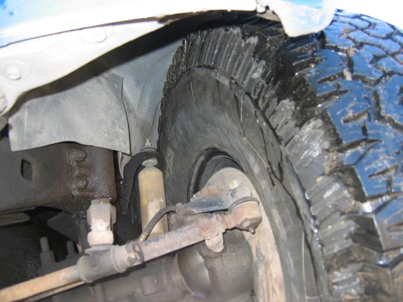

Here are some pics of the 35's on the rig. Wheels are chebby 15x8 rallye wheels off a 1/2 ton P'UP, scored for free from my father-in-law. Centers had to be opened up to fit over the MASSIVE toyota hub! Sandblasted at a coworker's house. painted black in my unfinished workshop. They required a 1/4" spacer to clear the TREs. it could use a bit more spacing because on full stuff the fronts hit the upper shock mount and rub on the frame.

Yeah, the fronts have to be stuffed to rub. Granted, I don't have a ton of droop in the rear end. Skinny tires are hard to find in a 35" and up. Plus Kief cut me a deal on these.
