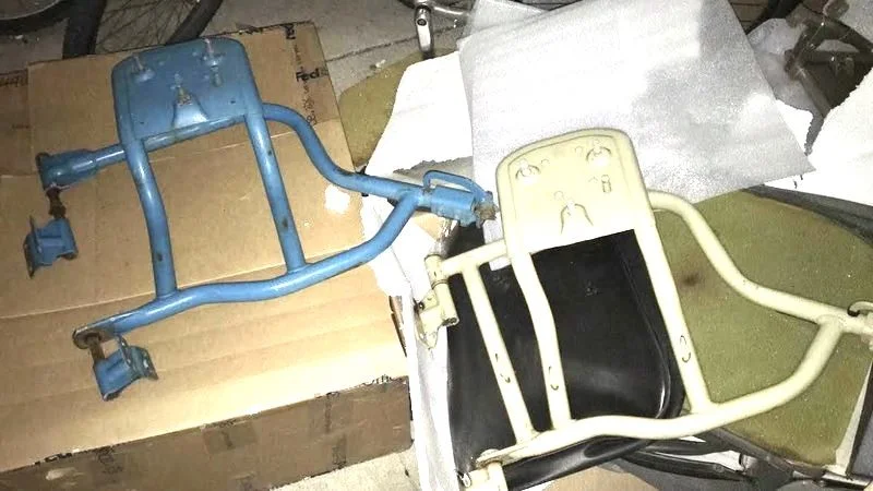

2. Non tube spare wheel carrier? If “YES” - model year 1976 (Sep75-Jul76). If “NO” go to 3.

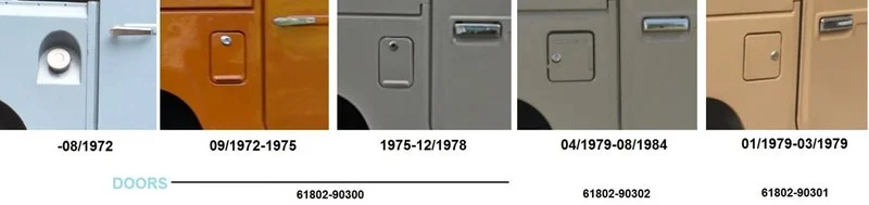

an easy tell on year between 79 and later is the direction that the fuel door opens... 79 swings to the rear while later swing to the front. I don't know exact transition month.
easier to spot from distance than old vs new style steering wheel, and not subject to parts swap so a more reliable indicator of true model year
Interesting endeavor!
I think you have that backwards. The newer models swing to the rear. Easy to tell by the position of the lock. Lock will be in the front on the newer models.
just looked at my march 79 in the garage and it swings to the rear, lock located toward the front. Am pretty sure all three 79's I've had are the same.
On one of those trucks I swapped on better tub, which I remember to have been an 80 model, and the fuel door on that swings to the front. that was the first time I became aware of changes between 79 and later (at least 79 and 80) when my door from the 79 wouldnt work for the new tub.
I assume you're speaking to how later models are oriented based on your 81? I see in your build thread pics that it swings to the rear.
How confident are you in your 81 tub being original and an 81 model? Does it have original door jamb plate? Month and year listed there?
one of the gurus should be able to definitively tell us which way each year went between 79-84

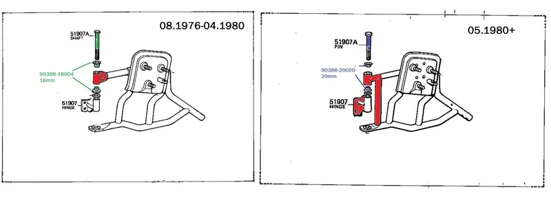

Fuel doors will not help for 08/80 model year
thanks for that Economist LC76... that's pretty much how I understood things to be (absent specifics).
So do we think that 4/79 pretty much started the 1980 model year trucks? Curious to know what Splangy has as an 81 with rear opening fuel door...

Lots of other little random changes. For example, the '76 had a cowl vent louver, and the '77 was the first year without it.
Some '77s have the SEAT BELTS and BRAKE lights on the dash, and some have them on the lower left side of the dash.
Oh, and the tubular spare tire carrier began in the later '76 models and was the square carrier in the early '76 models.
I'm not expert, but these are some of the little random things that I've noticed just between these two close years.
