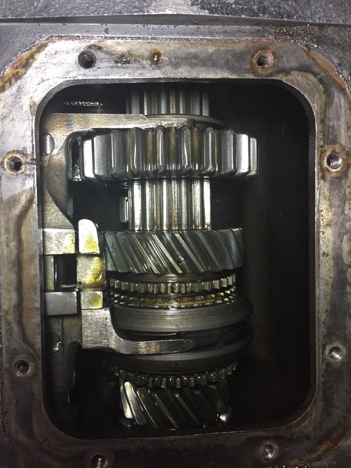

The transmission appears tight with only a few teeth nicked and the transfer case gears look good as well. The input shaft does not wiggle very much and feel pretty tight.

I blew my old 1F engine and got a 2F and now I am looking at the 3 speed Transmission and Transfer case and wondering if I need to rebuild them. I was getting a really bad whine over 40 MPH, but only on acceleration. I saw one link in IH8MUD where the guy replaced his main shaft and it got rid of the whine, and I saw another link on the FAQ where they said once you have the whine you can't get rid of it. So I am not sure which is correct?

What gear is the transmission in - Picture titled "FJ40_3SPD_Transmission.jpg". Is this neutral?
Not sure. I think so. This is an old thread. I updated my 3 speed to an H41 4 speed and rebuilt the transfer case and the transmission. Still have a slight whine at higher speeds. I need to look into some sound deadening materials I think.
