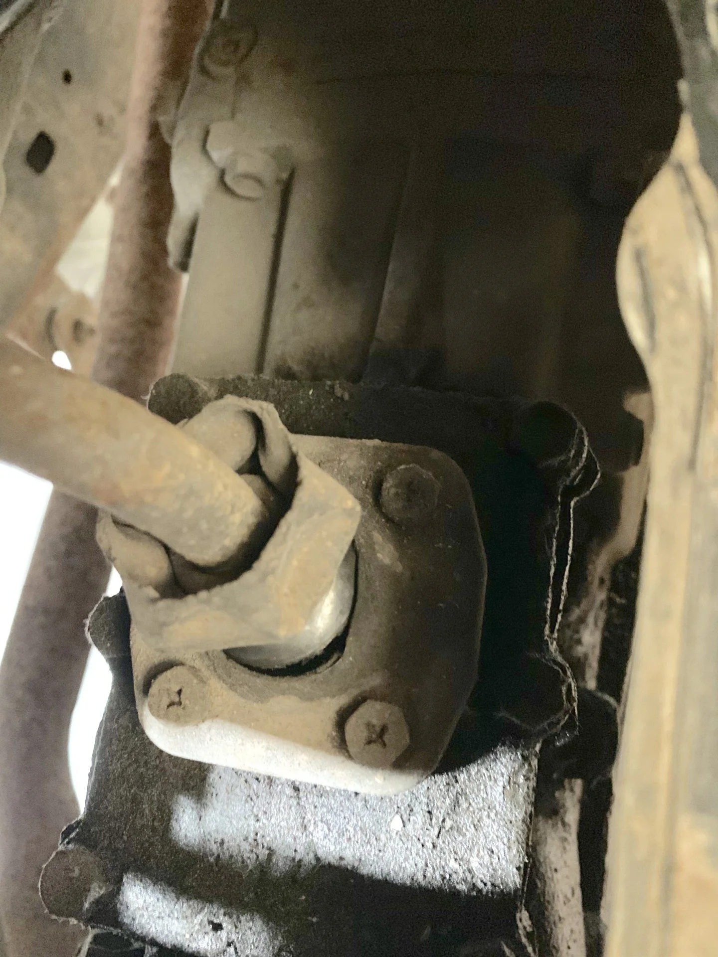

It appears the gasket at the top of the W tranny where the shifter enters the housing is leaking quite a bit. Anyone know a part number or have one they’d sell me?

Permatex the right stuff, best stuff ever.
Have you checked the tightness of the bolts? Mine have worked loose several times.

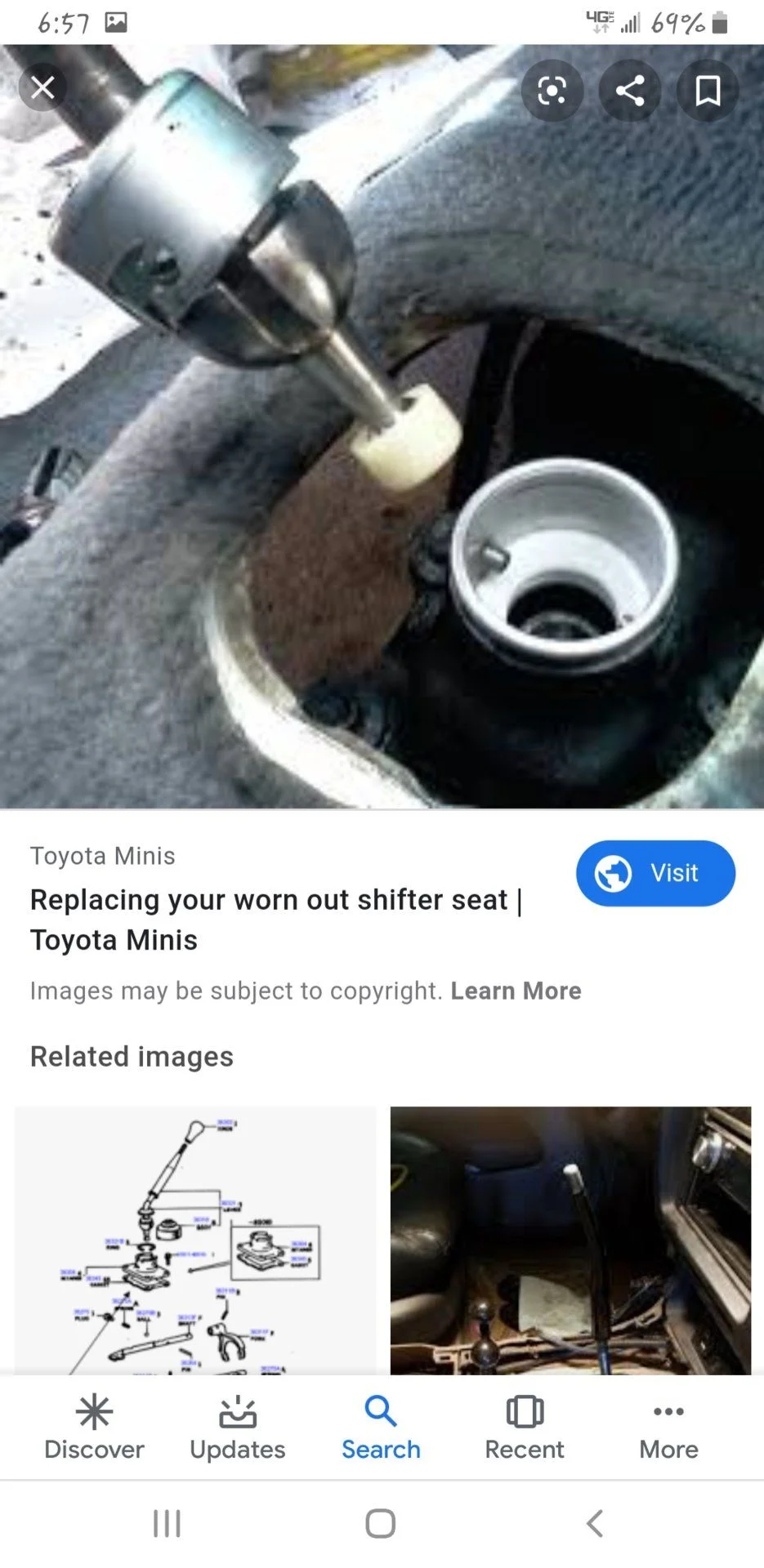

No linkage, bushing. Most likely worn.
Looks like I need to do a little homework.
so the shifter assembly just turns and pulls off the two knobs. Install a new bushing and looks pretty easy. This reminds me of my 1995 3.slow that would pop out of gear and startle you. That must have been the issue. Imagine that. So, if you replace the bushing and the piece of plastic at the bottom and new gasket it should be golden. Looks fairly simple. Thanks

That would be the 4 screws on the plate that holds the shifter in. Actually that would be the 6 screws. They were a bit loose. I tightened them up and degreased the side of the tranny.
The bushing will fix a sloppy shifter.

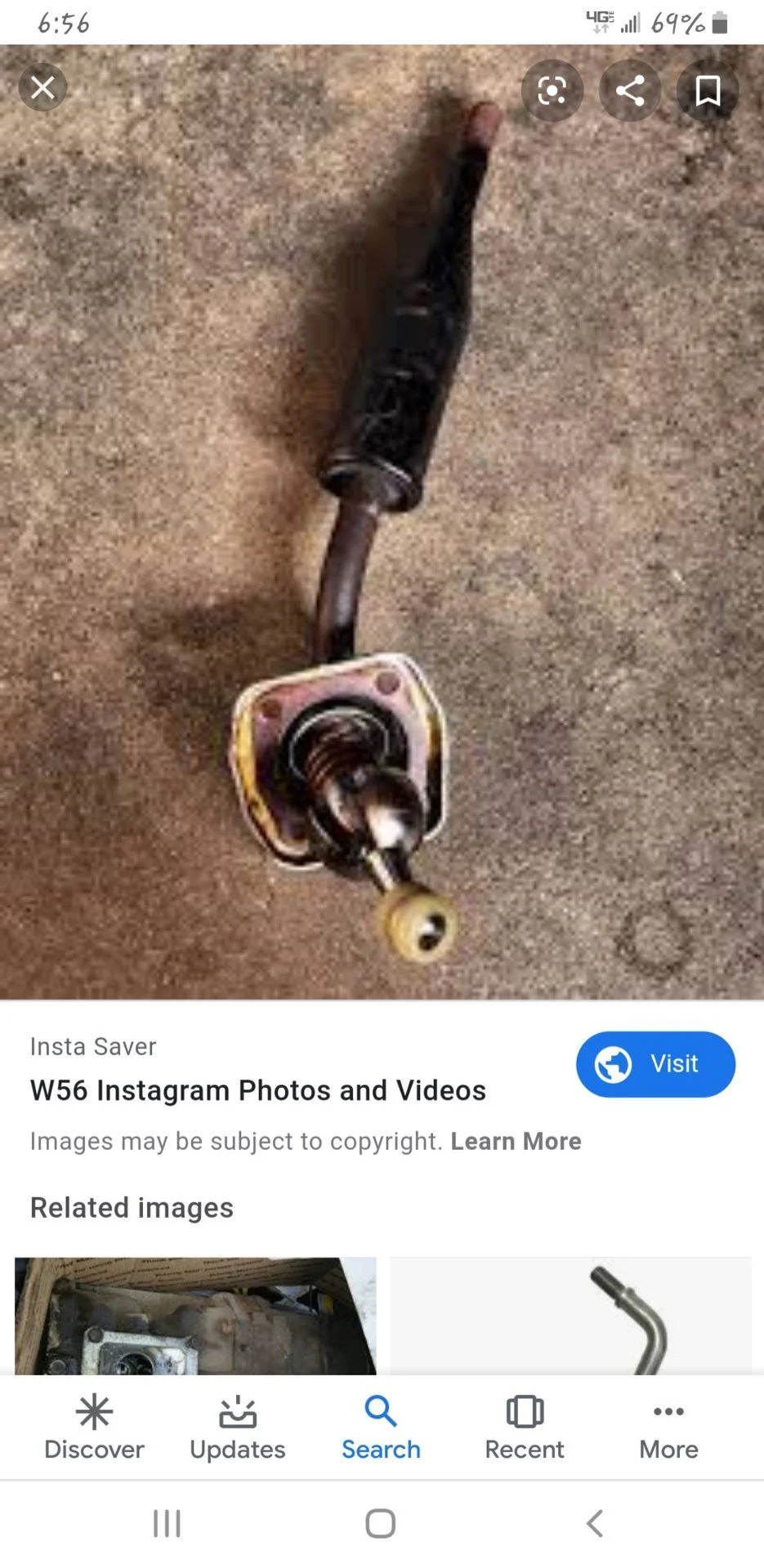

John is speaking of a different type shifter.
Some are held down with a 4 bolt "cap" that the shift lever goes through. That is to what he is referring.
You have a 6 bolt "plate" on top of the trans, but a push and twist type release that let's the shifter come out.
I think.....
sorry a crappy screen shot .
This is the 4 bolt type.
If you get to the top of the trans and the little rubber boot on the trans is square(4bolt), it takes red plastic race and standard bushing. Round (push & twist) boot takes white plastic race and standard bushing.
The six 12mm bolts below were not very tight. I gave each one 10 uggaduggas. Just kidding. But I tighten them down. I think the shifter moves a lot at highway speed because of the truck. Everything shakes. It’s never popped out gear but I thought, as a preventative measure I’d go ahead and put a new bushing in since it’s cheap and easy.
Yeah, you can see the gasket sticking out at top right.
