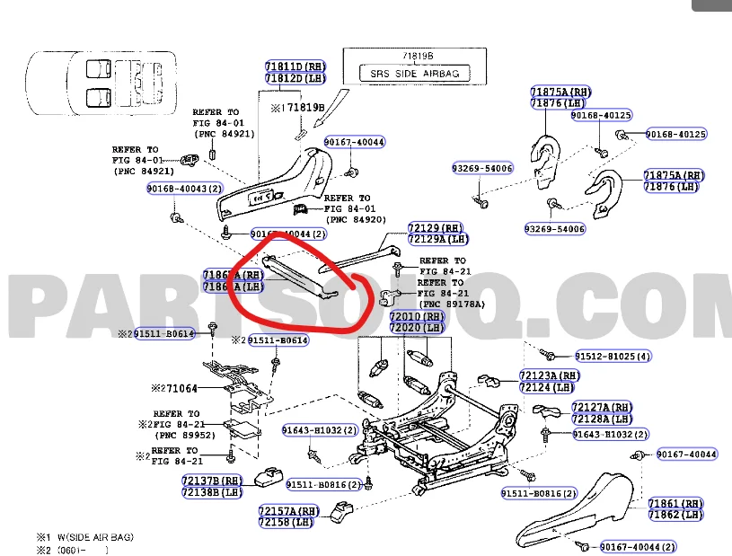

I installed a new cushion and am reassembling; I can't figure where this piece goes?

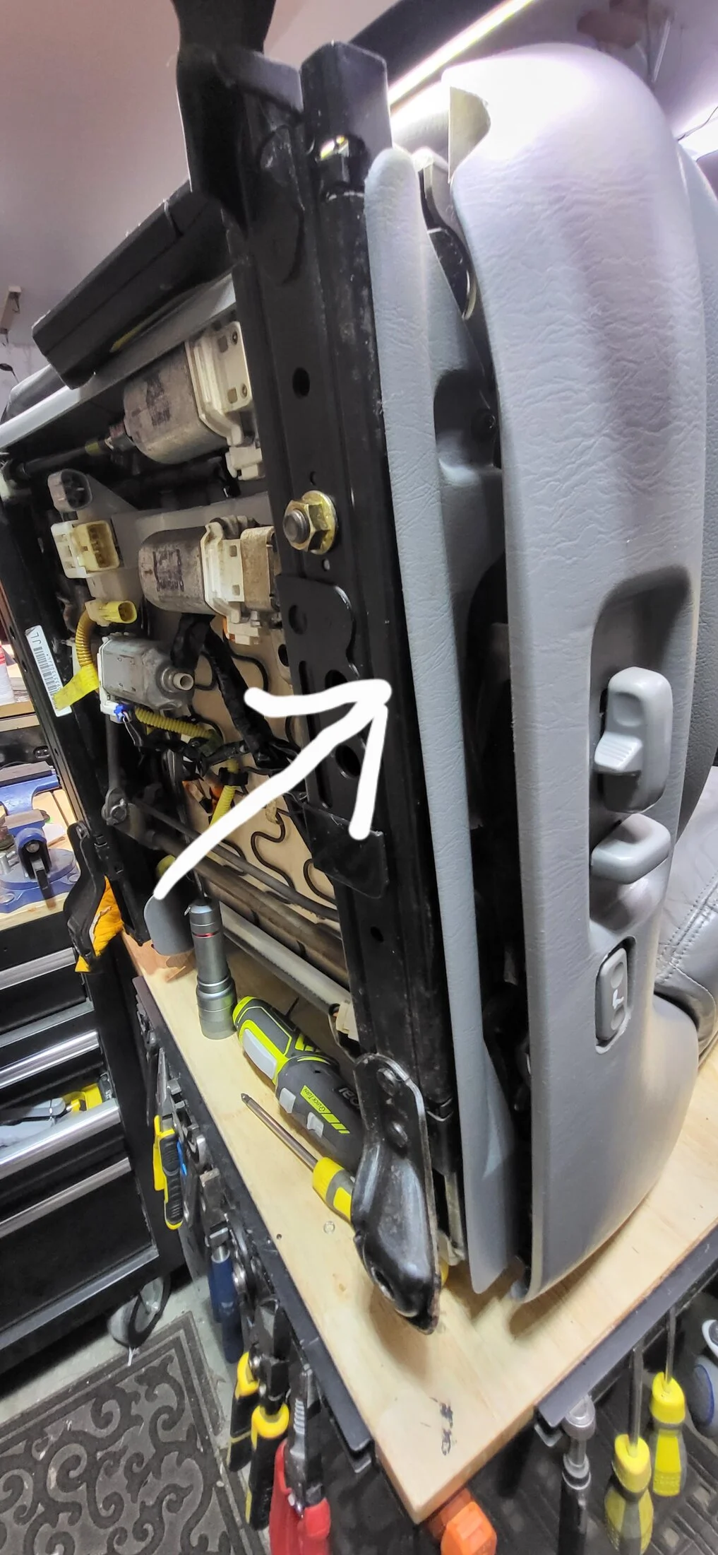

Isn't there suppose to be plastic covering the rails from like the inside / back?
Check your other seat, lift it way high up and look from behind along the seat rails to try and find a possible match.

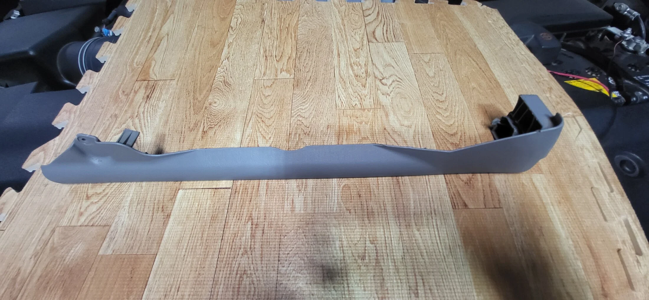

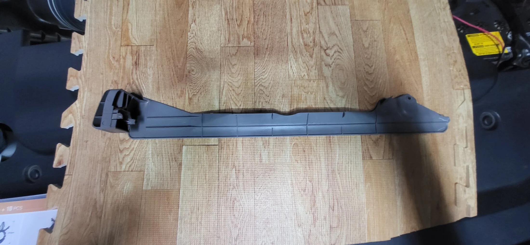

Ahha! sneaky little bastard..... Nice find..... I recall having a tough time getting all the plastic bits put back properly when I re-upholstered my seats
