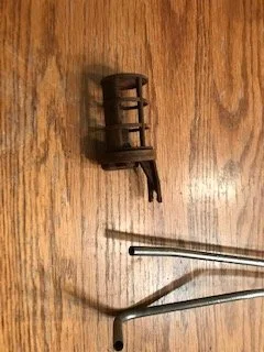

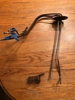

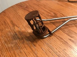

Sat for 9 years. RUST in the tank. Tank is removed and will be treated and resealed. Fuel sending unit is rusted solid, won't move. Fuel pick up strainer is toast, looking for a replacement. Seems that I can only find FI fuel strainers.
Here's what I'm working with. Any help???

- call out # 77023
- part# 77023-12050
- under $10 part
- also Buy qty x 6 93319-14010 screw
also buy
- 83361-20030
Gasket, Fuel Tank Vent
[08.1980 - 07.1983] LN40,RN3#,4#
DO NOT Re-USE either gasket or any screws , u Will have a leak or worse .........
A tap to chase old rusty threads is Not a bad idea too ( Edit )
" A Tap "
M8 tap? do you know the pitch of the threads? I didn't have any issues getting the screws out. They all came out clean.
there like a 4mm or 5mm thread size , not sure on pitch , i would have to use my thread pitch guage
