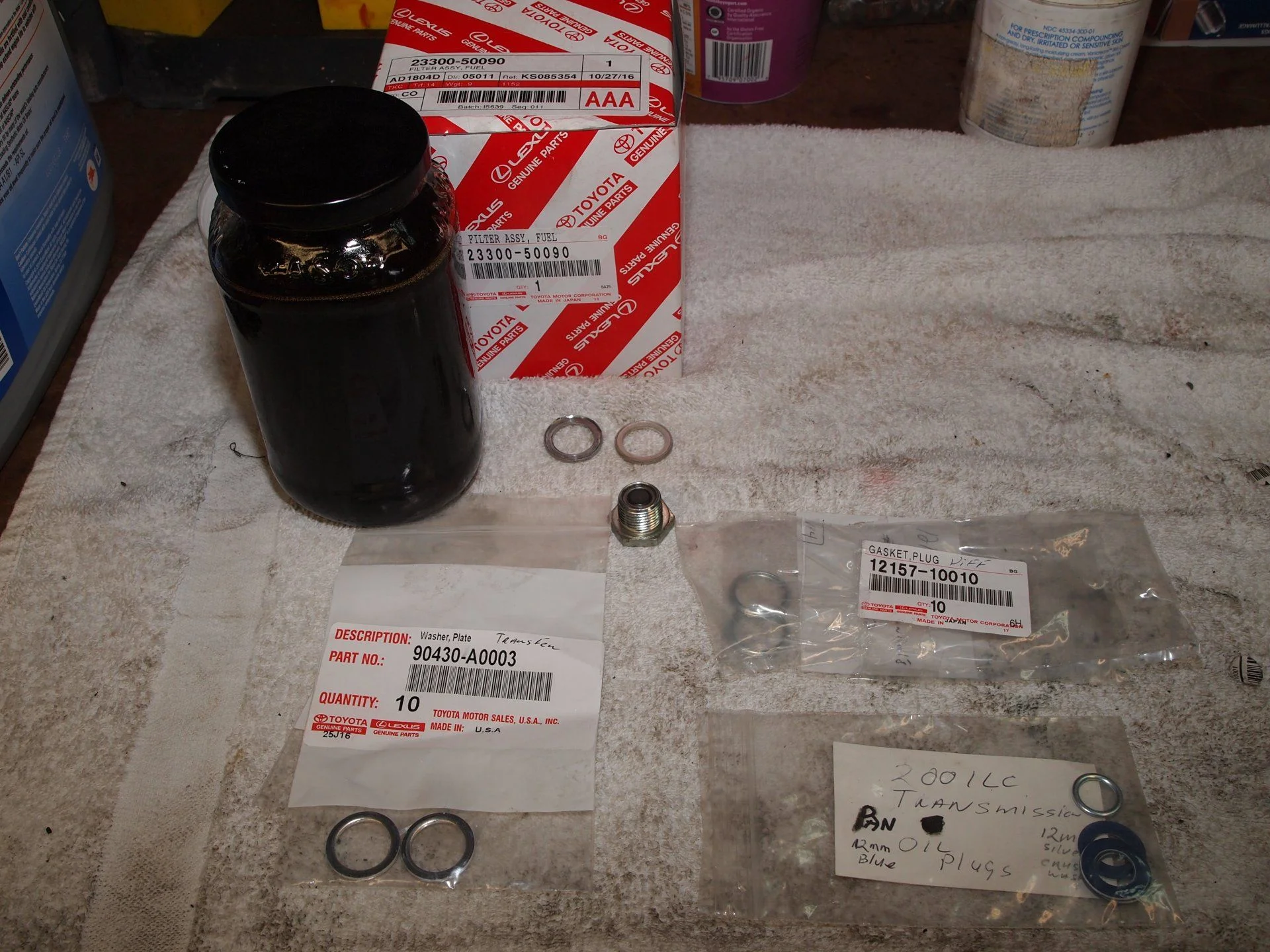

Flushed transfer case with M1:
Looks like old fill plug was leaking a tiny bit, common when washer (gasket not replaced)
Drain plug had minimal residue on magnet, about as good as I've ever seen.
One important point, is let new fluid settle in and recheck before buttoning up.
Old did look ready to come out. A few more flushes with M1 ever 20K miles and it will come out clear.

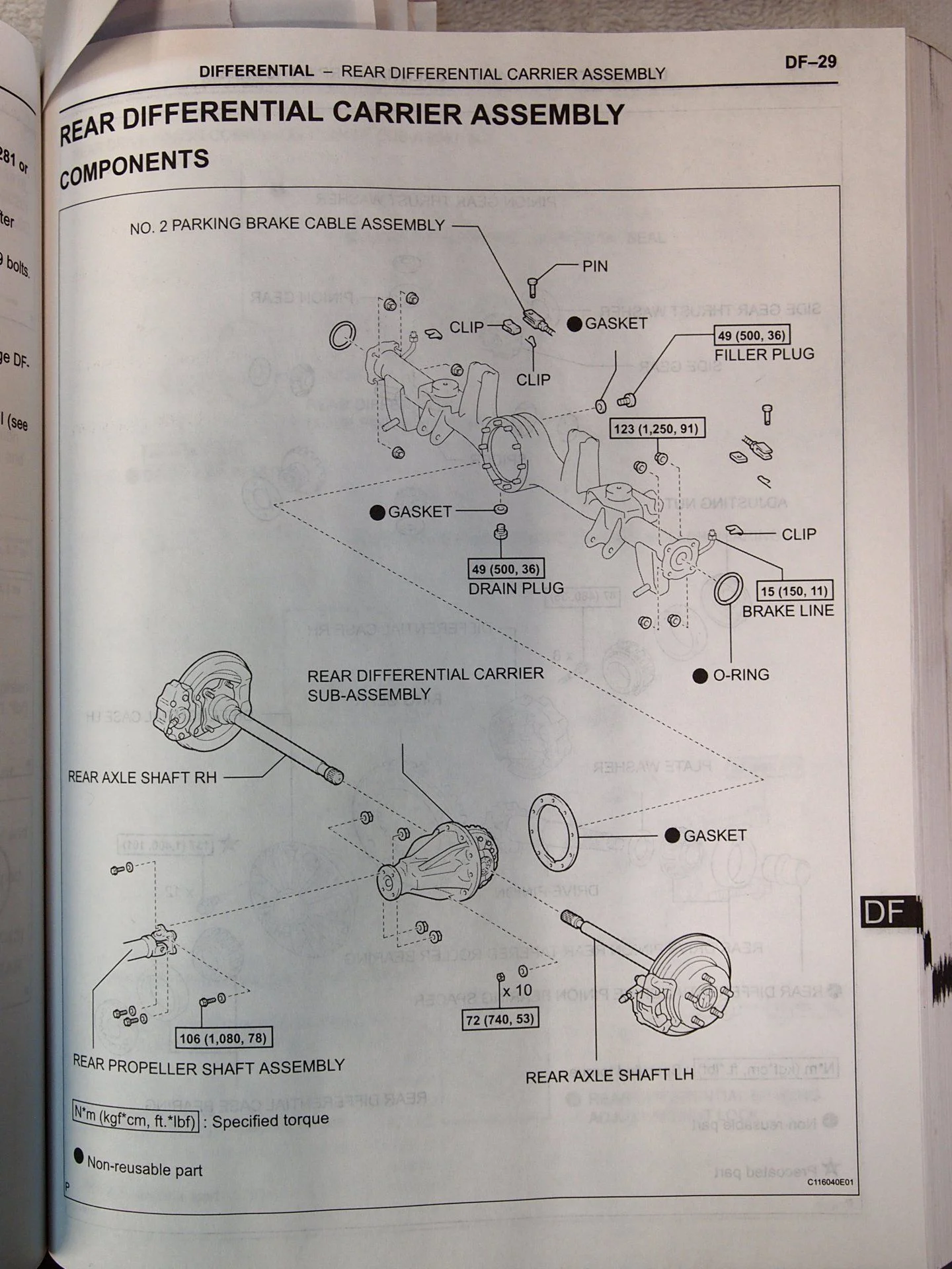

Flushed the rear differential with M1 (front diff done with rebooting):
Again looked like fill plug washer not replace last flush:
Drain plug residue on magnet looked amazing. Sorry no picture but not much and no large pieces.
Fluid looked ok about like I'd expect for only ~15K with conventional gear lube. Two more flushes with M1 every 35K (25K on front differential) and it will run clear also.

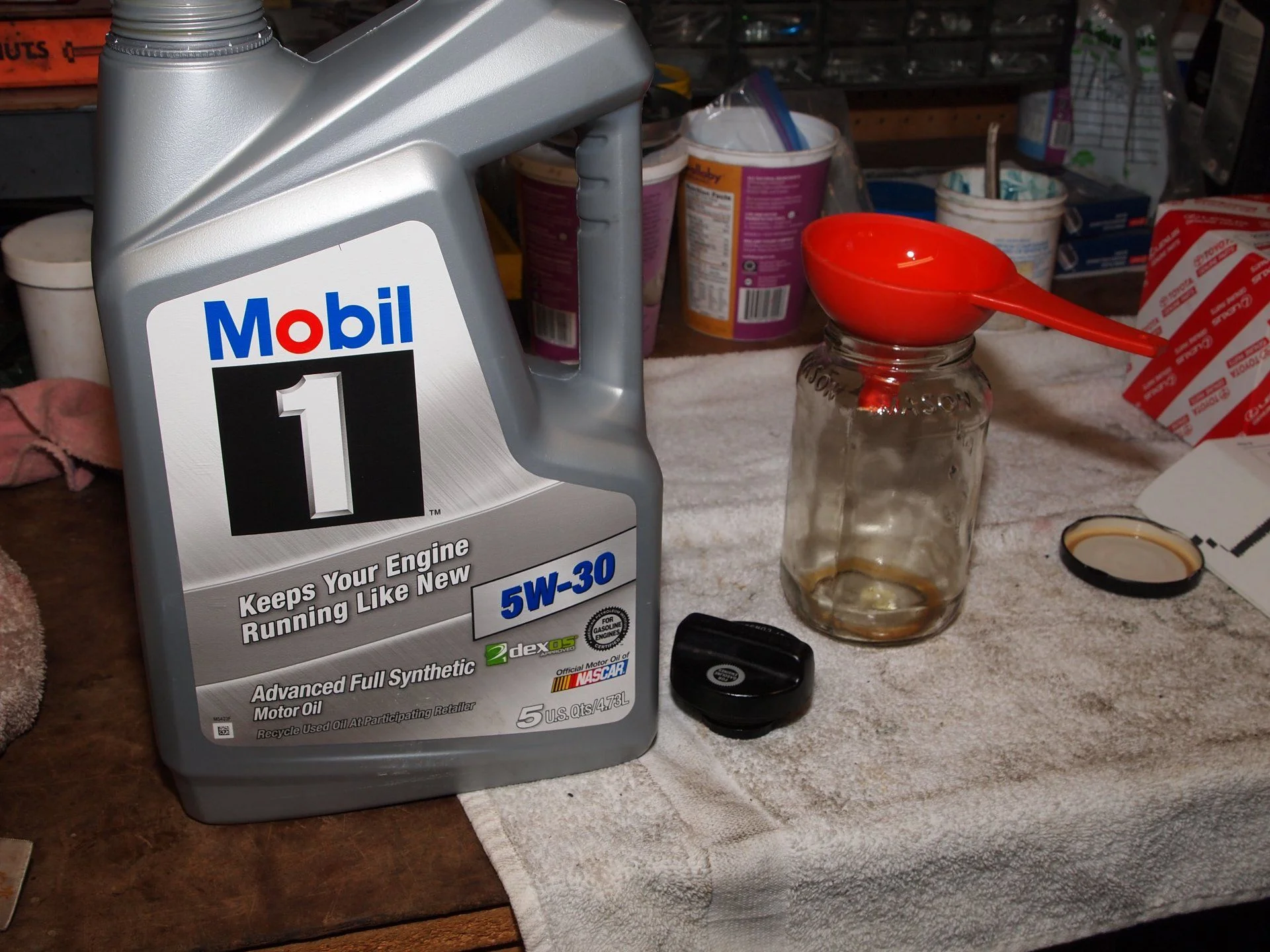

Sticking with KISS, of course I used M1 oil & filter:

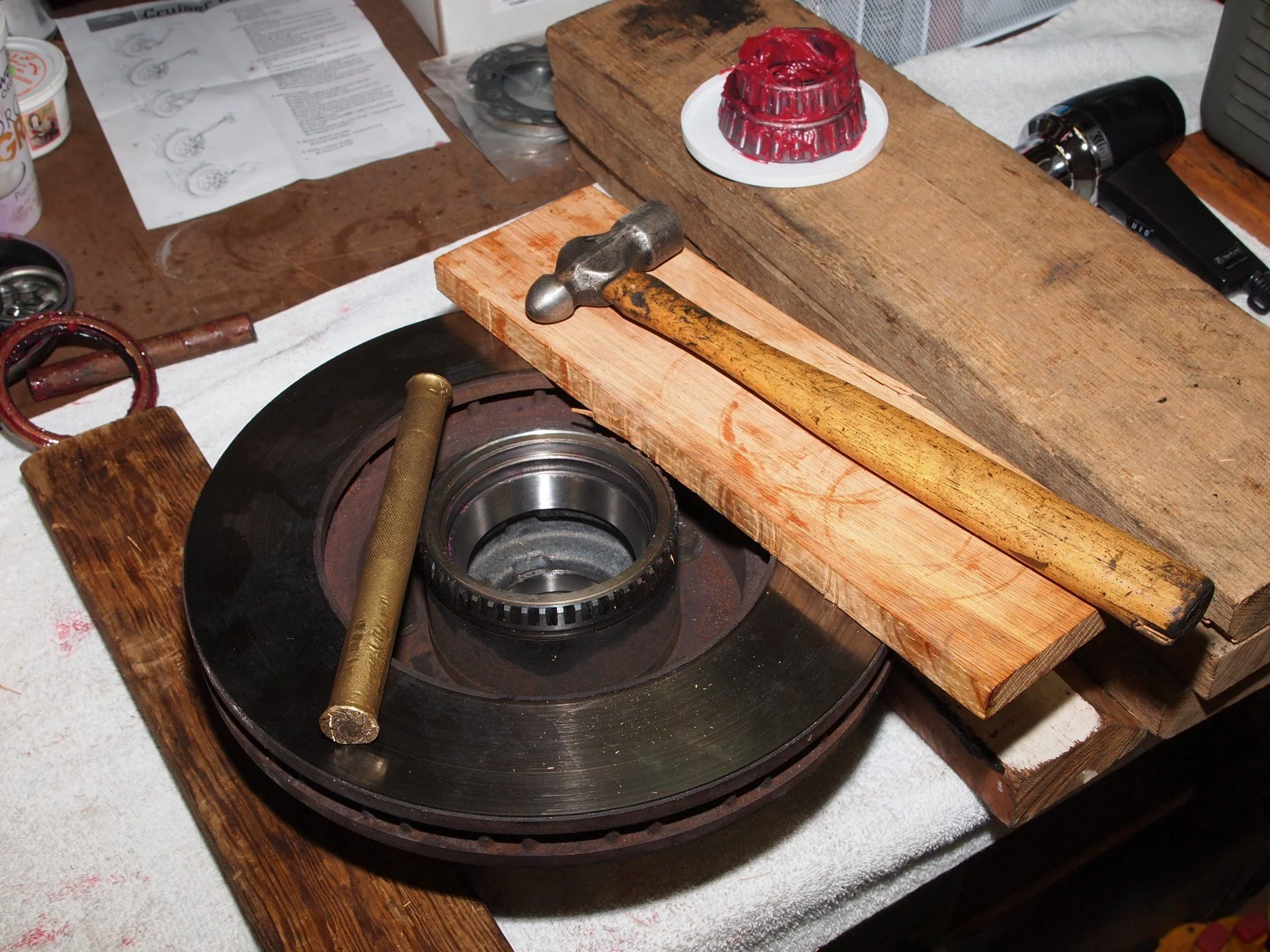

I used @AimCOtaco suggestion of freezing the bearings races' overnight to shrink, being careful to not mix bearing & race sets.
After removing old races, I cleaned wheel hub inner area with wire brush to prepare for races:
Used a space heater for ~90 mins to heat wheel hubs, followed with heat gun just before installing the now frozen races:
Tap in races using price of oak to protect race, then old races and final set/seat with brass dowel.

Regarding installing the races- for DIY on lookers, you can achieve good results by placing the race in the freezer for 30min-to an hour. I did this with out heating the hub and the went right in using the old race to tap new into place with very little effort.
Are you bringing this one to HIH?
Thank you both, pats on back are always welcome.
Actual I installed races in one side after only a few hour's in freezer, the other side after 24 hours of freezing. The 24 hours freezing side slipped in much easier. Next time I'll try not heating the wheel hubs!

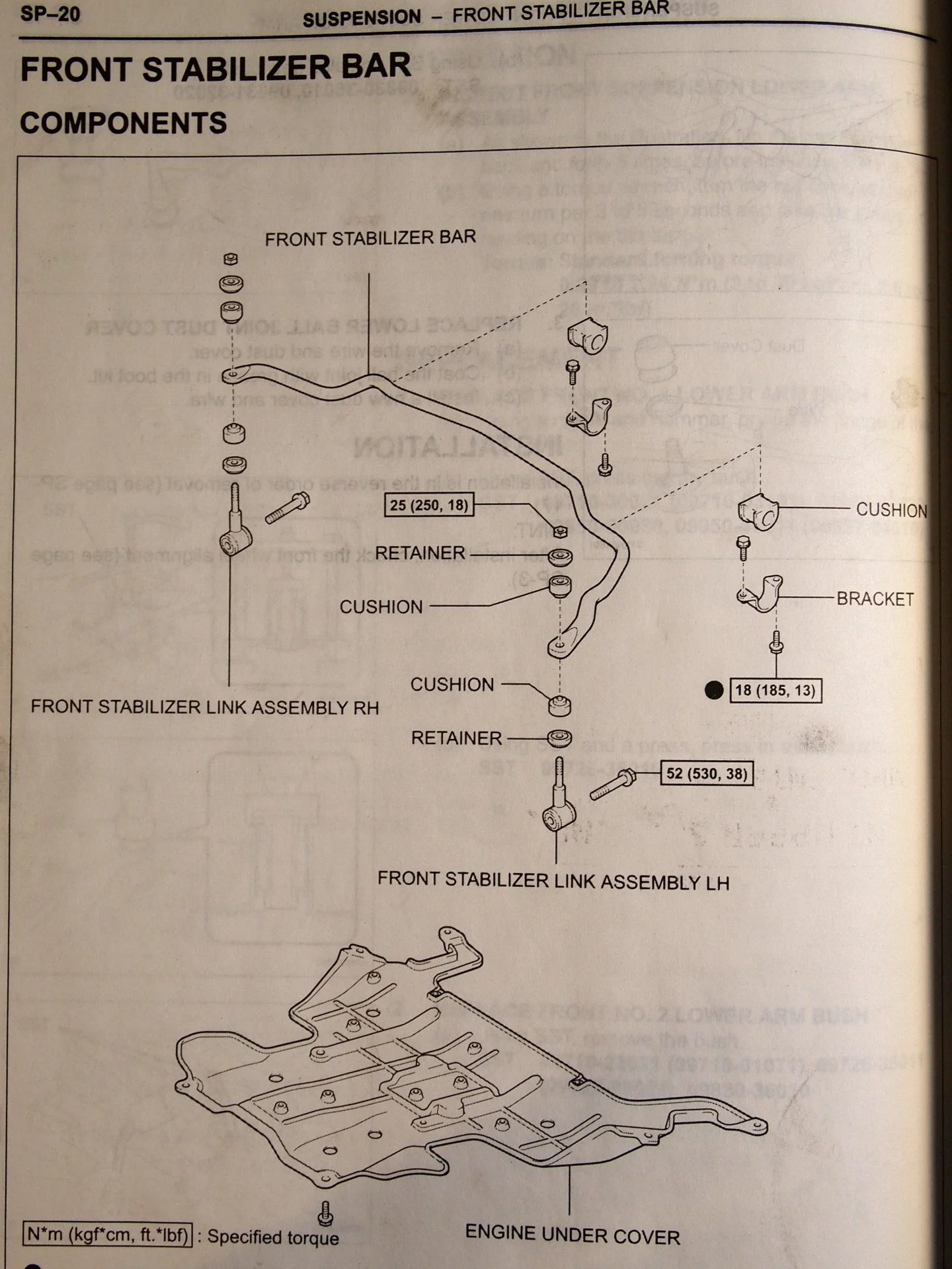

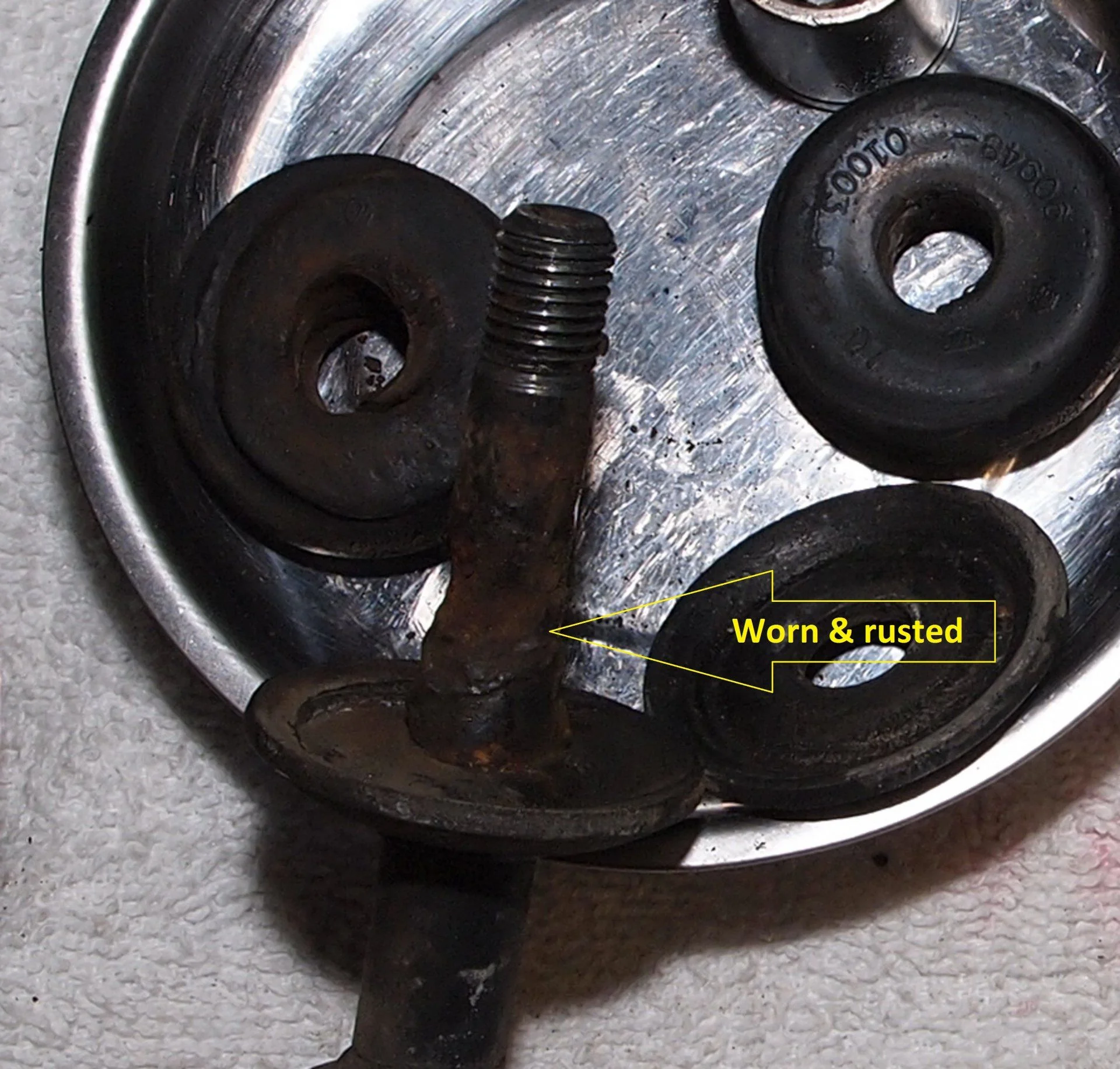

Looking for creaks & squeaks in post #45 found rear stabilizer link to bar cushion & collar was shot, which I replaced at that time. At same time I found a busted (rusted through) link from my 01LC (The King) lying on garage floor. So I totally rebuilt the stabilizer system front and rear on the King. The handling afterwards was amazing, getting on HWY ramps & mountain roads was like dialing back the clock 13 yrs.
So the decision to rebuild the 07LC (Redbarons) stabilizer system was subsequently made, to insure it would handle as designed for years to come. It was a good thing too, as issue were found. Number one was front links were rusting and stabilizer bar link mounting holes were widening. The front bushings also were more worn than early visual inspection revealed.

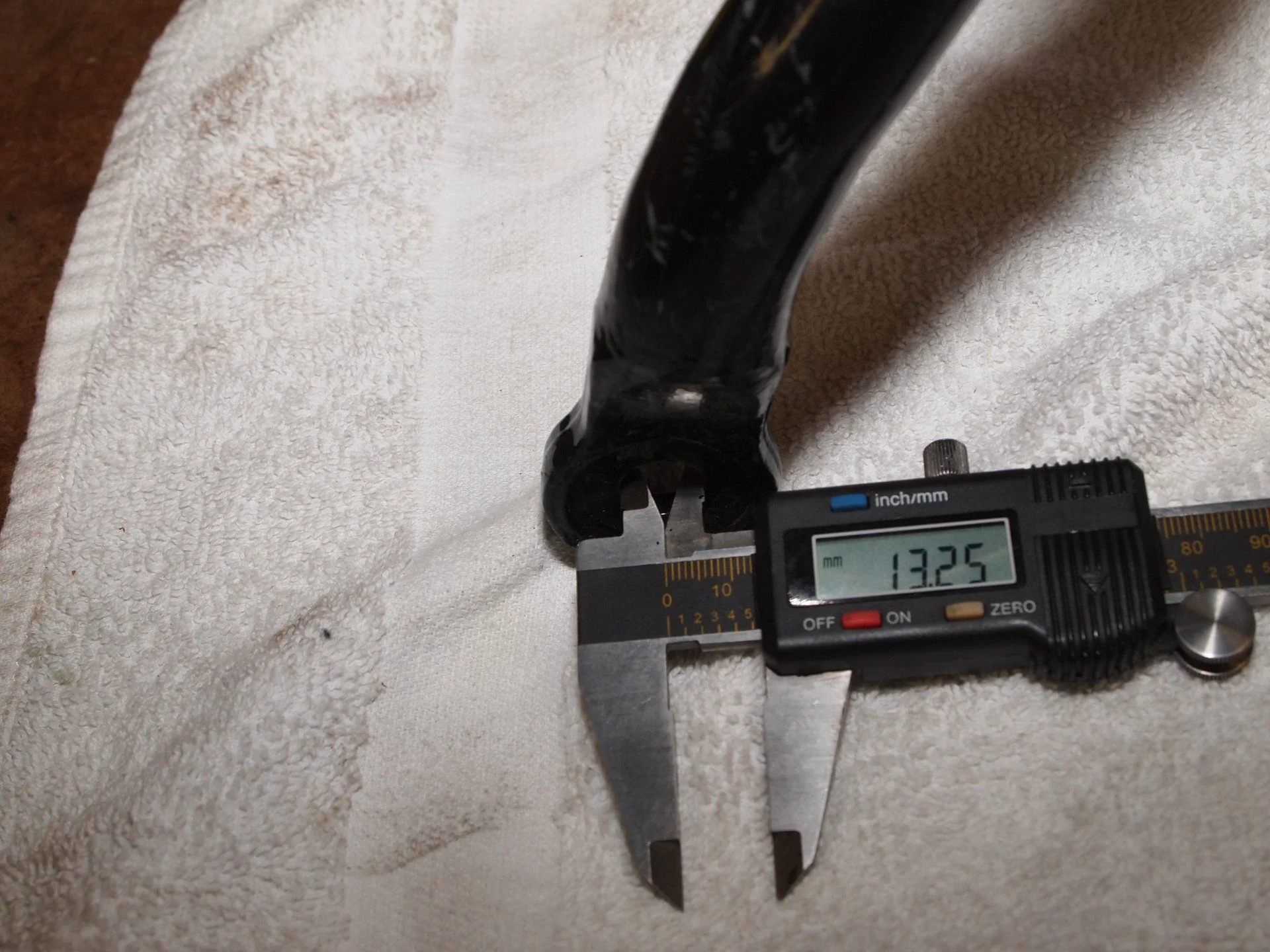

Old stabilizer bar hole for link mount was 14mm at narrowest point:
New stabilizer bar hole for link mount was 13.25mm at widest point:

Paul,
Were you able to get the front stabilizer bar in and out with out removing the torsion bars?
Yes. The one bolt facing down is time consuming as it must be wrenched all the way by hand. Toyota engines really helped us here with the forward nut coming in from above/top. I start both by hand then use my air tool on top bolt.
One issue I'm having with both the 01 & 07 is getting front bushing to seat with no gap at rubber seam. I'm letting it work itself in then I working in by loosening bolts, adjusting rubber bushing and then tightening again. This may take a few repeats!
