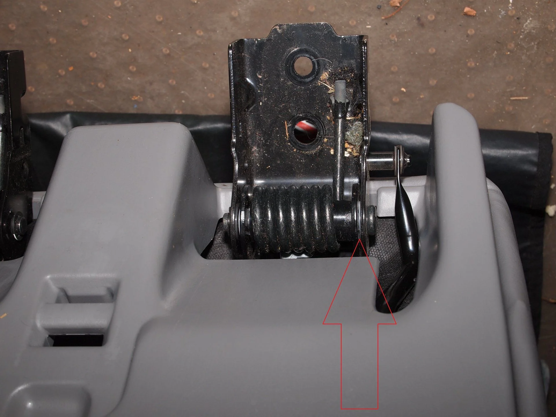

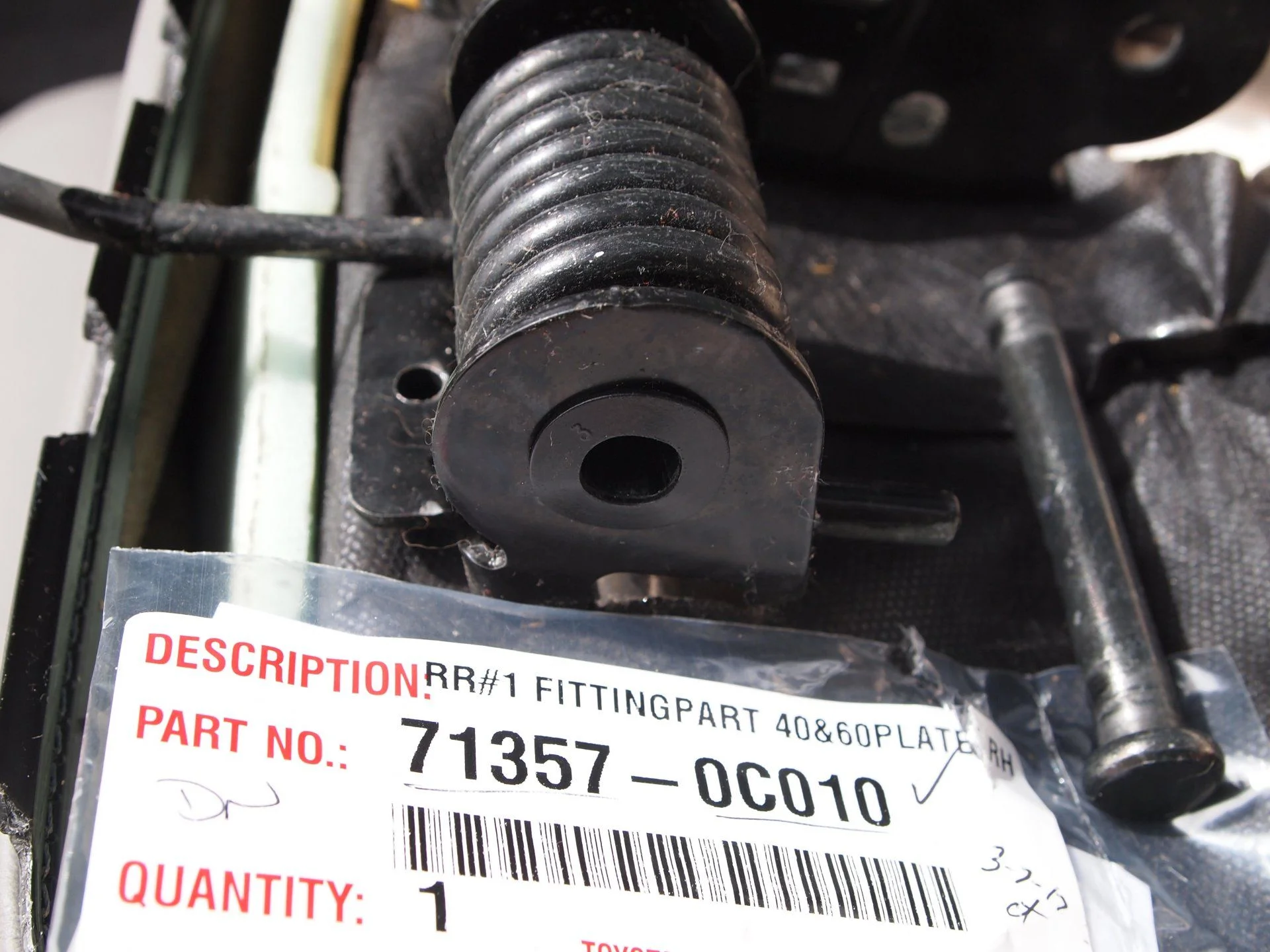

Second row jump seat bushing replacement.

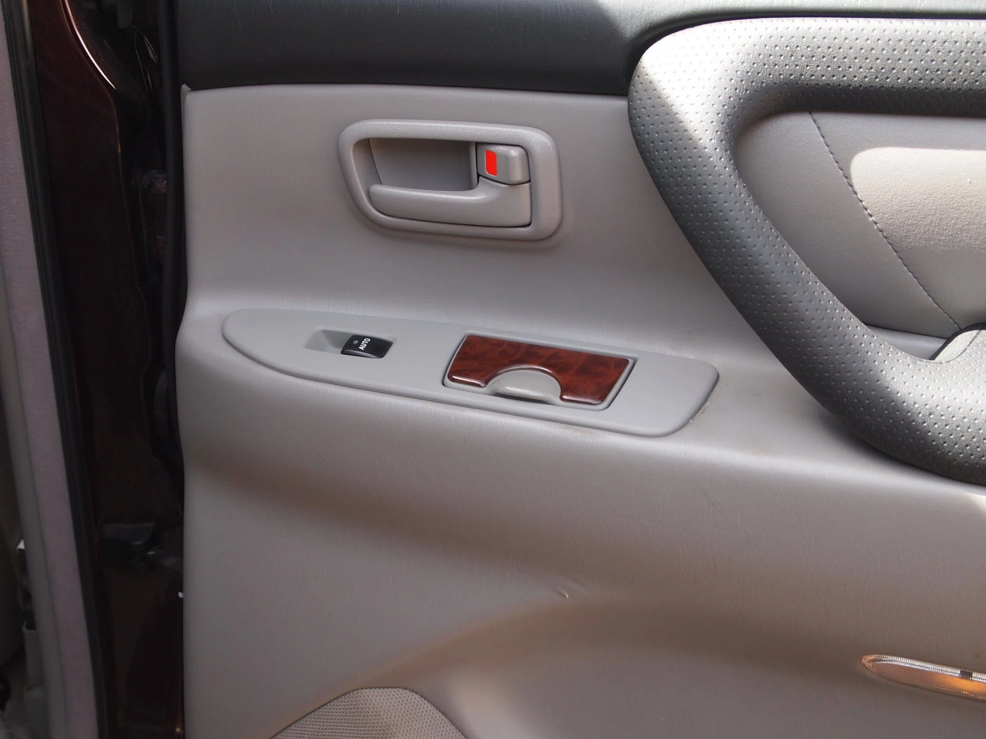

More repair needed do to previous work done. Ashtray/window switch housing rear catch/clip broken. This was apparently broken while replacing PS door rear window at some time. Tech must have just pulled stright up at rear of housing breaking hook, then tried to glue back on/in. I just replaced with new house from Dealer.
The rear hook was a solid plastic stationary piece, not meant to be pull up while hooked.

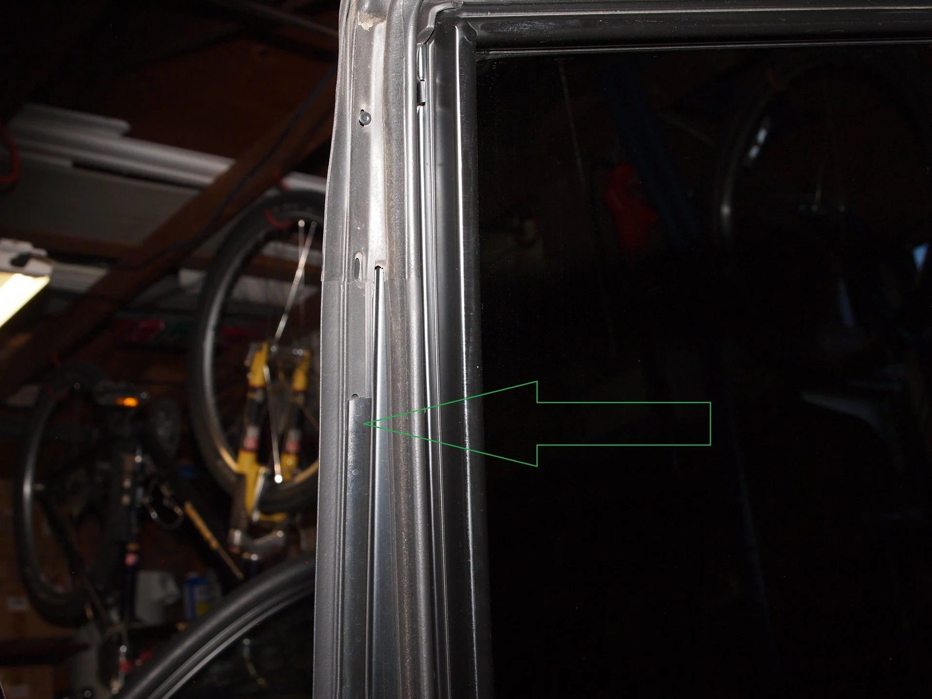

I replaced this broken seal retainer with new, it's anchors by rivets that aren't on my 01LC. It covers B pillar between front & rear doors.

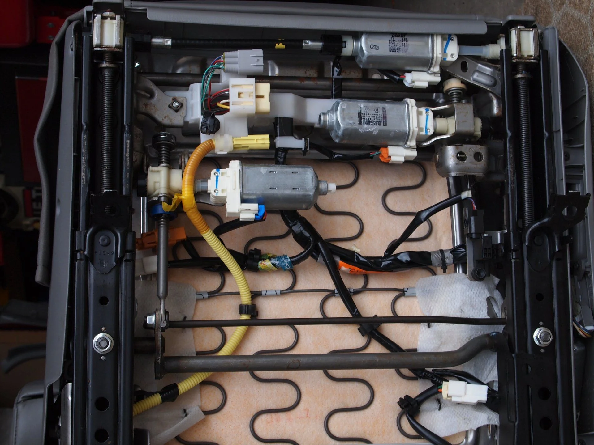

It is a 15 minute job pulling out. Spread plastic covers, from back along seat rails releasing rear pins/clips, then pull straight out release front pin/clips. Remove 4 bolts. Lift front and prop up with piece of wood, so you can disconnect wire housing(s) and release tie strap (don't remove just release with small prob inserted into back.
View attachment 1429326Here you can see Screw mechanism which has grease on as well as rials. Both must be keep clean.
View attachment 1429329 Older 100's have only one wire block housing, this 07 had three.

More details please, is this the cure for shaky seats? Or just a part your OCD wouldn't let you pass up?
Yes it did "help" with "shaky seat" sound from vibrating at this one point.
Restoration = OCD to some I suppose.
For me restoration means even the smallest parts brought back to within factory spec. I replaced these because seat was rocking in hinge. Eventually these old plastic bushing would have completely failed, leaving metal to metal. Then it would produce a nasty metal to metal clank, damaging the more expensive hinge & pin. PM is about, spending pennies on small stuff. And yes in this case it's was also part of chasing chatter & squeaks to get a nice quite ride.

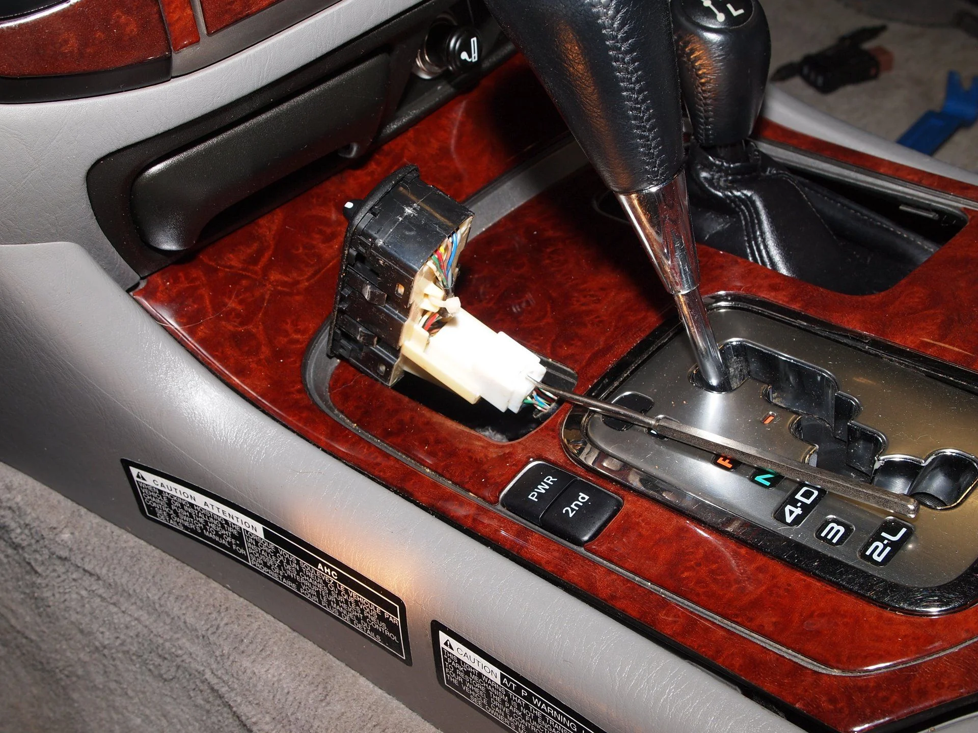

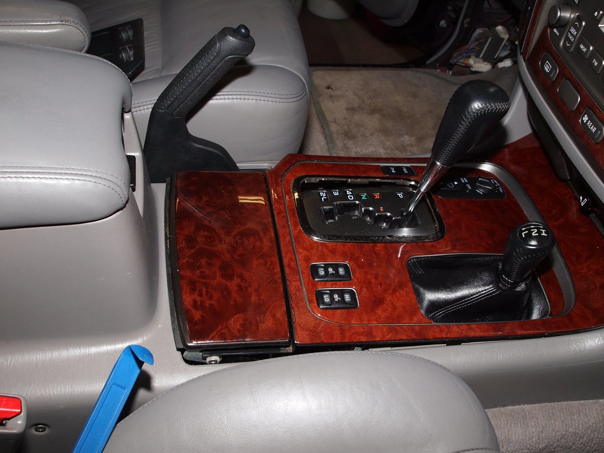

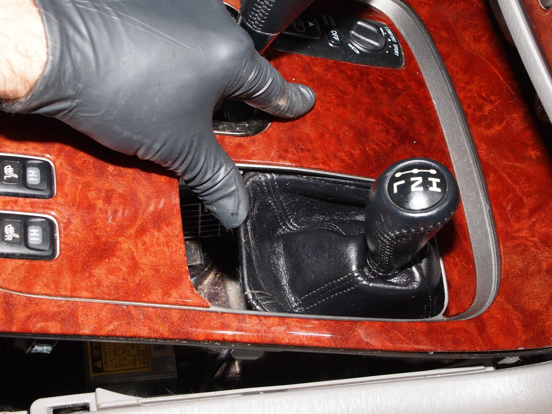

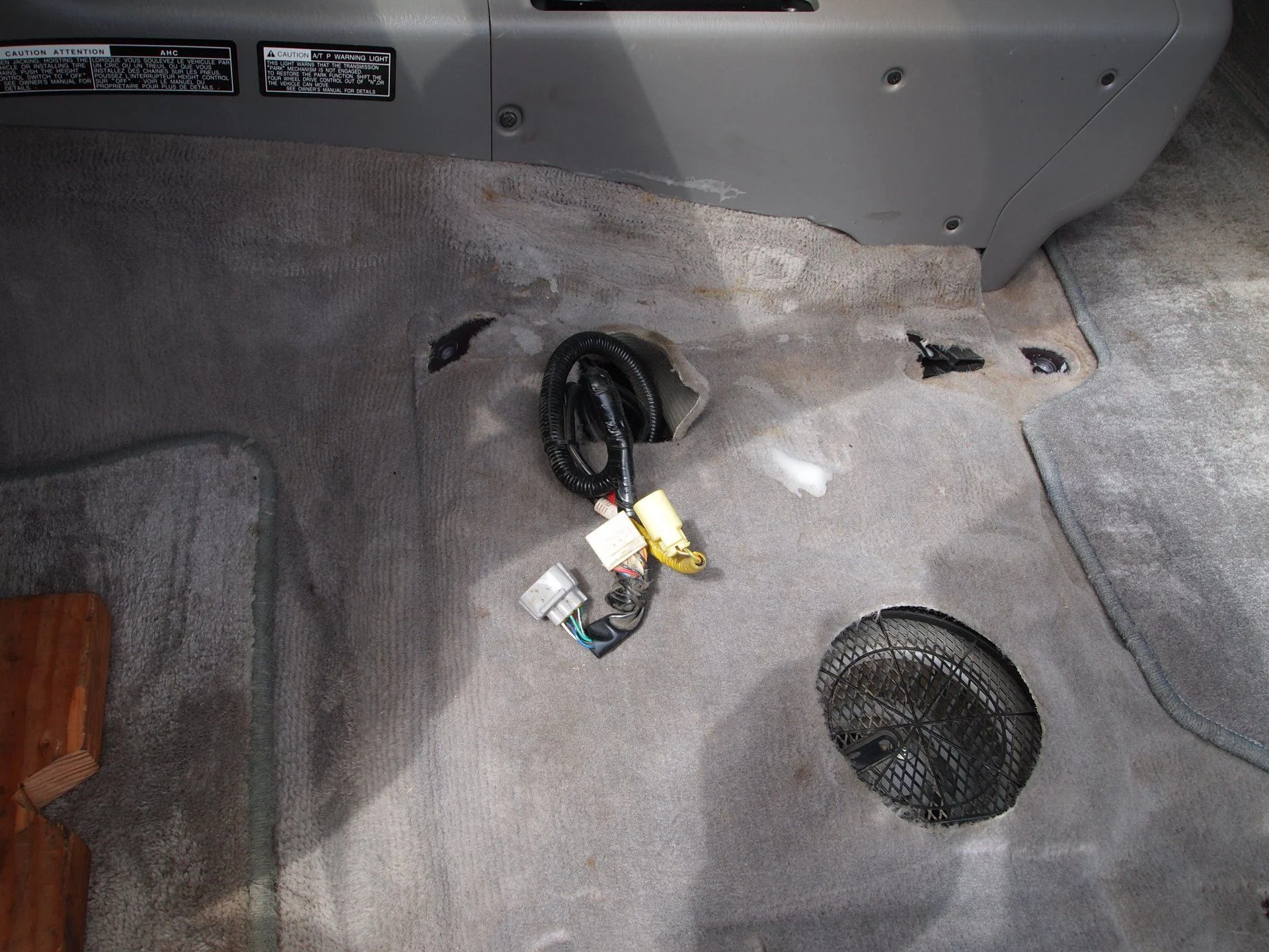

Pull the console trim to remove the controller & wires that belong to headrest DVD, and terminate the hot & ground wires for it. Also pulled the chrome trim off from around shifter, since chrome is peel off.
I've don't remove boot any longer. I've found it is much easier to just twist off knob of Hi LOW shifter
Fuse box and connection plug to power headrest DVD:

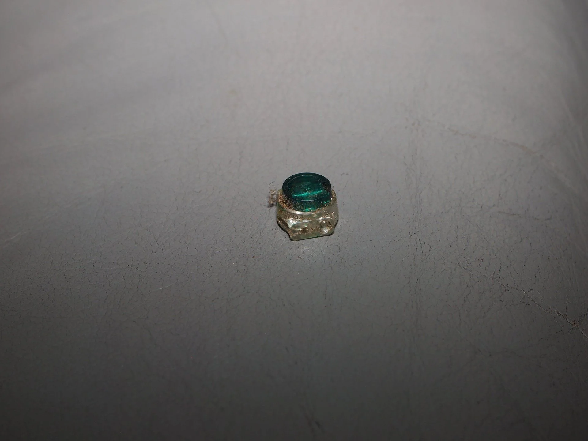

Found a couple of cool wire splicers. I was able too used them as terminator, for power & ground of DVD tap.
