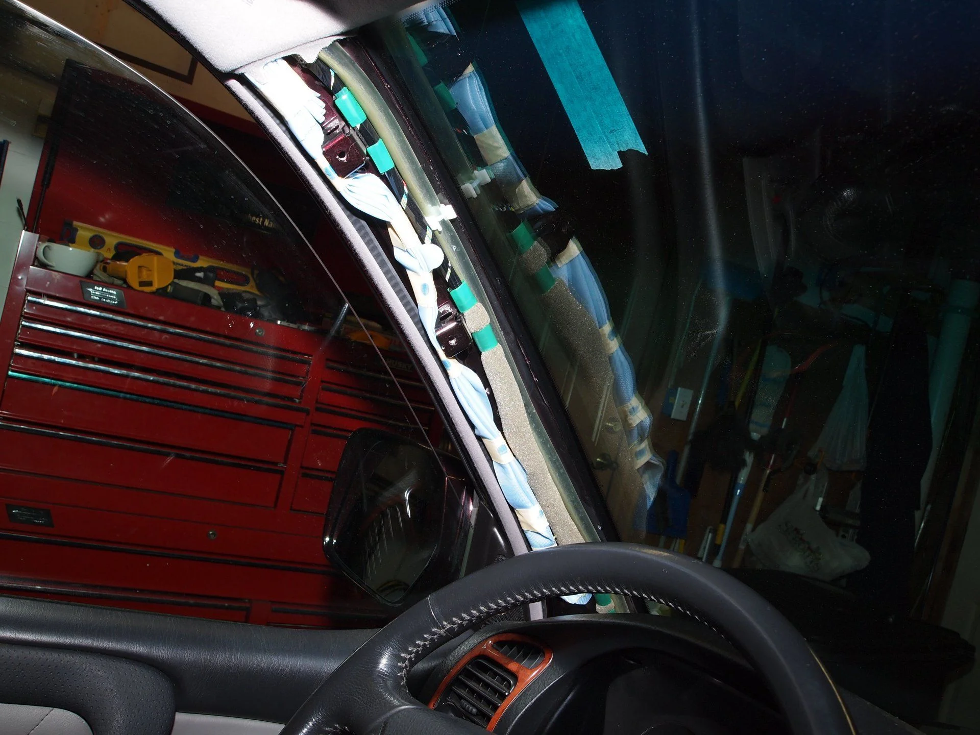

I'm having windshield replaced later today, so I went ahead and pulled molding to look for rust. Happy to report no rust around windshield. I did find sources of wind noise. It seem last installer did a good job using aluminum rivets (I cannot determine if they were plastic coated) but only 3 on each side, leaving bottoms (4th ones) out.

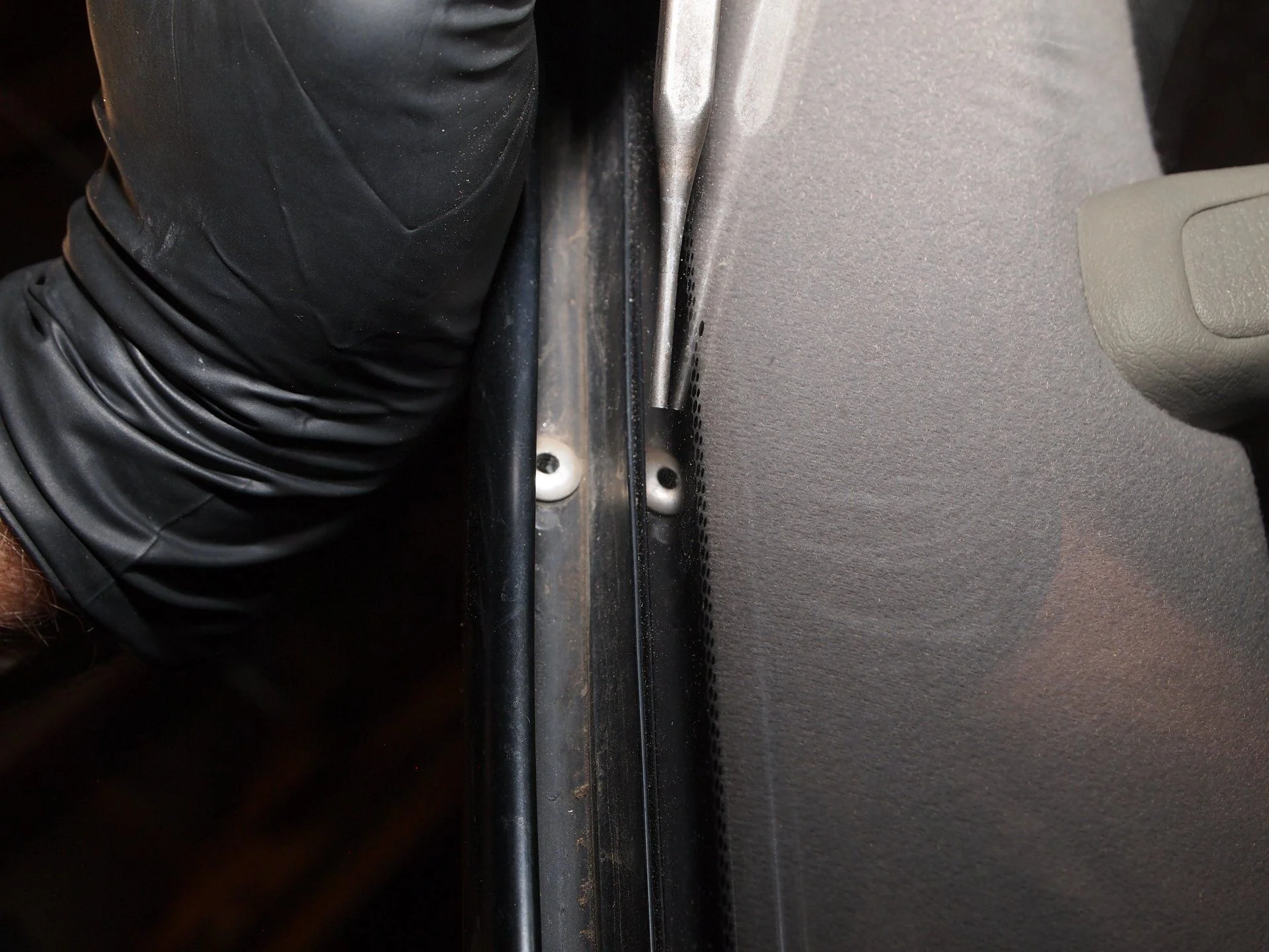

I remove the rubber strip molding that cover the rivets inside the side molding first:

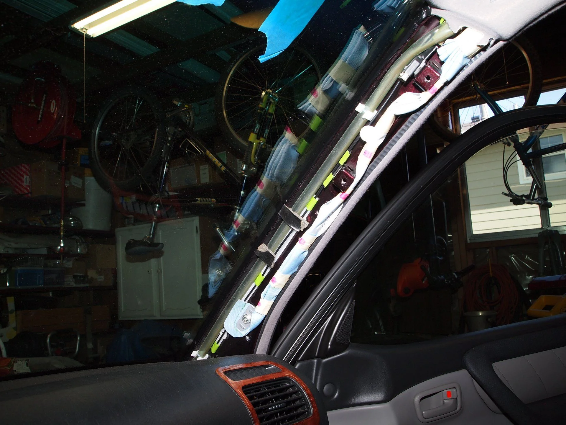

Then knock through the center shank of rivets:

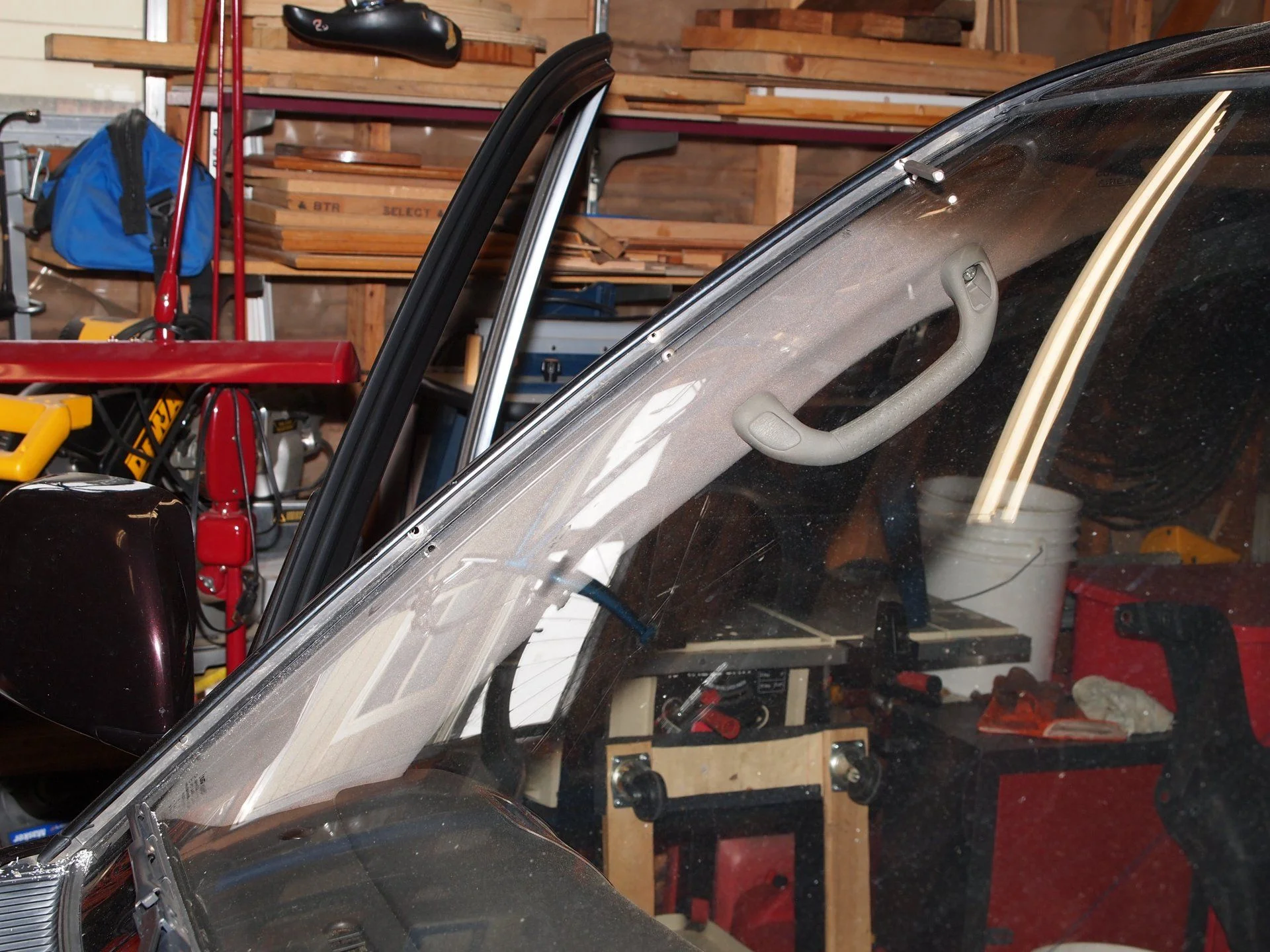

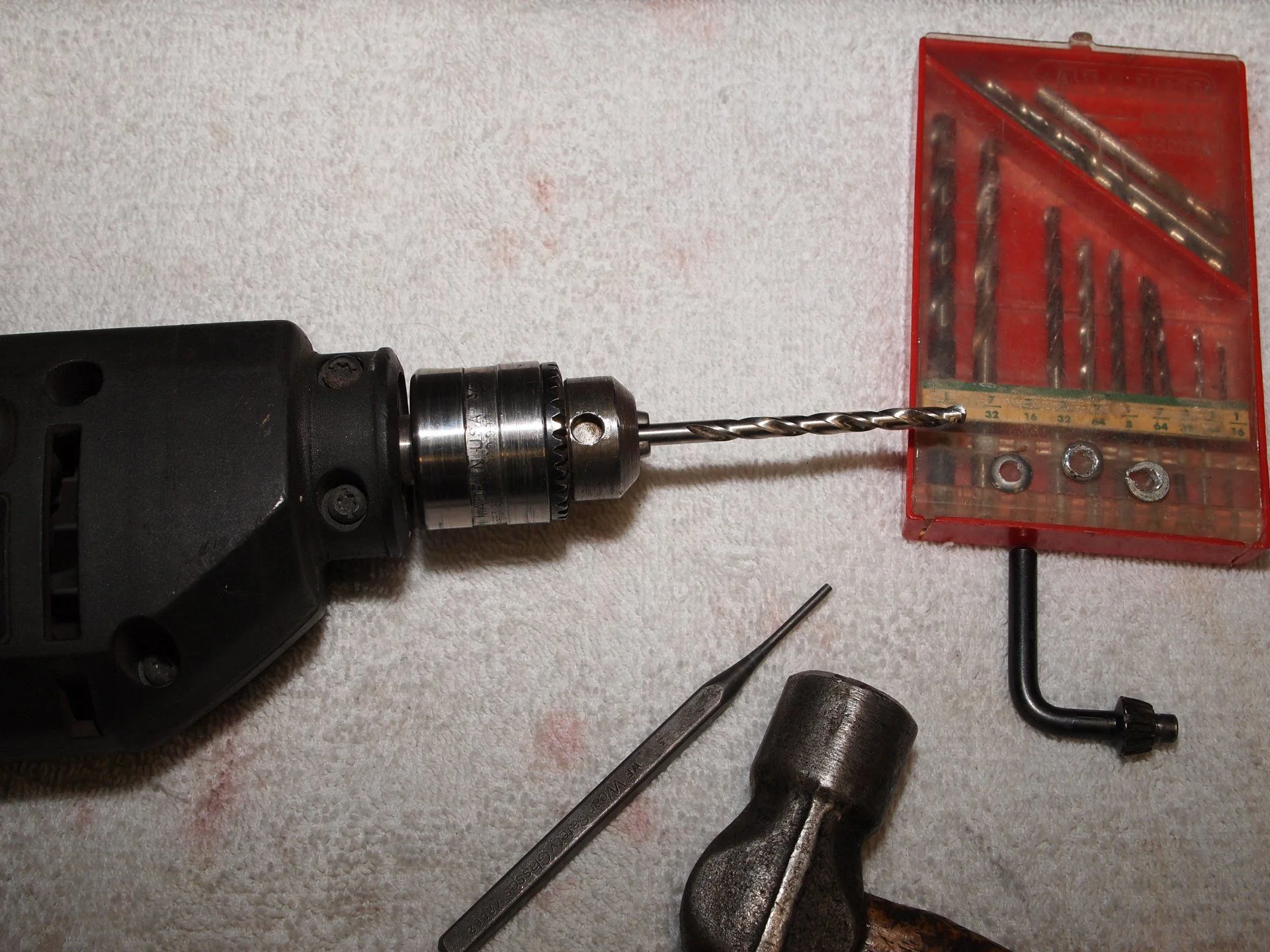

Next I drilled the rivets out with a 3/16" bit:

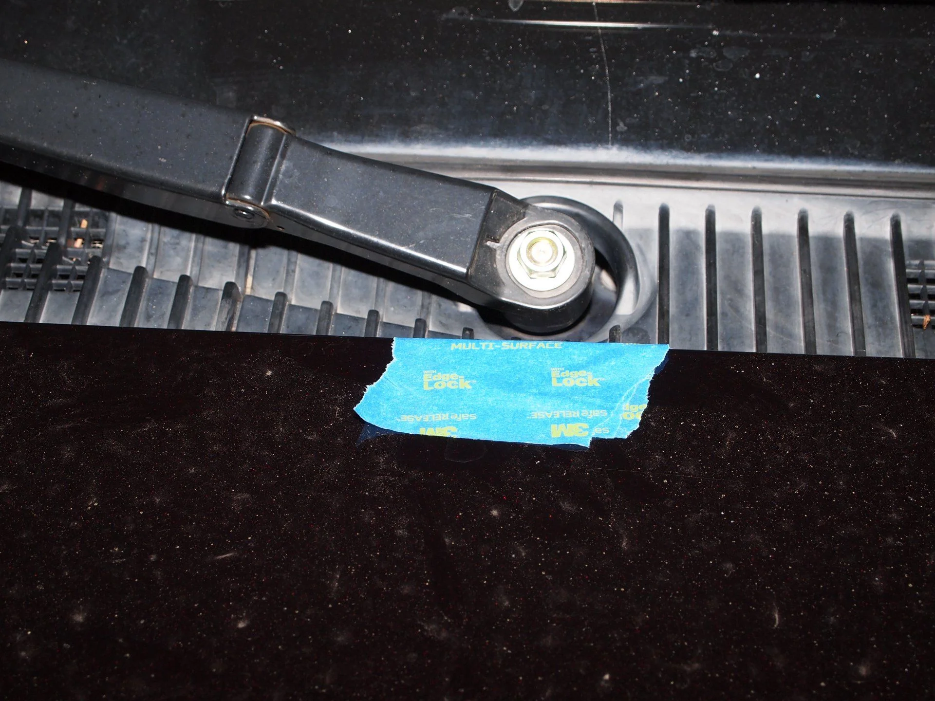

Once I had rivets out of my way, I removed windshield wiper arms. They popped right off once nut was removed without the need for a puller, sweet!

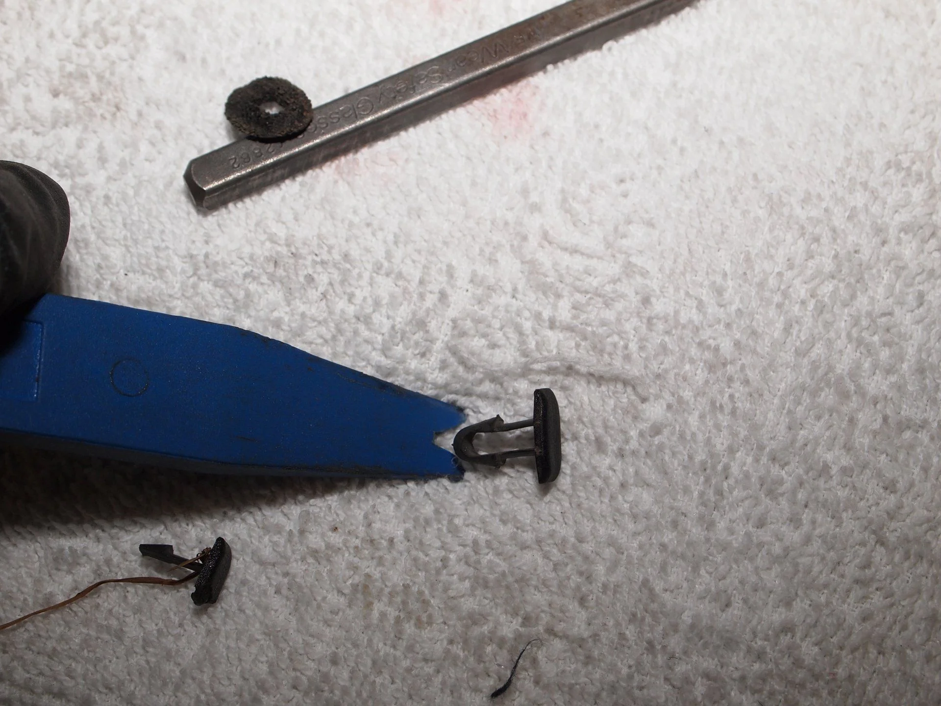

I then puller rubber strip molding (gently) off fastners that hold vent molding:
After which I removed the fasteners:

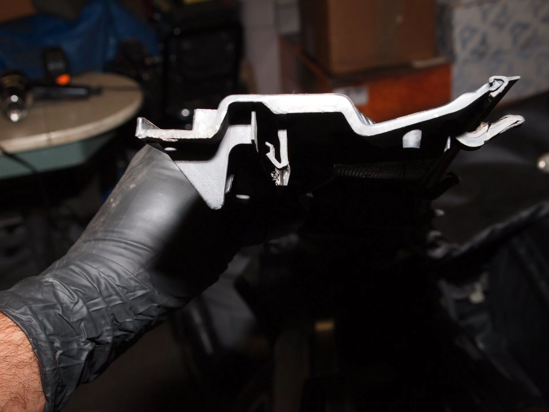

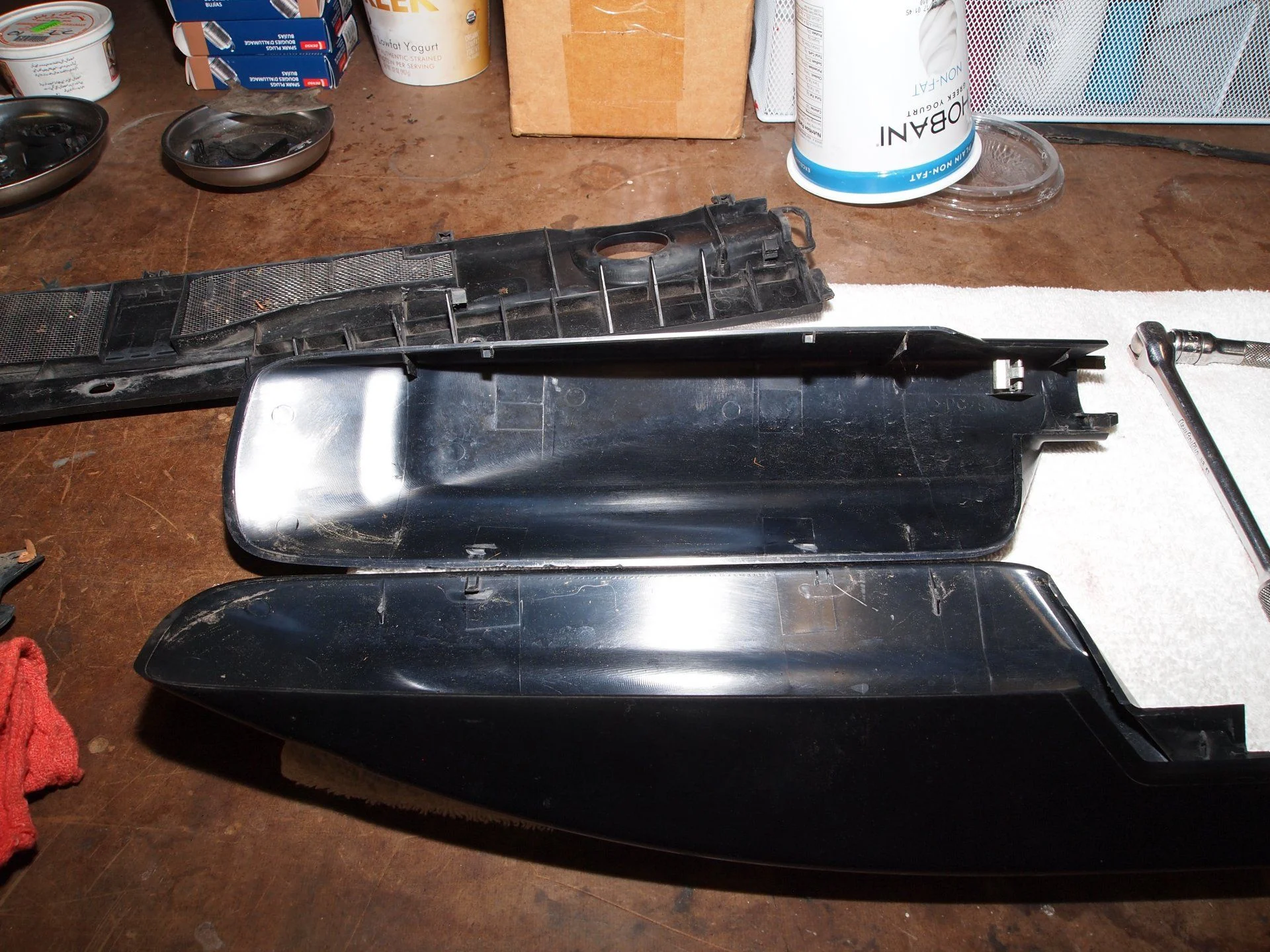

Then the vent molding, which PS has one and DS two keeps that need push from front to release them:
Then removed roof rack front plastic molding just to make install a little easier, but not necessary.

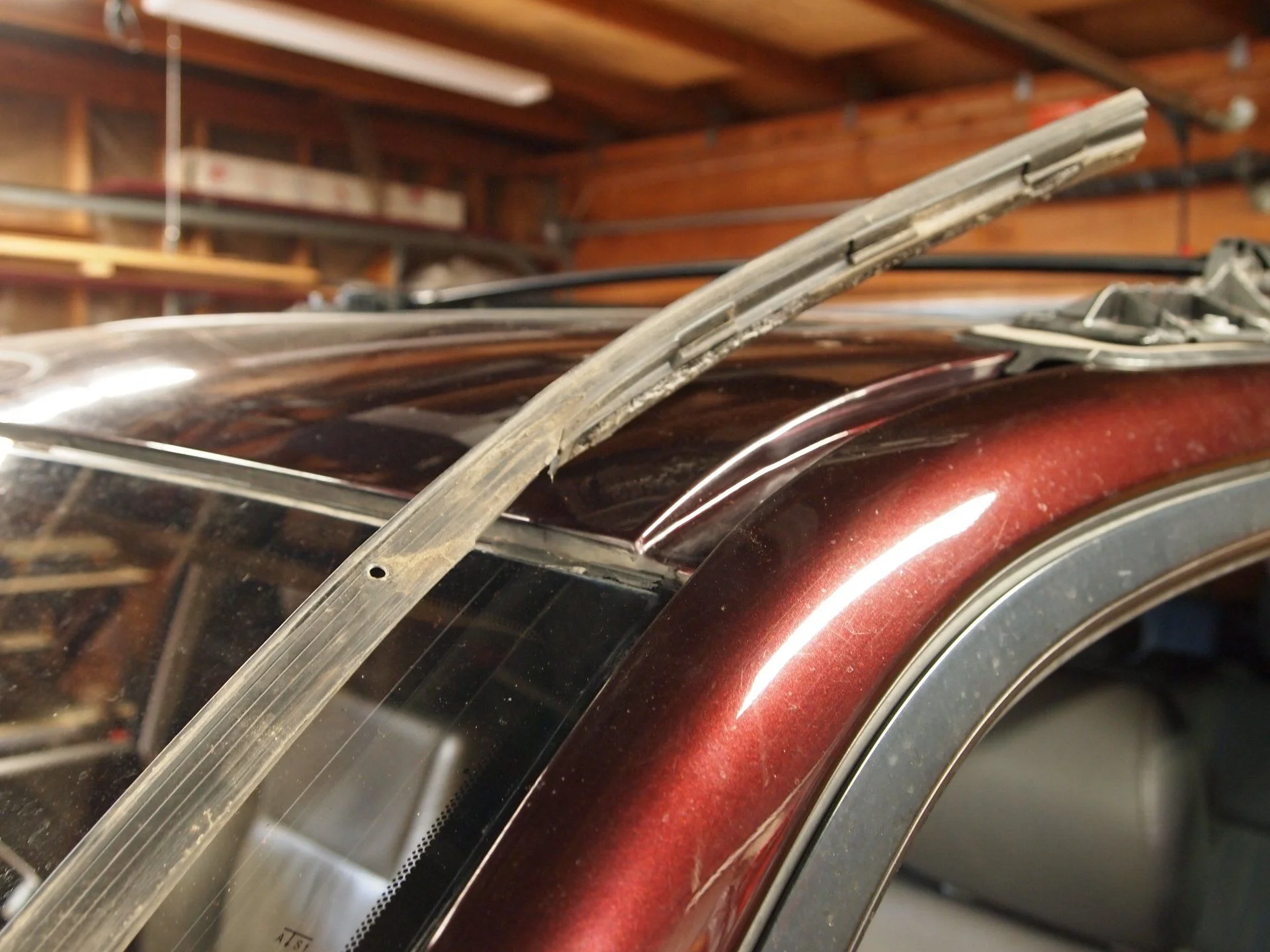

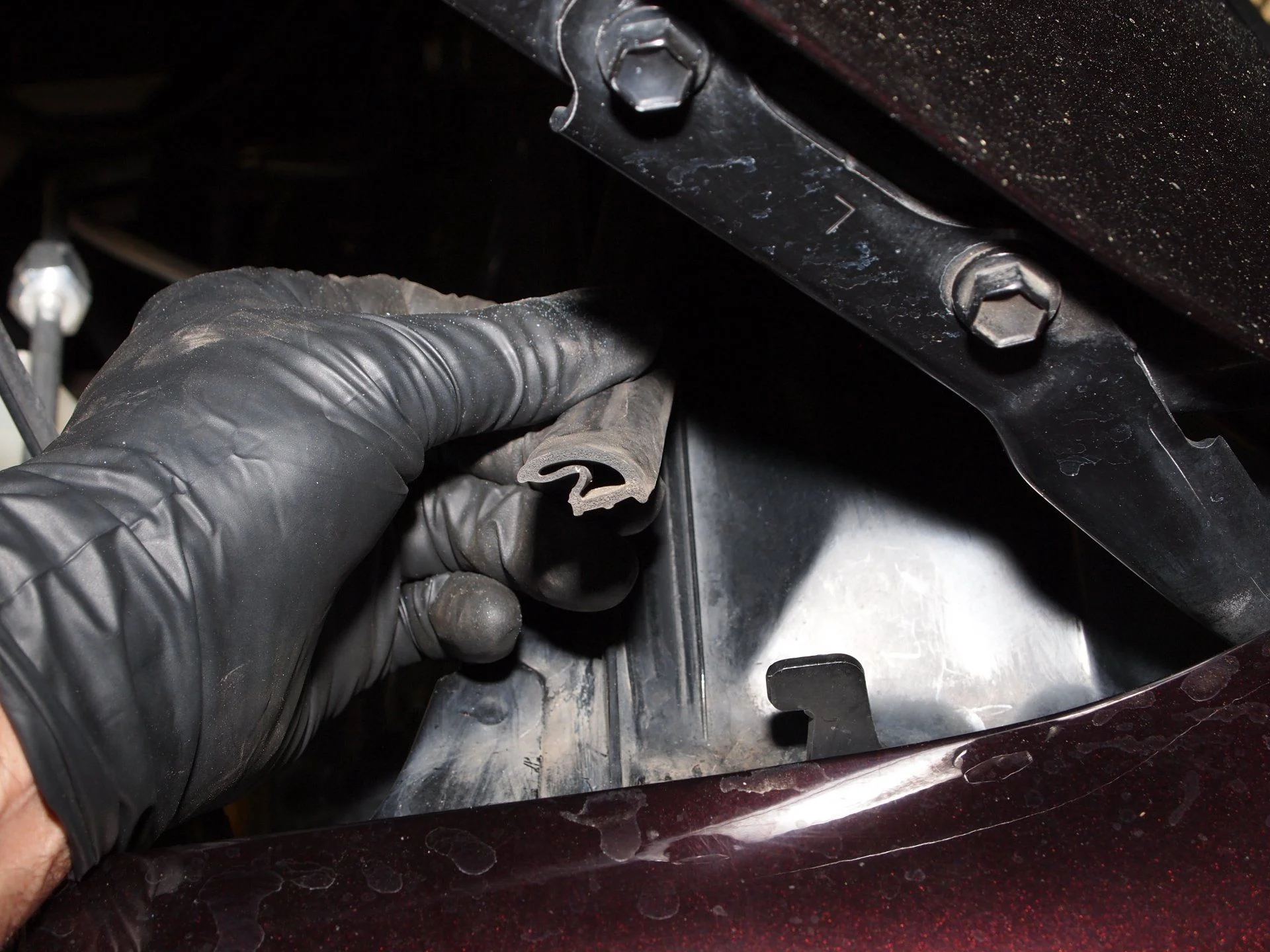

Then I simple pulled off side moldings that I had already drilled rivets out of. New side moldings have double-side tape to tack down at top in roof ruts. These had black poly gluing them down which released with very little effort/pull.
You can see some old tape & black poly on side molding:

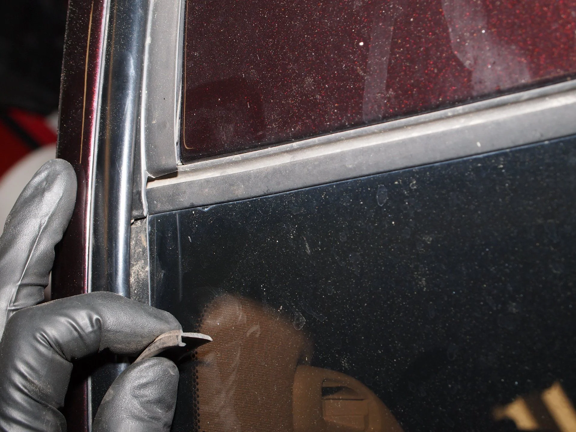

Last piece was the upper windshield molding which simple pulls off:
I cleaned off old black poly from last install, with a plastic scarper & cleaners to prep area. Next I'll pull interior side molding so installer don't mar up!
