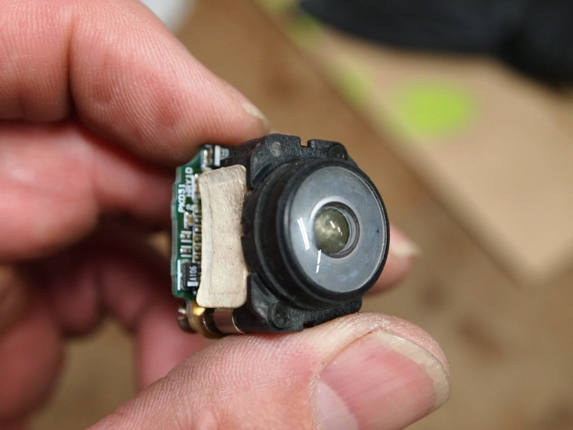

Speaking of camera thanks to @Goebeler and his brother I've got it working. They sold me a camera that came from a rusty eastern rear deck lid off a 04 series 100. I offered to buy it from his brother reducing his cost if he'd buy the deck lid, and so he did. He clipped of the plastic fasteners to release camera from body at my instruction, or should I say my bad as there's no part number for fasteners as it only comes with camera.
The 04 camera housing was rusted and missing seals, so I elected to swap internals. All the screws holding the plastic housing covering the lens just snapped as I tired to remove. So I had to cut housing cover off. It was risky as my bet was the camera lens is what was bad and not the circuit board wire connected to. If wrong, I be back to square one with no mountable camera. Fortunately I was right, swapping the camera lens/chip, which was free of any corrosion did the trick, and I was able to use the good camera housing.
Good camera form 04, bad housing.
Sweet cut off with no damage to internals
Bad lens from 07LC
Picture at last.

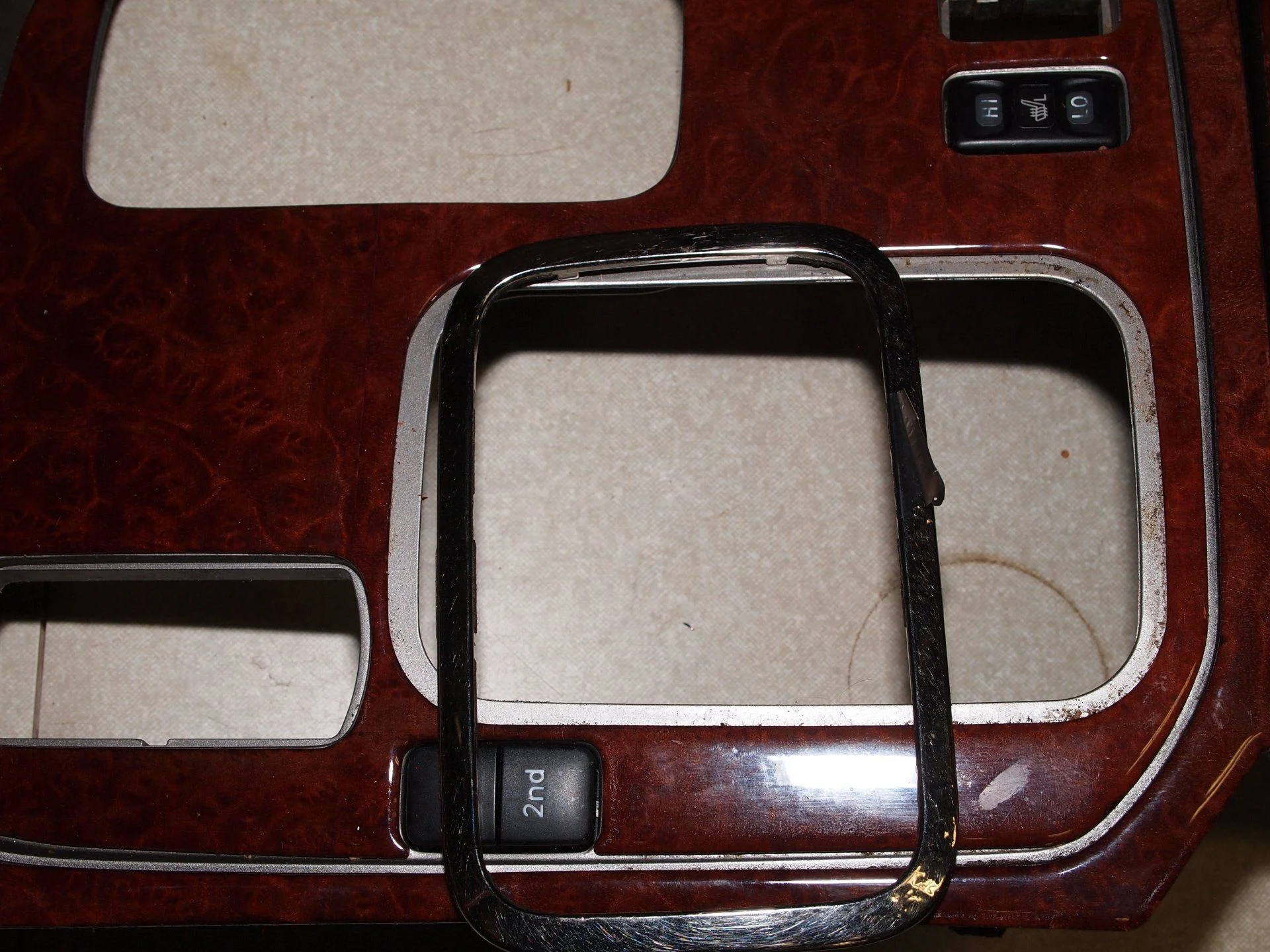

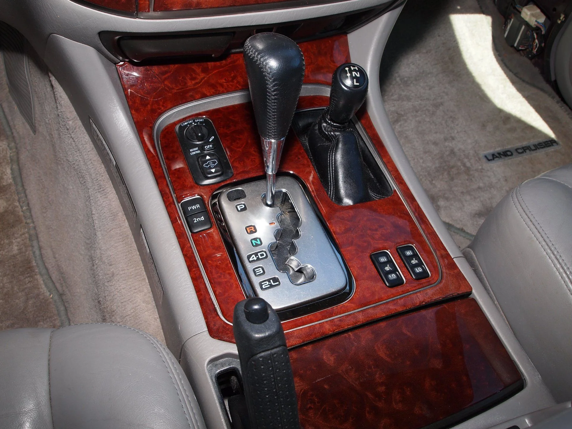

Now I need to decide if this chrome trim piece around shift is worth replacing. I'll bet it's around $50 from Dealer.
Would make console sweet to look at again. What do you think should I replace?
Edited: New bezel gives cleaner look, a gift to new owner.
Old bezel
No I need to decid if this chrome trim piece around shift is worth replacing. I'll bet it's around $50 from Dealer.
At your level of OCD, that is not even a question - you must replace :)
