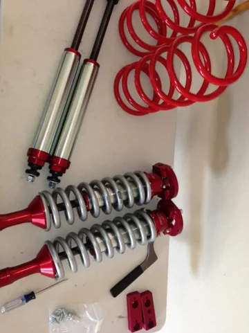

Installed an MT supplied SAW kit on a local's (not on Mud) FJC today.
700lb coils, no resi, basic "kit".

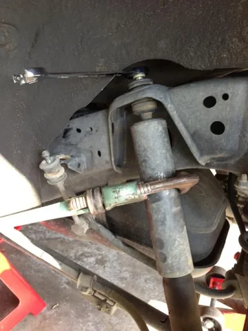

Rear
Tie rod "method". Owner opted for UCAs later.
Four hours work time, solo. Think I'm going to pass the torch on the freebie lifts, though.

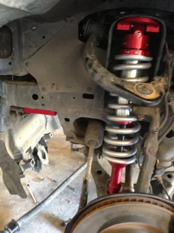

Still nose dives, still has rake, though I've adjusted twice, so going to let him drive for a while, then re-adjust up. Knuckles are already bleeding from trying to get the spanner ( well designed by SAW, I'll add ) inside the tiny coil tower.

The coil overs upper mount is threaded, so the bolts go through the top of the tower into the threaded holes. That's a huge time saver and just makes sense.
Most the others I've installed go from bottom to top, and don't have any means to retain the bolt. A big PITA on the back bolt and overall installation.
Coolest is SAWs spanner ( though the one they sent needed some attention with a flap disk. Was razor sharp. ).
Fits perfectly inside the tower. Best one I've seen, and I've been a huge fan of King's spud bar up until now. The coil but set screw may pose issues with finite adjustment, since full revolutions are required, but I've spent weeks adjusting stance, all in vain, so a non-issue, really.
What I don't like, and have voiced about all but King, is the Mickey Mouse bushings and washer on the upper rear shock.
It doesn't retain the bushing quite like, my opinion, it should.
Swapped mine to the King's on the Radflo's I'm running on FJC, and going to spec longer threads on the PP80s, so I can use similar too.
