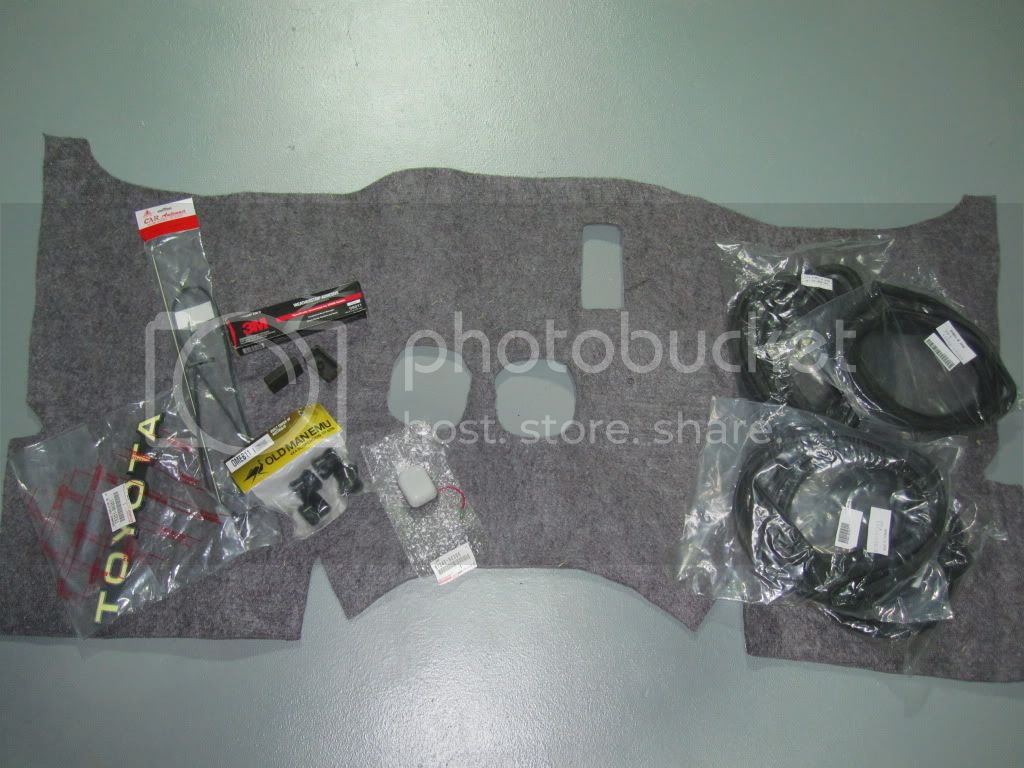

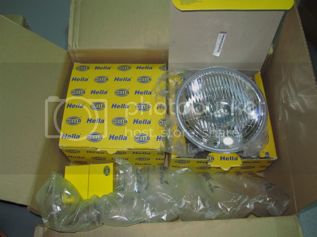

Some goodies came in. The lights are courtesy of Amazon.com, (Hella H4 upgraded bulbs + wiring harness), while the rest of the stuff in the 2nd pic are from CCOT. The OME bushings came from Kurt, and are needed in order to fit the shocks as the size of the bushings that came with the shocks were too big to fit the shock mounts.

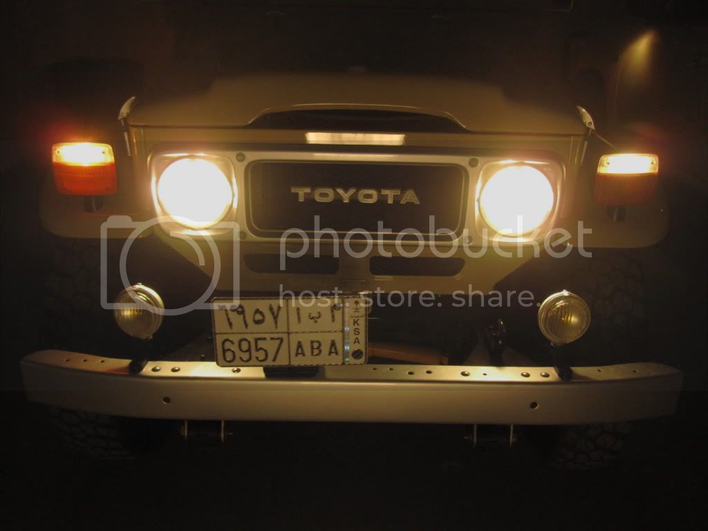

Got the new Hella H4 lights mounted. Sweet!

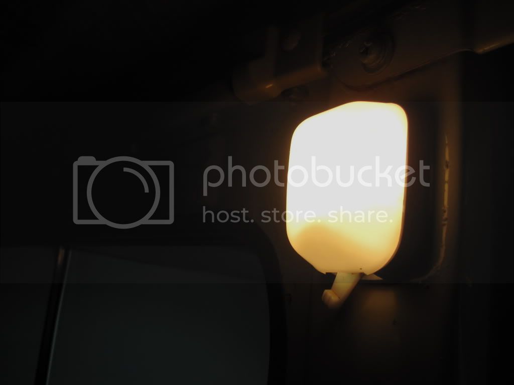

Got the cab light installed courtesy of CCOT.

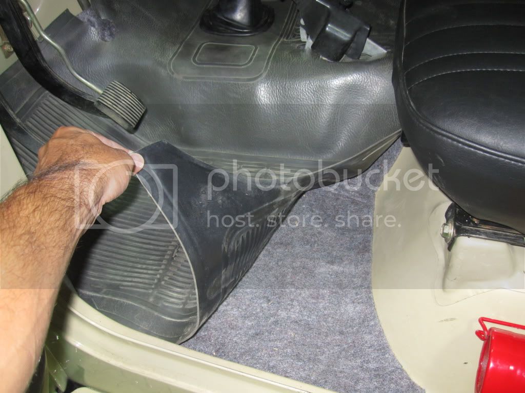

And the floor insulators as well came from CCOT.

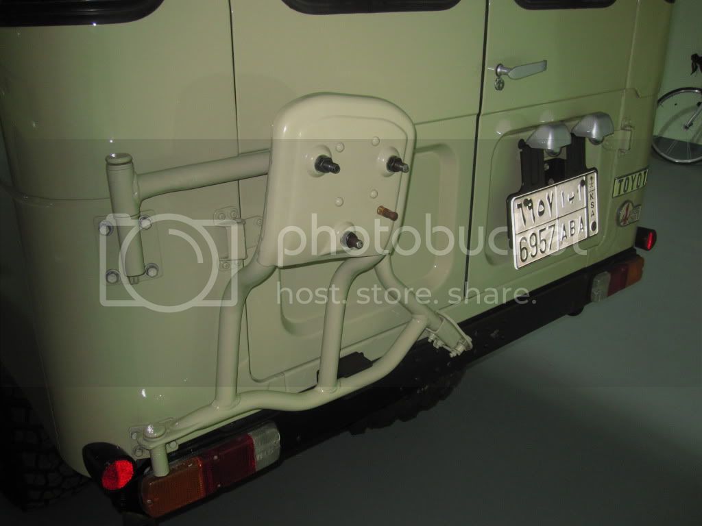

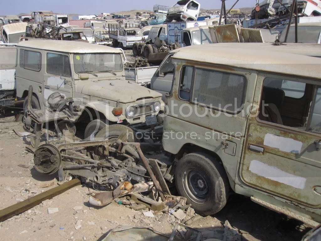

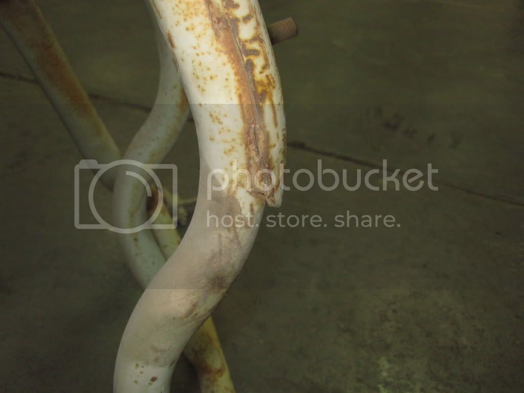

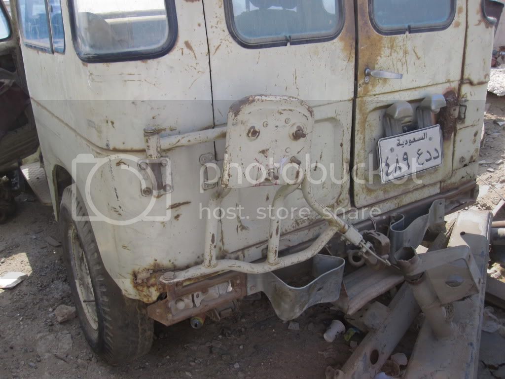

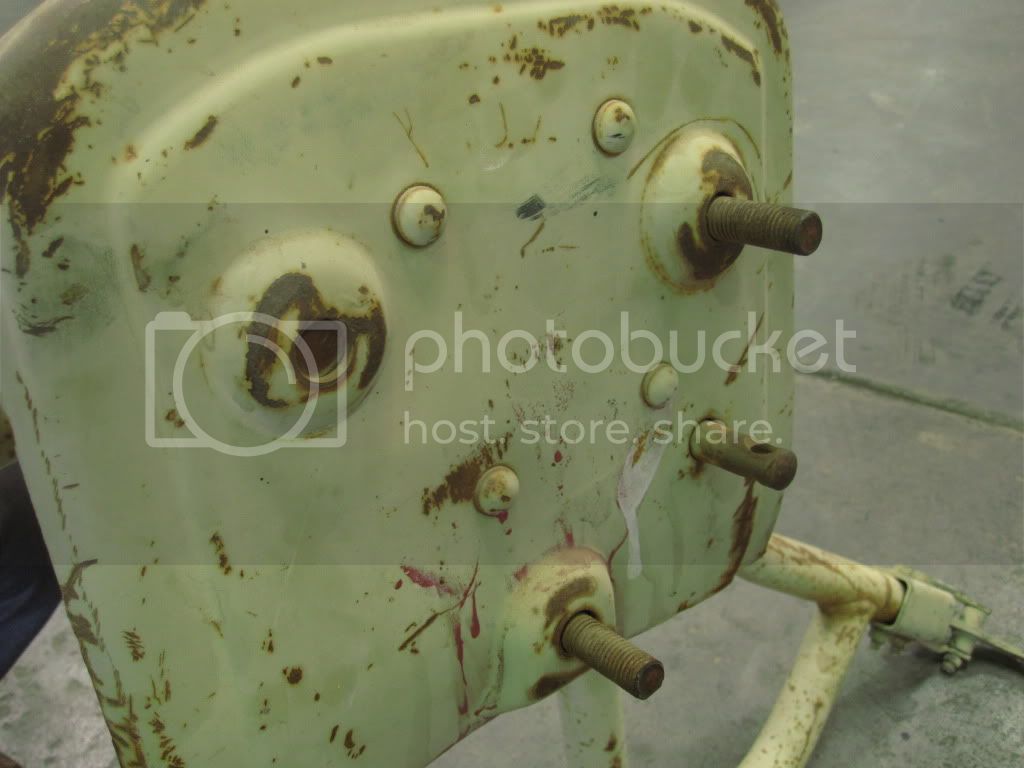

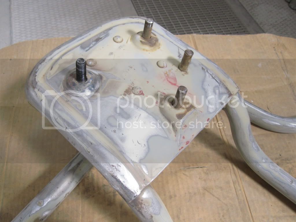

Had trouble sorting out the spare tire issue under the truck, as its rubbing against the shackle grease nipples. I decided I'll need a tire carrier as the original one was fabbed by the PO to fit a jerry can. Made a quick run to the junk yard, and after a few stops here and there and a few unsuccessful searches, I stumbled on a yard that had a couple of FJ40s rusting in the heat.
I haggled with the guy for the carrier, and eventually a reasonable price was agreed. It was missing one tire bolt, and had a small crack on the base. Nothing a little touch up welding cant fix, plus a paint job and we're on our way to having a tire carrier, (and a back up carrier for the jerry can:D)

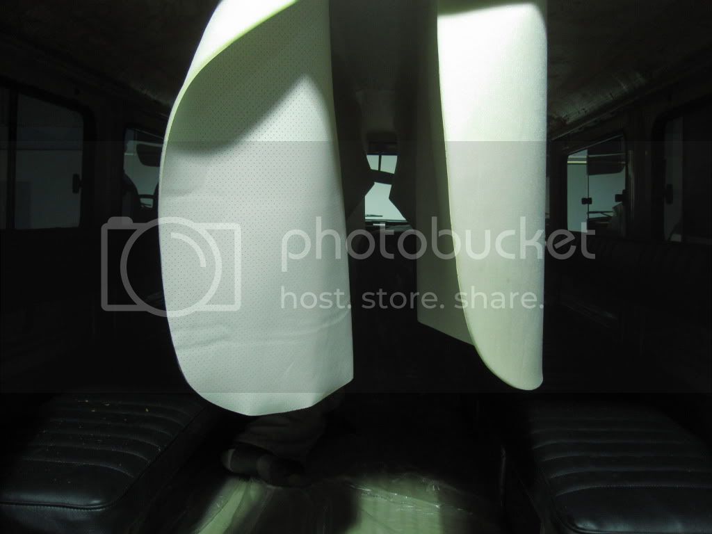

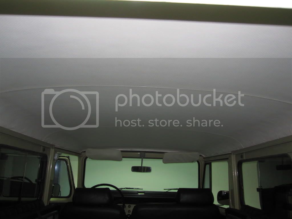

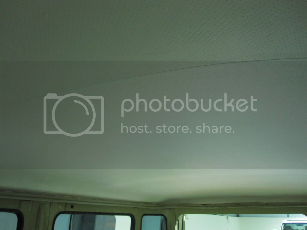

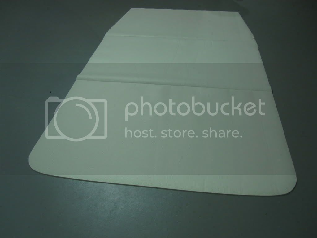

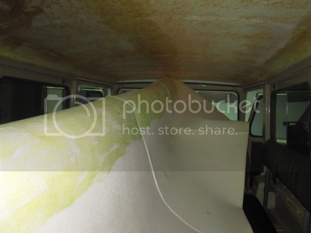

Onto the headliner.
Its an expensive piece of cloth from SOR, and screwing it up is not worth the price nor the effort of bringing it all the way from Cali. If I toasted it, I'd have to chuck it away and so I bit the bullet and brought in a pro to do it. He's been doing car interiors for 30+ years, and said gravity didnt phase him:bounce:
Its definitely a two man job.
I'm just glad I didnt do it myself!

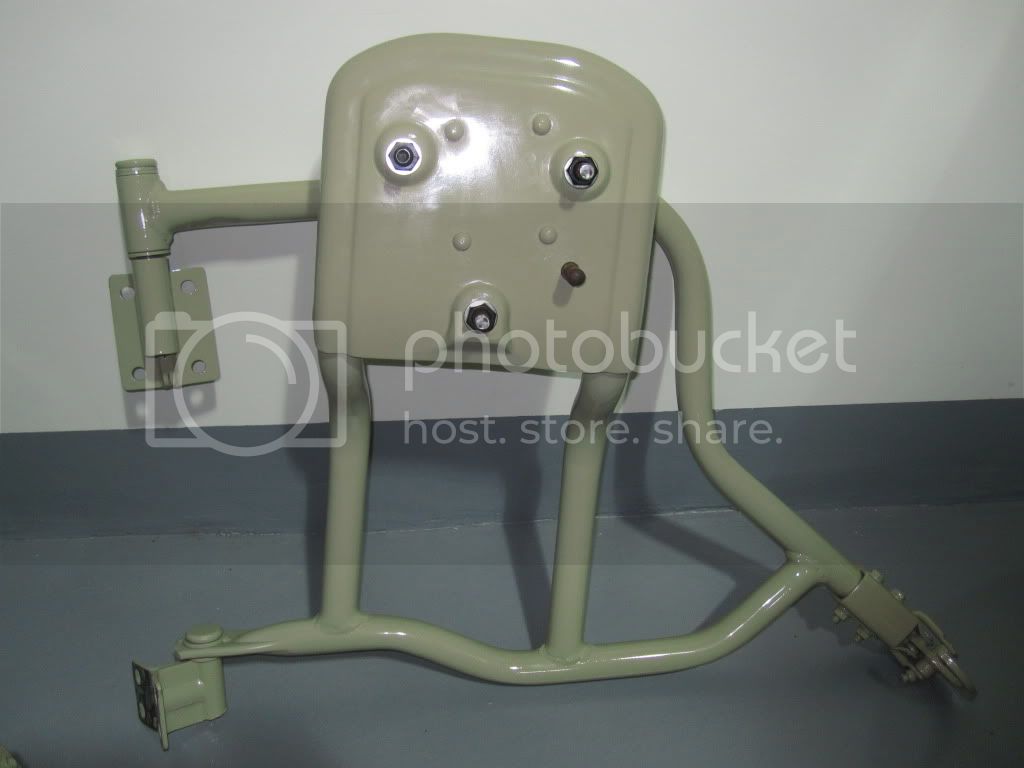

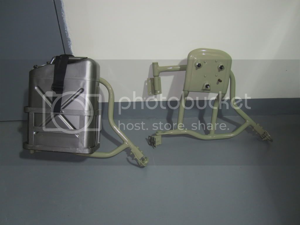

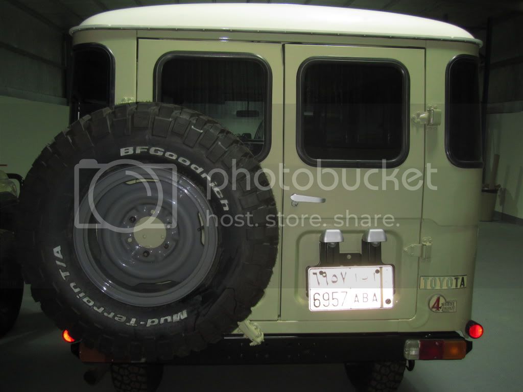

Here's a little update on the carrier. Got the broken bolt removed and a new one was welded in. Sanded and grinded down, painted, and voila!
Next to the original carrier that came with the truck.
Tire mounted on. (that tire was faarkin heavy:crybaby:)

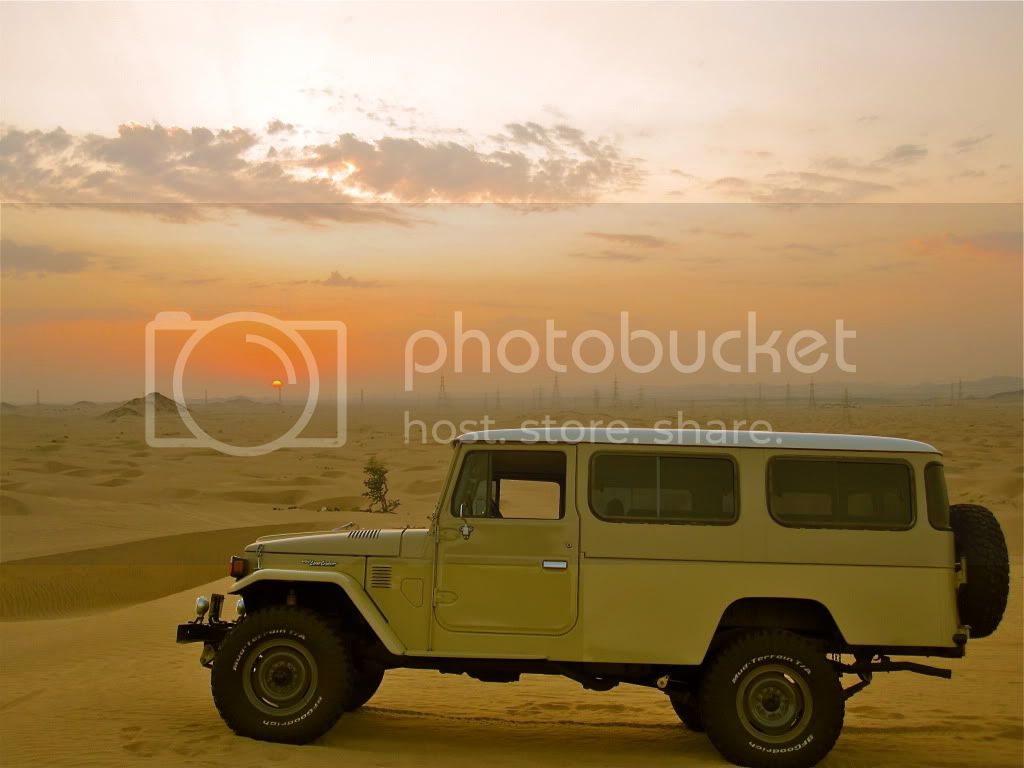

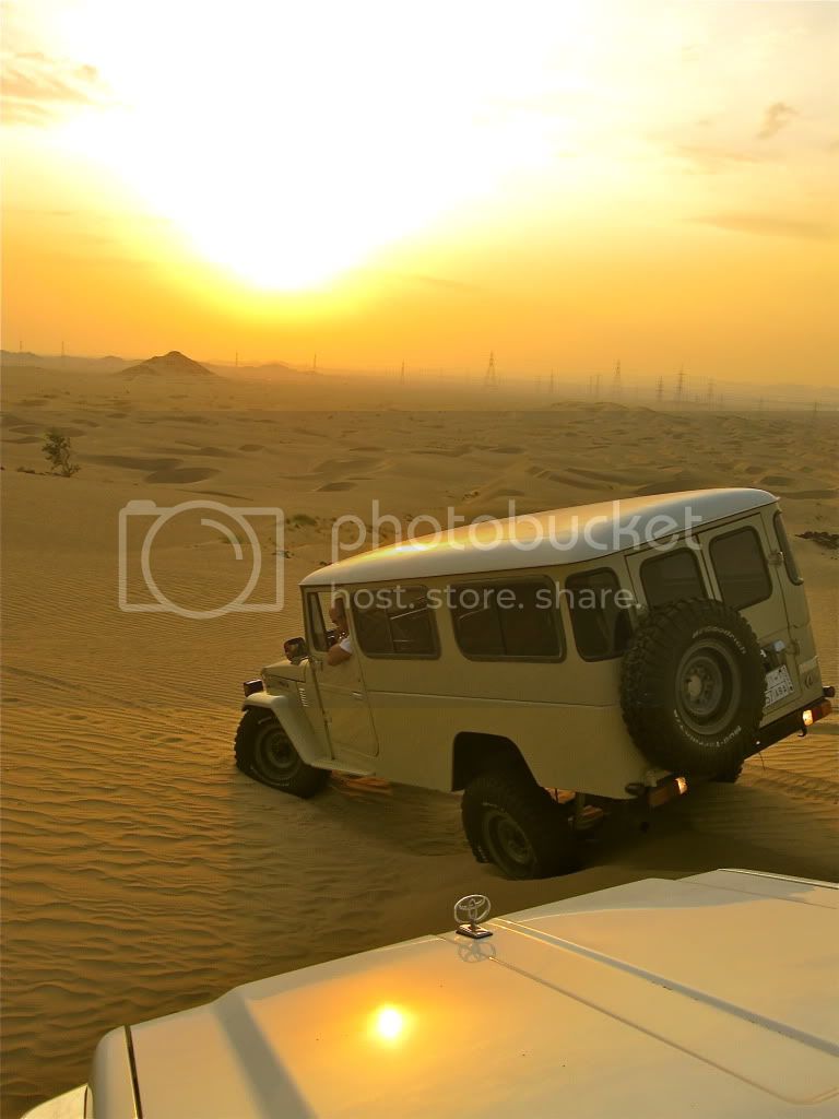

Trip

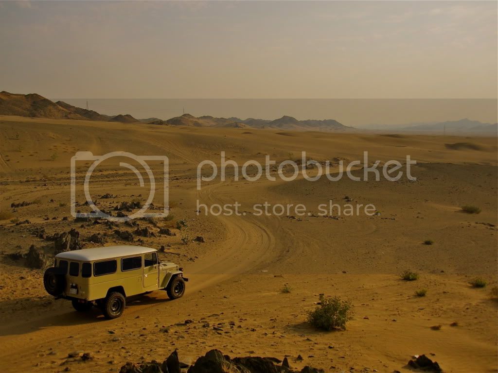

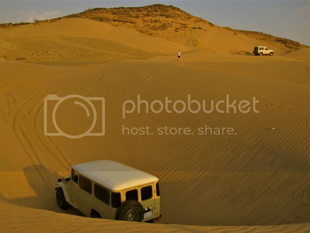

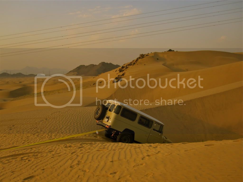

And then yesterday a buddy and I went for a little trip to the desert. It wasnt but a 20mins drive out of town. This gave me a chance to stretch its legs and put the truck in its element. I can say I was more than delighted at how it performed.
This is my buddy's 2006 FZJ74. Pretty awesome rig, and he goes by the name safir on mud. He rolled this rig a year ago, and the fiberglass top survived. Search his posts and you'll find the story.
I did get into a spot of bother by entering a bowl, and with not enough grunt in that 2F, I wasnt able to power out. Oh well, still managed to get a little tow and be on my way out.

Nice job with the carrier and I'm enjoying the great scenery pics.
That sand looks pretty dry and there appears to be lots of potential there for getting stuck with those big drifts and drop-offs.

Thanks marbles! Ya if you're not careful its really easy to catch an edge and tip over. The troopy has better stability going over those drop-offs than the shorter wheelbased rigs. The only difference is most of the shorties have much better power than I do, hence they tend to power out of trouble. I've got to take my time and choose my lines carefully. Fun either way:steer:
fantastic truck and wonderful pics
your truck looks fantastic and totally at home in the dunes
love the big Mud Terrrains on the steelies
you have excellent taste
thanks for sharing the pics and info - I really enjoy reading your thread
I don't know that there was a original carrier for the troopie? As I didn't see any reinforcement in the corners when I installed my carrier on the door? I had to reinforce the corner!
Adventurous greetings,
Coen
I thought the same too, until I looked inside when I first got the truck and noticed that there was reinforcments in place. I am just wondering if the factory actually made jerry can holders for the FJ4* series' or this one was simply modded by the PO.
