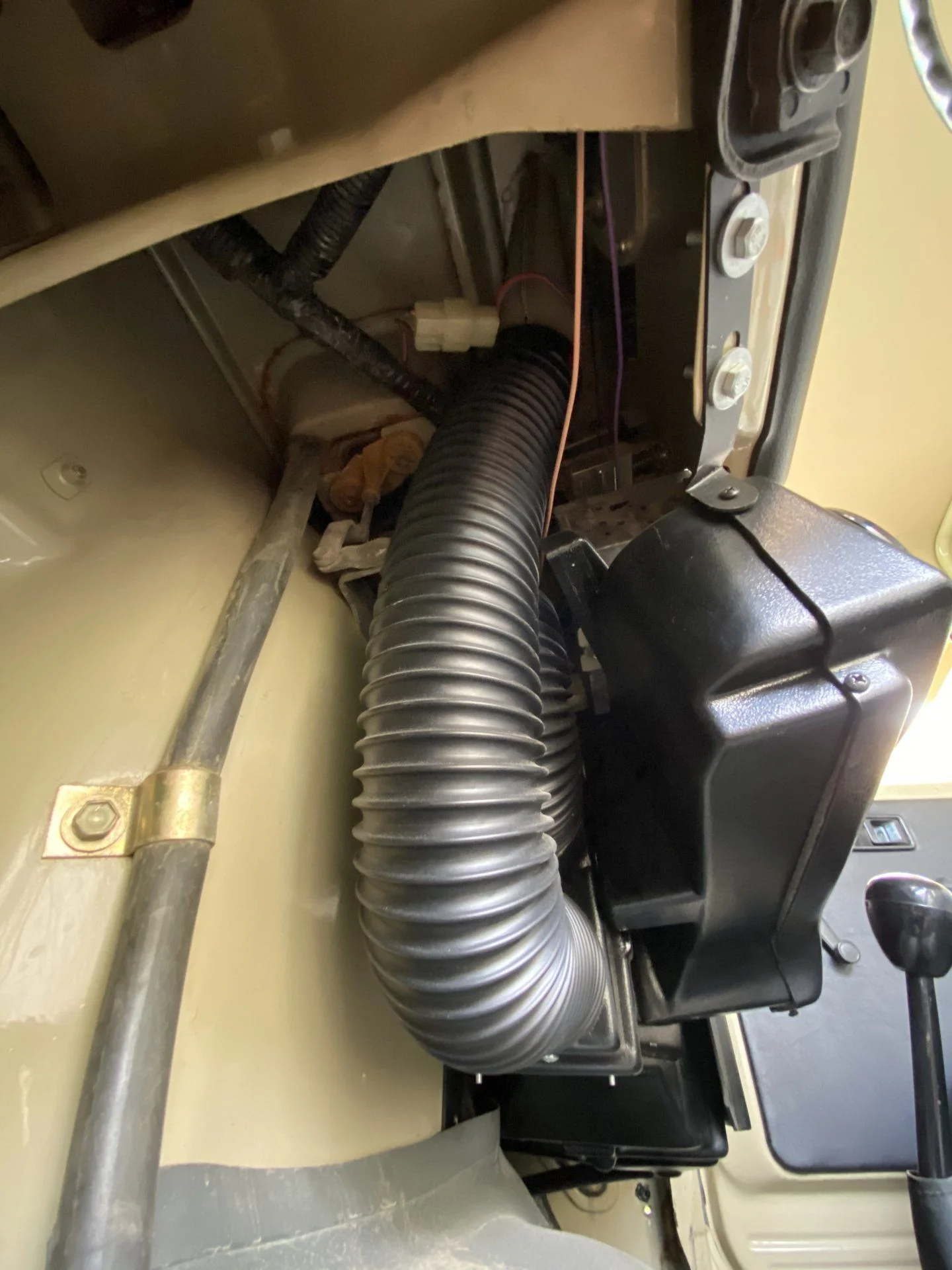

With the stock heater on an FJ40, you should be able to take out 3-4 screws and unplug a wiring connector to remove the fan on the top half of that "box" where the intake and such is and see exactly how it works and it's current condition. There should (at least on ~70's US import) be a cable pull on the dash marked "fresh"(?) that moves a flap back and forth inside that box, under the fan.
And, even with that water valve closed, it's not going to totally stop the transfer of heat, only really slowing down the flow of water on one side.
Plenty of guy's on the board in the US from places like Montana and Colorado that are probably very familiar with the system (where it gets kinda hot in summer, and really cold in winter).

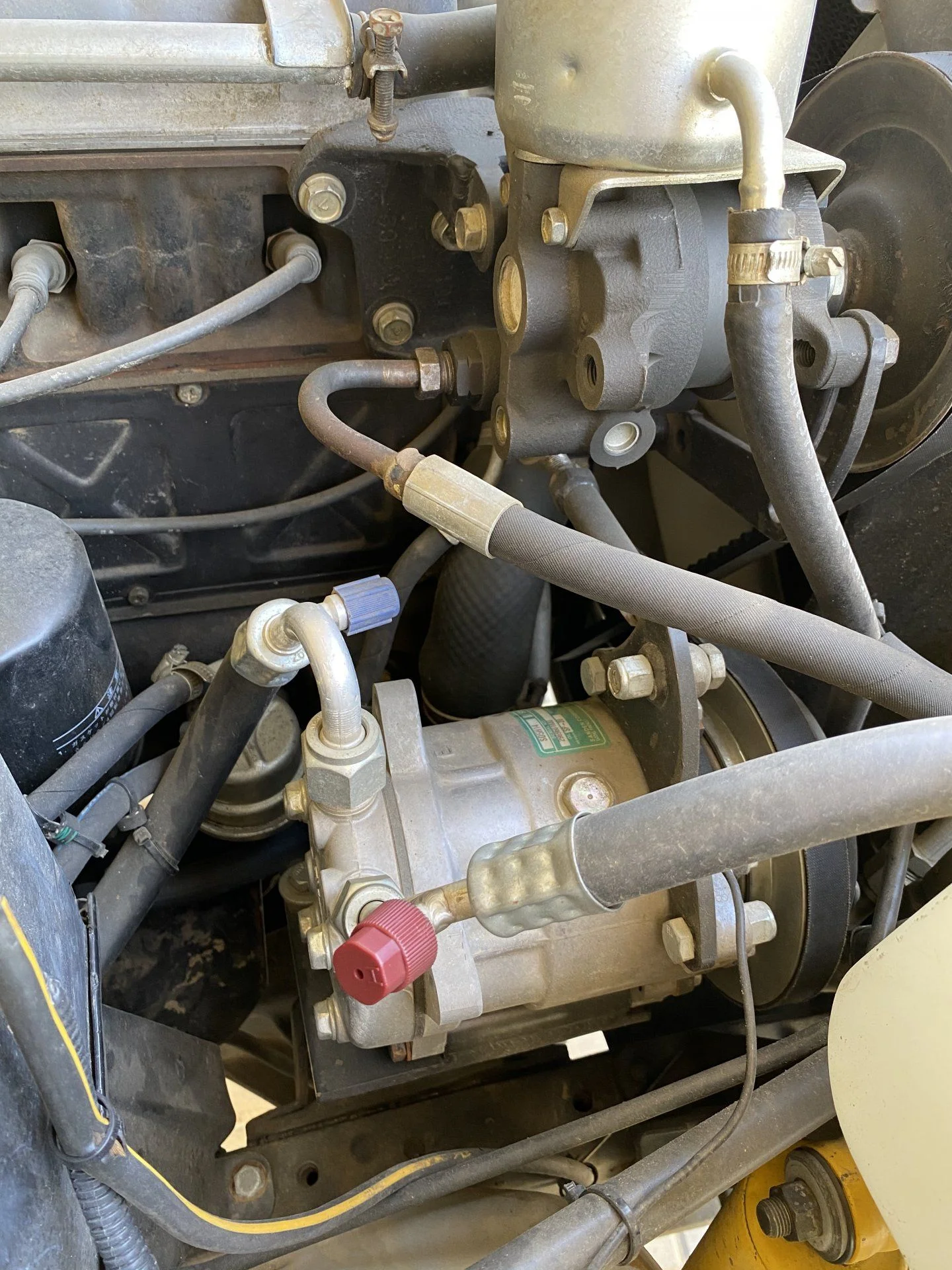

Thanks. I opened up the heater. All seems good. The flap which is controlled by the the knob marked “fresh” is working fine. Will investigate further when the engine is hot. It is summer here and that hot air coming out is not very comfortable ...
Nice, thanks for posting. By the looks of it using this means cancelling any heating option, right? Or does it heat as well? Here in the tip of Africa summers are hot and winters cold and wet, so we need both ...
It has a temp control dial along with fan speed. I've not tried the heat as we have plenty of that here:D

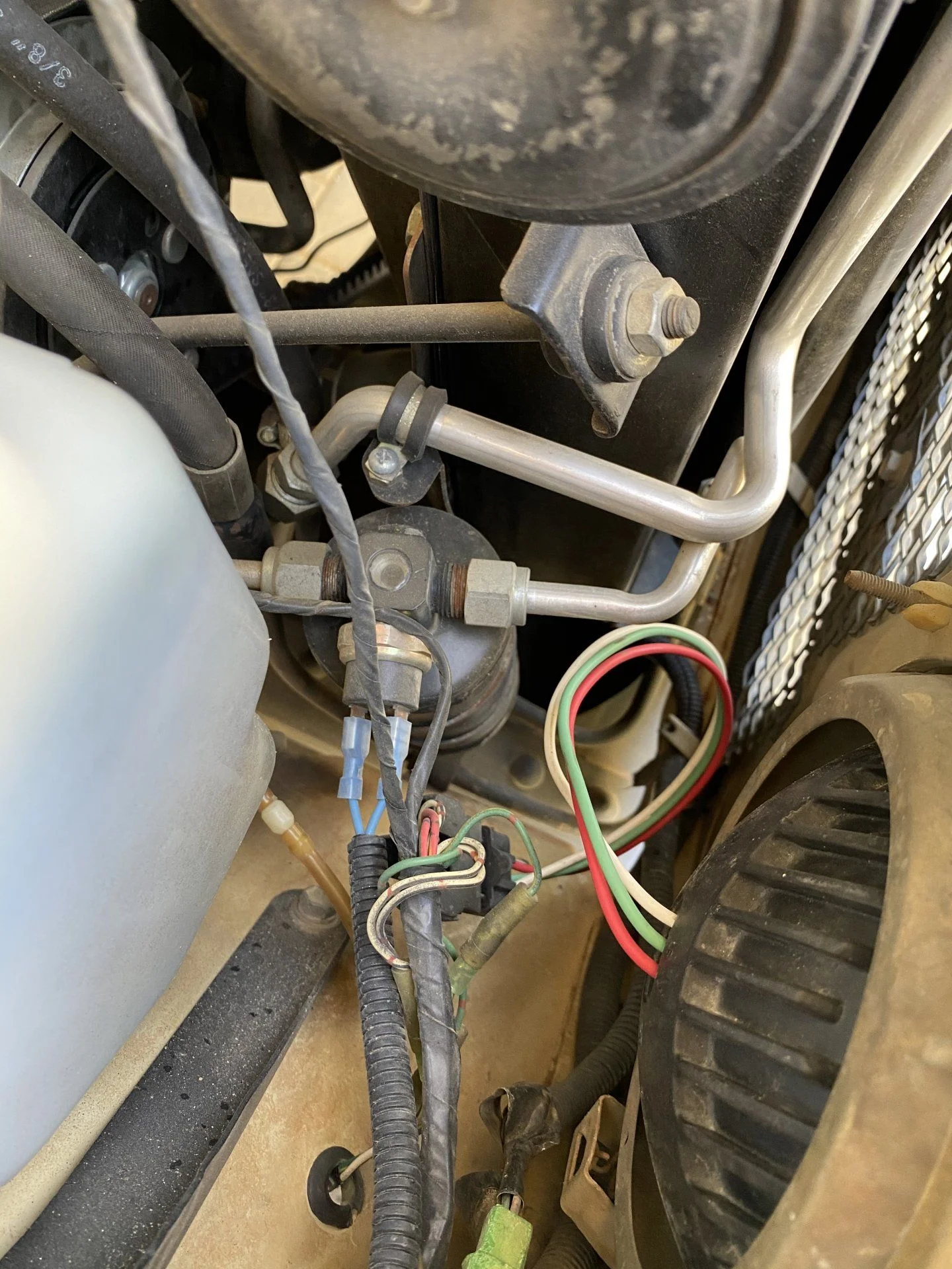

Back in a hard top. A much more relaxing drive, and no more cool air escaping from the Vintage Air AC

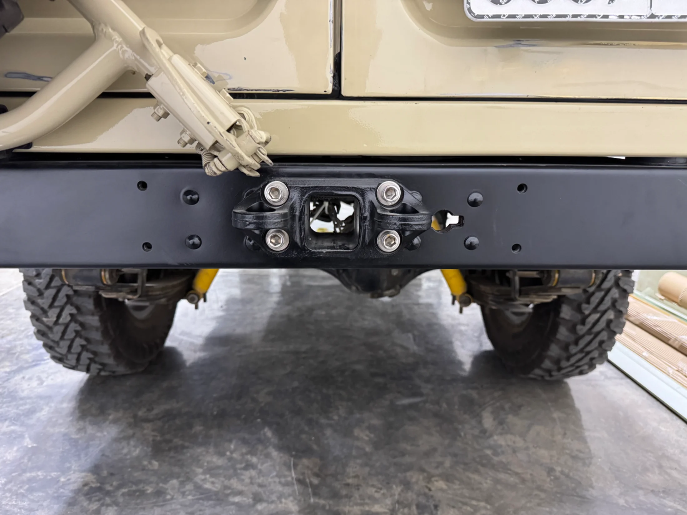

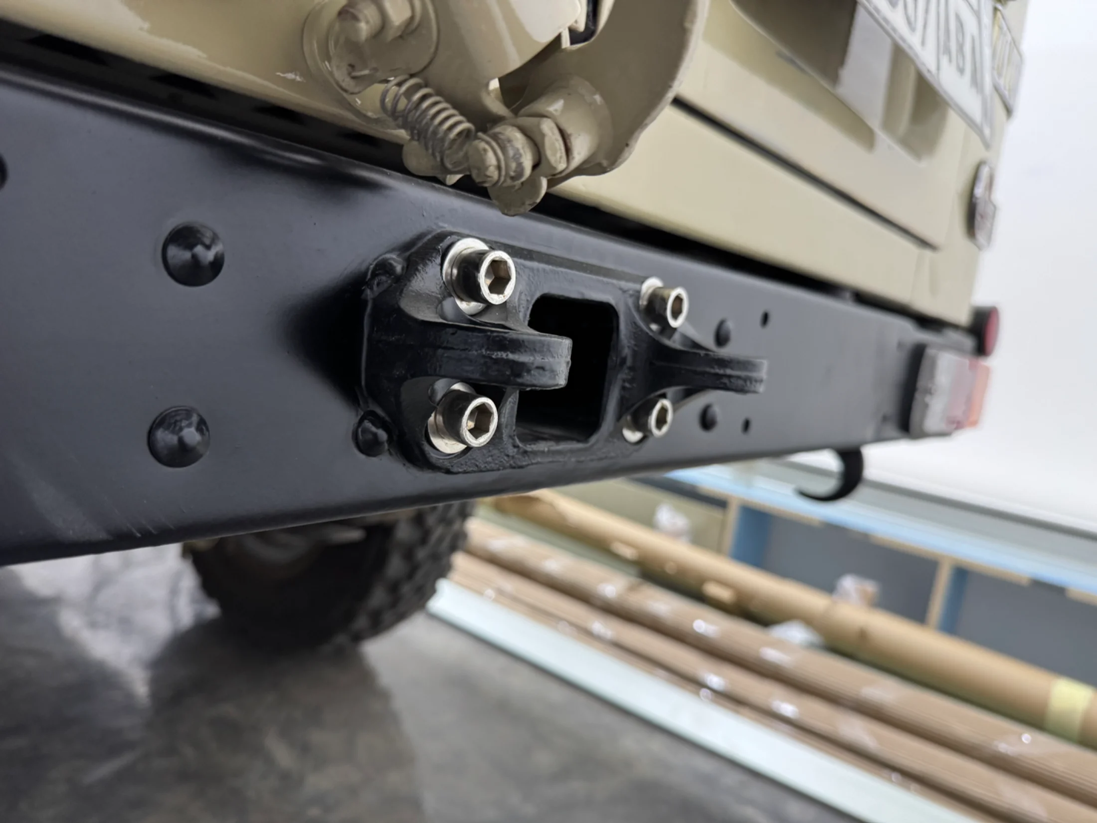

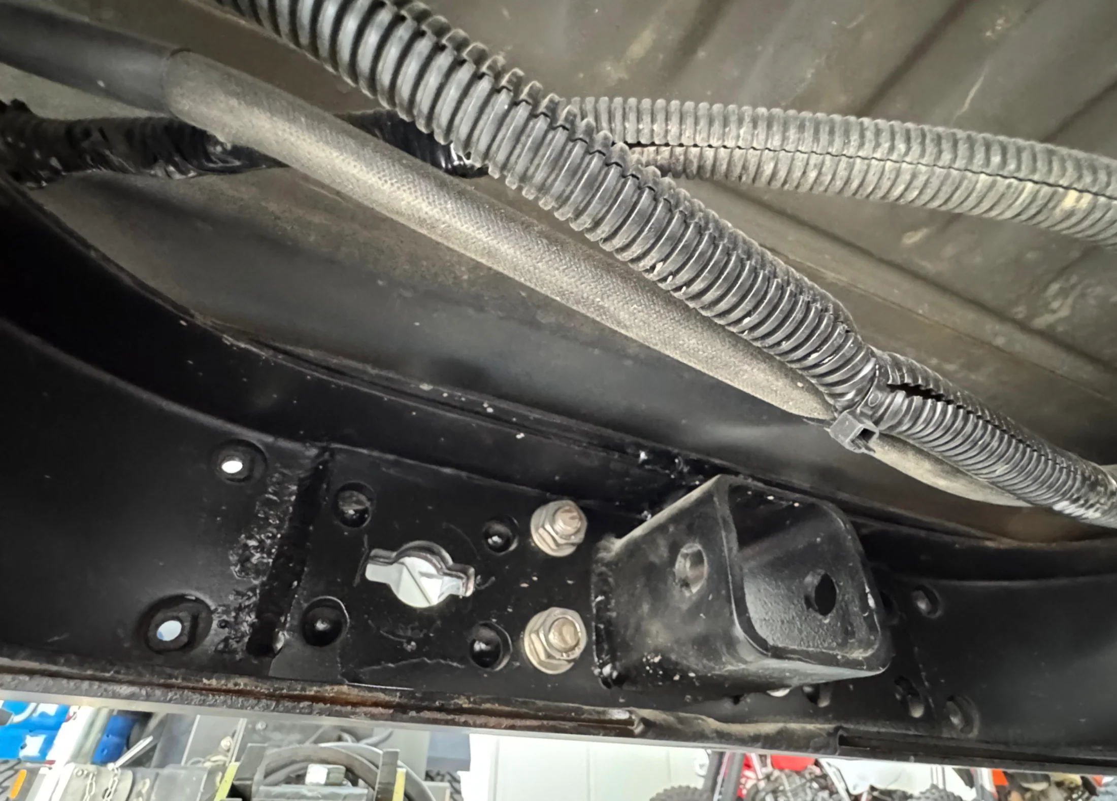

Had a hitch receiver welded into the stock rear bumper.

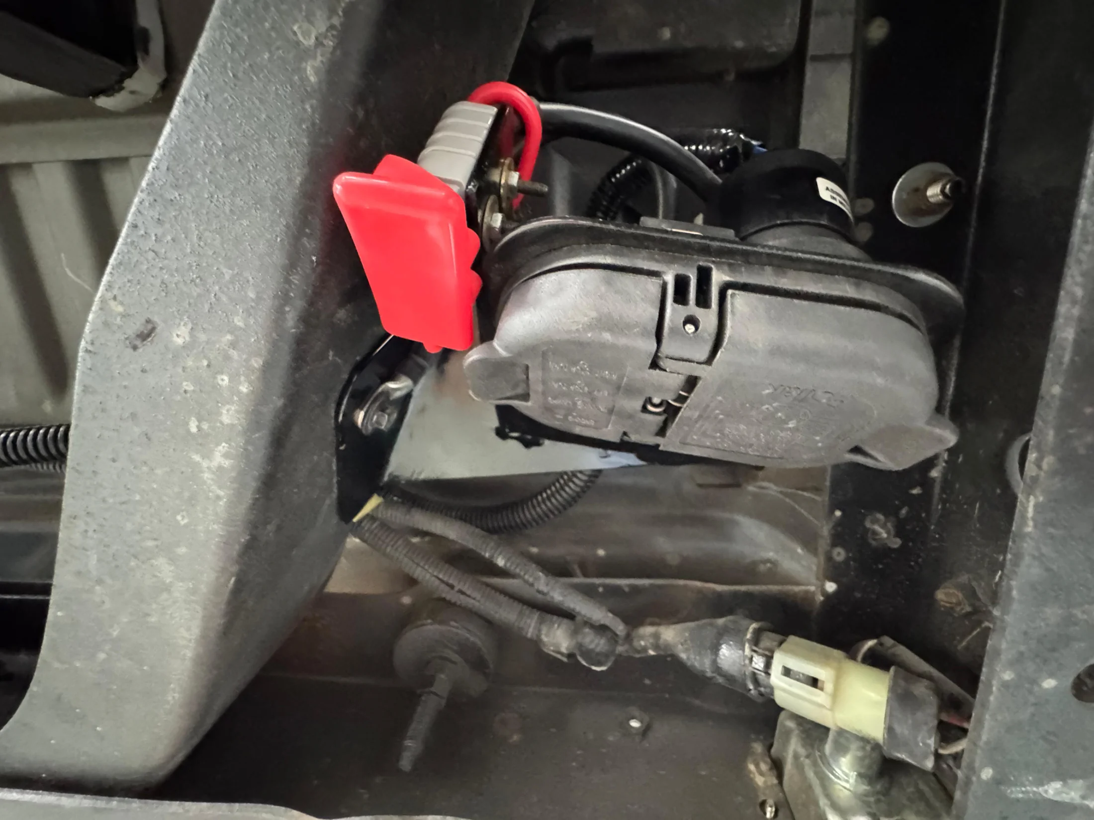

We added reinforcement on in the inner channel, and a 7 PIN harness and Anderson plug for towing duties.

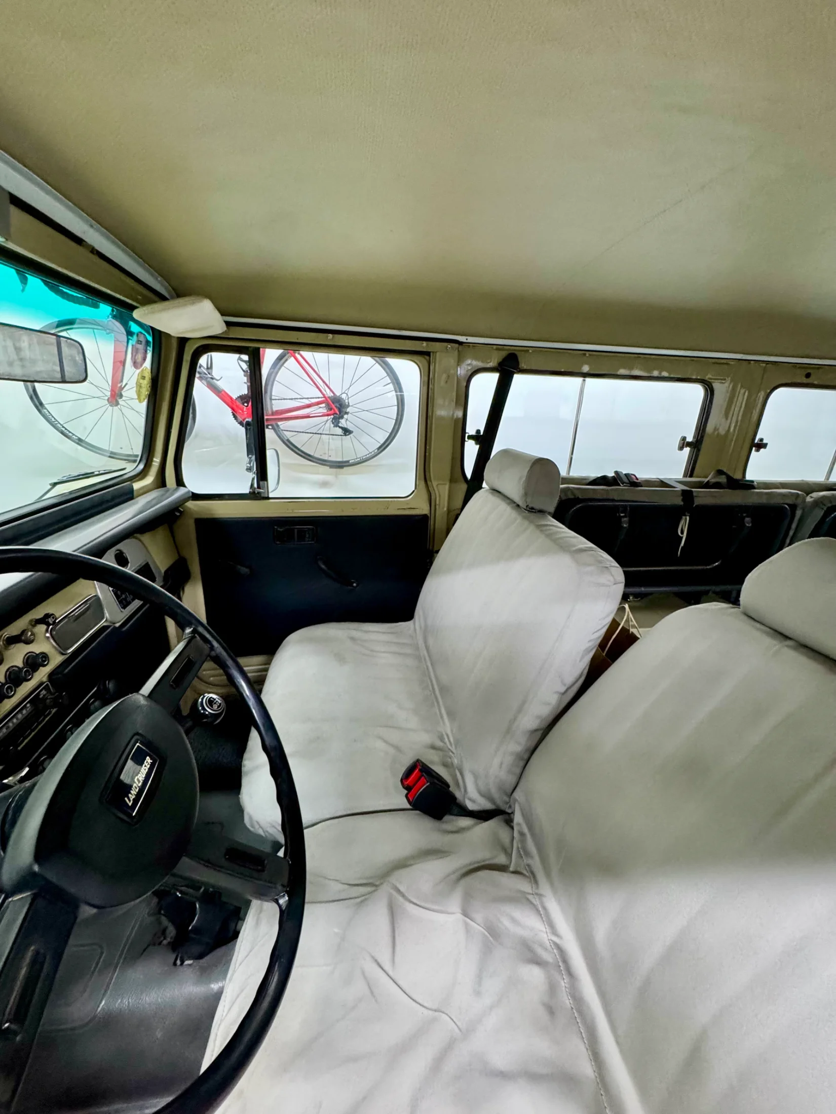

Lastly, the major upside for getting the hard top back on, is installing shoulder belts. I can now drive this daily and not get pinged, even though I am wearing a lap belt.

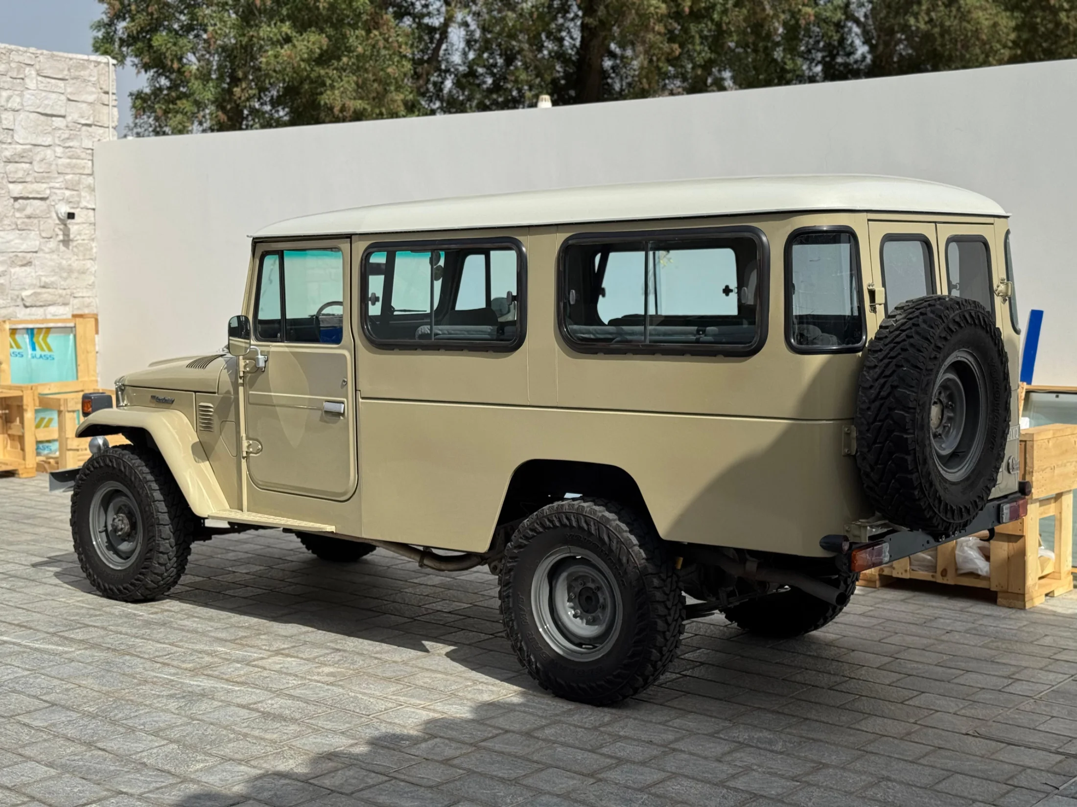

Here I am a year later, to the exact date, with another update.
Ditched the factory split steelies and went with City Racer 16" wheels. Also installed a set of TT Parabolics. Already noticed a difference in the ride. So much smoother, and thats coming from OME's with 2 leaf packs removed from the OME rear springs previously. Also gained additional lift.
Being in the hard top, I can now run the AC in the middle of the summer in 40C weather at noon and its super comfortable.
Next up is a U bolt flip kit. Stay tuned for Aug 8 2027:D
