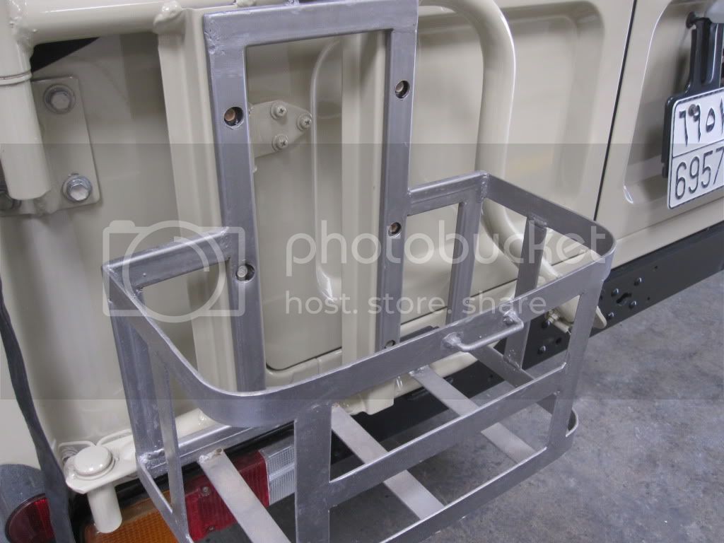

Heres a shot of my jerry can holder. Is this factory stock?

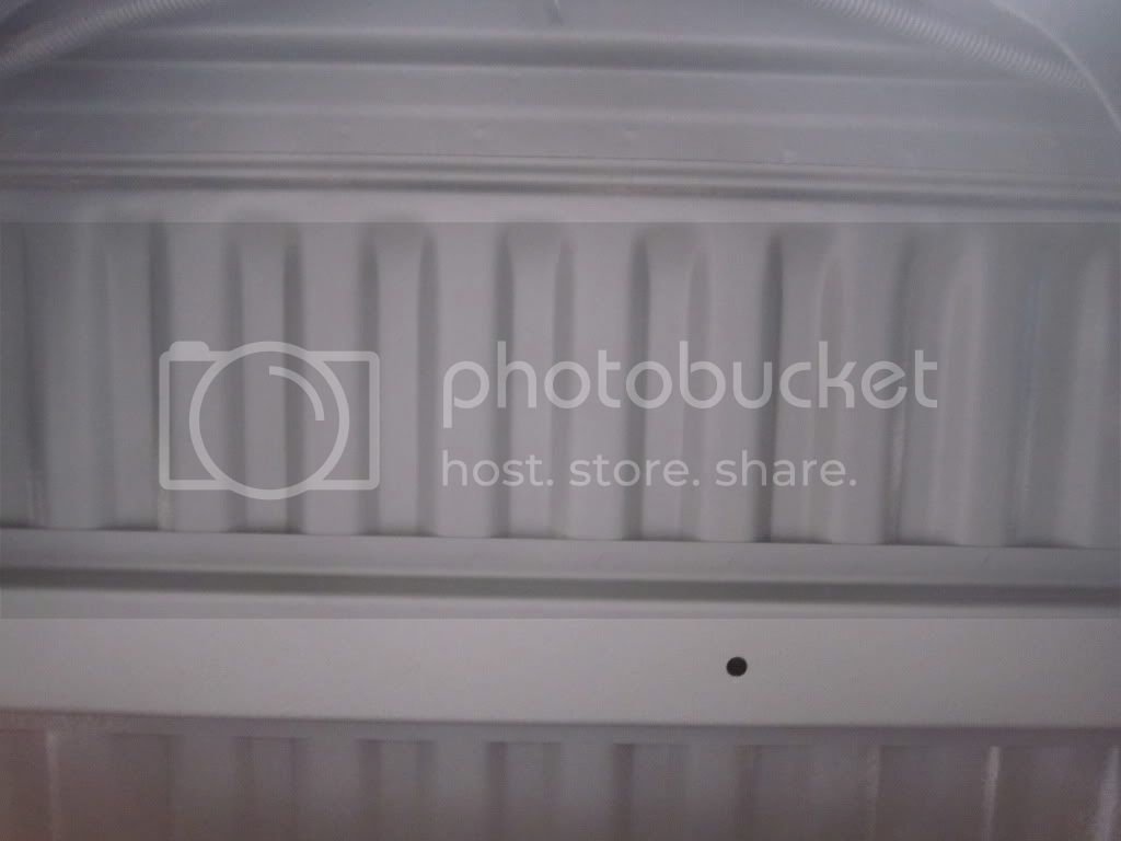

Got the splits painted. The inside has a matt finish, and the outter side has a glossier coat.

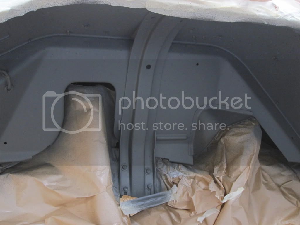

Went with a body coat for the underbody and the wheel wells.

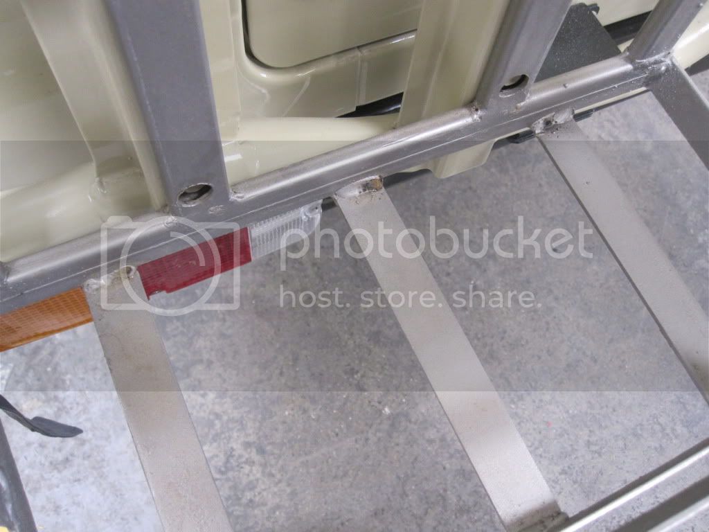

This is right under the rear doors.
We're almost there!

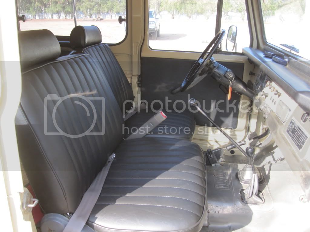

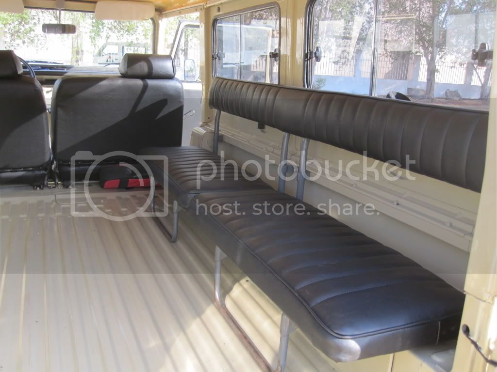

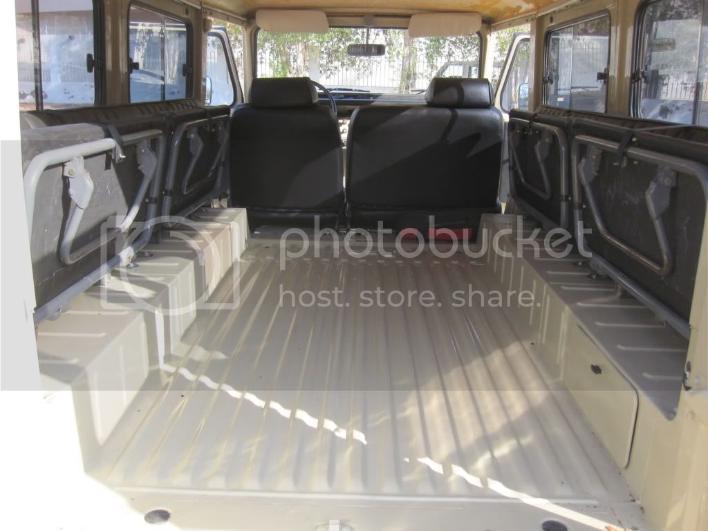

I'm really happy with how the upholstry turned out. Not bad for a local job. Got lapbelts out of a 76 series wagon front seats (3rd person middle seat). Fits great, and didnt feel like drilling on the door frames in order to install shoulder belts.:meh:

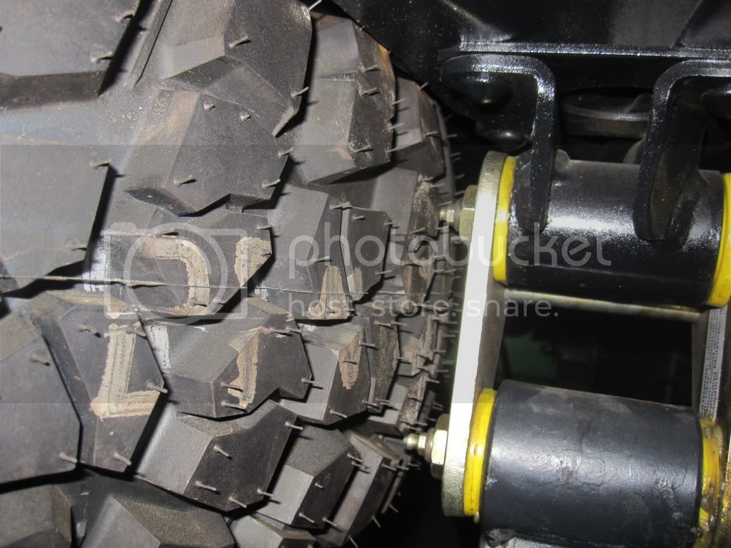

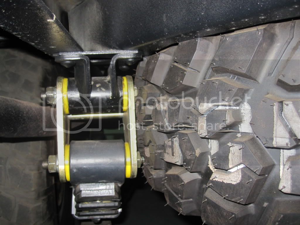

I noticed when we installed the spare tire under the truck, the 255/85 size seems too big, and the treads are pretty much engulfing the shackle grease nipples. I am not a fan of running the spare tire on the rear door, and want to keep it under the truck, but was wondering if the nipples may snap off from constant contact with the spare tire?
You can see the nipples burried between the treads. As if its in a buffer zone. Should I worry?
Umm.... those grease nipples will move quite a bit (probably up to an inch either way would be relatively common) as your suspension flexes. I cannot tell for sure from the pictures, but it looks as if you may have a bit of contact there that will probably wind up in damage to both the nipples and your spare tire.

Turn the shackle pins around so the nipples are on the 'outside'.
I'm wondering if I put the shackle bolts side on the inside, they too will rub with the tire when the shackles "rotate". Perhaps I'm just better off using the old standard tire as the back up, and have it as an "emergency tire". Enough to let me limp home in case of a flat, and then swap in the 255/85/16 tire.
