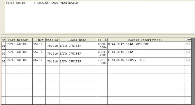

Just out of curiousity, I thought Toyota did away with the cowl vent long before the 82 model year. Did different markets still get the cowl vents? Anyone know?
:cheers:
Continued right through to 86 on some models:

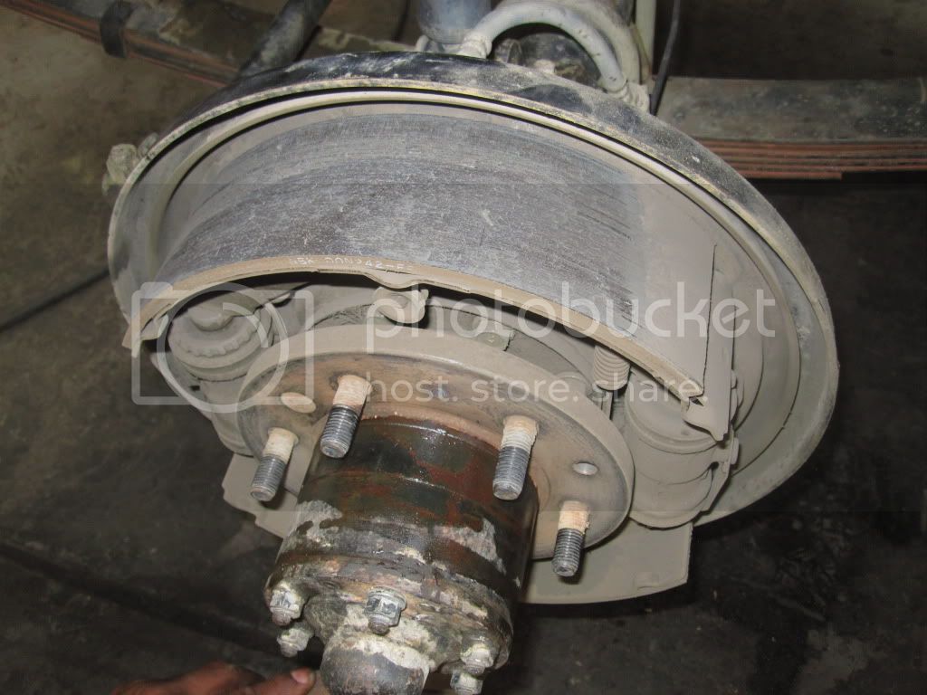

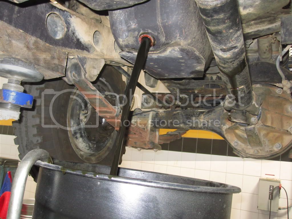

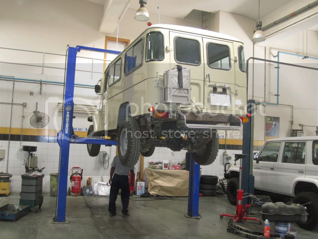

Here is small update. Near the office there is an awesome workshop that I have access to, that have a couple of very good mechanics, and a full on body repair and paint shop. I took the troopy in yesterday during our weekend (Thurs and Fri) and did a full service and check up. It also gave me a chance to check the undercarriage.
Here are some pics:

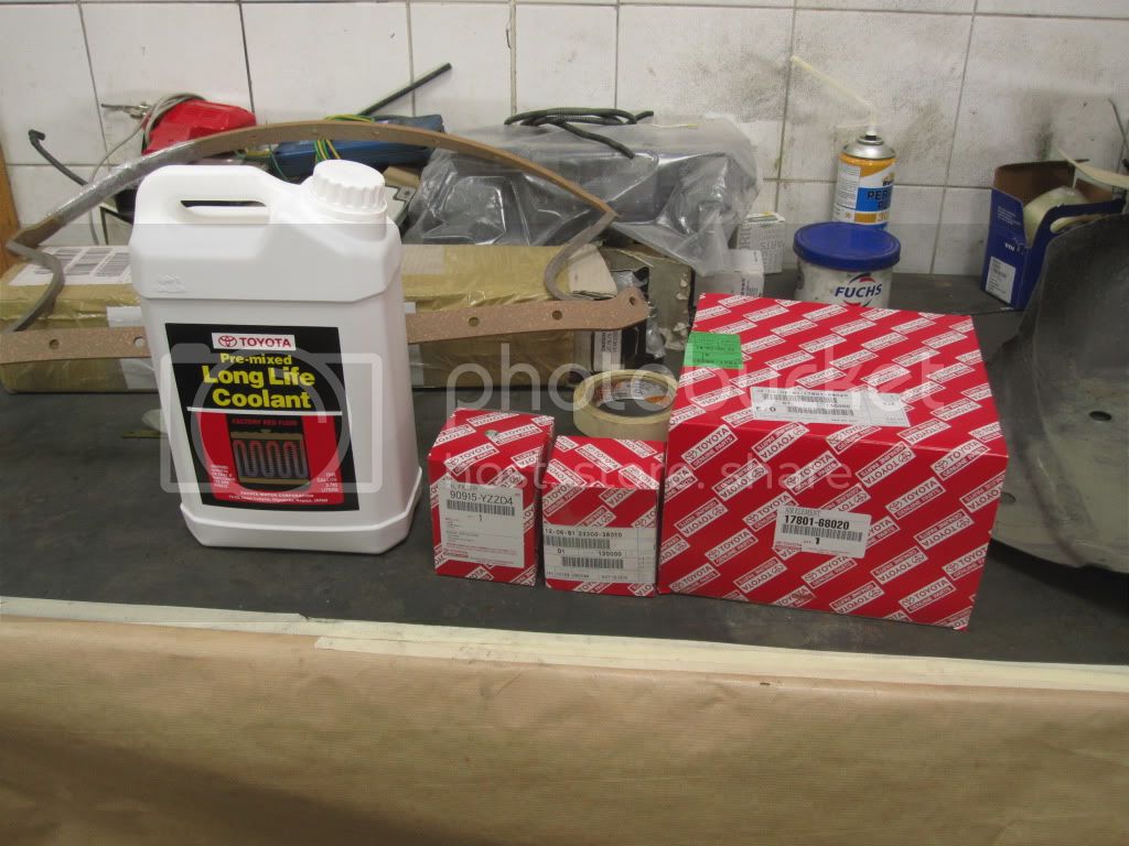

Changed all the filters
and all the oils

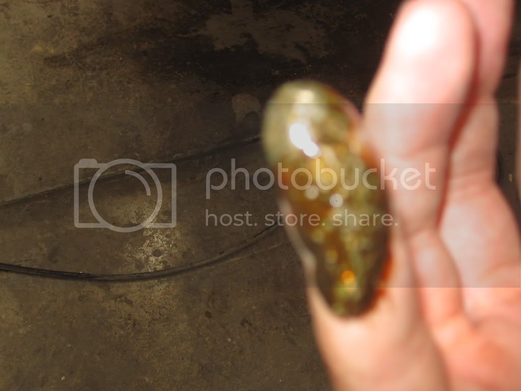

The transfer case magnetic plug had a bit of worn particles. Should I be concerned?
The brakes turned out ok for now.

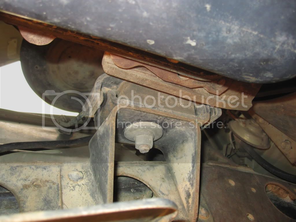

Body mounts seemed to be holding up well

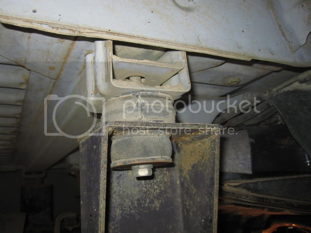

And engine mounts can stay for now

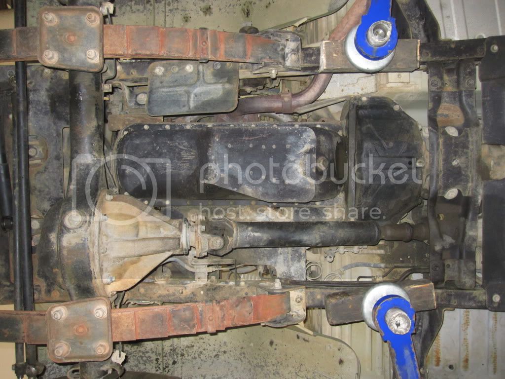

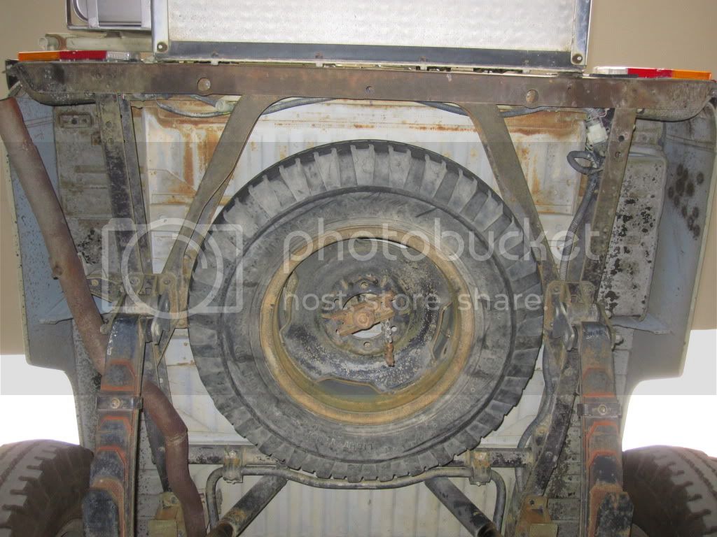

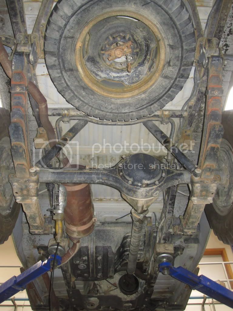

Undercarriage shot
I'm amazed at how durable these rigs were built!

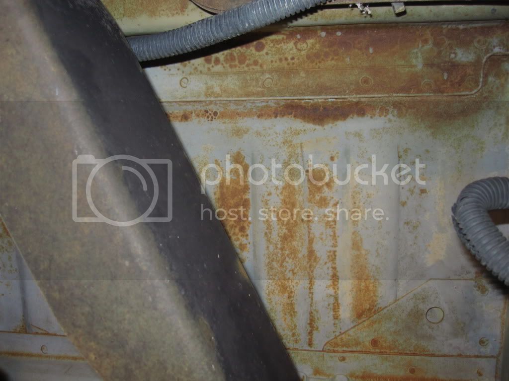

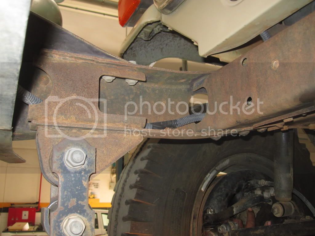

Some rust on the corners of the rear tub
Close up
The front frame/bumper rust.

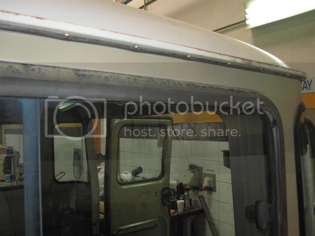

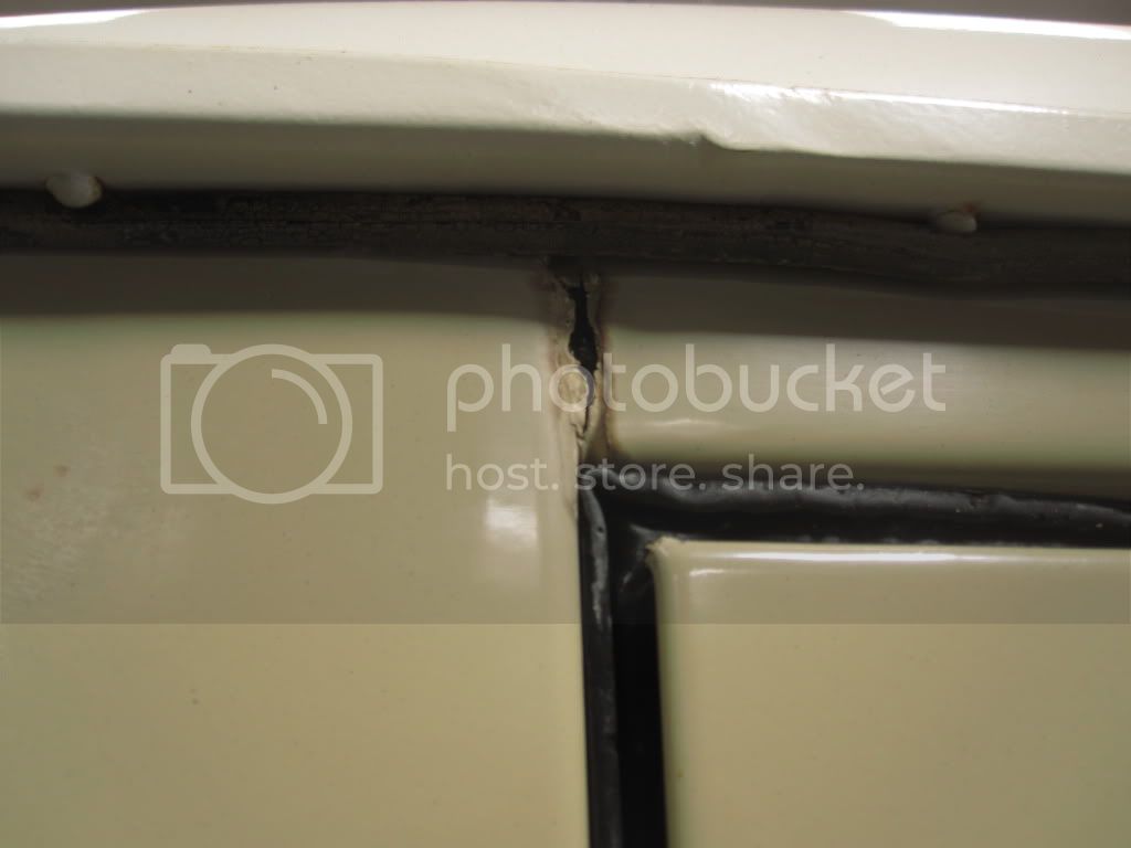

Rust cracks between the rear doors and roof

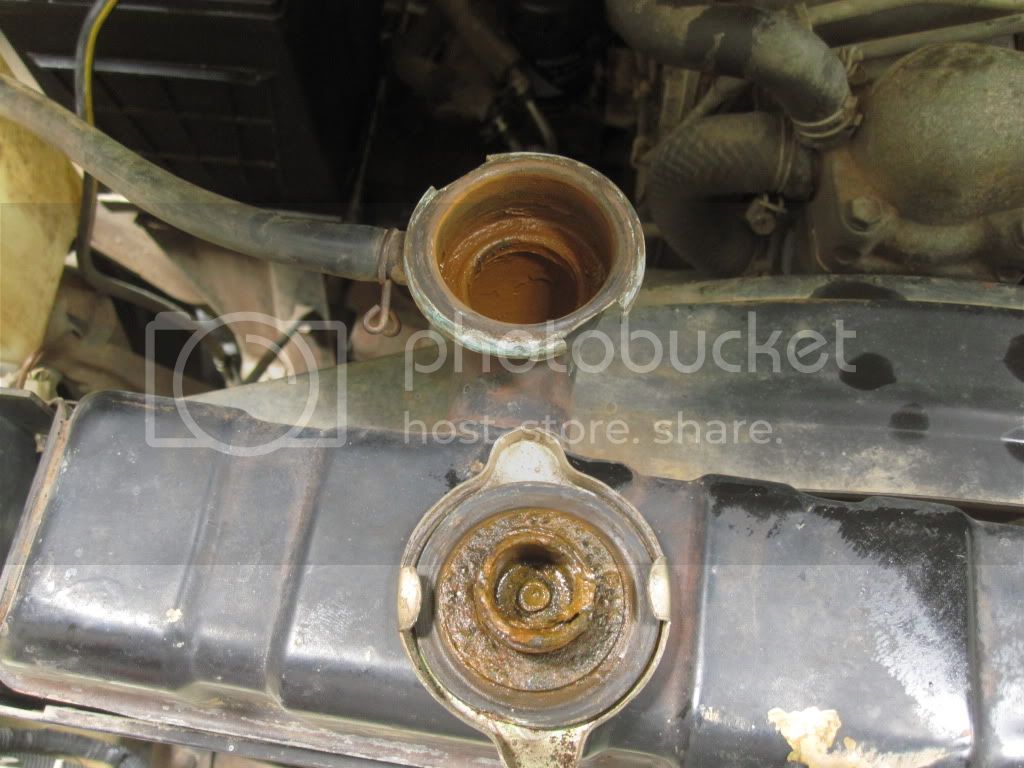

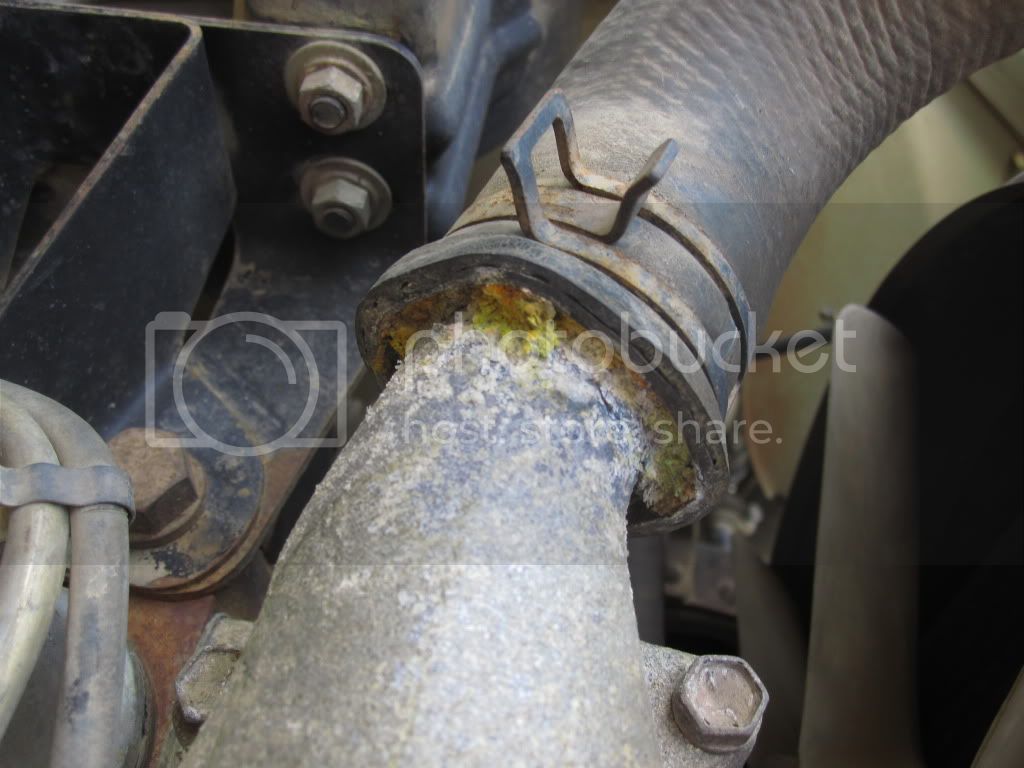

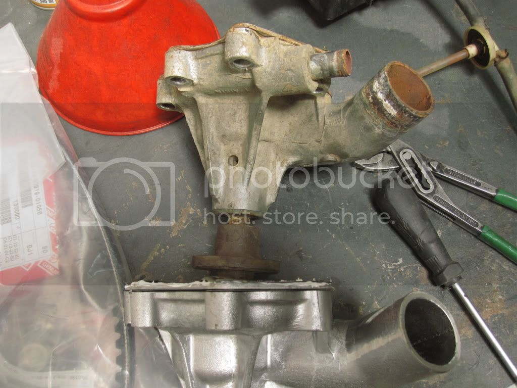

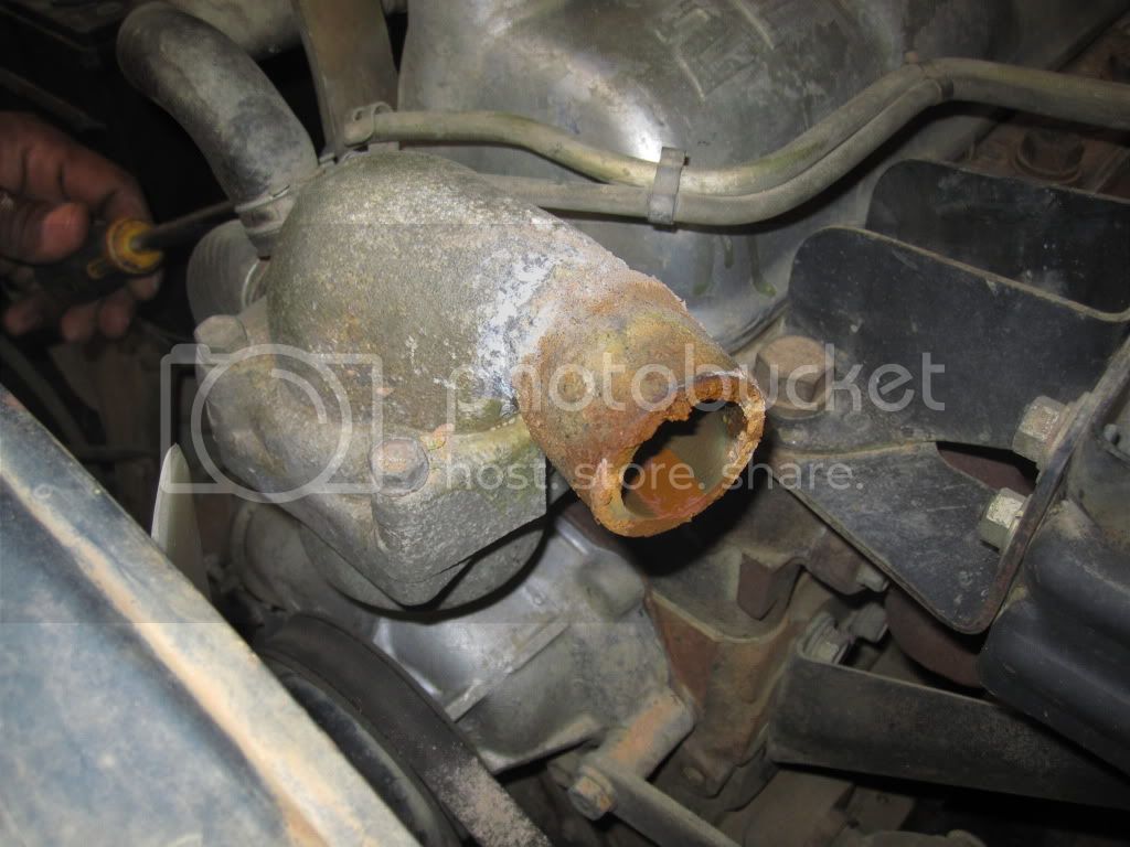

The radiator looks aweful from inside. Need a new thermostat housing. Whats the best way to salvage/clean the radiator?
Thermostat housing

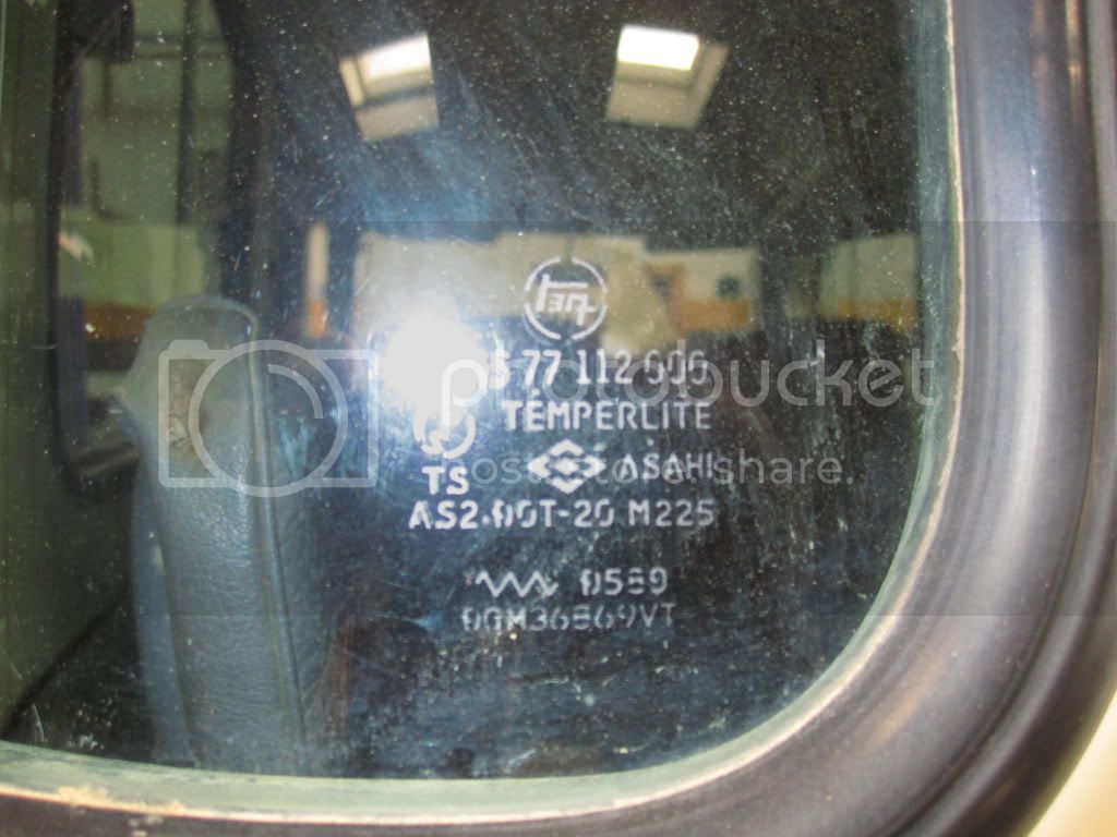

And a question for you history buffs: Is this the origina factory glass?
Here are some pics:
and all the oils
Undercarriage shot
Close up

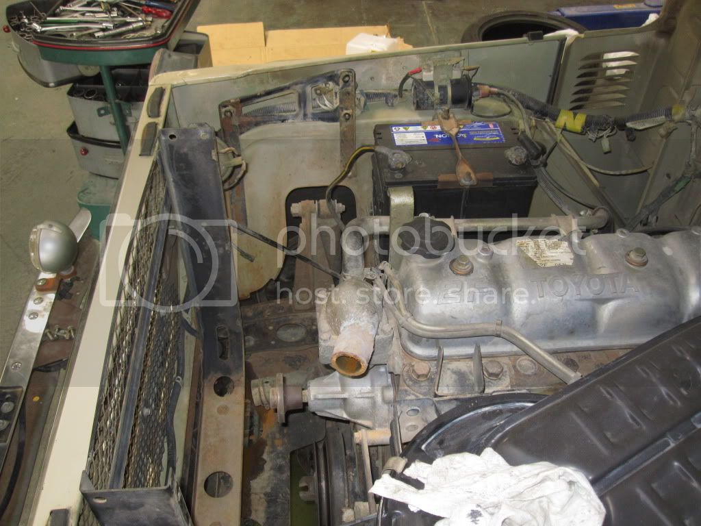

That is the original glass. Hopefully your tech does not shear the thermostat housing bolts replacing the thermostat. I would run some muriatic acid or radiator flush though that cooling system before you replace the hoses. I would also install a new water pump while you are there. The cooling system looks like it was run on straight non-distilled water for most if it's life.

The only rust I see there is minor surface rust. And this can actually be useful because if you paint such areas now (using quality products) the paint will actually adhere better than the factory paint did (because of the roughened surface).
And it is normal to find small amounts of metal during transmission oil drains - and more so if the change interval is long. (So I wouldn't worry there.)
Furthermore, the gap you pictured at one top-corner of your ambulance-door-opening is simply cracked sealant and this is quite common/normal. I think in your case it is probably caused as much by the dry hot climate as from any body movement there.
My area of concern is really limited to that coolant system. It is a shame the PO didn't take more care of it. So I back John's advice about that.
I see in the photos that you may have changed your coolant already ... That's fine.... But I'd dump it all again when you replace the hoses .... So that coolant (pictured) may perhaps suffice as your "flushing agent" if your lucky. (You'll know for sure when you see how clean things look inside when you change your hoses.)
With the previous poor maintenance of your coolant system, I'd keep a wary eye on your water pump (and replace it right now if you detect any abnormal play at all in the bearings).
:cheers:
PS. You may find the aluminium thermostat cover/housing is so corroded/pitted that you need to replace that too.

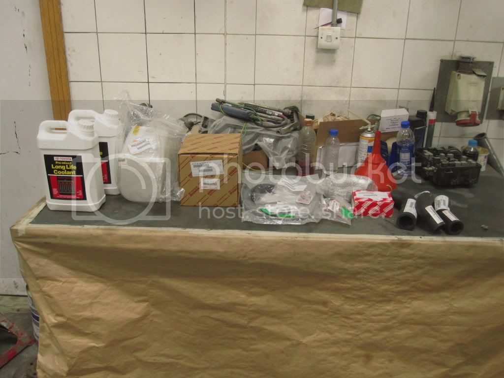

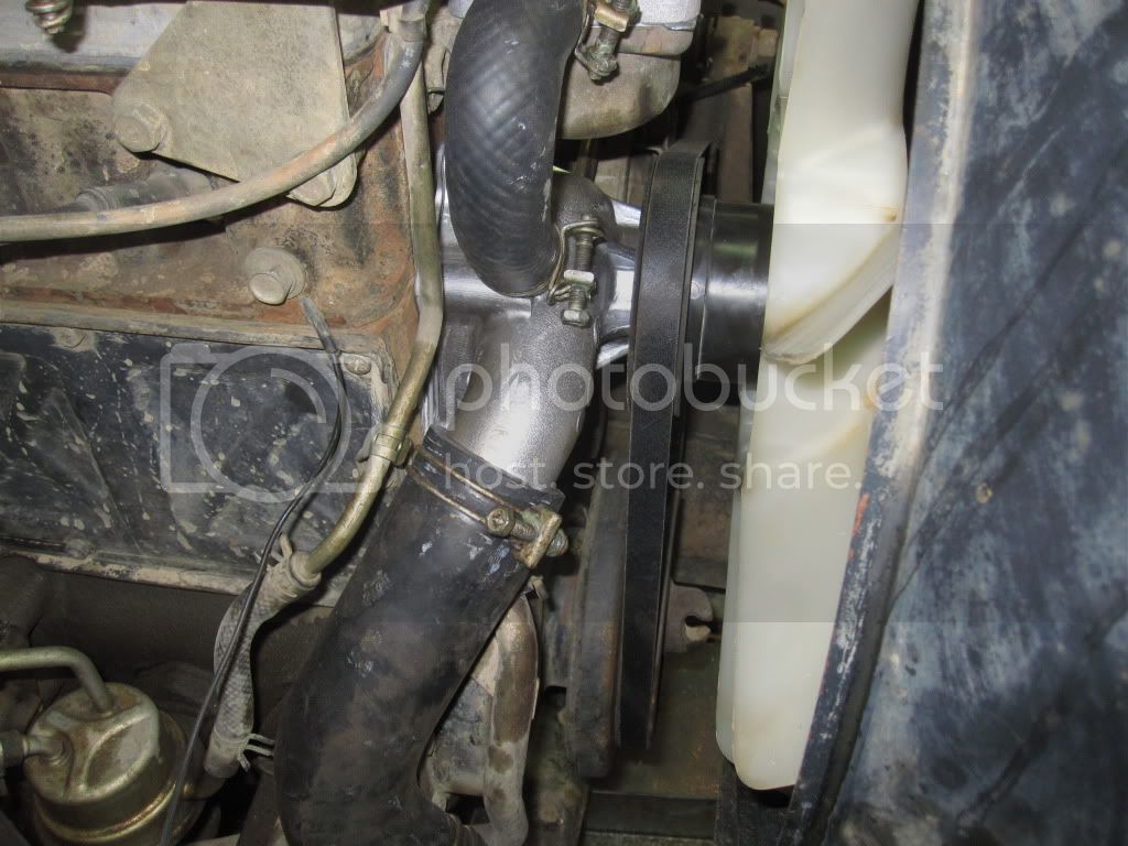

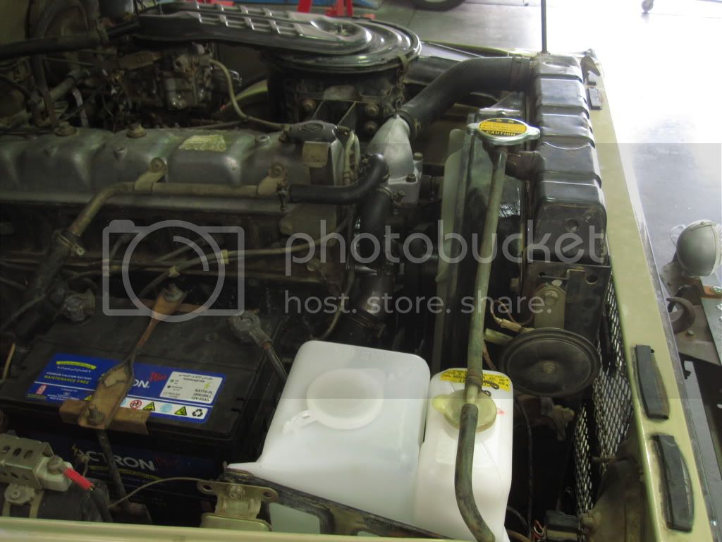

Here is a little update. We managed to sort out the cooling system, but not after getting the wrong parts. Turns out I ordered the water pump and the thermostat housing for the 2F that doesnt have an oil cooler. It was not a big deal as we popped down to the local dealership and they had all the parts in stock and we were able to exchange them for the correct parts.
Apart from that we drained the entire cooling system, cleaned the radiator, fan, changed the hoses, put new gaskets for the water pump and the thermostat housing, and put a new timing belt. I also put in new spark plugs.
Here are some pics:
All parts are ready. Or so I thought:doh:
Out came the radiator, fan, pump, and coolant resevoir
Thermostat housing in bad shape
Spot the difference?
Everything back in place

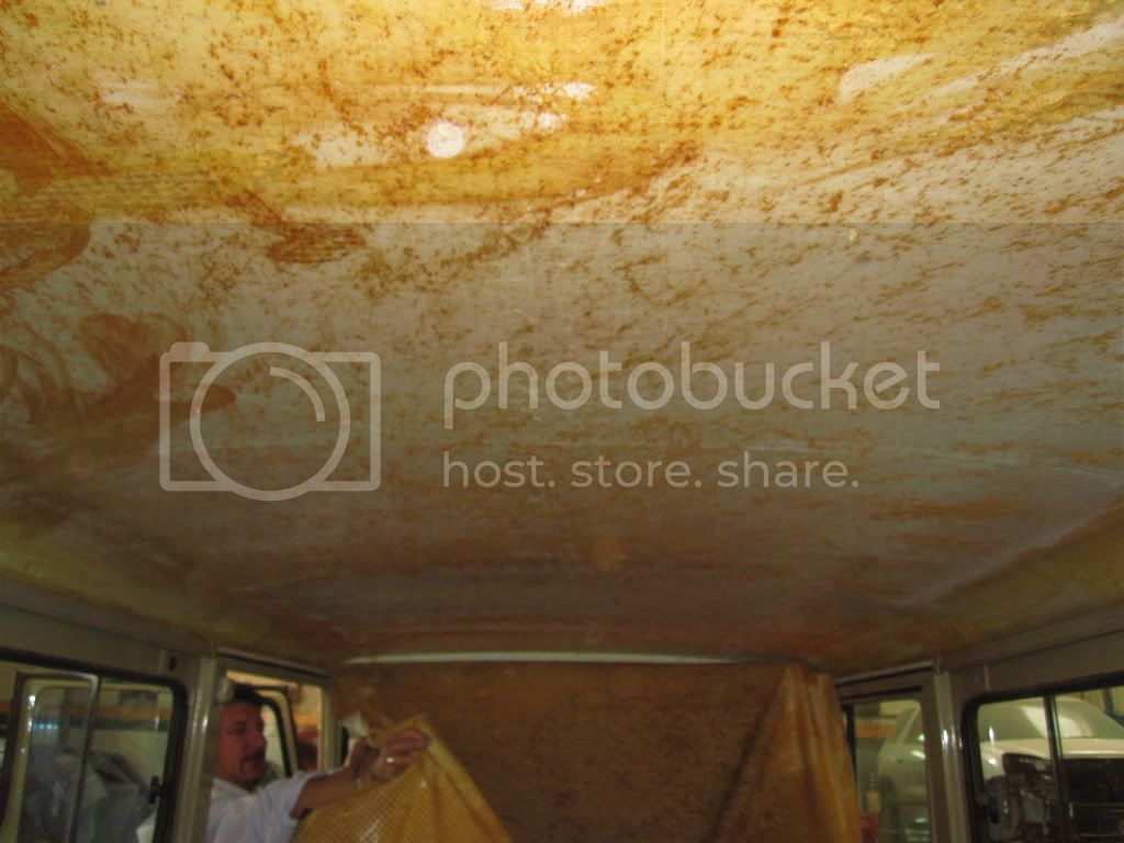

Removed headliner. I have ordered a complete new headliner from SOR and its on the way, along with some other goodies.
Anyone know what the paint code is for the bracket that goes outside the weatherstripping? Is it black?
Regarding the headliner, would it be possible to install the new one without removing the roof. I am bit scared of losing the weatherstripping if we remove the roof as finding a replacement is not easy. If we were to take the roof off to make the installation easier, would it be possible to re-use the weatherstip?
